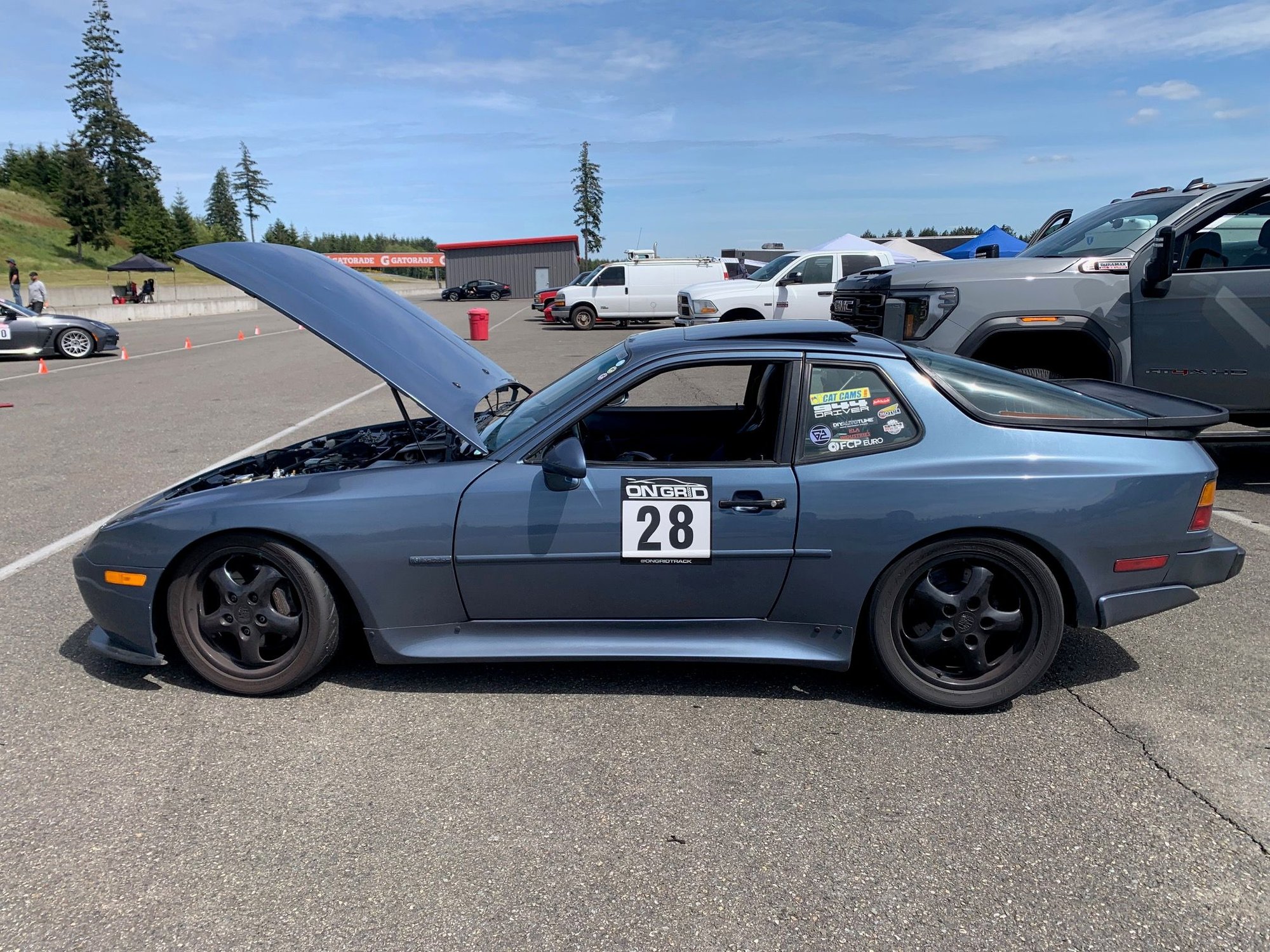

The Ridge
Track Day at The Ridge in WA. Time Attack Group.... Lots of GT4s and GT3s!!
First day on the new tires ~ RT660. They are awesome. My old tires were the Falken RT615 and they were 5+ years old... still had some tread but the rubber was getting stiff. The RT660 were significantly better. Sticky and forgiving. New Fortune 500 suspension and new tires made a noticeable difference. Made some changes & lots of notes on tire pressure and suspension rebound adjustments. Sway bar is at 19mm stiff and may go back to the 22mm soft... going to do one more track day before I decide.
I know very little about the Lotus line but this one was super cool.... super low and tight.... gota be super flexible to climb in but such a rad little car.
Love the 944 chassis. This was a 944 S2 so normally aspirated with the larger 3.0l engine. If I had a bigger garage, this would be something I would go after.

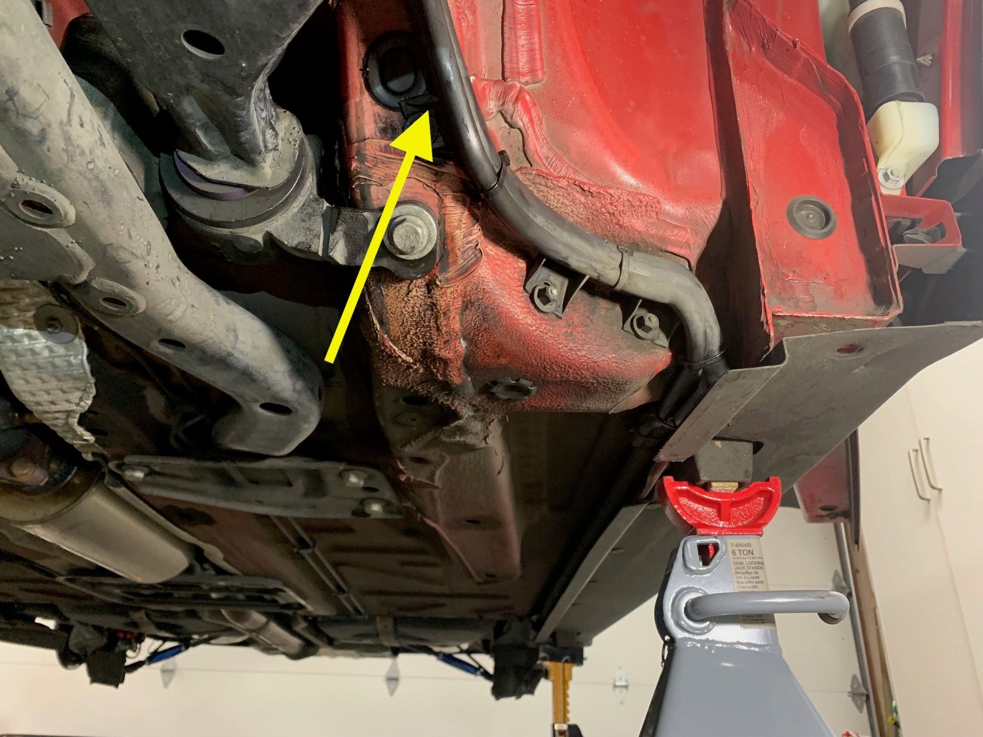

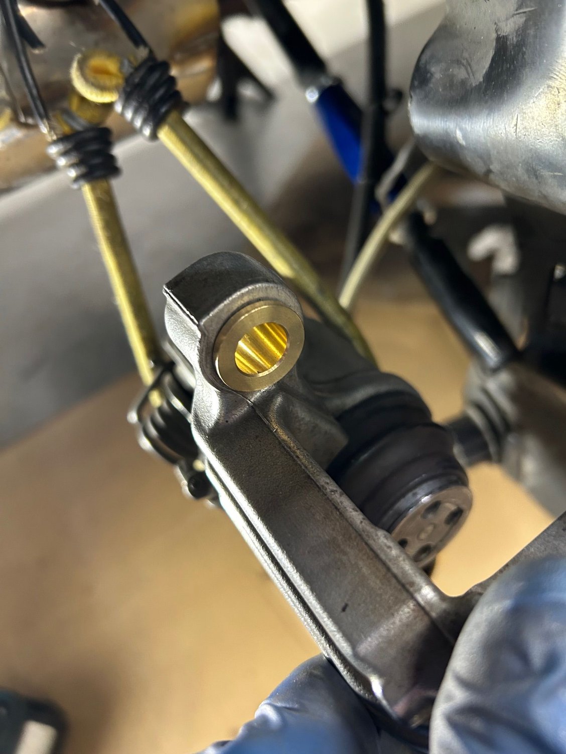

My brake reservoir has had a small leak for about 6 months now... After pressure bleeding (just under 15psi) and even heavy braking at the track I find a little brake fluid running down the back of the reservoir. So time to change it before it implodes.
It's a pretty easy job and you shouldn't need to bleed the clutch or the brakes if you're careful. It is messy though... no way to really get all the brake fluid out of the reservoir so get as many rags as you can under it.
Clutch line is a little tricky... it has a rubber gasket that keeps the line on the reservoir nipple. You can see in the pictures.
Separate the gasket and the line to get it off. Putting it back on ~ it was easier with the rubber gasket already in the line and push the whole thing on the nipple.
Pelican has them for about $100 and they are on the West Coast so shipping is 2-3 days.
I think it was leaking from this back seem... but I can't really see any signs of breakdown.
Even though I had a bunch of rags under the reservoir, I still managed to get brake fluid down in the compartment which has a hole and ends up draining behind the wheel well. So put down some cardboard and maybe even take off the wheel liner before you start.
Came down roughly where the yellow arrow is.... I've already cleaned it up at this point.

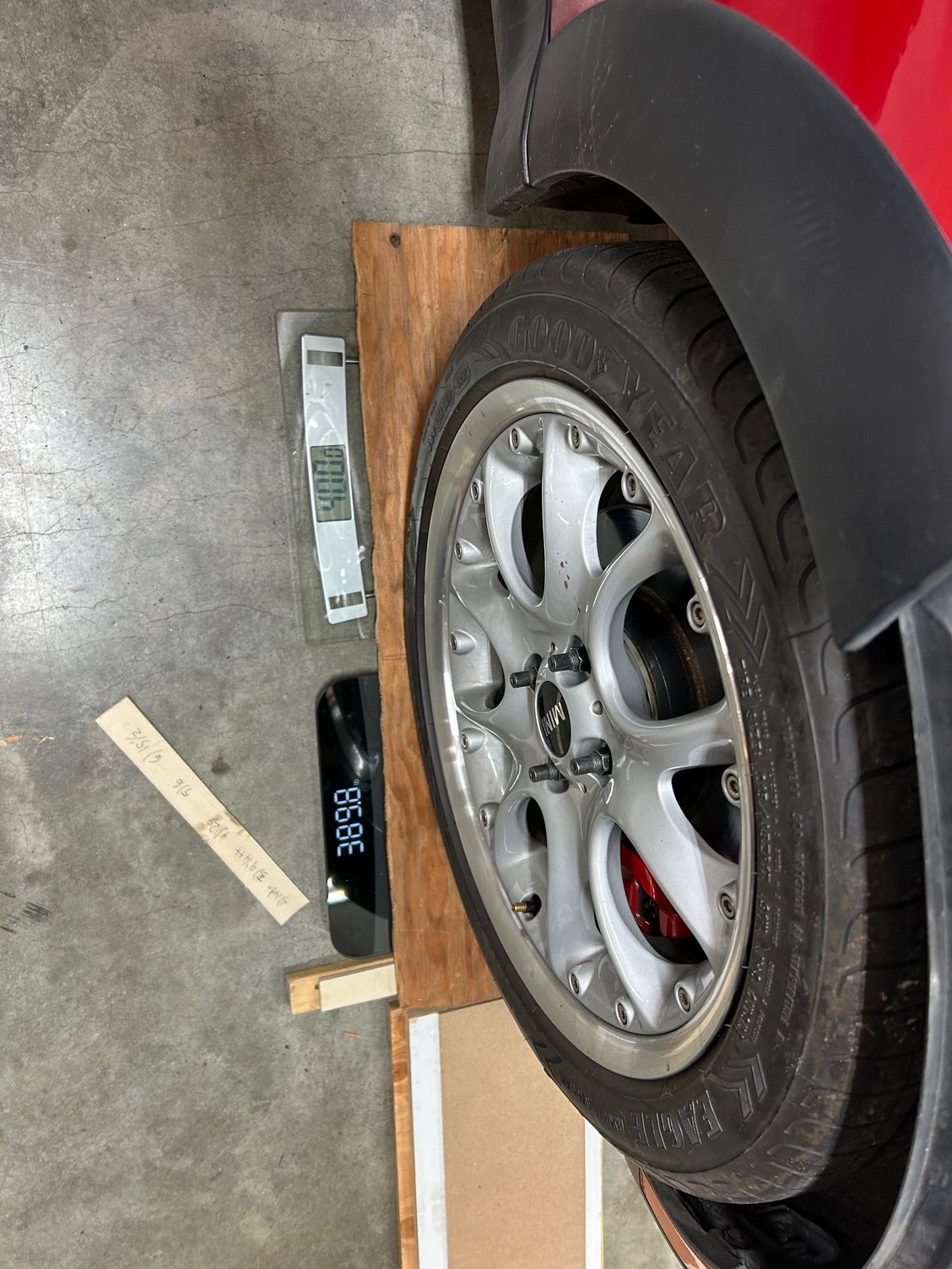

Corner Balance
Went down a full rabbit hole last weekend.
The LF of the mini has always been a little low when measuring the ride heights at each jack point & wheel arch. It's not really noticeable to anyone but me. But I started extending the length of the LF coil over to raise the LF to be more level. Then I started thinking.... am I adding weight to the LF and RR diagonal? Rabbit Hole!
So I started watching YouTube videos.
Ordered another bathroom scale on Amazon. If you want to do it get two 450 pound max scales because the fronts could be close to 900 pounds.
This one is 450 max but some times I would have to re-wake it up... but it worked well.
Put 130 lbs in the drivers seat.
Leveled the garage floor with plywood.
Disconnected the sway bars.
Corner Balance the DIY method
I will save you the details of the 3 hours of rolling the car on and off the scales.
Yes ~ by increasing the length of the LF coilover i.e., ride height via the threaded body, was adding weight to FL and the diagonal. So I reset both front coilovers to the same length and confirmed the spring preload. (I had the coilovers out to replace the bumpstops anyway) I also confirmed the rear were the same and re-weighed the car.
The bathroom scale method is not fast but it is actually pretty accurate. I would roll the car on and off the scales for each wheel. I would get 4 weights of each corner and most time it would be within 2-4 pounds. Which for me, was close enough.
I was able to estimate my car weighs 2850 pounds with 7/8 tank of gas and 130 pounds in the drivers seat.
LF / RR corner weight was 1437 pounds and RF / LR was 1413 pounds after resetting the front coilovers.
I was able to shift 60 +/- pounds from the LF to the RF by setting both front coilovers at the same height.
Front Left is still a little low but that's OK... rather be balanced than look perfect.

I have thought about doing the bathroom scale thing, but not as of yet. These questions come from a few things I have pondered before attempting it.
- Did you just do one wheel at a time?
- How did you make sure the wheels not on the scales were at the same height as the wheel on the scales? I know you said you leveled things, but just checking to see if that meant with respect to the scales.
- You appear to have driven onto the scales in such a way that at first one scale would see the full weight that the wheel is supporting. Maybe the answer is obvious, but a scale rated for 400+ was ok with being loaded to about 1000 lbs with no issue? Or did you have some way for the 2 scales to share the load as you drove up?

Corner Balance continued...
Coilovers.
I have Fortune Auto 500 series Coilovers with 6K front and 6K rear. I am super happy with this set up but I would like to note.... You can NOT have your cake and eat it too. This suspension took 4 seconds off my best lap time a the track BUT big hits / dips on the backroads are hitting pretty hard into the bumpstops. For me, it is very good (but not great) on the street and good enough on the track. I am definitely straddling the fence between street and track.
Corner balance. (there was some trial and error here but this is where I landed)
First I used plywood to level each wheel on the garage floor. I have tape marks on the garage floor for each tire position and then used a laser level to get all 4 points level.
Next I made sure both scales were the same height and got a piece of plywood to span the two and measured the total height. For simplicity I made the height of the wood + scales 1.5 inches.
Then I had some 2x8s. Three long ones over 5 feet and 1 short one of about 2.5 feet. The short one is paired up with the scales.
Trying to drive the car on this mess was not happening so I just pulled the car in, jacked up one side put all the wood in, jacked the other side and put all the wood in, let it down, rolled it back and forth 3-4 feet at a time and settled the suspension.
Remember tire pressure, sway bars, drivers seat weight and fuel depending on how detailed you want to be.
I then jacked up one side and replaced the 2x8 with the scales+wood and put the short 2x8 just in front of the scales to roll the car on and off the scales.
Rolled the car on and off a few times to get the suspension to settle (this is crucial, the weights changed as the suspension settled) and then do it 4 more times to get the weights. Then jack the car up and do it all over again for the other 3 corners. I used a little block of wood and some shims under the lip of the plywood on top of the scales to make sure the wood was supported when the wheel rolled on but not height enough to hold weight.
Yes, rolling the car onto the scales sends the first scale over and the scale screen would show and ERROR or OVER but then once I got the tire between the 2 scales it comes back and registers the weight. I was a little leery but every time I added up the two weights they were with in 3-4 pounds.
I always had 2 chalks going to make sure I kept the car on the wood when rolling. Two people pushing back and forth helps a ton.
Technically you subtract the weight of the plywood you have on top of the scales but let's be real here, we are going for ballpark numbers.
Corner balance
Corner balance

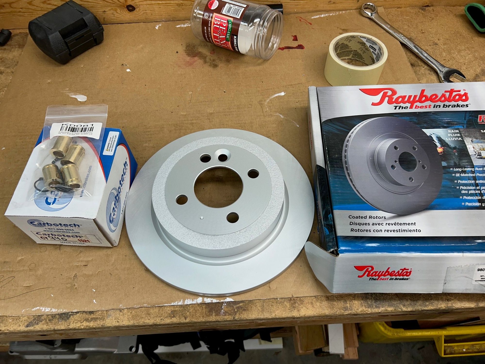

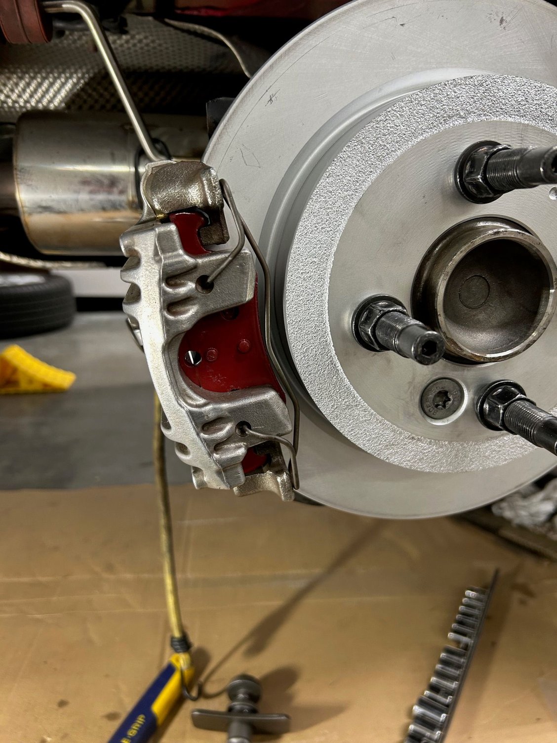

Rear Brakes
Pads were almost done, rotors were getting close, wanted to try some more aggressive rear pads and install the caliper guide bushings I purchased last year.
Over the years I've been focused improving the rear end of the car under heavy braking (long straights into hard corners)
To this point I have replaced the rear trailing arm bushings with poly, switch out the suspension to Fortune Auto coilovers 6k front 6k rear, worked on alignments as well as stiffened up the chassis. My next step is a little upgrade to the rear brakes.
Going with the Carbotech 1521. I change out the front pads between 1521 for the street / XP10s for track days, but I'm not changing out the rear pads every track day. Pressing the rear piston is kind of a pain. If you have not done it before.... watch Mod Mini's video and go slow... you need to get the piston turning before you get too much pressure.

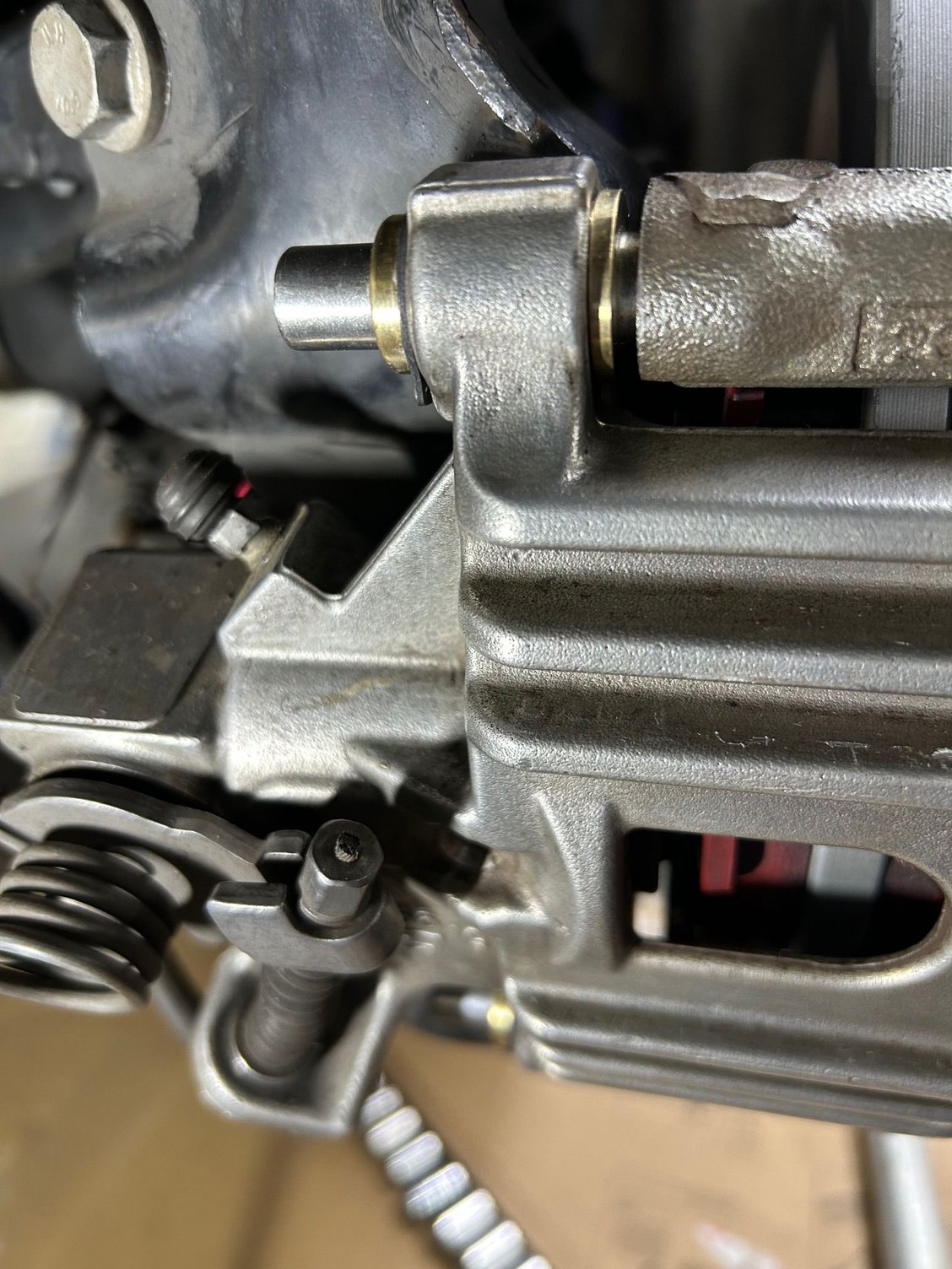

Also wanted to see if these bushings on the rear help with more consistent pressure and even pad wear. I read about the slider bushings from PNWR53s
https://www.northamericanmotoring.co...ml#post4489909
Full explanation POST #2010
https://www.northamericanmotoring.co...ml#post4491267
