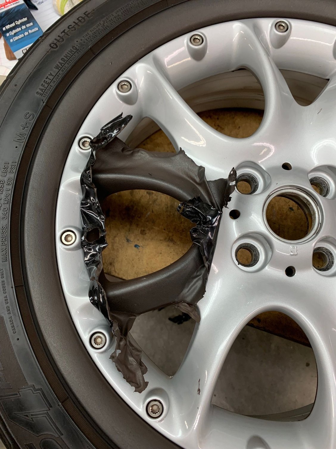

On another subject.... I want to report back on my Plasti-dip adventure.
March of 2018 I painted my wheels with Plastic-dip. I wanted to go black and it seemed like a good idea at the time. After a lot of back & forth and apprehension.... Yesterday I decide that the black plastic-dip was looking a little faded and dingy.... so I started peeling.
Plasti-dip after 5 years.
So I'm very happy to report that after about 2 hours, all the dip was off and the wheels are back to 2018.
Thoughts for those considering Plasti-dip on wheels:
I think the brake pad dust is what made the Plasti-dip dull and dingy. Maybe some sort of clear coat over the plastic-dip would have helped.
Lots of coats of Plasti-dip. When removing it, the thicker the dip was, the better it held together and pull off in one piece. The thinner spots tended to tear away in to small pieces.
Pressure washer worked to get the last of the thin spots.
For 5 years of black and then in 2 hours I'm back to original ...I'd say it was great.
