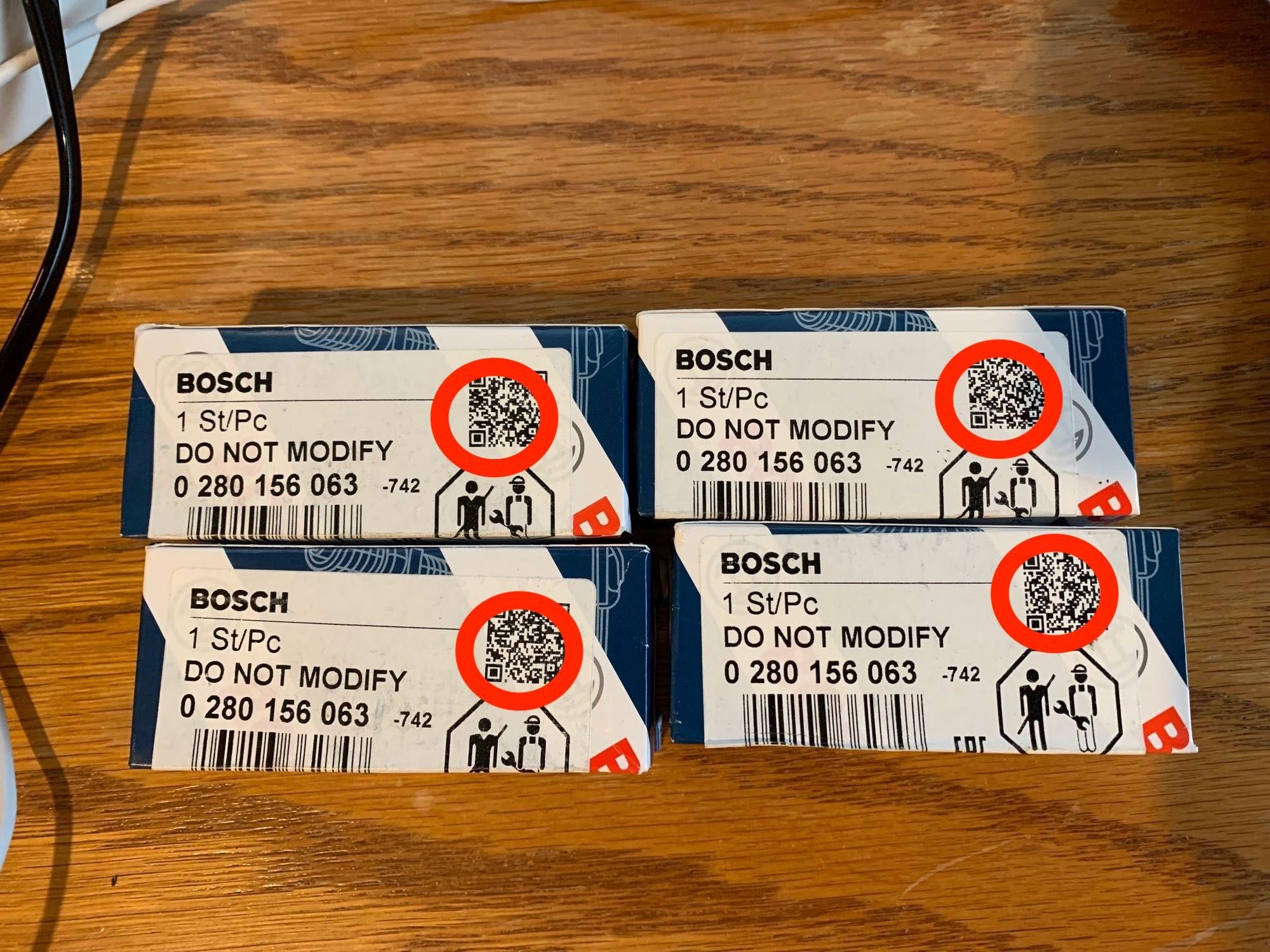

Bosch Injectors
I've been busy with work and forgot I purchased some 380 injectors on Amazon about 3 weeks ago, turns out they came all the way from Germany. I would assume coming all the way from Germany they would not be counterfeit, but I have read about knock-offs so I figured I would follow through with checking them. Hopefully this can help someone else out there.
There's a couple different ways to check.
1) The QR code on the boxes. Just scan it and a confirmation comes back right on your phone browser.
2) Go to www.protect.bosch.com & key in the 18 letters/numbers printed on each box.
You'll get a confirmation just like this.
That easy....
More info here.
http://www.slturbodiesel.com/identif...e-bosch-parts/

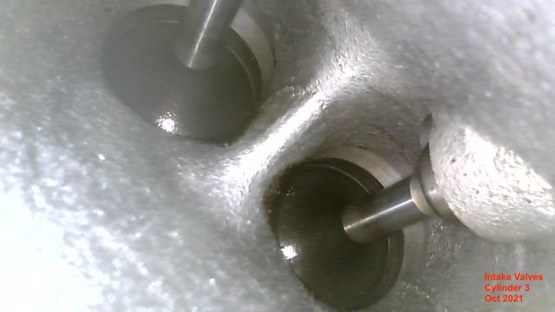

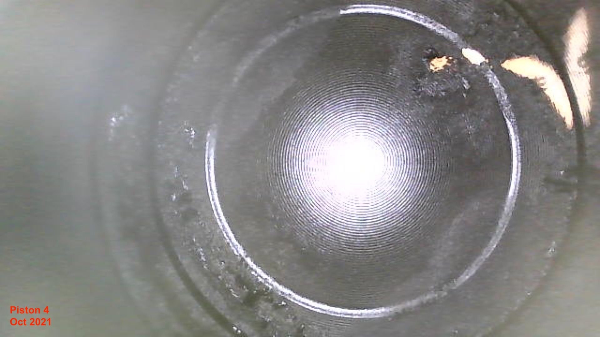

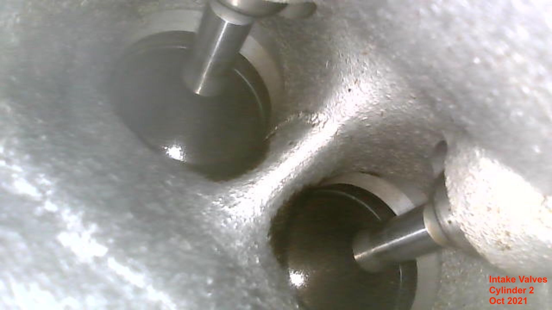

Injectors and Intake valves
380 injectors went in today. (I will post all the details and part numbers here in wrap up post)
For noobs like me... here's a link to Mod Mini for some details. (@5:00 he works on the fuel rail)
Couple notes:
The OEM O-rings can be purchased for cheap and put on the injectors. (BTW these are not the JCW injectors... I think they are Audi TT injectors but I've been told they will work with r53 injector O-rings)
The O-rings that come on the Bosch injectors look very close to the same but I changed them out just to be safe. The top and bottom O-rings are the same so you'll need 8 total.
The 380 injectors are a little shorter than the OEM 320 injectors. But the O-ring seems to be at about the same distance from the fuel rail so it should still seat in the intake manifold. Again I'm a noob here and just noting my observations, please chime in and correct me where I go off track.
After installing, I let the fuel pump run a couple of times and then it started right up. No codes... just ran a smooth as ever.

Bosch injectors 0280156063 $45 per (more info on these about 4 posts back)
https://www.amazon.com/Bosch-280-156.../dp/B00BHJ63MC https://www.amazon.com/Bosch-280-156.../dp/B00BHJ63MC

I have the same Bosch (Audi TT) injectors and can confirm they work fine with the Bosch o-rings too. The OD was identical as far as I could measure. Been running them for over a year now and a full AX season without issue.
I saw these injectors in your build thread last year and made note.... Adriancl confirmed they were the right way to go.

Confession. I'm throwing these photos up for feedback, I really have no experience here and lots of questions.
While I had the IC and injectors out, I took a look down the holes.
Intake valves first:
Look pretty good to me????? But I really don't know what to look for.
Pistons next:
Soooo what is the gold/ orange colored stuff? Too much heat right at the valves? Is the build up around the edges of the pistons bad?
What am I looking at here and should I be concerned?
Thanks in advance.
