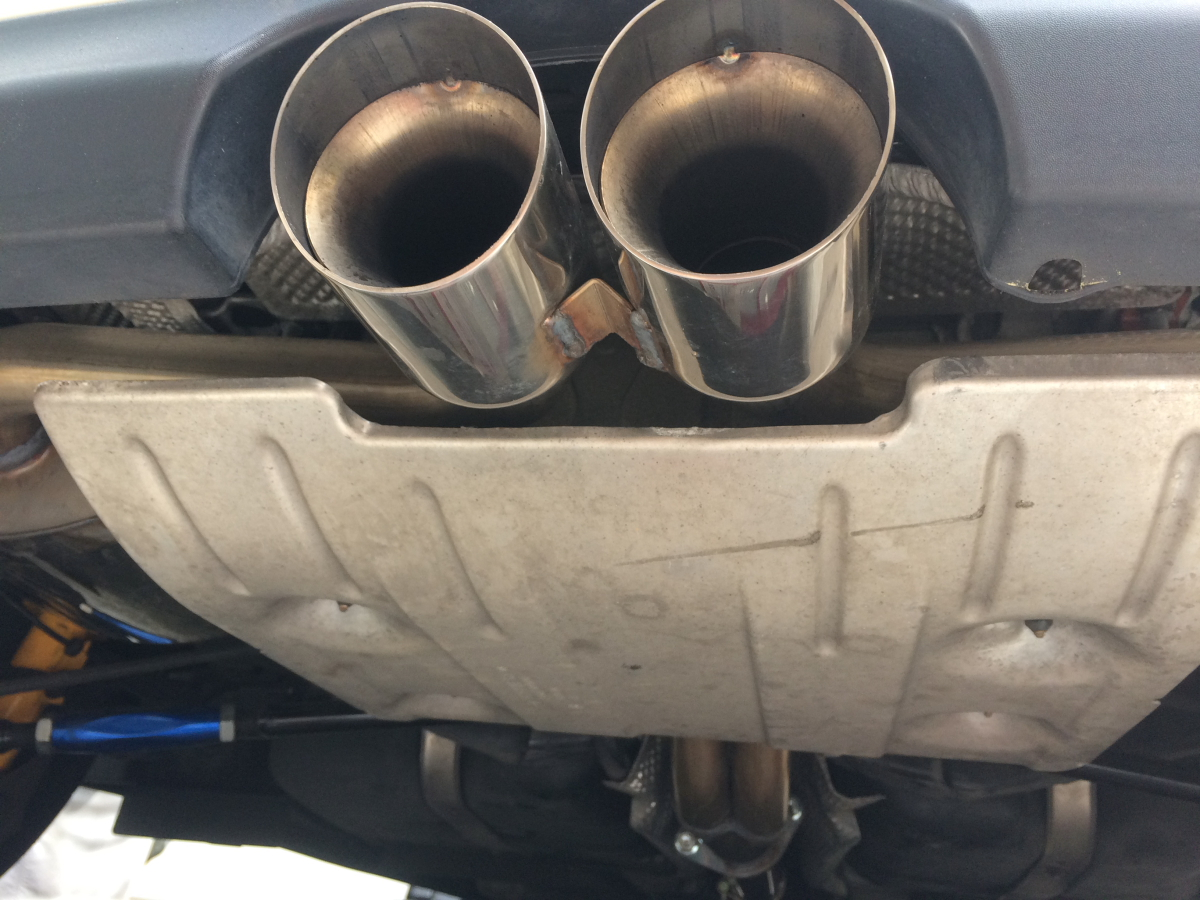

milltek non-resonated cat back
Here are some photos of the Milltek non-resonated cat back installation.
unboxing the Milltek cat back exhaust - it is a non-resonated version
I chose the non-resonated Milltek cat back exhaust for many reasons:
It is lighter than the resonated version
It does not have the resonator under the gear shifter which can get very hot driving on the track
It has less back pressure but is a bit louder
the hanger bars on the main pipe has a sleeve welded on to increase the diameter for better engagement with the MINI shock mounts
a closeup of the flanges of the two section main pipes - for shipping reason
here shows the weld that is done inside the lips of the flanges
all the pieces has a welded on tag showing the part number and country of origin
the two section main pipe mated up - they are 2.5 inch instead of 2.25 inch diameter of the stock main pipe
Before installing the Milltek, I check the back pressure against the stock muffler and the resonator. I also carefully weighed the Milltek compare to the stock exhaust.
the mufflers on the Milltek is tiny
you can see here how small and light the Milltek exhaust is; the reduce weight should be easier on the silicone rubber shock mounts
Before proceeded to install the Milltek cat back system, I carefully weighed all the components of the stock exhaust as well as the Milltek.
Milltek:
muffler - 20 lb 3 oz
straight pipes (2) - 9 lb 1.5 oz
misc hardware - 2 lb (not include two pre-05 hangers)
Total: 31 lb 4.5 oz
Stock:
resonator - 20 lb 14 oz
muffler and pipe - 27 lb 4 oz
hangers - 14.6 oz x 2 = 29.2 oz = 1 lb 13.2 oz
Total: 49 lb 15.2 oz
So Milltek is 18 lb 10.7 oz weight saving. I did blow test on both system and Milltek is significantly less restrictive than the stock resonator and muffler which are in series. I expect the Milltek to complete resolve the heat problem with the stock muffler driving wide open throttle at the track.
I improvise this paper cup to do my not so scientific blow tests
One thing that I was concern initially with the Milltek is the hanger bars. They don't have the nubs like on the stock exhaust to prevent it from slipping out of the silicone rubber shock mounts.
you can see the nubs on the stock exhaust hanger bar
this looks to be a heat shield for the battery box but it is actually an aerodynamic undercarriage baffle; this baffle was a liability with the stock muffler as it traps the heat but it should not be a problem with the Milltek cat back
the one-ball exhaust (left top) and the Milltek cat back (right bottom)
one of the rear shock mount is torn
I bought this German shock mount from a local Mini onwer for $10 and it is very close to the red MINI one that costs 3 times more money
I managed to get the Milltek finished between showers with everything squared up. I initially was very concern how well it will fit. It turned out quite well. As the total length of the exhaust will increase significant at maximum operation temperature (like driving wide open at race tracks) I will need to carefully monitor the potential stress it will put on the rubber shock mounts.
I was most concern with the hanger bars of the muffler adequately engage with the silicone rubber shock mount. I checked all four hanging points at the twin muffler after tightened all the fasteners.
do note that the mufflers will tend to move rearwards the higher the temperature, especially driving at full tilt on a track
Another area of my initial concern is this rear flange. On the stock exhaust there is no flange here so the muffler tunnel is quite narrow for the new flange interface. I knew should the flanges turns out to be too close or touching the aluminum heat shield, I can widen it slightly. It turned out I didn't need to as the entire cat back sit very snugly.
the twin tail pipes centers as well as I could hope for as there is no adjustment if they are not; the vertical space is just right
the skid plate of the battery box got bang up at the track when the muffler came loose; I restored the folded lip in just a minute; call me Hammerschmidt
the skid plate is actually a undercarriage aerodynamic device
So what is the Milltek exhaust like? It give the Mini a lot more presence. It is significantly louder than the one-ball exhaust that I modified from all stock. Since my experience with extremely hot muffler which threatened to boil the battery electrolyte I am now willing to live with a louder exhaust for the benefits on the tracks. With the Milltek not just the exhaust is louder and sportier, there is also an incremental step of more drivetrain vibration that can be felt. It is still very pleasant and not enough to cause unpleasant rattle of the interior. Now one can sense each controlled explosion of the engine cylinders. Also, Mini is that much more British.
