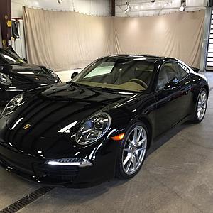

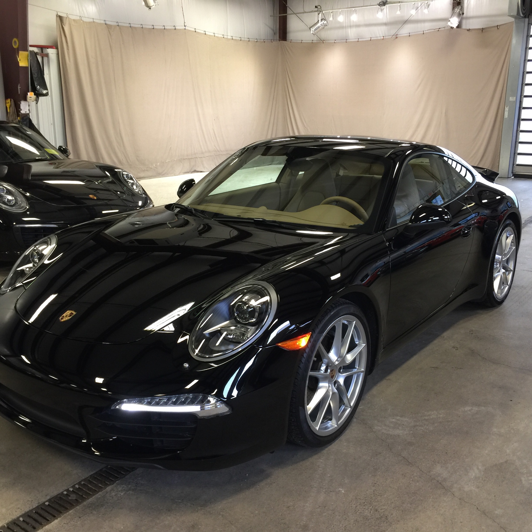

Wow perfect.
Now I have to start dream.
My mini (little booger) needs one of coolworx toys to play with.or my other s after a good detail...but wait mine is tiptronic lol
Ben
Attached Thumbnails 05 pepper white MCS modification project-img_0444.jpg   05 pepper white MCS modification project-img_2234.jpg

Yes it is the 991.1.
Like your steering wheel.
I like my lounge chairs with 18 way adjustable seats
Attached Thumbnails 05 pepper white MCS modification project-20170428_083940.jpg
