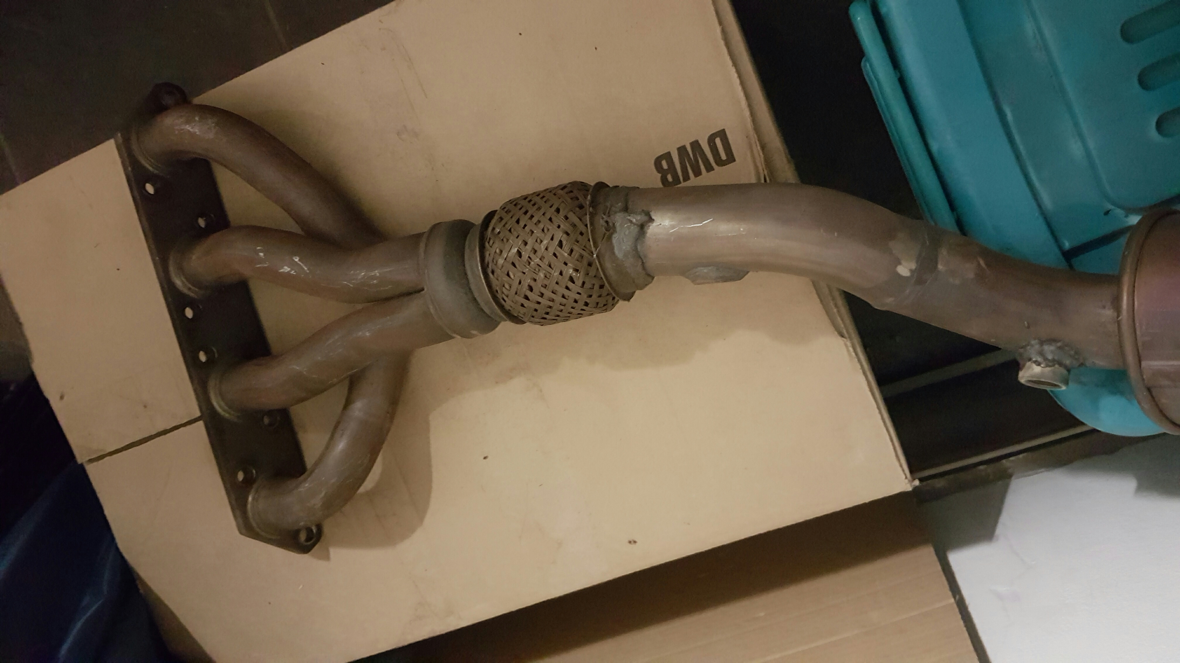

I took a pic tonight of my stock manifold where the sensor bung was welded to give you an idea of where NOT to put it. My sensor got fried very quickly in this location. I will attach another pic as well of the Mynes header and you can see the sensor was in pretty much the same location as where I had the bung welded on the stock manifold, but I guess it goes to show the difference in flow and heat which fried it on the stock manifold.
Sorry to hear the engine mount has caused such vibration. I have a similar issue where some panels are rattling and it's now driving me nuts, I have to pull the panels and add some material to silence that cheap car vibration rattles.
Attached Thumbnails 05 pepper white MCS modification project-20170805_234114.jpg   05 pepper white MCS modification project-20171206_204022.jpg

the stock header bung is too short it'll stick the sensor right into the exhaust flow
I wonder if your WB sensor died because it is too close to the cat. I would reason that at sustained WOT the exhaust gas temperature would be the highest, especially if running too lean. Also I don't expect much temperature different at just post-flex joint, and farther down at worst operating condition - being sustain WOT as the header's heat dissipation is negligible compared to the massive BTUs of thermal energy passing thru.
On the contrary, by placing the O2 sensor closer to the cat, you will add the temperature rise from the cat burning the residue hydrocarbon. Hence the temperature tends to be higher than slightly upstream.
I found the datasheet for the Bosch LSU49. It has operating temperature of 930C. The install note actually advises to install it at where the gas as hot as possible, but observing the operating and max temps. Further it cautions against contamination and condensation.
At this point, based on the drawing I don't see a problem that it would protrude too far into the air stream. I will have better idea when the kit arrive and I would be able to see the sensor and the bung.
