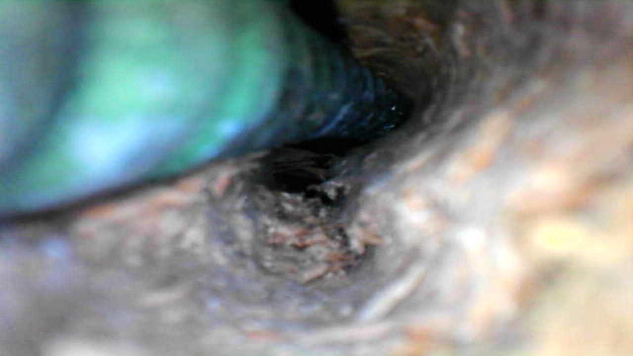

A couple of stills. First is a bit blurry as the end of the borescope was bouncing a bit:
DEPSTECH “endoscope” (borescope) WF010 still picture
Camera was on the lowest resolution.
This second still was taken inside 2 co-joined 5/16” dia holes at the lowest resolution.
Borescope with LEDs at full bright
Thanks for sharing the stills. I infer you chose the lowest resolution because it acts like digital zoom. The object of interest would otherwise be too small to see?

I didn’t give that much thought. That was was the default setting from when I bought it....
I have a video I put together (will put it up on YouTube) where a I upped the setting (640x480 to 1280x720) and it didn’t make much difference in the resolution on the iPad. I think the camera sees what it sees and that is what is displayed on the iPad screen. The still pictures are just a snapshot of that. It seems that the resolution setting is an after thought for video recording. It didn’t even change how it was framed on the iPad, but the picture might have been a bit clearer.

Oh, I should say, also, that the one picture inside the holes does not do well at showcasing how good this is. That view is no where near as good as I saw before the cable moved. When the cable moved and the hole got tighter, the focal length of the lens came into play. Things were just too close and blurred out. Before that, I could see the scratches on the cable that the drill made. I tried to make up for that lack of quality with the Craftsman shot.

even by dissecting it was very difficult to see the failing magnetic winding that is hair thin as it has a lot of epoxy securing the inside
here is the happier time using the scope to help develop a home made smart multi-function automotive gauge using a game joystick for user navigation
Last edited by pnwR53S; Jun 28, 2019 at 06:53 PM. Reason: lost a huge amount of text and many photos while writing it
