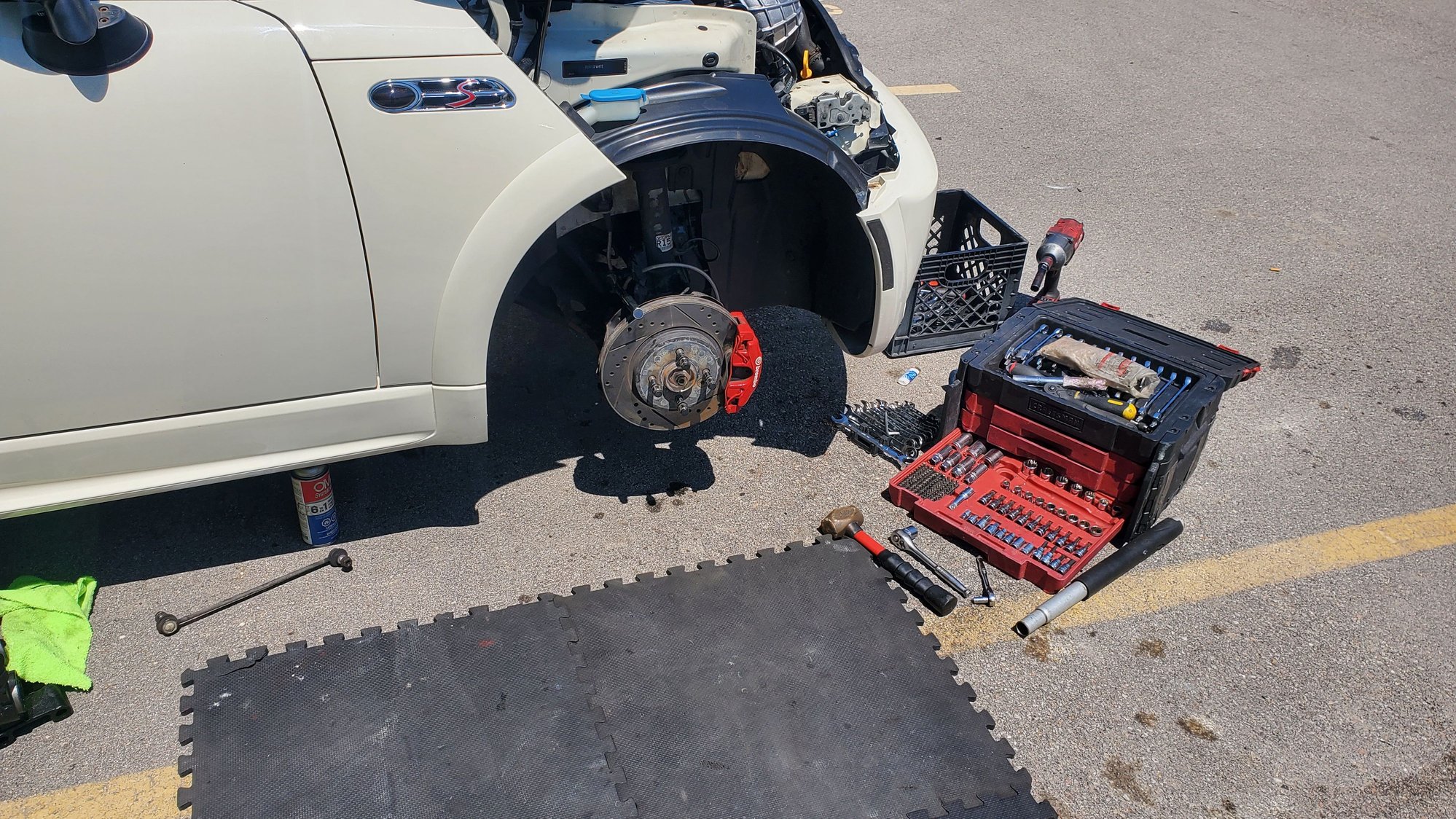

What a pita , lol... it was going ok until a bolt snapped in the knuckle..
ille try drilling it out tomorrow ifnot ille just order a used replacement..
I had a hell of a time getting the control arms into the control bushings. I had to grind abit of the inside bushings were oblong shaped and was IMPOSSIBLE to press on. So that took a bunch of extra time... unfortunately ille have to go back at it tomorrow's and get as far as I can without that knuckle.
i also hope I set the preload tension correctly on the rev9 coilovers because of course there were no instructions. My luck I got them too stiff and ille have to completely reset them while there on. Ugh..
I found the cause of the clunking on the passenger side too I believe. The strut mount has a big crack In it...i SHOULDA just seen that and through in JUST the coilovers and not opened such a big can of ****.
awe well. This is the mod life rite ????

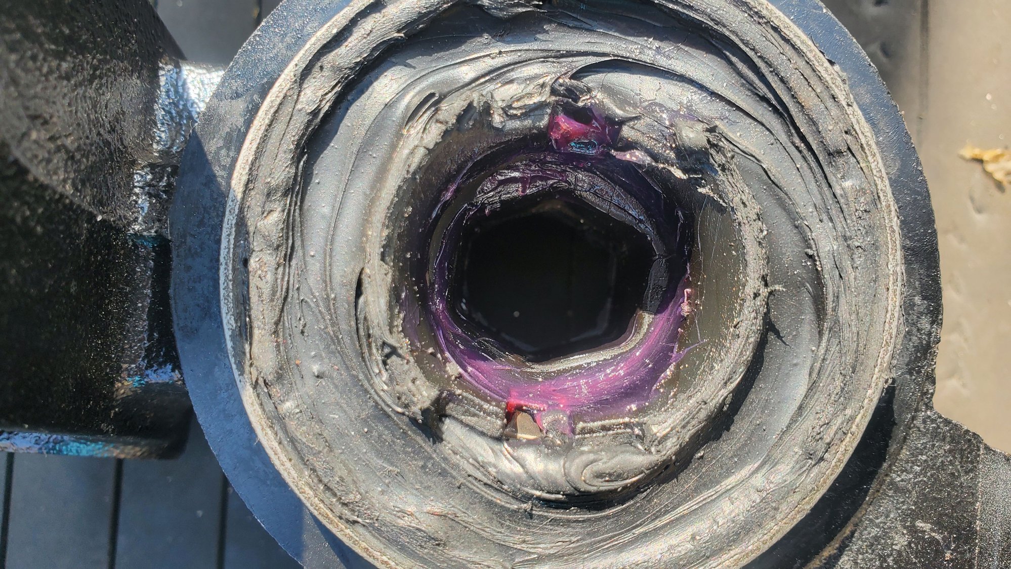

Again , I'd like to thank megadan for helping me out...
I needed a knuckle and he had one so I didn't need to wait on shipping and was able to continue on working..
buuuuuut I went to inspect the axle bearings because the boots have been torn since purchasing the car aaaaaaand their JUNK. SOOO new axles and lower strut mount bolt ordered.
maybe ille do the rears tomorrow since I gotta wait for the other stuff to get here anywaanyways.. lol always 1x step forward and 2x steps back when working in these cacars.. but it's expected so it is what it is... no pain no gain.

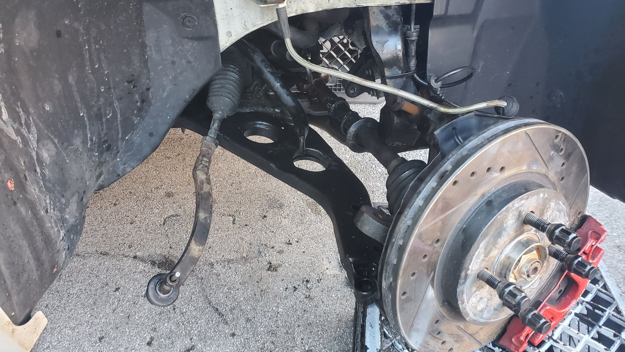

Control arm bushings : Am I seeing that right or are my eyes playing tricks on me?...
How did you manage to pull the control arm brackets without removing the subframe?
Or is it that you only dropped the subframe halfway?
Greatly appreciate any insight. I'll be preforming a complete refresh on my front end in a couple of weeks and I kinda dreading having to entirely drop the subframe

Dropping the subframe is really only a 45 minute activity, and can be done with the bumper on if you remove the shocks separately. This makes doing LCA, tie rods, and...everything else much easier. I've never done LCA bushings in-situ and they can be such a PITA even with the subframe out that I've never even considered trying it.

yes , I only dropped it half way , I lowered it on a jack just far enough to remove the control arm bracket/swaybar bushing bolts..

so I coulda left the crash tube attached ??? I just assumed they had to come off when lowing the subframe.

Nope, I'm an idiot. I was preoccupied and was confused by some of the 'uniqueness' on the last vehicle I serviced. Bumper skin and crash bar have to come off to get the crash tubes off. But radiator and shroud can stay on and coolant can stay in. Sorry for the confusion. STILL super easy and I'll buy anyone some of my favorite chicago dogs from Sammys if they can find a quicker method.

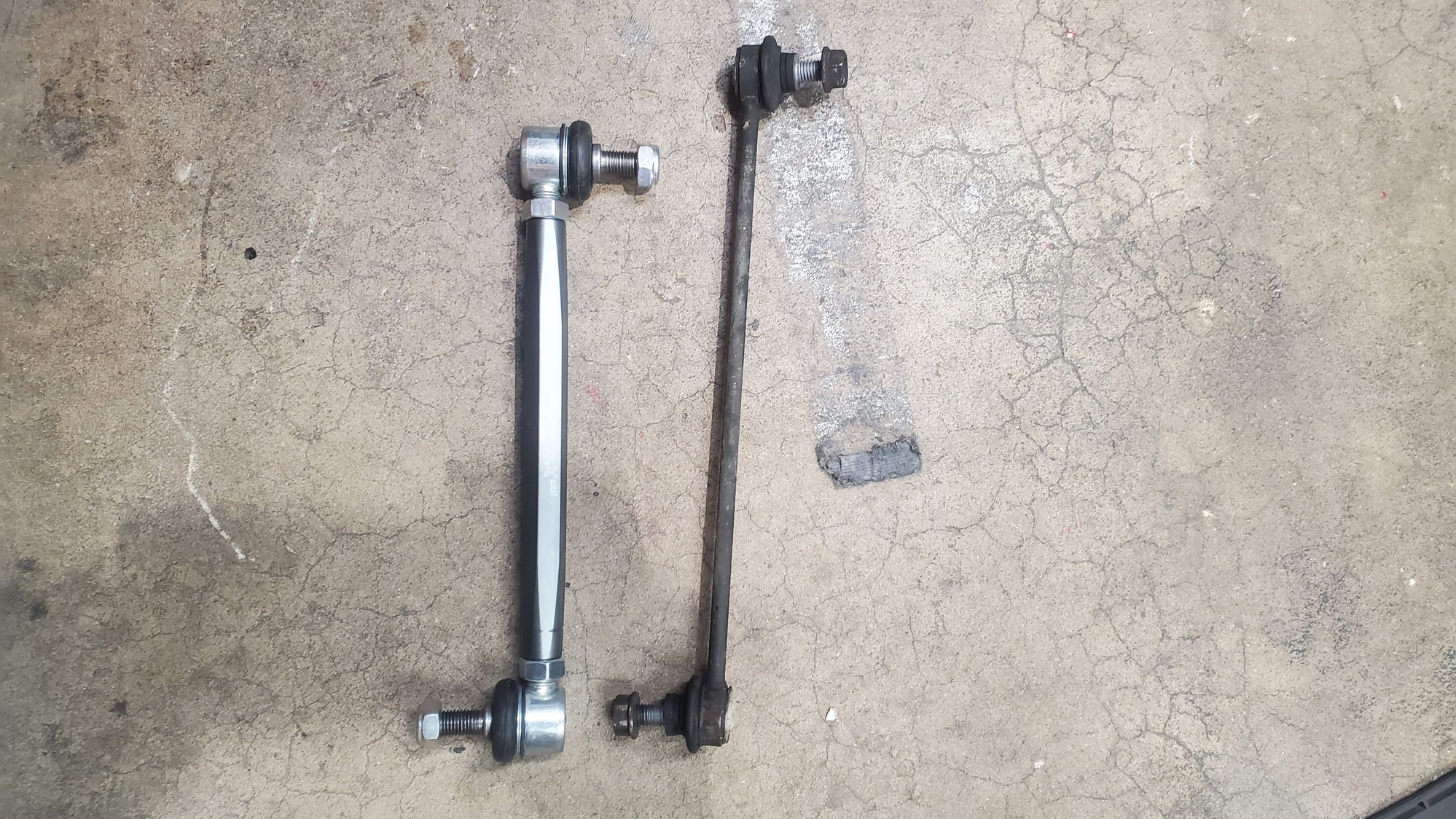

I got all 4x corners pretty equally set but ad it settles I will have to readjust them one last time.. lol I onky jacked up n lowered the car probably 40x today.. lol I'm BEAT.
BUT the tesla endlinks I ordered ended up working out awesome. It took minor modification to the inlets to accept the larger bolt end on the links but totally OK to save 50% and get a much beefier end link then too.
if I have time I'm hoping to finish the car tomorrow and limp it down the block to the local car show as it's memorial day show and it's their biggest all year. I'm already going to be taking the grey mini but I'd really like to get this one there too as i know most the people there as its alot of local peeps.
anyways here's how it's sitting sofar guys.
Check out how well the end links fit too !
O yea , lol i HAD to install my 5mm spacers but i wanna buy as think ones as i can because the tires only need about 1mm of clearance because they're so fat. Lol they were rubbing abit.

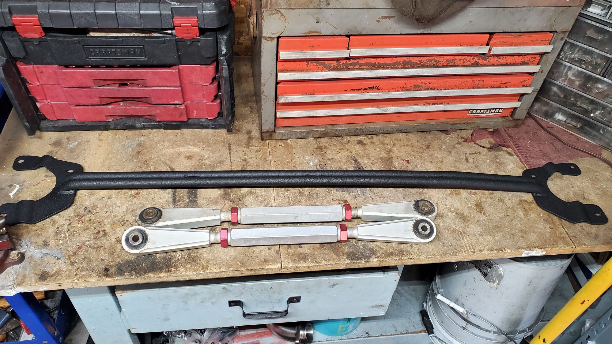

Scored a few goodies off a mini in the salvage yard..
my 421 headers from summit also came so ille have to get the new style collector welded on and wideband bung. I got a full wideband kit to install out of my other mini because i put in a wider sweep aem one in that car for when it goes e85..
I had to do so percussion maintenence on the strutbar to get it to sit down flush. Then i sanded it , sandblasted it , anti rust coated it and then hit it with some black wrinkle paint and ille clearcoat it tomorrow. I also snagged 2x sweet rear adjustable control arms but unfortunately the other 2x were snapped from the crash ..
I pulled the aftermarket taillights off of it to for my buddy, they were the exact ones I have on this car.
I got the control arms and strut bar for well under 100$ so I'm happy even with the little repairs I had to do.
I been setting thr cpilovers too , i got all 4x corners where i want thwanbut i need to ad some more pretension because i want it abit stiffer of a ride still. Though its abit stiffer than stock rite now i have a spefic stiffness i prefer.

Wow, that must be a brace from 2002 era. Most of those companies are no longer around.
I was guessing it was old by its condition.. i also couldnt find any info on it so I don't know if monster mini was the brand name or what. It's definitely a heavy-duty bar ille give it that but it's gets a 0 for style points...lol it's ugly imo but itle serve its purpose well.

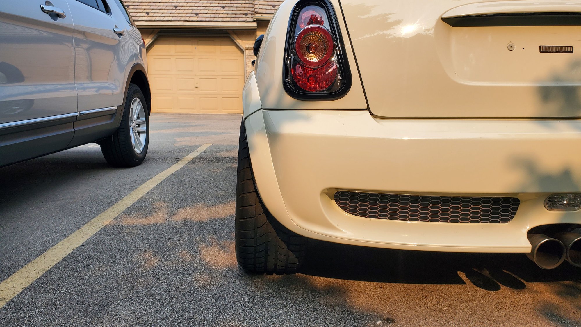

So I just couldn't get the rear end to sit perfectly even. The right side always wanted tl sit higher unless i set the coilover way lower but that wasn't the rite way to do things..
so I said " might as well put on the adjustable rear control arms because I might need to adjust it around that then " and once I did.. OMFG , these can't be normal, look how squiggly my 2x lower rear control arms are..
I set the adjustable control arms both side at -3 degrees of camber only but that enough fir a dailydriver. And wouldn't ya know it ? the rear end sits level now.. so ima let it sit over night and settle and test drive it somemore tomorrow and see if I need to adjust anything more or if I got it as good as I can and then it's time for it to get an alignment.
I also swapped on the alta intercooler I had onto this car just because the grs motorsport looks much better on my other car.. they perform identical actually. They're the 2x best air to air intercoolers I've tried yet and I've tried A BUNCH of different ones now.
