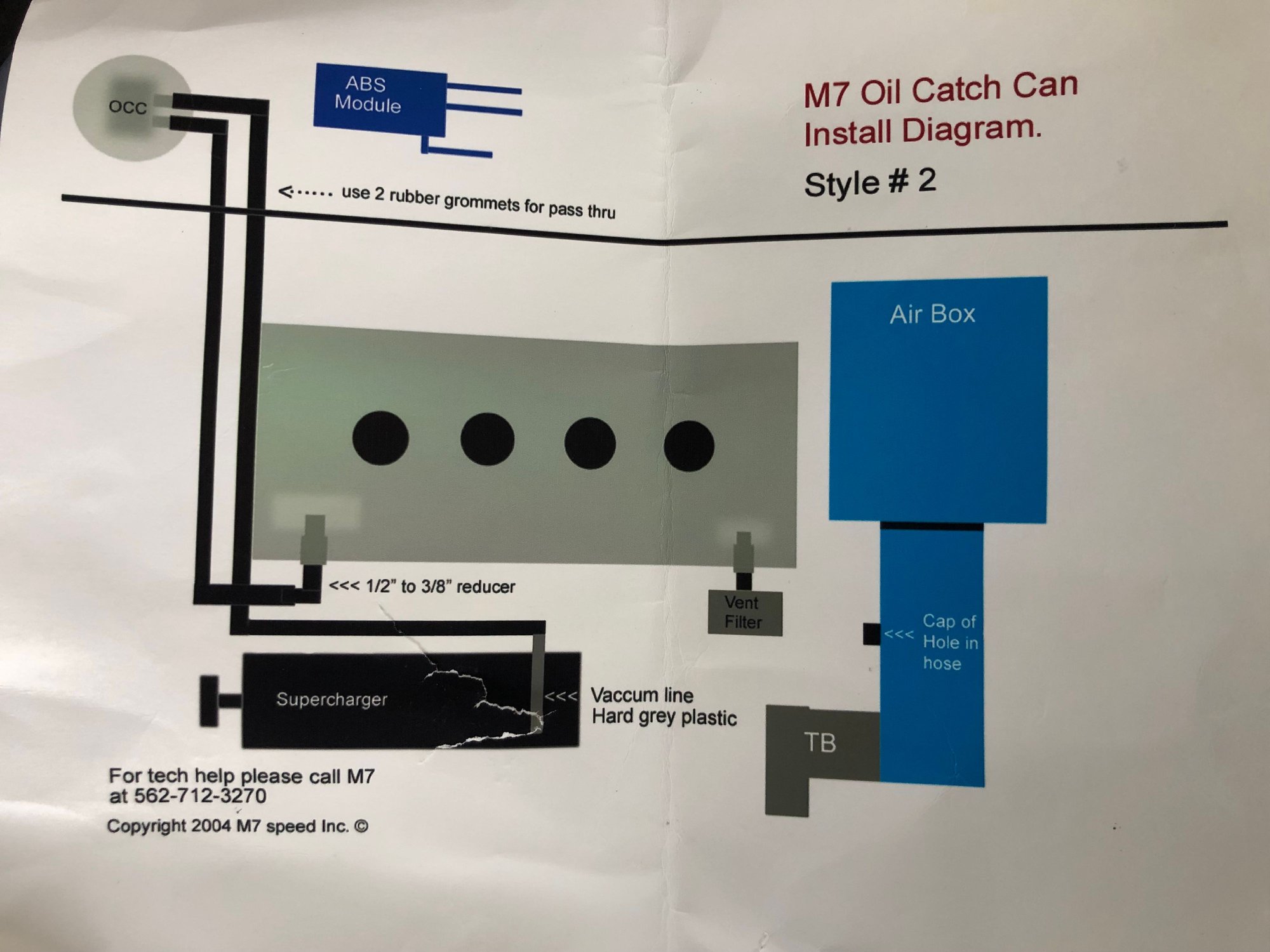

Old Dec 10, 2023 | 05:57 AM
  #204
MiniManAdam's Avatar
MiniManAdam
Community Builder
Joined: Jan 2020
Posts: 5,272
Likes: 709
From: OakCreek
Well , this cold weather has caused abit of an issue..
ANY HELP would be MUCH appreciated.
So here's the issue , then I will explain abit more..
either I have a p0302 occasionally or a consistent p1498 end eml light. Ille explain...
Either I run the car WITH the oilcatch can on and i seem to be getting an excessive build up of condensation in my purge hose going into my intake along with under the oil cap , it will then occasionally throw a p0302 code for cyl2 missfire. I changed plugs,coil and injectors and no change. Cleaned and even tried change both map sensors also no change. I also smoke tested the engine and found no leaks. Also tried a different throttlebody with no change. So I try removing the catch can and running stock vacuum line routing BUT as soon as the catchcan is removed and I start the engine the eml light is immediately on and it throws a p1498 code.. then if I do NOTHING other than reconnect the catchcan , the p1498 code and eml light goes off and I won't get a cel until the random p0302 comes up ,which only seems to cone up IF I let my car idle to warm up and give it NO throttle input. That's the only time I seen the p0302 code come up was at idle. It idles glass smooth too.
my vacuum at idle is 14-16hg and when in gear it goes into the 20s. Car also makes 17psi...
the OOOOOOONLY thing I can think of is I have a post lift ecu with a gp tune in this 04 pre facelift car.
I wonder if it has something to do with the ecu parameters not matching up with the 04 sensors or something... idk ????..
anybody got aby ideas ????
I got an entire new gasket kit , I will be redoing every gasket on up besides head gasket. I also got new fuelinjector Orings too so once I'm doing that I can further inspect vacuum line routing then too.. because it's just not making sense why I'm getting 1x code or the other. And idk why reinstalling my catch can would prevent the p1498 and eml code , you'd think those codes woukd come up WHEN I PUT ON the catch can , NOT remove it. Because that is am unmetered air code and I'm literally removing potential vacuum leaks by removing the catchcan but it's doing the exact opposite..

Old Dec 21, 2023 | 08:15 AM
  #210
Whisky B's Avatar
Whisky B
Joined: Jul 2007
Posts: 181
Likes: 36
From: Missouri
Just a guess, but the colder weather may be over-pressurizing the system just enough to set off the EML, those sensors are sensitive. My experience on installation was the same after the first test drive, problem was too much ventilation (was running two breathers instead of one). In your case it might be just the opposite, since it's now running in cold conditions (boost increase), you may actually need to add a breather to the clean side. Also it looks like you're running an air/oil sep instead of a can, which is a lot smaller and can definitely create increased pressure on the dirty side. Nothing wrong with that, but it will send more oil vapors over to your clean side which could be the actual problem (p0302). You'll need a cap (Dorman 02254 with 3/4" iDiameter)for the intake tube and something like the Predator 12mm air filter for the hose, this goes right on to the existing connector. Amazon carries these but your local car parts store may have some on the rack. Definitely not a big deal, but not the sort of thing you want to ignore as it will only cause more probs over time.
Old Dec 21, 2023 | 09:32 AM
  #211
Whisky B's Avatar
Whisky B
Joined: Jul 2007
Posts: 181
Likes: 36
From: Missouri
Here's an old M7 diagram for reference sake...
