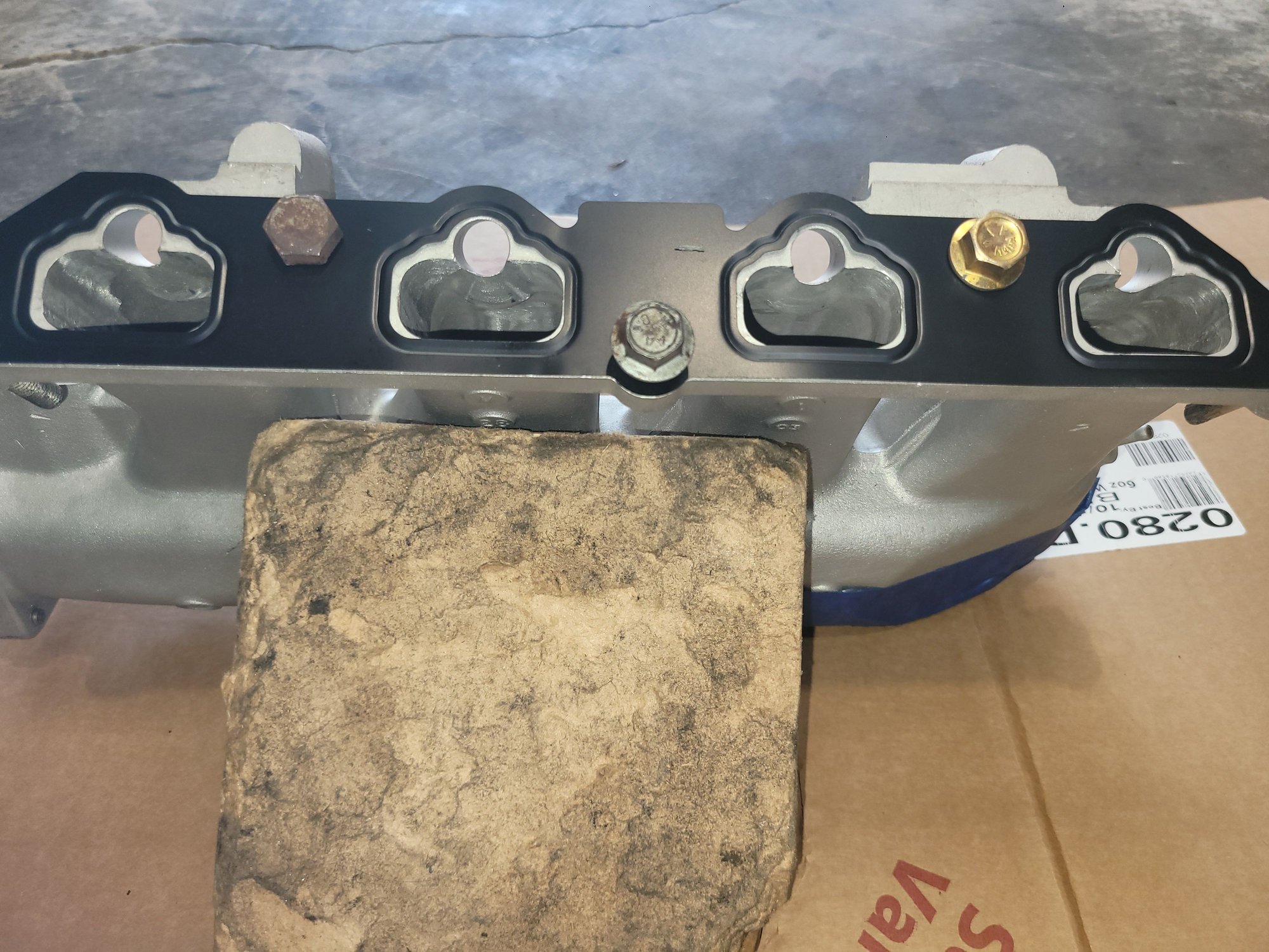

I got the Manifold ported n polished. I ported it , then media blasted it and then finished it off with 1500grit..
it turned out fricken excellent !
I broke the trigger on the ghetto ebay blastergun so I had to run to harbor freight and grab another one which is actually much better quality, I also grabbed a bu ch of ncw fittings so all my air tools that I never use have the exact same fittings..

Damn! You went to town on that manifold! What are you using? I tried a little with a rasp bit and some stone bits but I think I need some better quality bits to make any impact.
Old Jul 15, 2023 | 06:05 PM
  #138
MiniManAdam's Avatar
MiniManAdam
Community Builder
Joined: Jan 2020
Posts: 5,276
Likes: 709
From: OakCreek
I have multiple different lengths and sized tungsten carbide double cut and single cut porting bits , similar to what's pictured below..depending on the angle or depth of cut determines which bit I use..
I also have a mixture I spray inside befor the bits start every time and i dip the bit in it too every time I remove it to keep it cool , lubed and not clog up with aluminum material ( which can be a pita if you overheat the bit and not clean or lube it , itle wreck the bit with minutes)

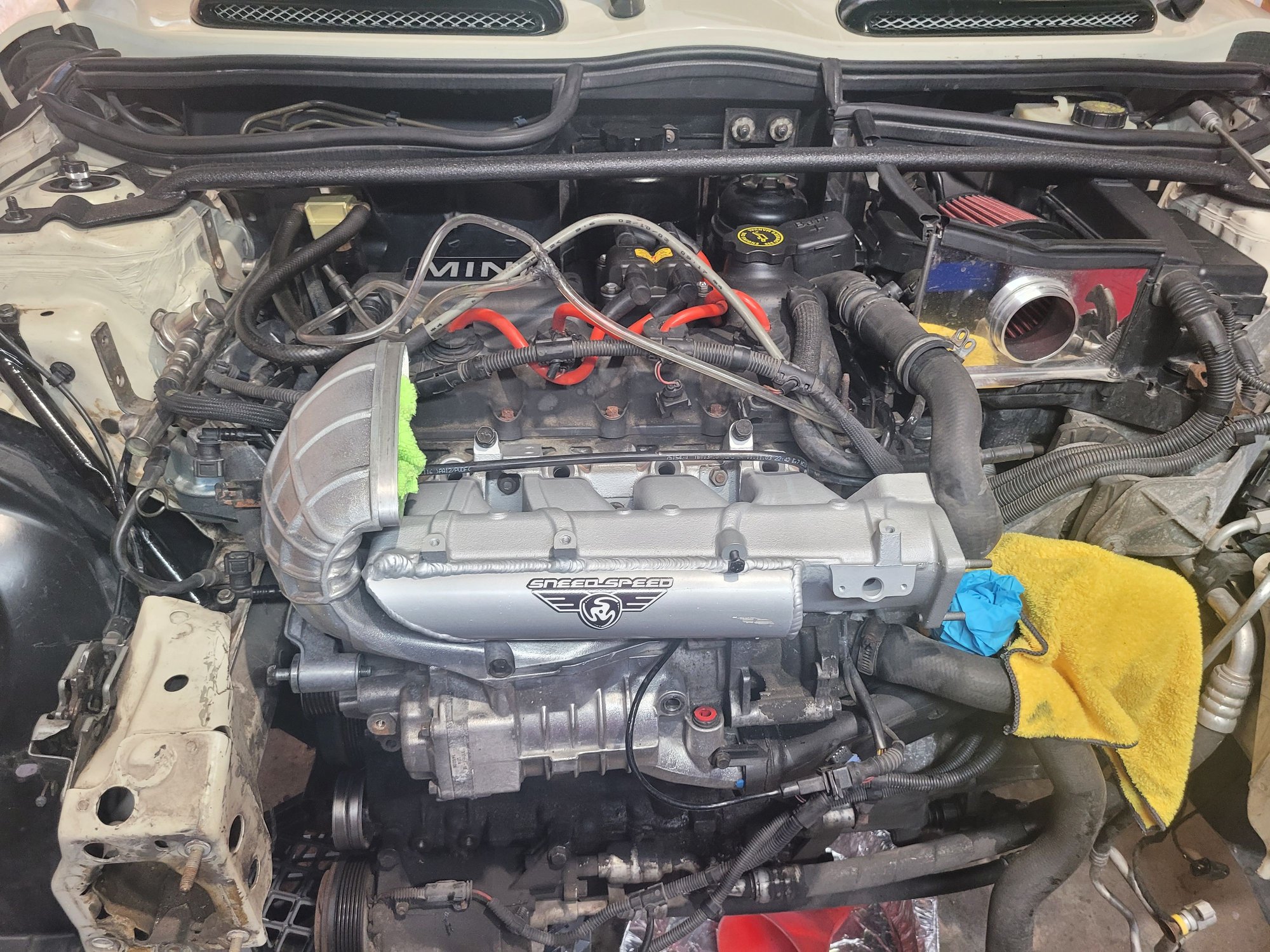

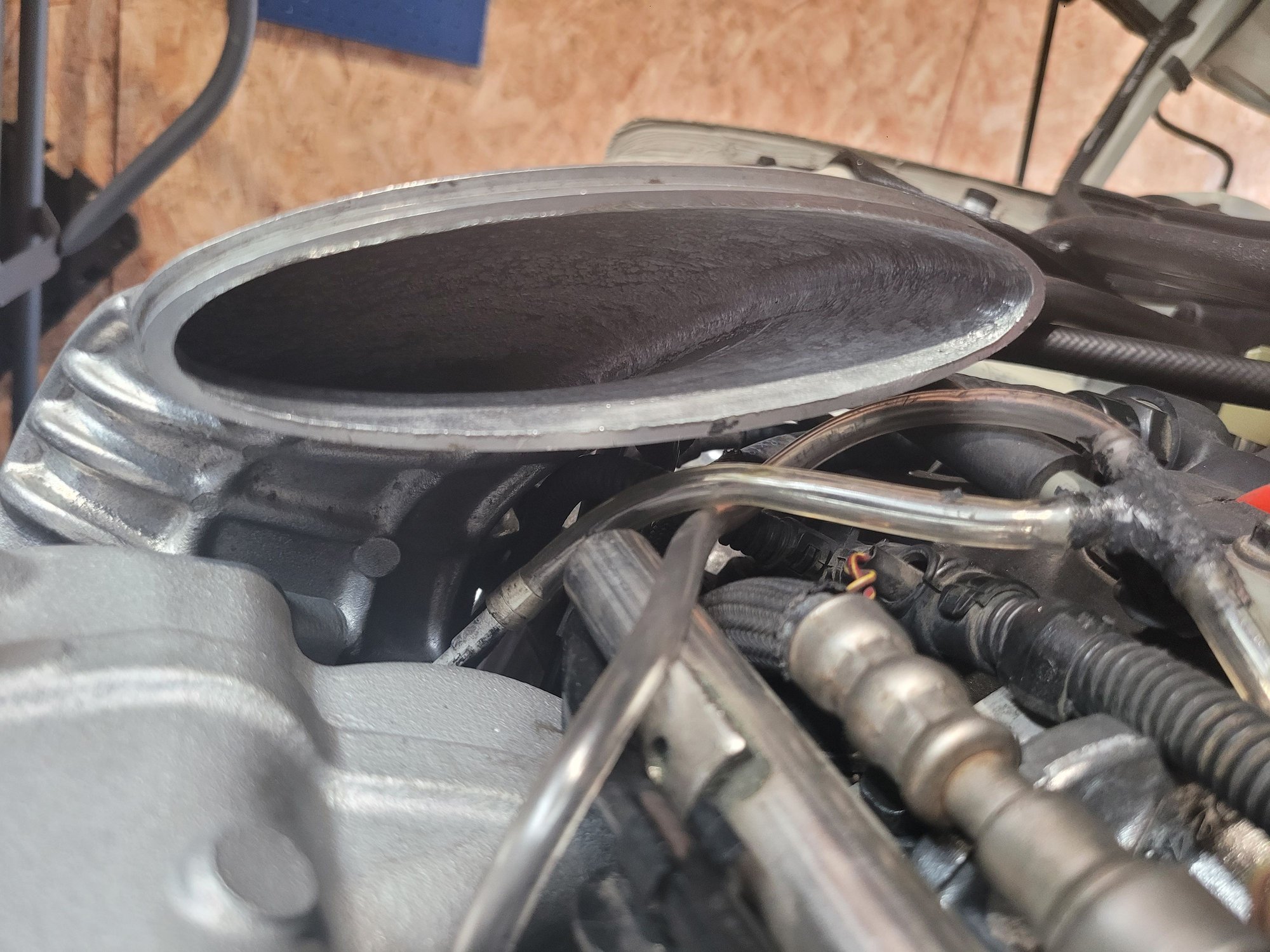

Got on the sneedspeed intake Manifold and I FORSURE verified the the CAR DOES HAVE a remanufactured engine AND I don't know how I never knowticed but it is a post facelift too judging by the pcv style. Also the alternator looks to be pretty new too , I guess when I did the clutch I was too busy to notice...
BTW you CAN remove the intake without removing the sc , well atleast fully. I removed all it's bolts but left it the waterpump so I could pull down the passenger side corner enough fir the intake Manifold to clear..
I had 1x issue..I ruined 2x top fuel injector Orings and when i tested started it WOW , fuel EVERWHERE ! i had a huge puddle under the car and got the pleasure of smelling it the entire time I fixed it but atleast it was a quick fix...
anyways here's pics...

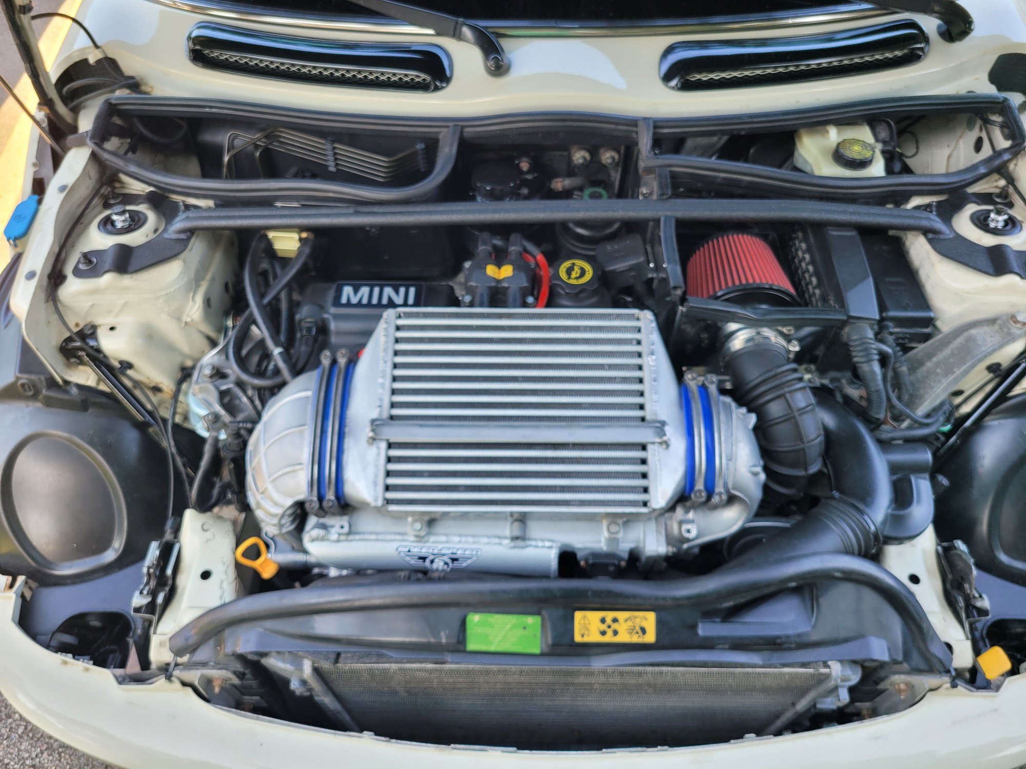

Daaaaaaaaamn I can't BELIEVE how much power this car just picked up..honestly, it's not much less than my fully built grey mini now..
just swapping to the ported sneedspeed and grs motorsport ic it made a HUGE difference. It doesn't make any more max boost BUT it runs cooler and hits max boost easily.. i just cant believe how much faster it is..it now has almost NO traction in 1st gear if i go wot and am above 10mph , it just lights up the tires like a fricken monster...
I'm just blown away how much these 2x things helped. And it already had a ported Manifold and upgraded ic too but these 2x are just , so , much , better...

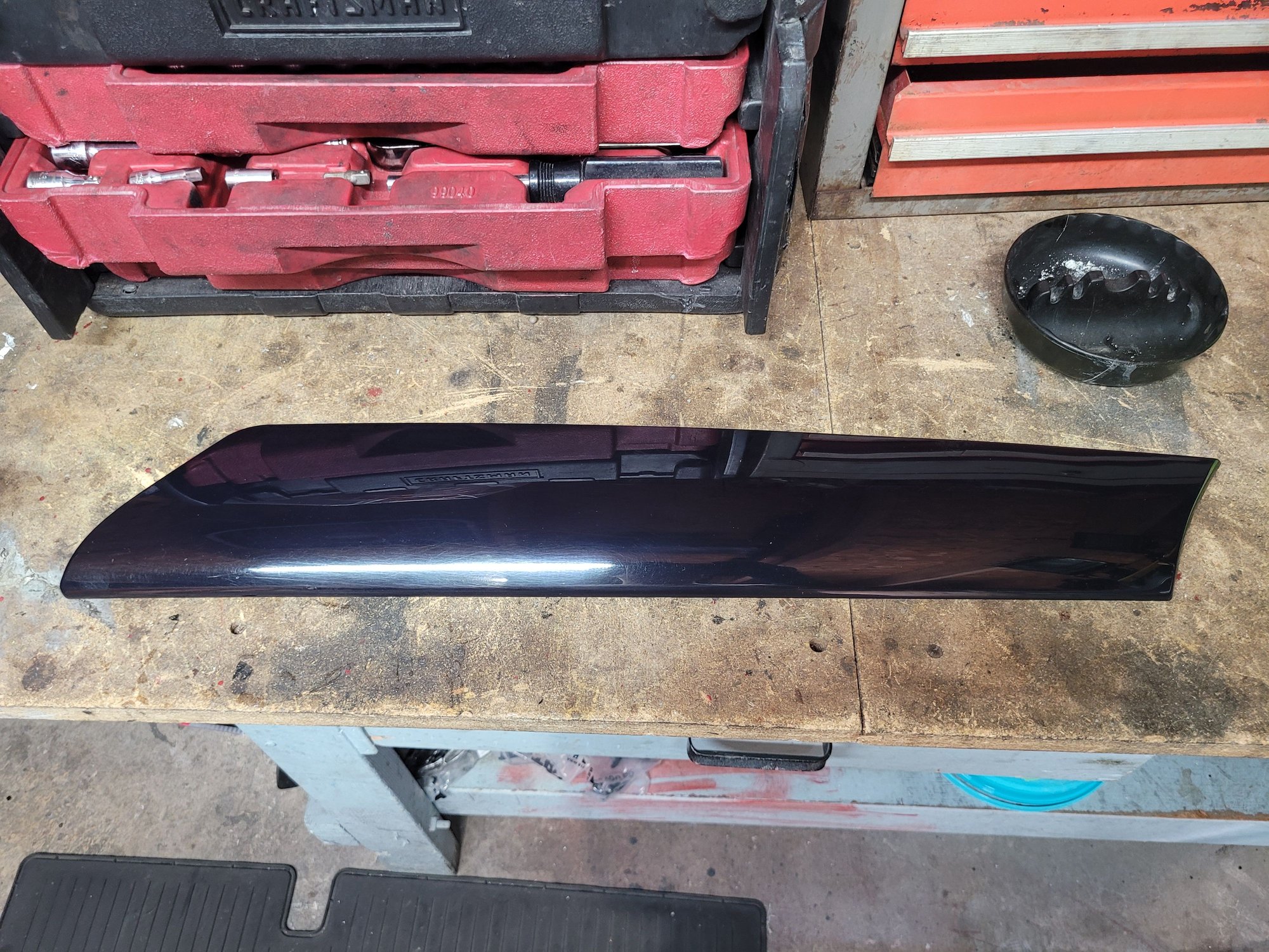

I finished the chrome delete finally by doing the under window trim and installing r50 side scuttles..just waiting on parts to arrive to take this baby up another notch...
