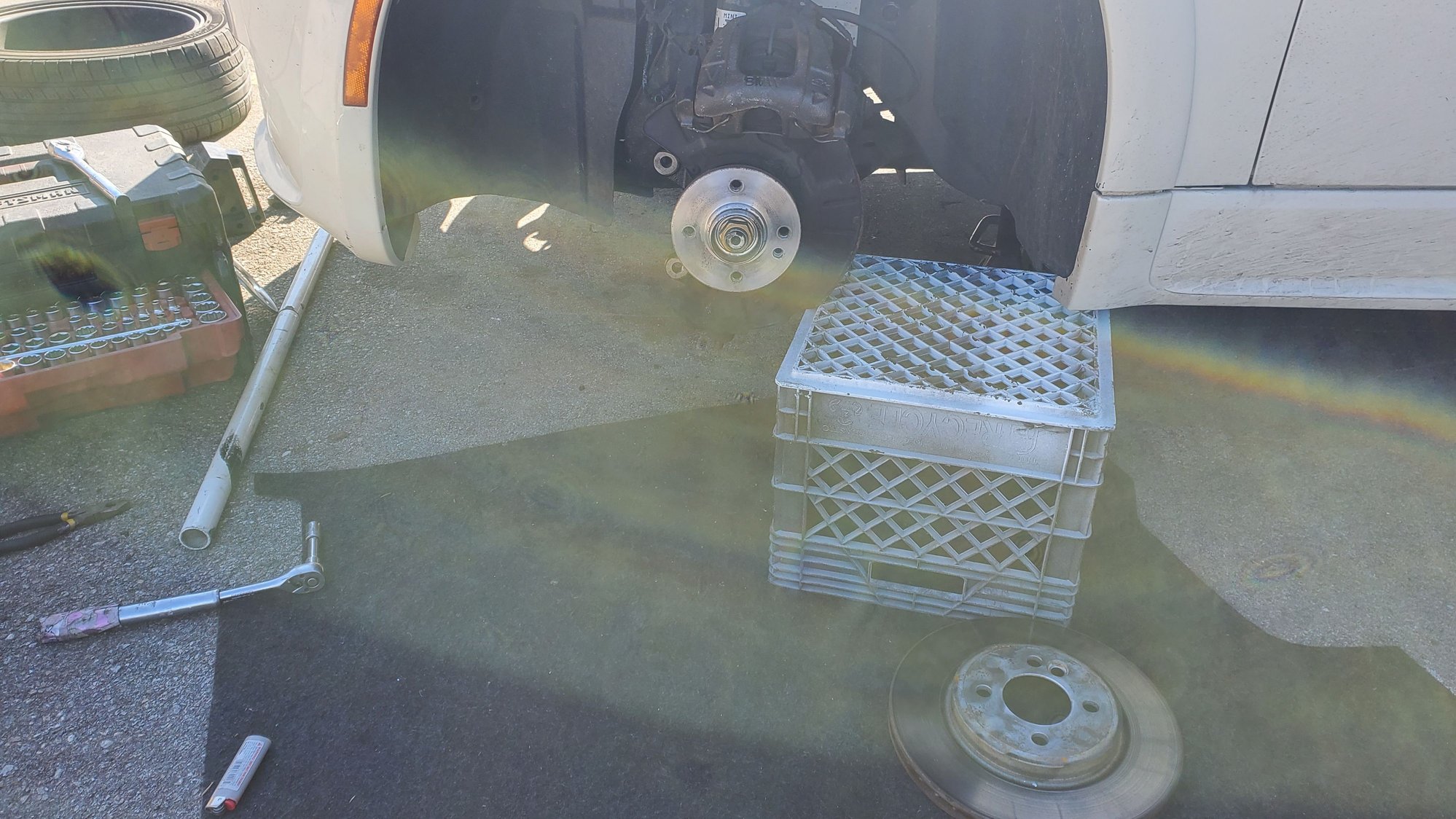

I replaced the front hubs today and put on the correct sized new spacers, hubcentric rings and extended lugs. I cleaned up everything under there too with a wire wheel and cleaned the sensors and their housings. When doing so on one side I seen the prior idiots forgot to notch the axle retaining nut. I also then put on my performance rotors i had left over from doing the r56s brake swap on my other car , im glad they never sold now,lol.. i will put on the ss brakelines too soon because im grabbing my buddies powerbleeder today . So hopefully i dont fight the bleeding after installing the lines because i alhave to bleed my other mini too because it refuses to bleed all the way the ghetto method.
so once i buttoned everything up i fired the car up AND the lights turned off like they always have. Which was no surprise because id moved it a few times just around the patking lot and its not a distance enoygh to reset the lights. So I drove it around the city fir about 45min AND THEY NEVER came back on.. saweeeeeeet. Now I have no dummy lights on in the car at all. My abs and traction control work once again because I DO prefer my abs working though I don't care if traction control is or not it's still nice to have it there if I need.

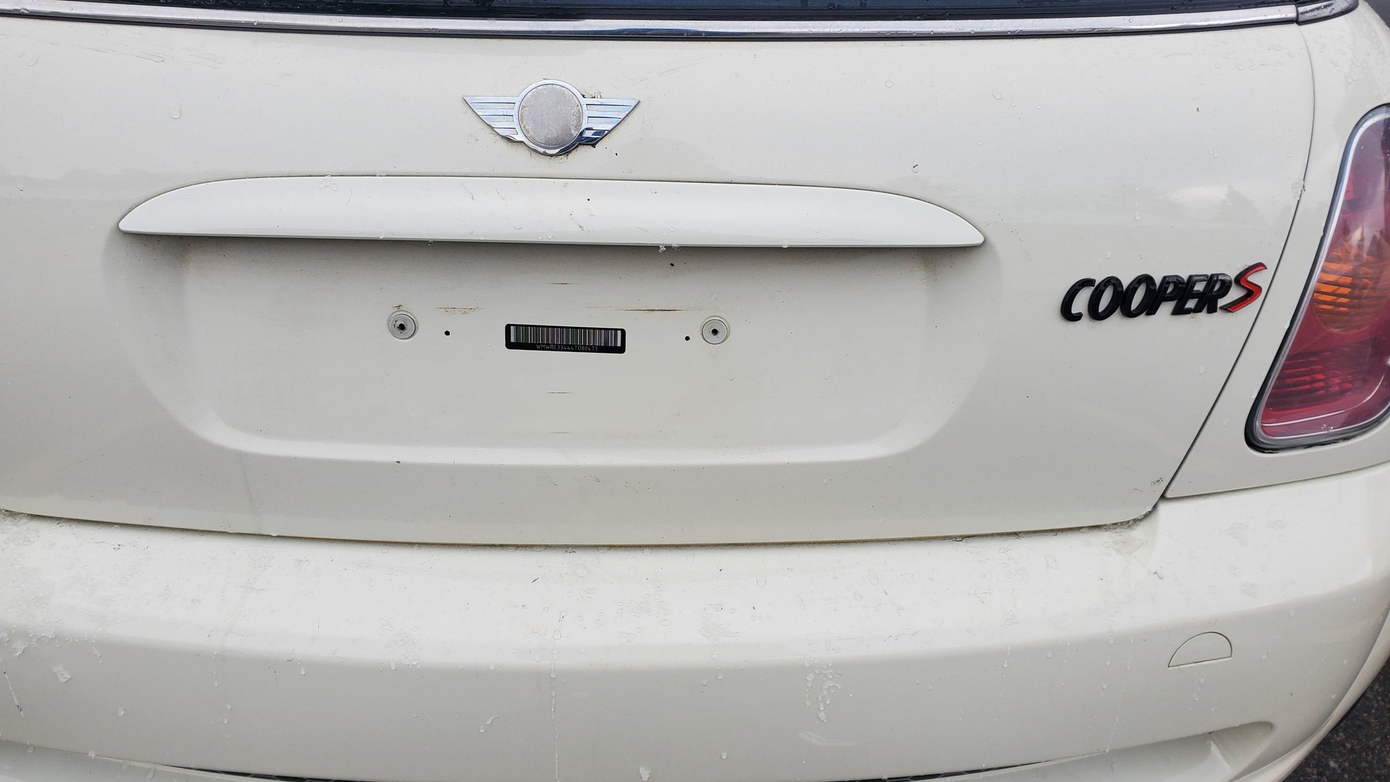

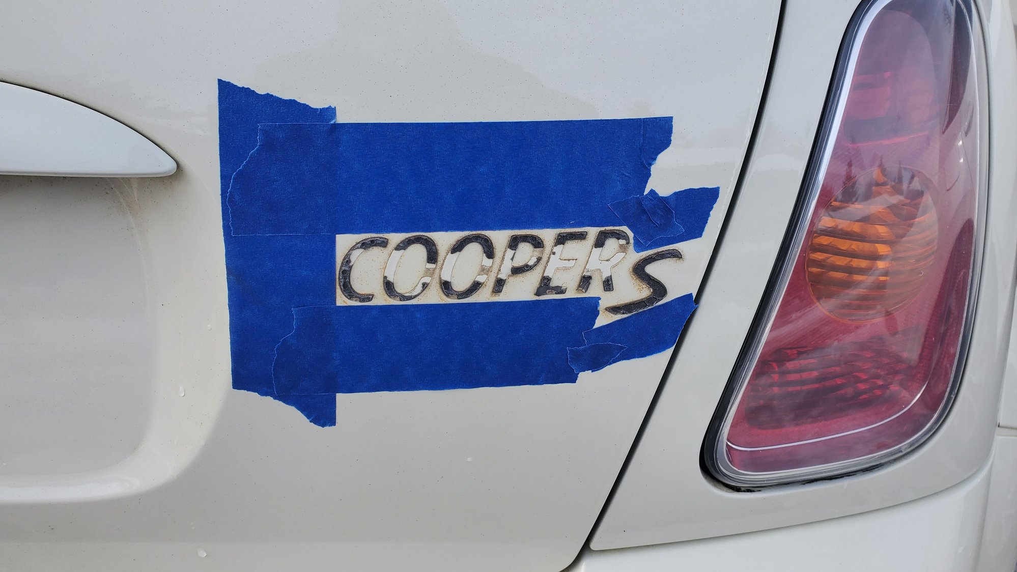

Replaced stock reservoir with a cheapo ebay one because it matches and goes with my black theme. I won't be replacing the p.s reservoir unless I find a black one that matches well.
I also removed the rear logo cooper S and replaced it with a blacked out one and I put on the black gascap cover.

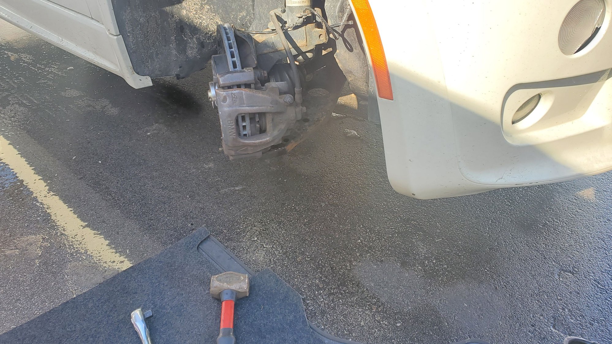

Put in 2x new outer balljoints. Then I let out about 10psi of each tire and evened them out..wooooooow , the car drives sooooo much better. No clunks , no more harshness going over bumps..I can't wait to get coilovers on this sucka. I'm going with the same ones as my other mini , rev9 hypersteet2.
Durring test drive i rolled into 2nd and went full throttle upto about 110mph and the car pulled PERFECT. ITS surprisingly fast actually, it's not much slower than my almost fully built r53 BUT ONLY 80mph and below. Anything above 80mph my other mini makes this one look like turd..buy having stock cam n sized valves is keeping the Low-end power there. The lightweight flywheel also seems to help ALOT as it's rev happy. And the clutch has 0 slip ,even when slamming into gear at high rpm high-speed. My other cars clutch has yo be on its way out. It feels so stiff in comparison and it's bite isn't NEARLY as good. So I'm putting this exact clutch kit into my other mini cone nicer weather.

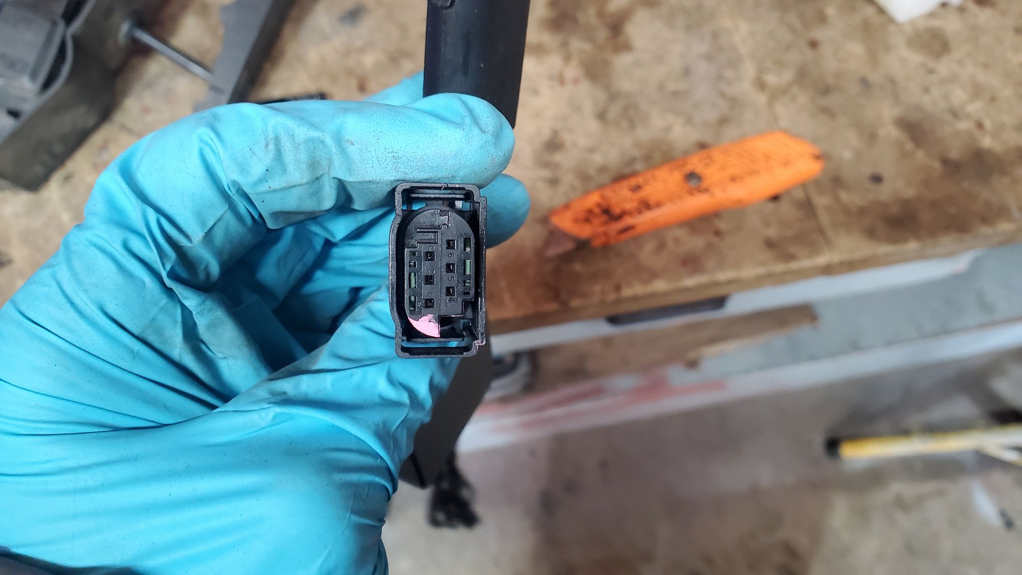

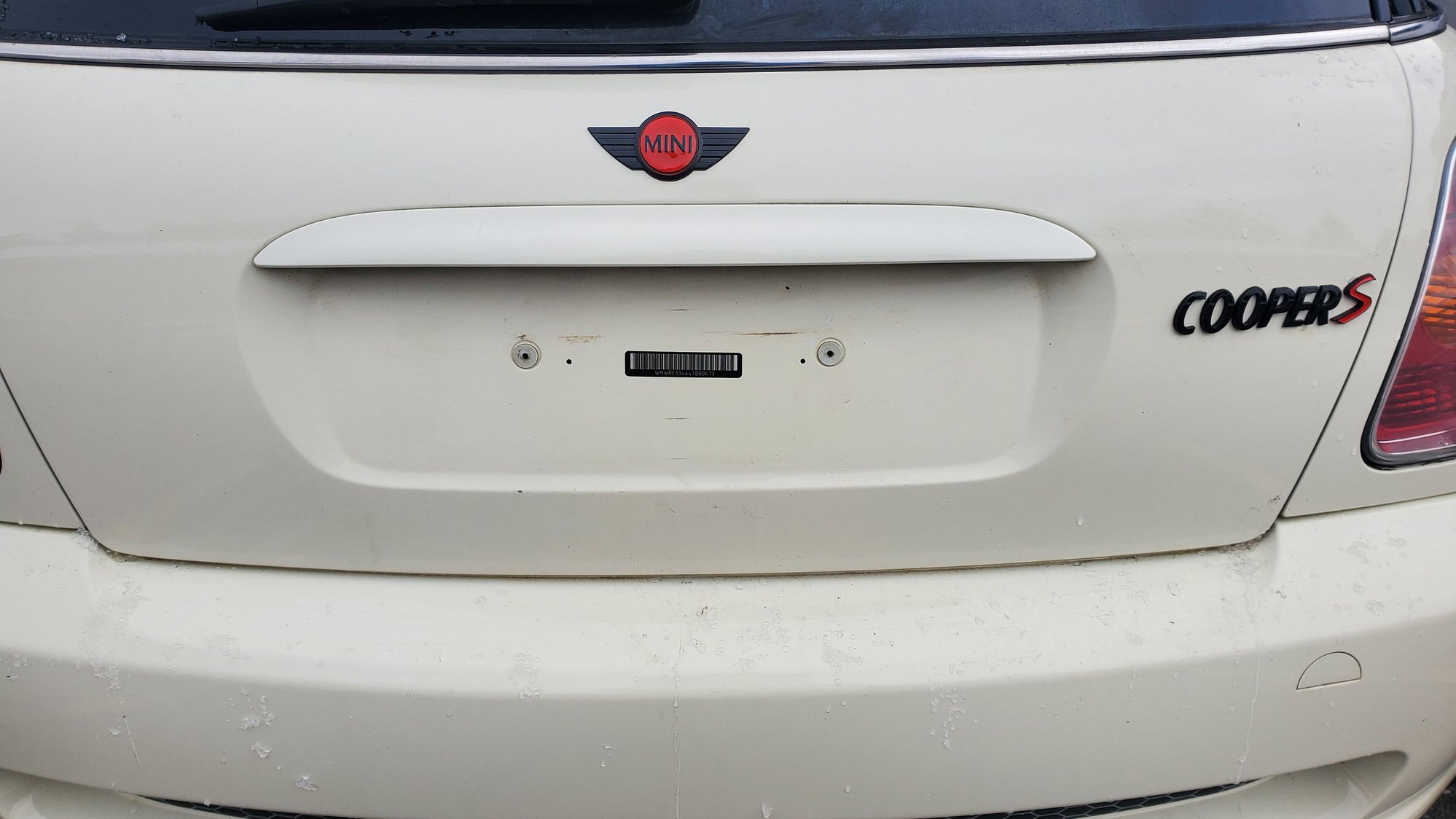

I put on my larger hood scoop today.. grrrr , I had to stretch the front bra over it because it stick out so much buuuuuut thankfully I got it on still. Lol it does a perfect job of hiding the damaged hood and grill until I get a replacement.
I took off the rear faded out badge and replaced it with one IM NOT happy with. I wish id just gone pur black or chrome again. Imo it doesn't match. Awe well..
I then replaced the side markers with led ones. The old ones one of the light casing fell off so the blacked out led sidemarkers will match the head and tailights I plan on getting down the road.

stupid ? Do LED side markers need to be coded or plug in play? Only had my R53 for a month and I want to change all the side markers.
Old Feb 23, 2023 | 06:54 PM
  #63
Thomas Burdek's Avatar
Thomas Burdek
Joined: Oct 2021
Posts: 116
Likes: 43
From: Schaumburg, IL
Plug and Play. Most lighting things for the R53's are plug and play.

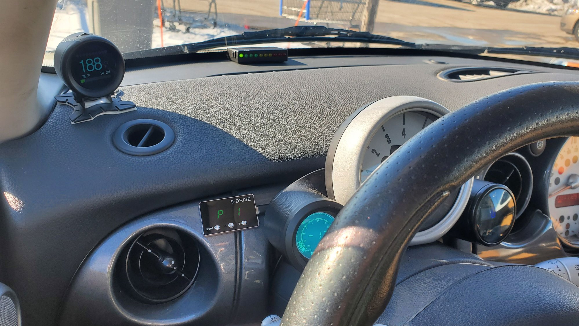

I got and modified my throttle controller and I will provide you guys a link.. if your running a bmw v12 tbody YOU NEED this . Read the post I made and itle explain. Basically it completely corrects that dead pedal feeling the upgraded tbody gives..

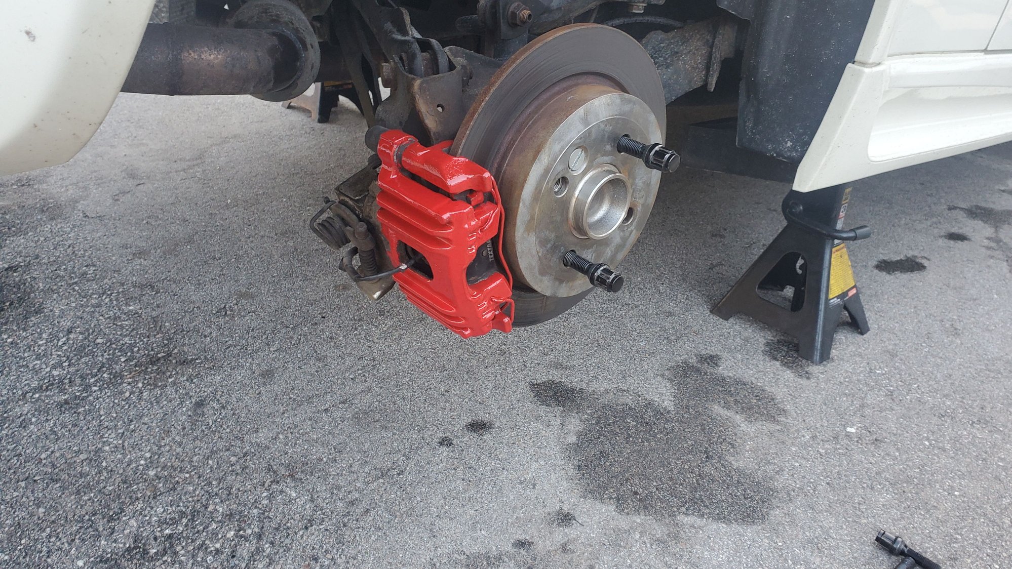

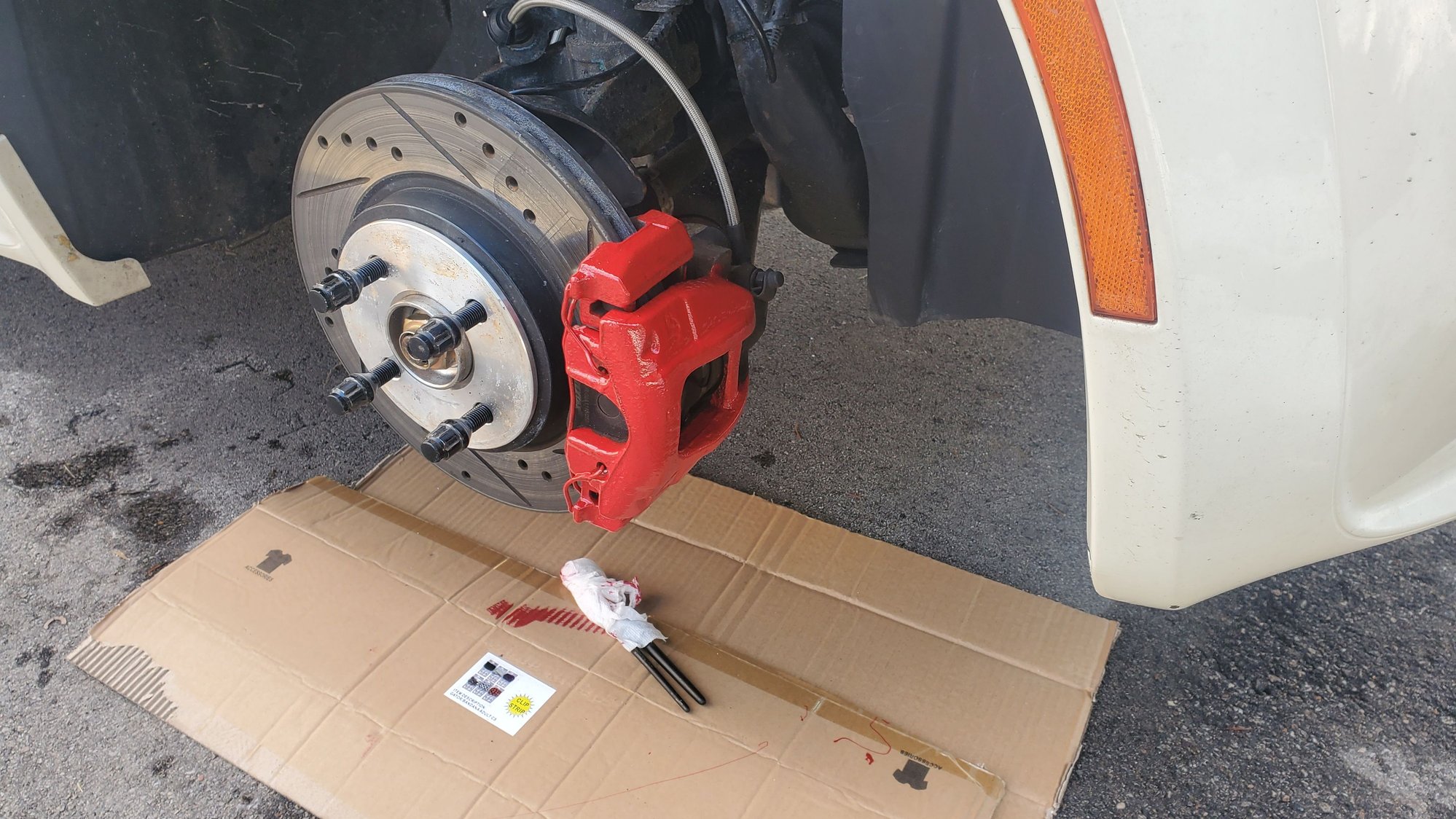

Well today I finally put on my ss brakelines I had sitting around for the front brakes. I couldn't bleed one of the calipers so I had to remove the bleeder and line and clean it out inside but it fixed it and then everything bled correctly. I also activated abs module and then rebled all 4x sides again. I'm sure I got all the old fluid out now fir sure for sure. The pedal feels amazing so I know there's no air in there.
I then painted the calipers and removed the 5mm spacers and the extended lugs still fit luckily.
