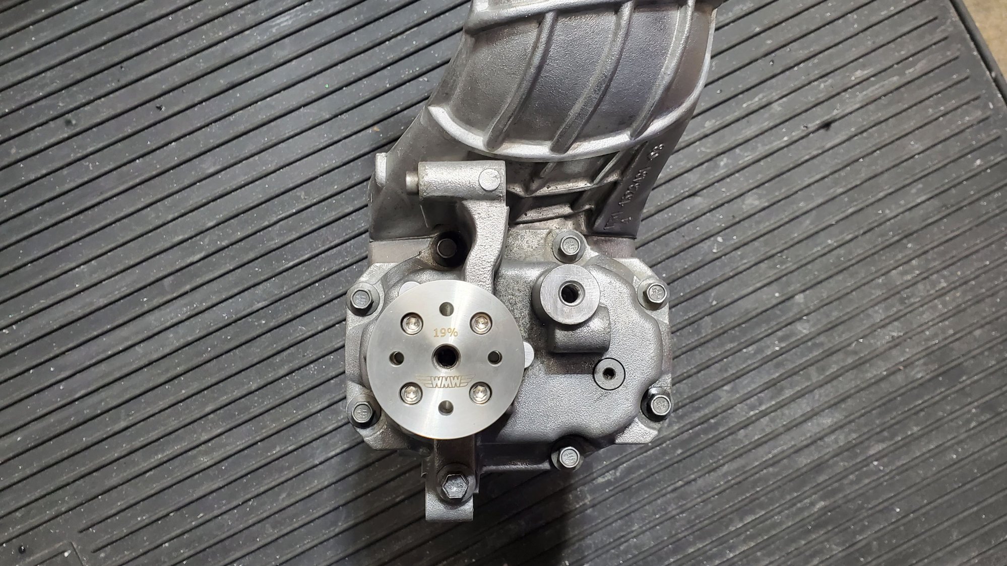

Awesome, the sc pulley cane off without much fuss.. it took abit of heat but once heated it began to slide off..
wmw also got me the 19% pulley very fast and that arrived today so after I got that stock pulley off I was able to finish cleaning the snout and few other spots that the pulley was preventing me from getting at.. lol this supercharger actually is starting to shine pretty well ALONG with the ic horns... itle look nice once I slap in my grs motorsport ic off my other car..
I still need to get an intake manifold inorder to get it ported out so i can install the sc and the entire ported intake system along with it. Then I'm curious to see how the stock ic will hold up with a 19%.. hoping all the porting I did would allow me to continue using the stock ic but I highly doubt just porting would be sufficient enough to stop the increased boost..if anybody has an intake Manifold I got a few things I'd trade like a that digital/analog boost gauge I'd removed from this car I DID get a new boost sensor for it too for it to read accurate.

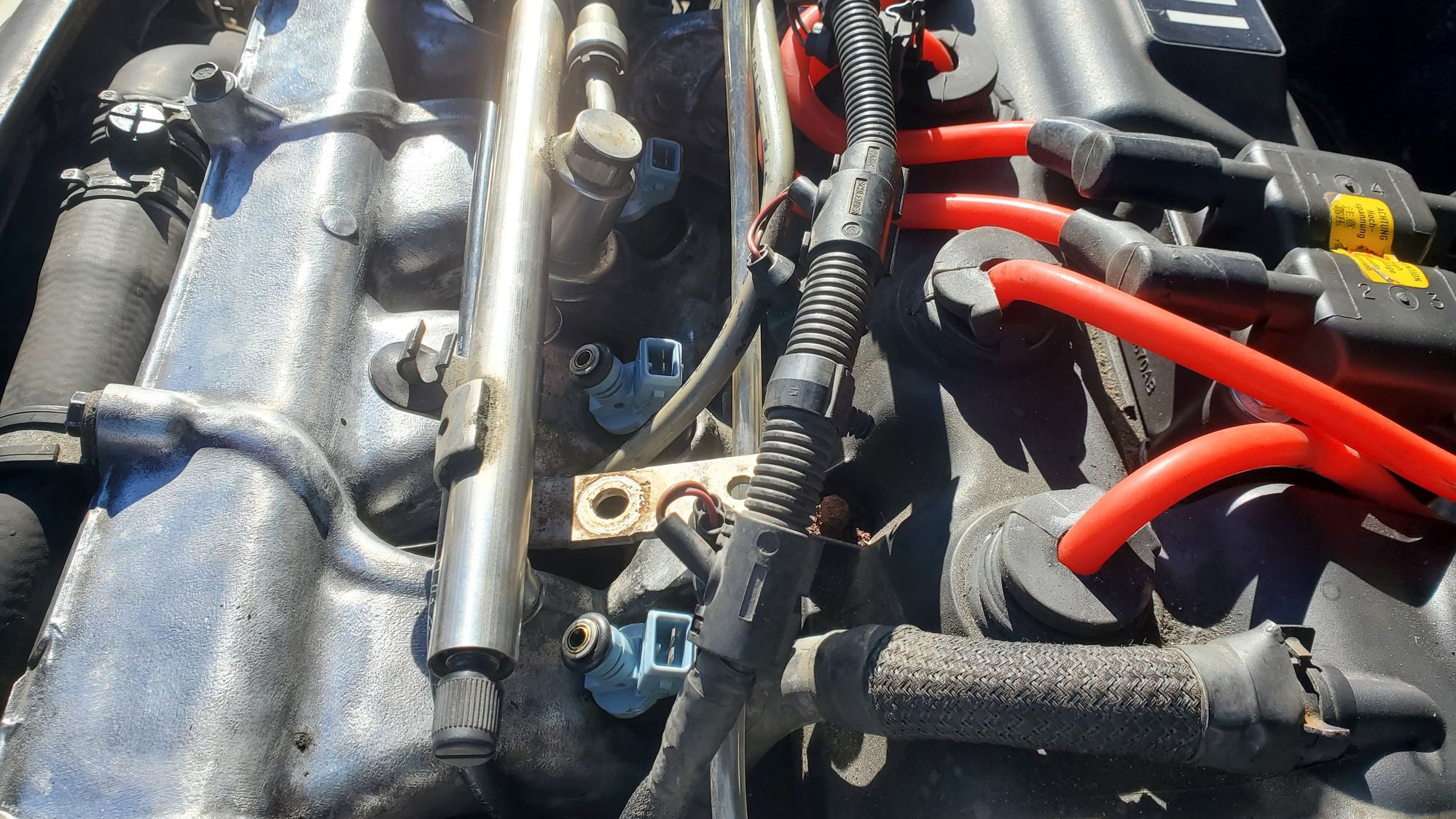

Took my car over my My parents house which is only 5min away..
The only issue i ran into durring disassembly was the very right intake Manifold stud had corrosion and it took alot of heat and wiggling to finally get it off. I was smart this time and sprayed the fuel injectors prior to trying to removing them because those buggers are stubborn when their seals swell up and harden. Thankfully I remembered I had pliers that grabbed the injectors without damaging them and I was able to get them out with some persuasion.
I'm pretty sure the rear main is leaking internally and weeping out where it can. The cars leaks nothing under it BUT the front of the eng n trans as you can see LITERALLY has an inch buildup of oil and grime.. I guess I better order an entire gasket kit abd replace all i can while its easier to do so.
I also found a heat tab on my block , so does that mean this car ALSO has had an engine replacement ? can someone please remind me where abd what to check to see IF my engine matches my vin.. would sure be nice if it's a lower mileage engine. I peeked at the tops if the valves and they looked like new , ille get a pic.. I can tell the alternator is new along with serpentine belt..
so now I need to port the intake Manifold and boost tube and put the other ported things and facelift sc on along with new tensioner..

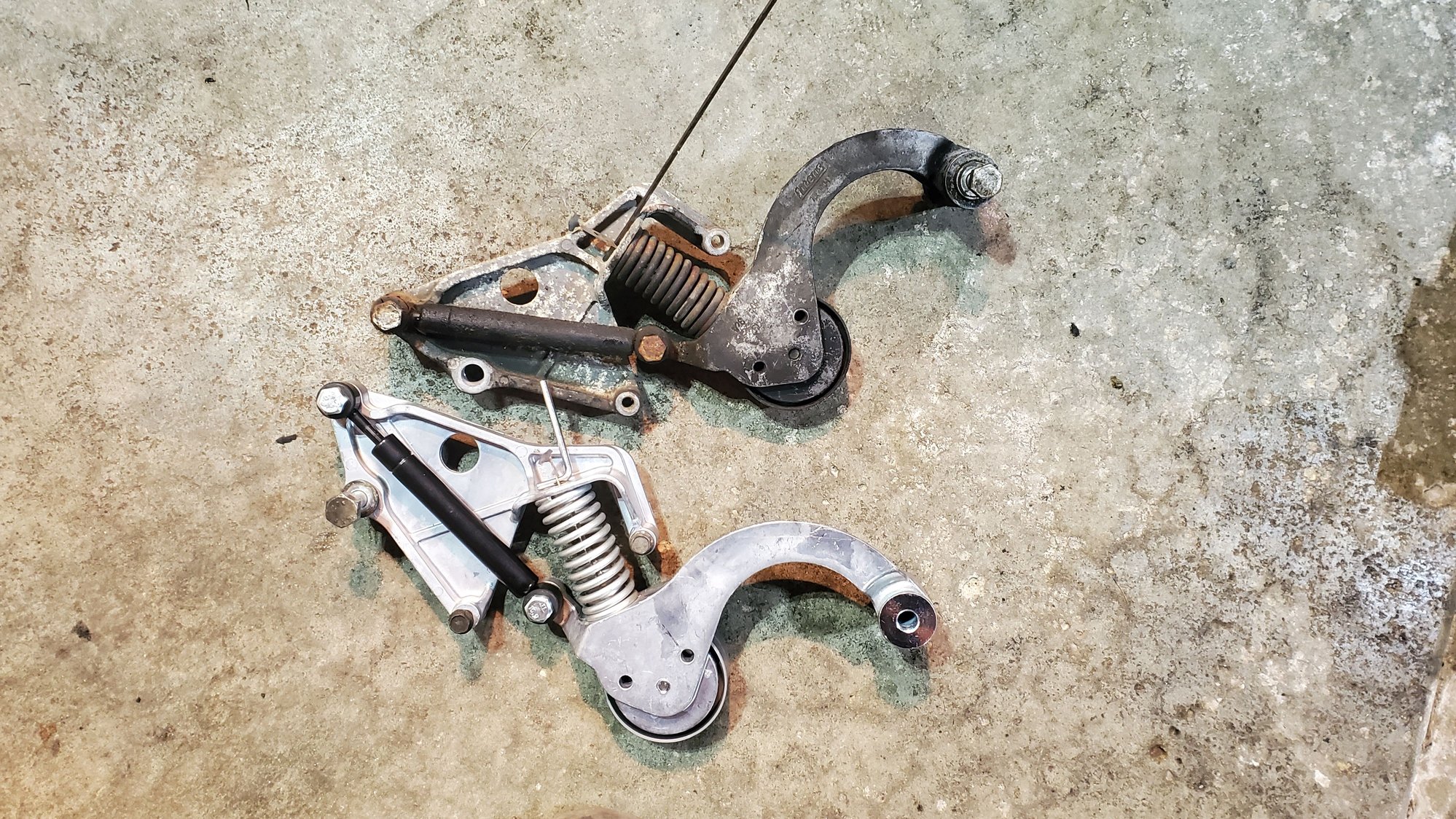

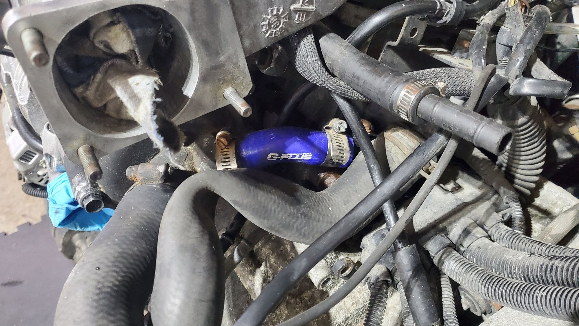

Ported facelift running a 19% pulley has been installed , ported intake is on , new tensioner , new gatorback serpentine belt.. I also replaced all orings that came out like fuel injectors, waterpump and dipstick.. I also coated the oem metal gaskets in copper gasket maker.. i take every precaution I can to make sure I don't have any boost or vacuum leaks.
I thought I was in for a headache getting a coolant hose to fit between the waterpump and the metal T buuuuuut thankfully i had THE EXACT hose i needed that was left over from my silicone coolant hose kit i out on the other mini..lol i musta used the wrong hose...derderderder.
things are going very smoothly.. twist my testies and knock on wood that it continues going this well...

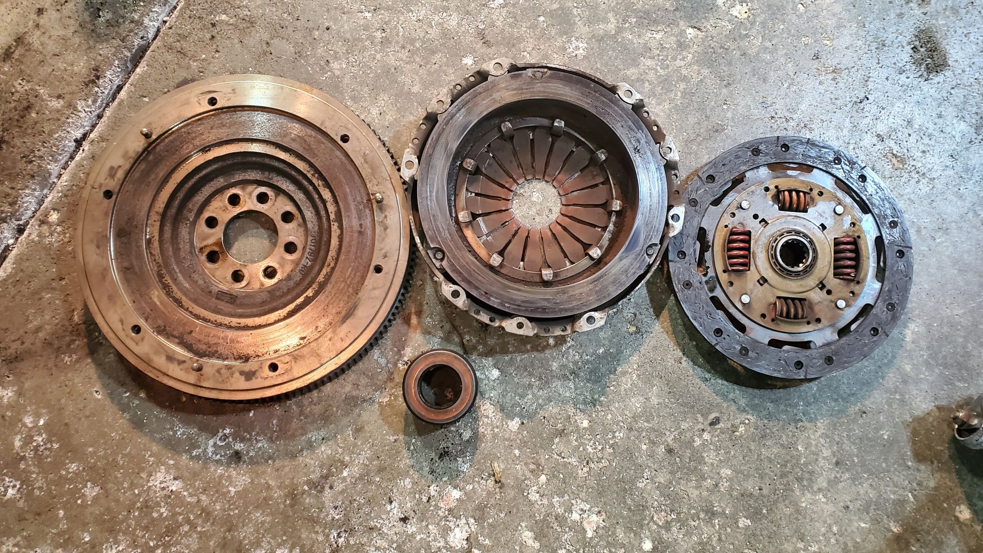

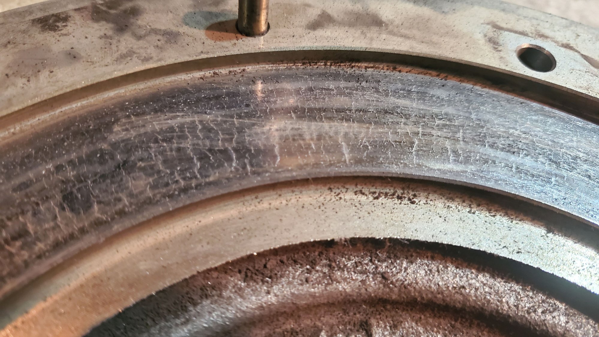

I found the car already had a 1x piece Valeo clutch kit in it but as you can see in the pics , either someone didn't know how to operate a clutch correctly or it was replaced looooooong ago.. but i cant image the later became the cars got 172k and 2x clutchs in that amount of time says " LEARN TO DRIVE A MANUAL CORRECTLY STUPID !!!!"
we replaced rear main seal and I didn't use the provided throwout bearing in the kit I used an exeddy one. I read thats where you cant chinse out so..
i cleaned out the inside of the transmission casing very well also because it was COATED in there like id assumed it was going to be.

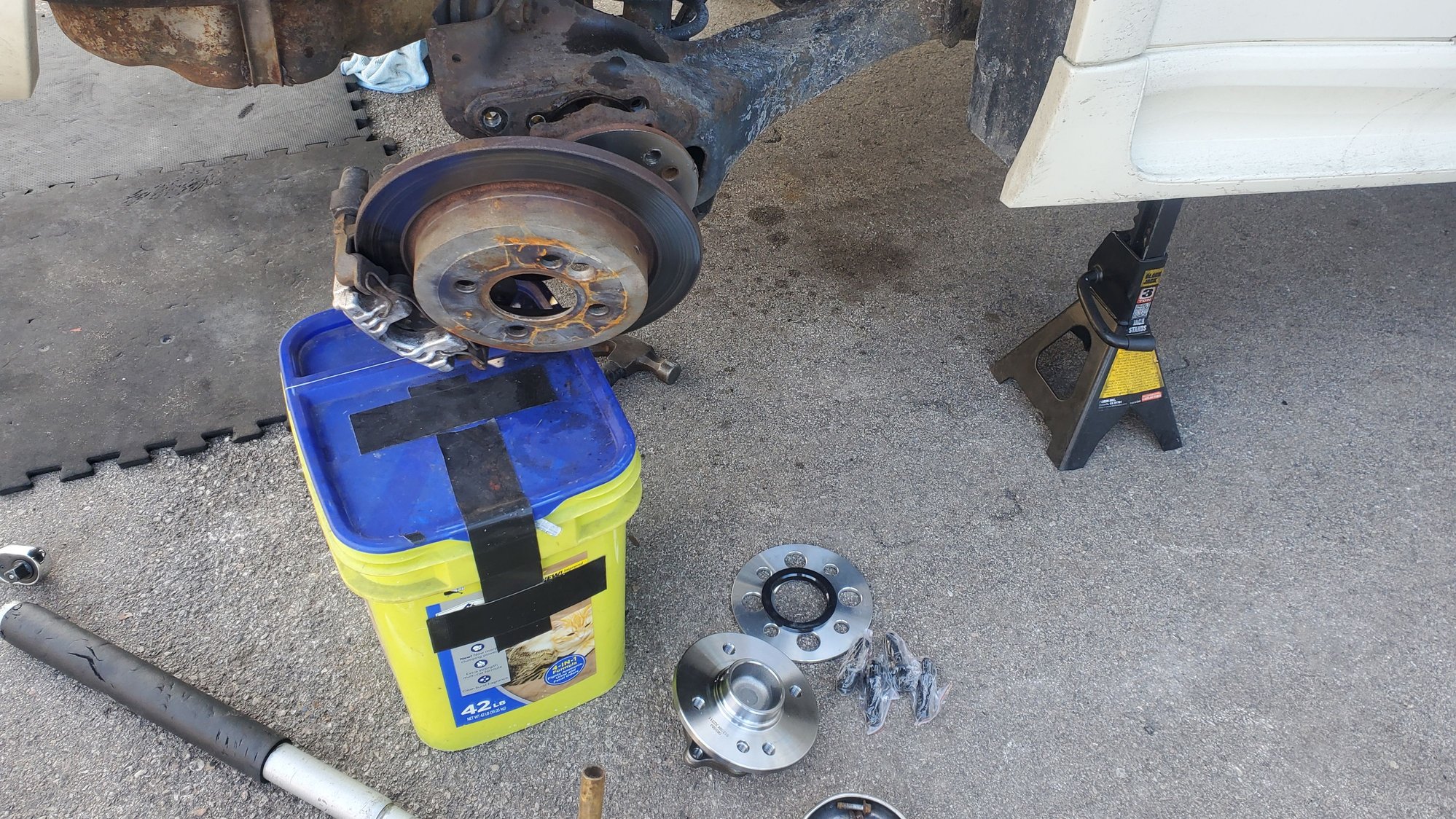

I got on my new rear hubs and cleaned everything up back there with a wire wheel. I also pualso the correct sized 5mm wheel spacers , hub adapters and new extended spline lug nut ( I prefer splined , they're almost impossible to strip ).
I would like to get the exhaust done soon but I really can't because I believe I pulled my pectoral muscle and WOW it hurts doing ANYTHING , even caughing is like being stabbed under ny arm pit..lol I used lots of heat and penetrating lube today to make things come off without having to fight them.
idk if just replacing the rears is going to keep off the abs n traction control light but I do have the front hubs and stuff I will replace soon.

Dug out my radiator and cooling fan I'd saved off of my other mini and put them in today..was worried it wouldn't fix it but soon as it hit 220 the lowsided came on and I breathed a sigh of relief.
​​​​i also , if you look closely. I put in new seals all around the radiator so no air gets past it. I used the weather proof packing that my mishimoto radiator came with and used the old pieces as templates and cut them a tad larger so they'd press fit.
the 380cc injectors also arrived today ( jcw knock offs ) and ille toss those in maybe tomorrow if its not snowing n raining again like its been all day today...yuk , what a NASTY day out today..i think it's spose to be sunny and in the 40s tomorrow's, so if so , ille toss in the 380cc's and take it for a 50mile cruise like I now plan to do every day until I reach the 750mile breakin period...then it's time to test this little sucka out...

I forgot to mention I DID install a new bpv when I put on the ported intake stuff. I also adjusted and set it so it would fully close and not leak boost.
Well it definitely wasn't in the 40s today BUT it was sunny and it hasn't been sunny in WEEKS , so I took advantage and put in the 380cc injectors and step colder sparkplugs. i also replaced the line and conector to the fpr because I CRAZY about making sure my vehicles NEVER have any vacuum or boost leaks. Imo there's nothing more annoying than leaving power on the table and not running perfectly. I take time to ensure all the little things are done so at the end of the big project I'm not chasing down issues caused by something so simple to avoid. It also why I always use new gaskets and copper gasket maker on those dumb janky flat metal gaskets/seals
I then reset adoptions with inpa and gave it a quick test drive to the store down the block and it ran PERFECTLY, no sputters or missfires or anything. Not even a cel.
Kinda funny , I'm running catless headers ( with a defouler though) , larger tbody and intake, full ported intake system and sc with 19% pulley and even 380cc Injectors and its all running fine on stock tune. Yea , I'm I know not to it's full potential but good enough until the clutch breakin period is over. Then ille toss in 440cc injectors and have it tuned.
Btw if your wondering , i am using the ebay 40$ r53 jcw upgrade jcw knock off injectors. This is my 3rd time using them with nothing bad to say about them.

Went for a nice long ,all city driving cruise tonight.. within 1st 5min the car began feeling sluggish after I went full throttle for a second and I looked and was loosing vacuum and low on boost.
so i headed back home and instantly knowticed the fpr line I just put on, the adapter literally exploded from the boost.. so I put a stronger one on and went back out and put on 70some miles again and 2hr drive..lolol the car MAKES 20LB OF BOOST TOO !!!! WTF ?????? I can't belive it !!!!
fir such few mods it's a little rocket actually.. I went wot a few times just testing and clutch feels outstanding sofar. I did knowtice minior belt slip too at high rpm so i will drop down to abit shorter belt and then i bet i see atleast 1lb more of boost.. unreal , i cant believe all the porting I've done how much it's helping. With the 19% my iats are totally acceptable too and never spike too high and recover soon enough. Though it is in the 30s but still.. I'm making only 3-4lb less than I am with my Sprintex.. lol MAN ! I can't wait to get the ported head n cam on and see how much that'll help.
I wonder if the exhaust will help at all too at all. It's gotta atleast some since it's. 25 larger piping and mandrel bends with no mufflers just strait through resonators. Soon as I got a helper around ille toss it on.. should only take an hour.
btw YOU NEED to buy these pliers. They allow you to put on or remove the boost line on the intake Manifold as well as fuelrail without having to completely remove them . Matter fact , i end up using these alot on this car. Go buy ur self a set , i promise youll thank me..

+1 on the eBay 380cc injectors. There's a video out there somewhere on YouTube where a guy did a flow test and they're running 380cc. I've had those on my MC40 for six months with absolutely no problems. You can't beat the price. Also, you can buy a set of those pliers (different angle bends) at Harbor Freight for a very reasonable price.
