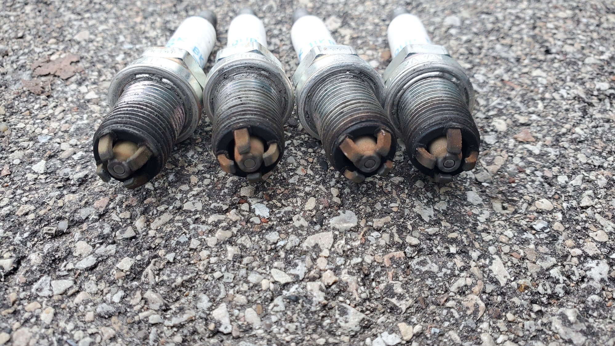

I plan on an entire tune up. Plugs,wires, every single fluid , filters including fuel filter and tank cleaning , full interior detailing and cleaning along with a good cut and buff for the exterior paint once weather permits. It's not gonna be a ballz to the wallz build like my other mini BUT it will be able to scoot pretty well once all is done.
If gear fluid change and stuff doesn't help the clutch ,the 1st mod the car gets besides its intake is a lightweight flywheel and clutch. I also have an extra complete head im going to port out that I have on my shelf and toss in an ns1 cam along with all new timing components. I wanna swap my grs motorsport ic off of my other car into this one , facelift sc ille slightly port and a lightweight 19% pulley and I miiiiiight do an electric waterpump swap , 440cc injectors , 65mm tbody and intake, catless header and I'd really like a jcw exhaust then but I might go pacesetter again since that's the largest and ONLY actually full 2.5in diameter piping exhaust but it is a pretty loud exhaust unfortunately. I will also port the intake Manifold and intercooler horns and Of course ille be having Adrian tune it when time comes.
I would really like to know if this car has an lsd but im not gonna be attempting any peelies until i have the transmission issue fully addressed along with a complete tune up.
i already have enroute catless headers , new plug wires and ngk 1x step colder plugs , 4x wheel speed sensors , oil fiter and oil and new decals for the rear bumper...lol I don't waste time. I also will install my x60 gauge and boost gauge I have and I will also be installing a wideband. So once the header is here ille have a bung welded onto it yo accommodate the wideband.

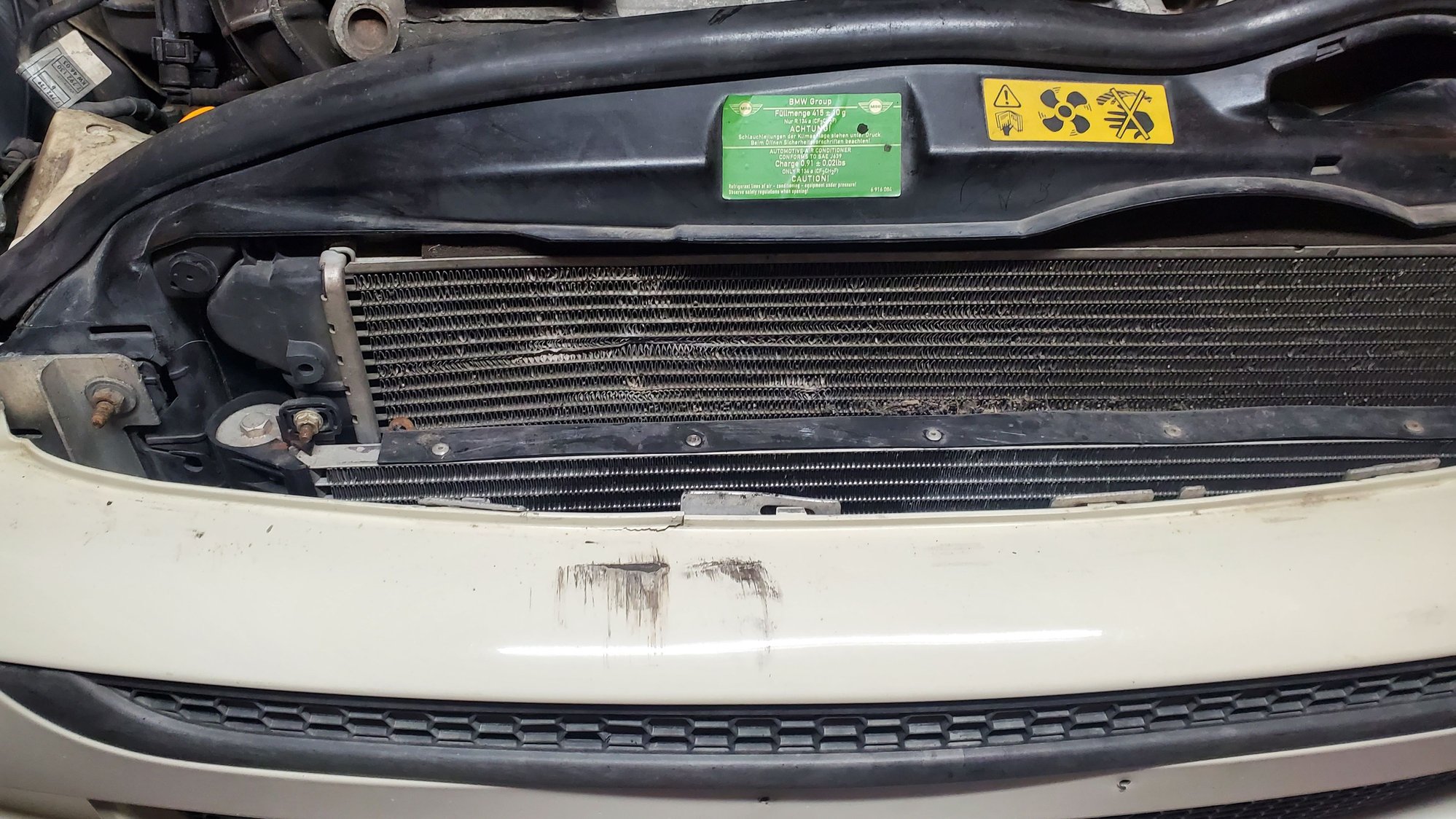

the only damage I found to the front end is : it looks like someone ran into like a likeor something and it broke the bottom of the aero grill , pushed back the grill retainer and it dented the radiator too.

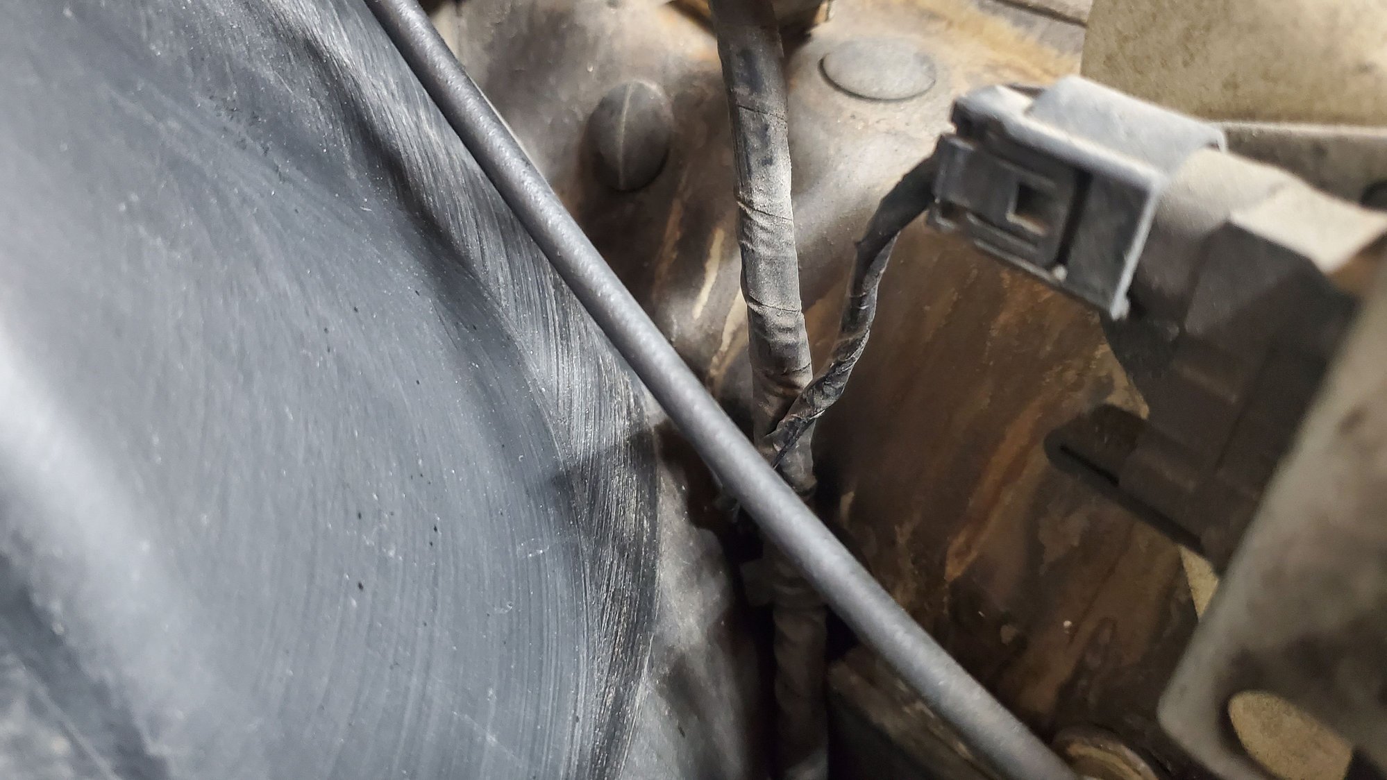

I replaced all 4x wheel speed sensors and the error lights are still on so I'm going to be taking it to the dealer abd having all 6x of its recalls taken care of and hopefully it just needs a reset. There no error codes present but it dies have an old battery. I did try putting on my jump box and starting it n running it but no luck. Voltage is always above 13v too so idk.

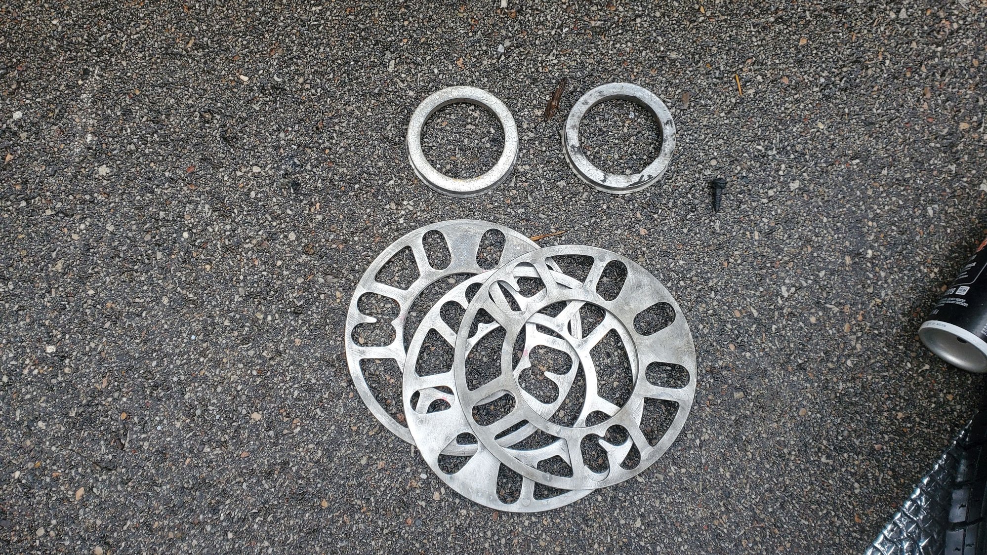

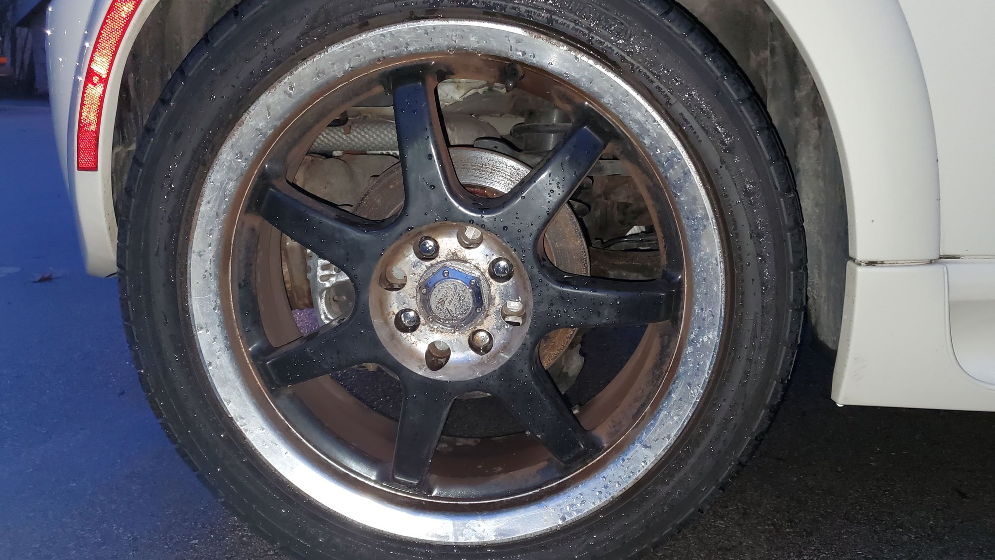

when i was removing the rims the 1st one tumbled off because they didnt have on hub adapters buuuuuut because i hoard parts i had some that fit so i put them onto the rims and then also installed the 7mm spacers and extended lugs i had also.. thxfully i didnt have to fight any of the old lugs removing them. That's a 1st on a new car for me , maybe it's a sign if good things to come ?

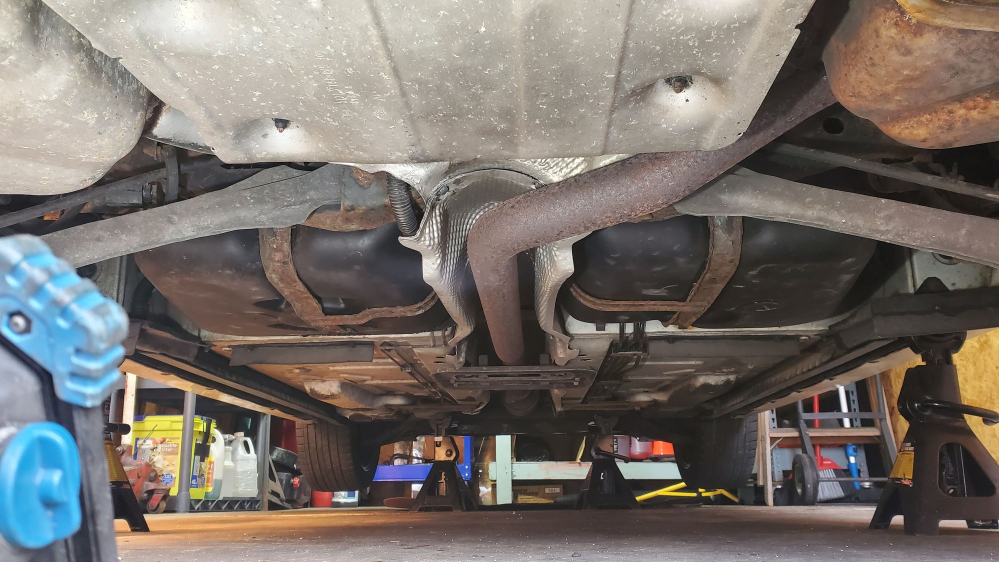

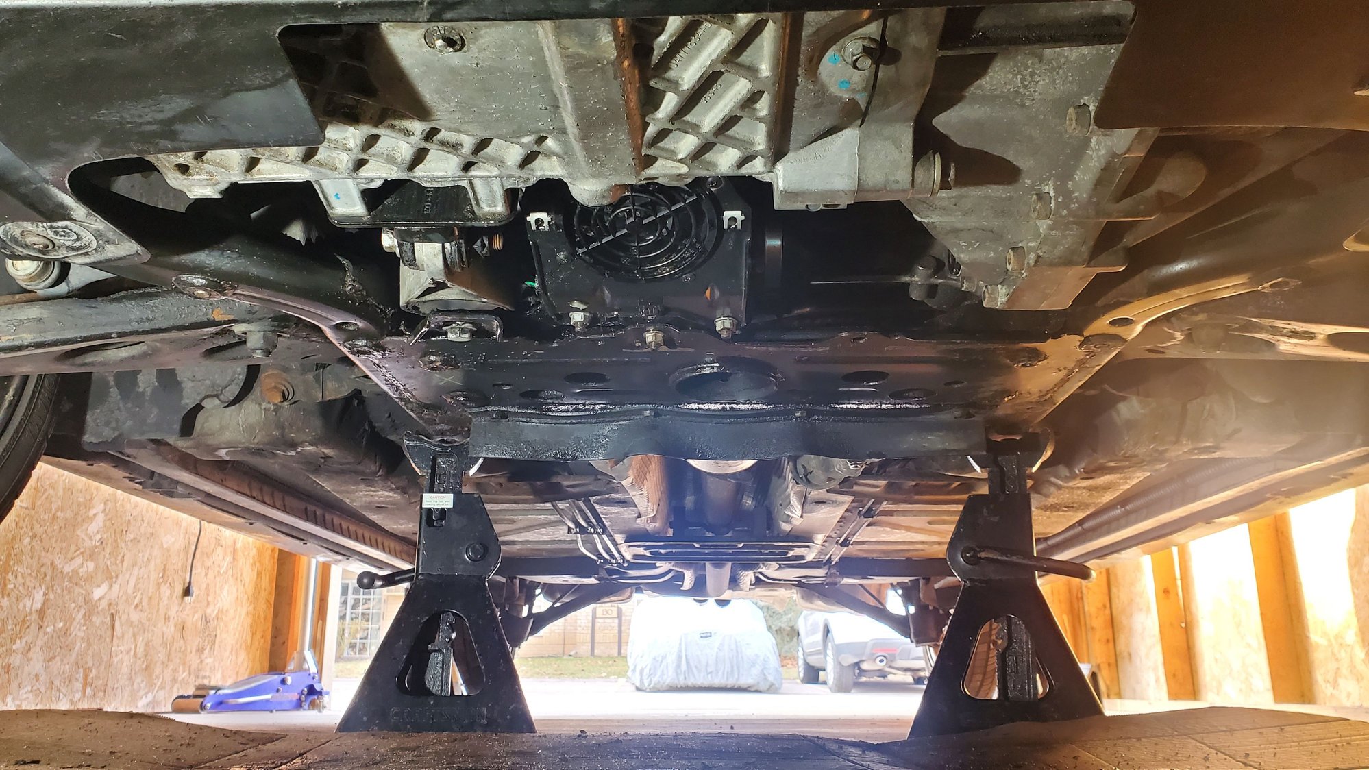

Nice, the front is not rusty at all, just a little in the back.
I just did mine rear hanger bolts. Drilled from the trunk and installed stainless bolts and grease.
https://www.ecstuning.com/b-assemble...1199040241kt1/
Coil pack on the back side always have a little rust. I cleaned mine and added some die electrical grease unless the coil pack is bad,.

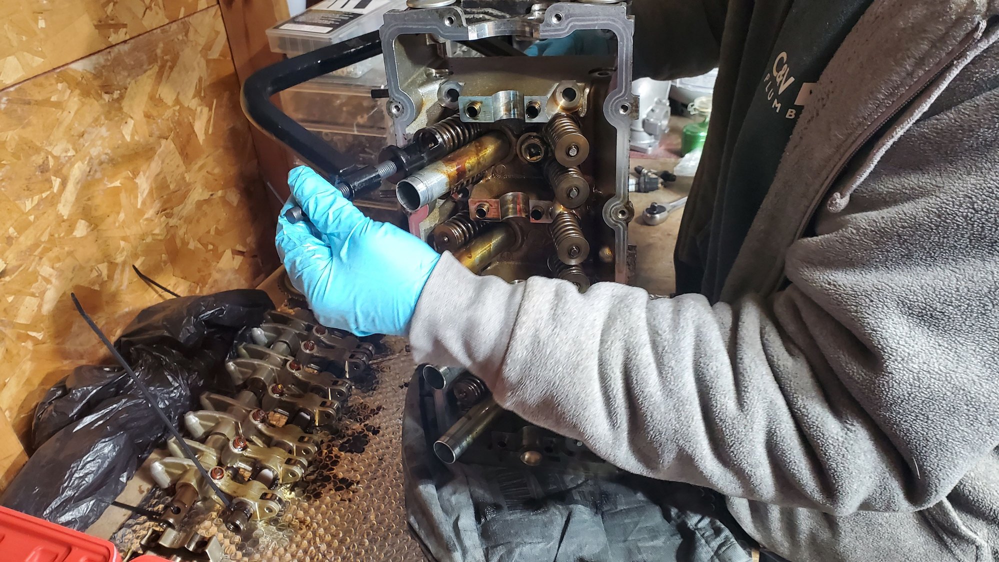

i started to disassemble the head to begin porting that and installinstalling performance valves n springs. that same car I took the sc from I got a glovebox organizer out of and installed.

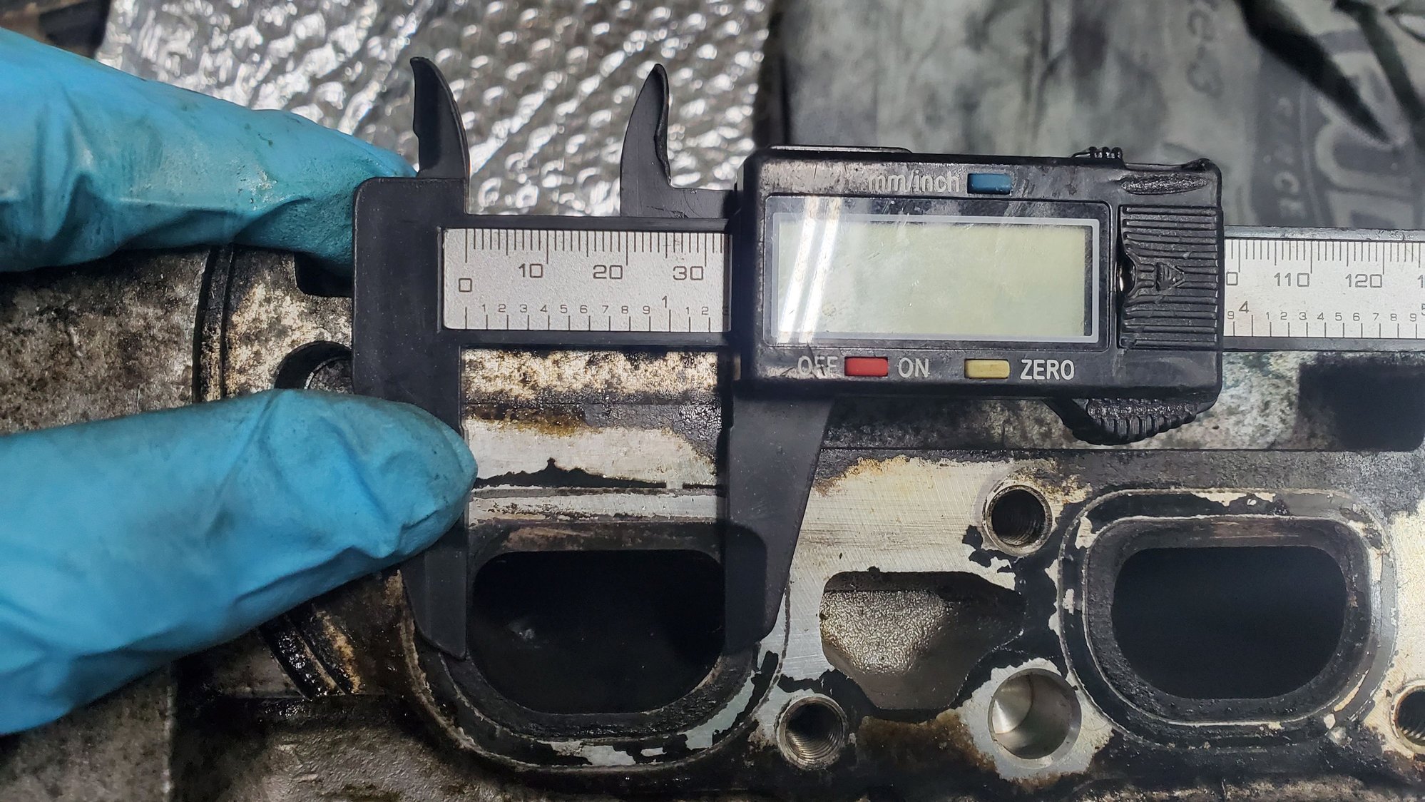

I began porting the head today.. I got a really good start on it. I just need to clean up port shapes a little , though I'm sure it would be fine as is. I'm just **** about stuff so ille have to get them as perfect as possible. I will also finish it off by polishing the exhaust ports then too.
it's a big misconception that your intake should be glass smooth , it actually hurts fuel atomization and can causes puddling of the fuel in low velocity spots so i leave the intake side smooth but not glass smooth.

AAAAAAAND the abs / traction control lights turned off and have stayed off. Lol idk whst i did but indid another partial fluid change so most dirty brake fluid is gone. But went i went to move the car closer to my garage , wgen I applied the brakes they started to pulsate and the brake pedal moved up and down positions snd then resettled, firmed up perfectly and vwola ! The dummy lights then turned off and have stayed off...

Catless headers are on along with 2x new hanger bushings. Its sounds great actually with the stock catback but I'm still gonna get an aftermarket soon.
I had to remove the entire exhaust all because the last bolt on the collector stripped and both ended having to be drilled out in order fir new bolts to pass through to mate upto the midpipe.
I had to bash the firewall and loosen the shift cables so I could get the header in and I had to use my truck jack and stand in order to get the car up high enough for the correct angle. I wrapped the headers too and customized the stock heatshield to fit over them actually.. i drove it around like 45min and 30miles and somehow the cel didn't come on fir the cat delete. Though anyway now the 02 spacer will be here to fix that once it does come on.

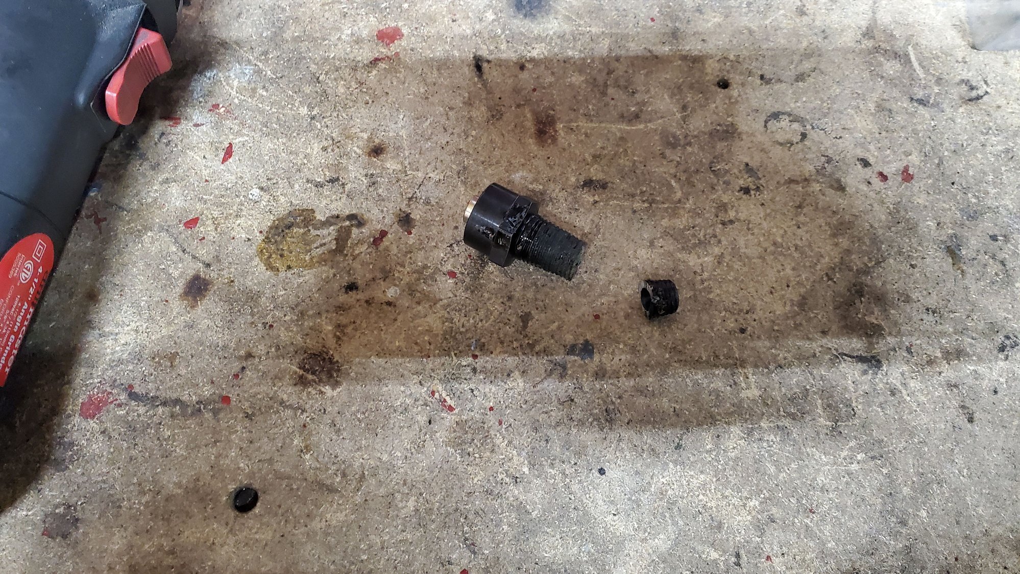

I also was hearing a very loud ticking and i knew it wasnt the timing chain but i narrowed it down the the breather valve. That thing was chattering away , I couldn't believe how loud it was.

Was in the mid 40s today actually so I took out a bunch of buckets of HOT water and dish soap and gave the car some elbow grease.. it's still dirty but atleast not filthy.
I cleaned the door jams and all the tucked away , usually neglected areas and found some thick grime BUT luckily no rust. Though under the tailights the paint is either gone or so dirty it needs more scrubbing but either way i will pull them and if i find any sign of rust starting i will address it IMMEDIATELY. I will order some paint match touchup paint too.
i need to really clean up the rims and do some paint perfecting but that'll come more as the weather allows. I can't cut and buff the car in my garage as it's too hard to regulate the temp and stuff in there and I need perfect temp,lighting ectectect to be able to do what little I'm able to. But if I was able to cut n buff and perfect my other mini after it's paintjob , I should be able to bring this one back to a 9/10 again.. I mean it's not bad by anymeans but I like things to be perfect.
