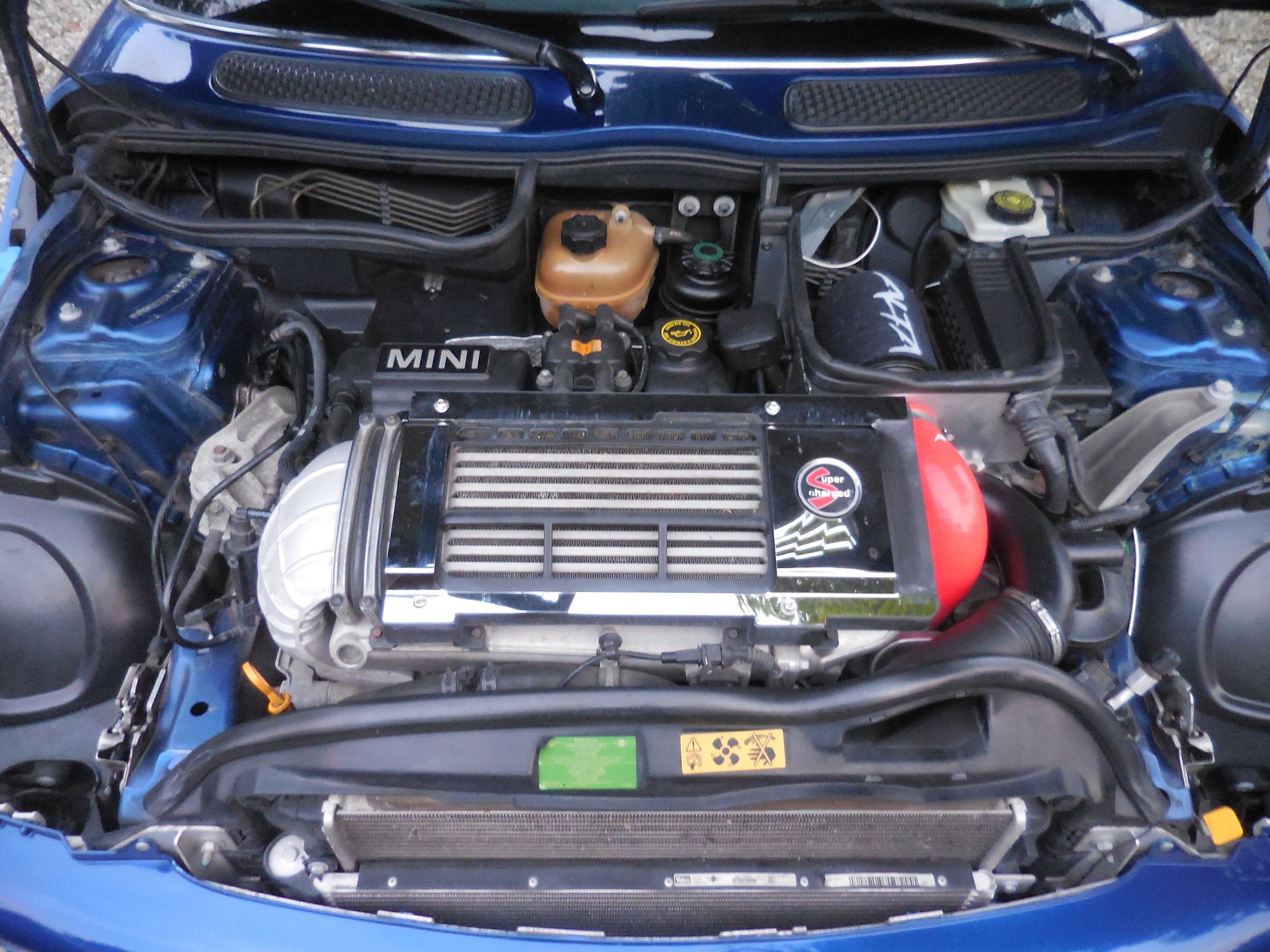

Yes, pics would help us help you. Once you determine what you need, you'll be surprised at how many of us can supply much of what you need. Frankly, looking at that pristine engine bay, I have a feeling that you probably have some surface rust but not as severe as you might think.

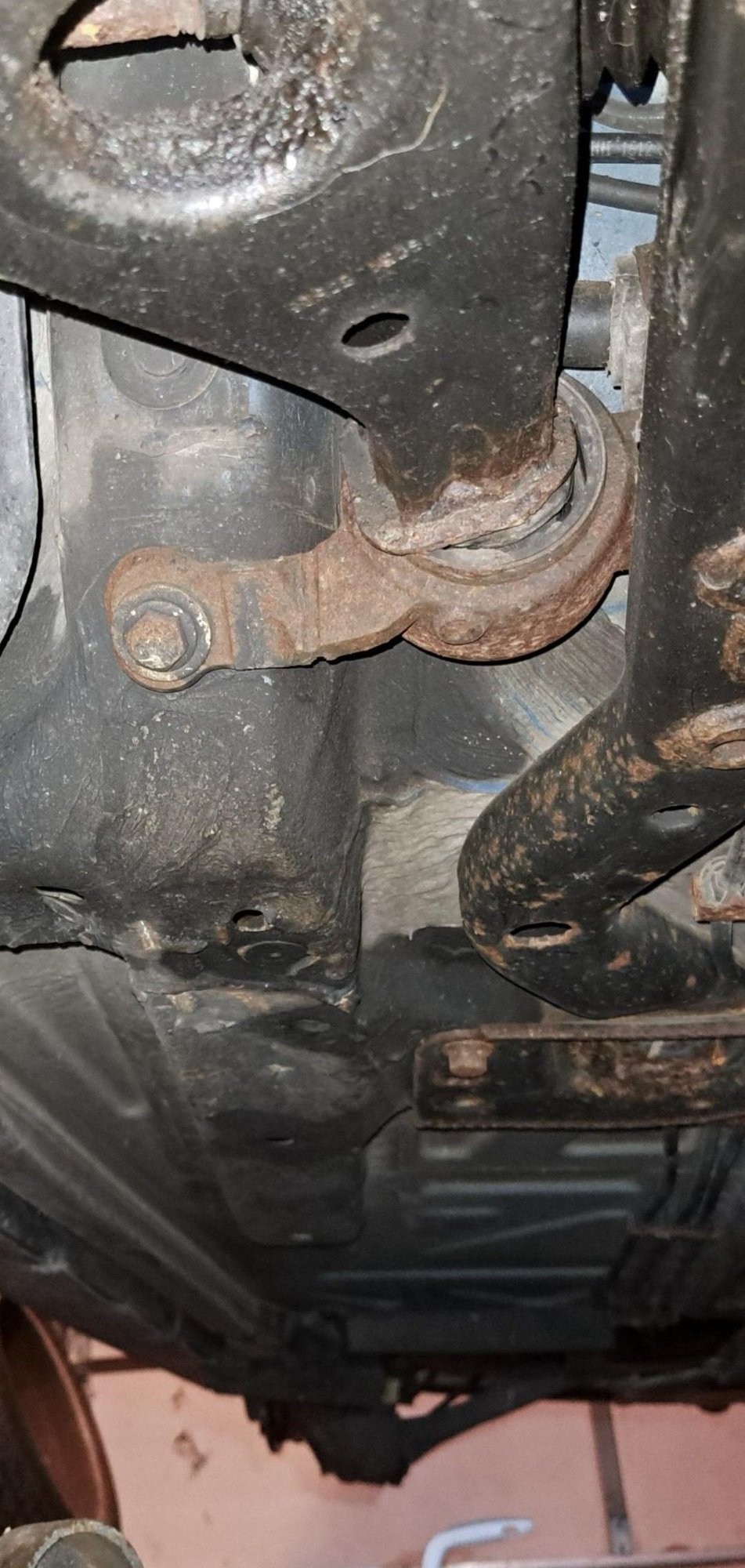

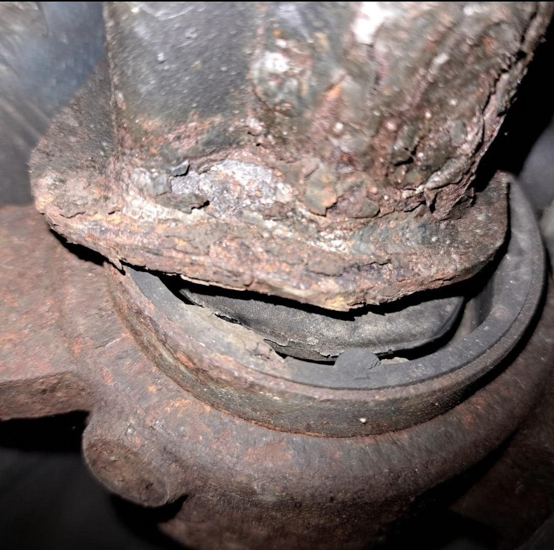

Here is what caught my eye doing an oil change. I believe this is called the hydrobearing (31126 757551) on the wishbone bracket w/rubber mount (31675 757562). It secures the wishbone (We Americans call it the lower control arm) to the sub-frame. As evidenced in these photos they are coming apart. These are of the driver's side at different angles. The passenger side is just as bad. Hope to have more photos Monday night after it goes up on the rack. I must add that there is also a fluid leak as the bottom of the engine is always wet. However, not enough to drip on the floor. A closer look from the right-side wheel well now leads me to believe it is likely the power steering rack....

Those are the lower front control arm bushings. I’ve never heard the term “hydrobearing.” They’re a well-known failure point. If you’ve never changed them before, they’ve probably been trashed for a while. The easy check is to kick the tire on the tread while facing the rear of the car. Bad bushings will allow the tire to shudder from the kick.
I changed mine at ~60k miles, IIRC. Polyurethane bushings are the way to go for replacements. Some people have changed them on the car, but I pulled my subframe to change mine. It’s not a particularly bad job.
The power steering hoses are also a common failure item. They’re basically guaranteed to leak at some point. They shouldn’t get the bottom of the engine wet though. In fact, I’m not sure how the power steering could get fluid on the engine at all.

Looking at the picture, it’s really not that bad for a 22 year old car!
As mentioned, looks like you need new rear control arm bushings and carriers, and perhaps new control arms. Dropping the subframe would make replacement easier. Plus, with the subframe removed, will give you an opportunity to refresh the paint on it.
