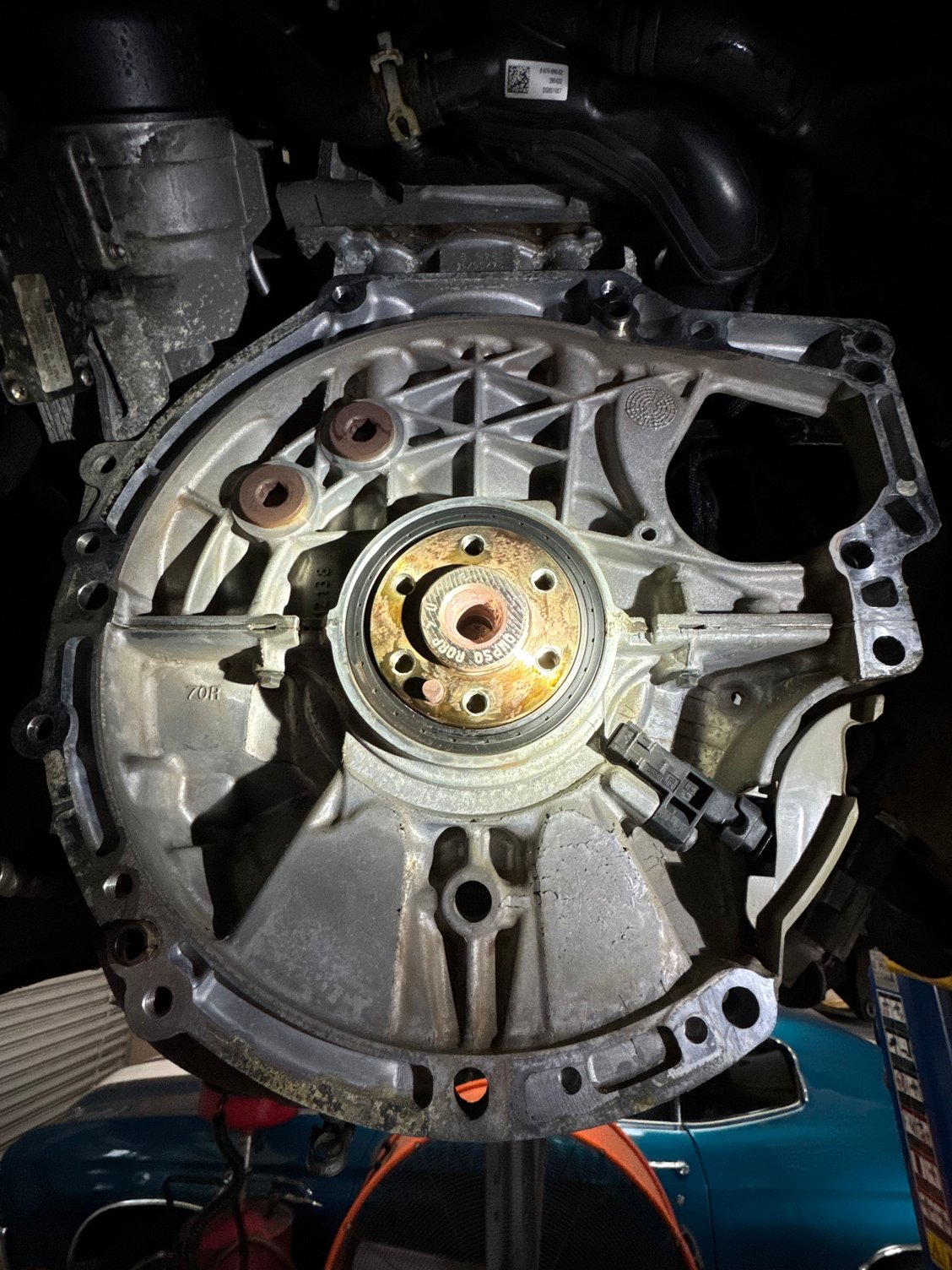

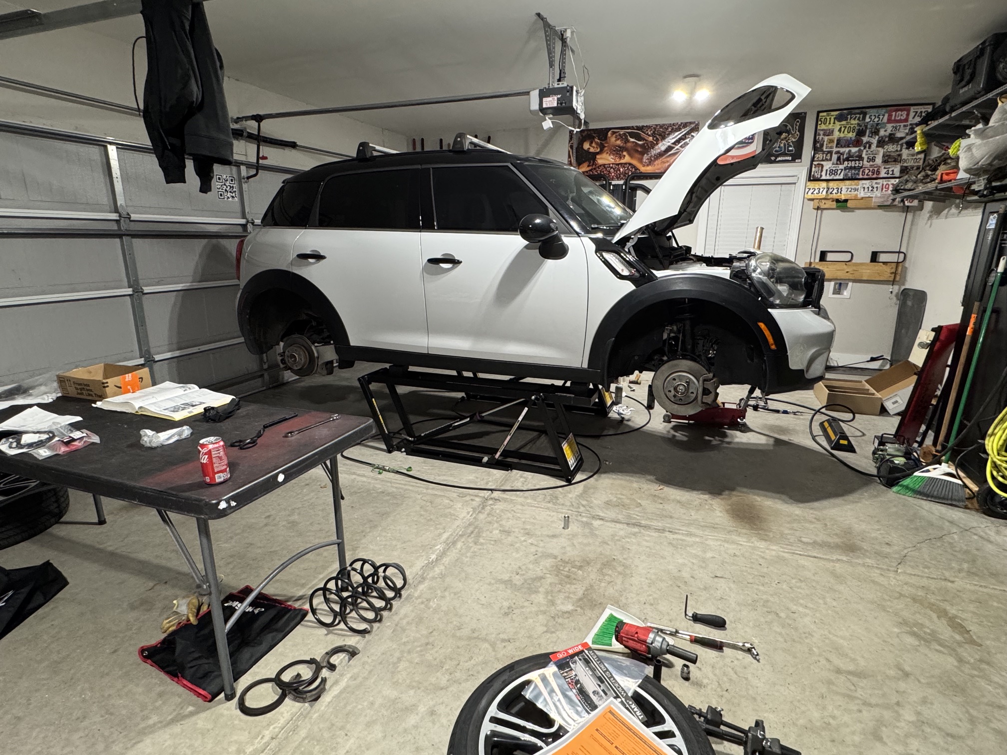

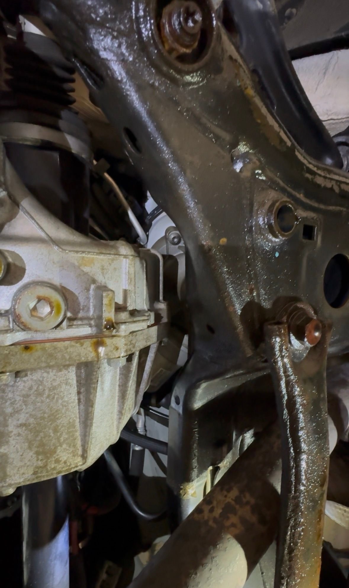

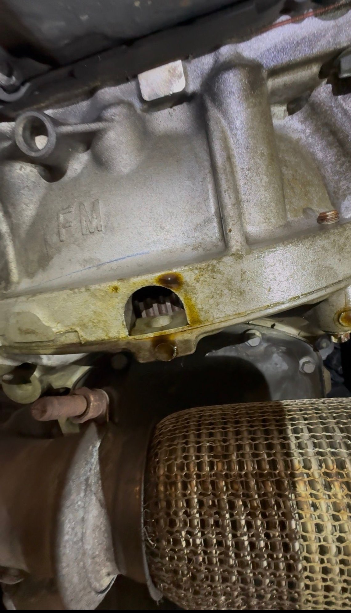

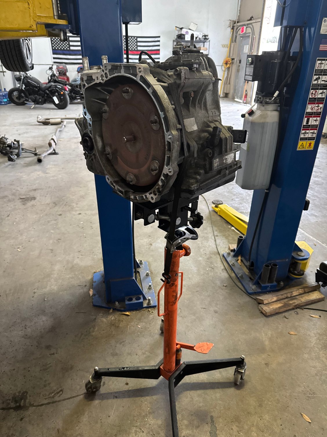

Your situation seems to be identical to what I experienced recently with my son’s 2014 R60 S FWD.
I first noticed the leak due to the amount of oil residue I noticed on the underside of the car when doing an oil change. After cleaning it all up I found it to be from that same weep hole and confirmed it using my borescope camera.
Fortunately the parts aren’t expensive. In addition to the rear main seal, the transmission bolts have to be replaced since they’re one time use. The cost of labor makes this project expensive since the subframe and the transmission has to be removed in order to access the seal. Unfortunately I don’t have a life high enough to be able to drop the transmission from the car but I was lucky enough to have a good friend nearby who owns his own MINI repair shop be able to do the job while I watched and learned. Not sure how these can be replaced without dropping the transmission since you have to make sure you don’t roll the new seal when inserting it and it’s safer to set the new seal with a special tool that pushes it in evenly.
