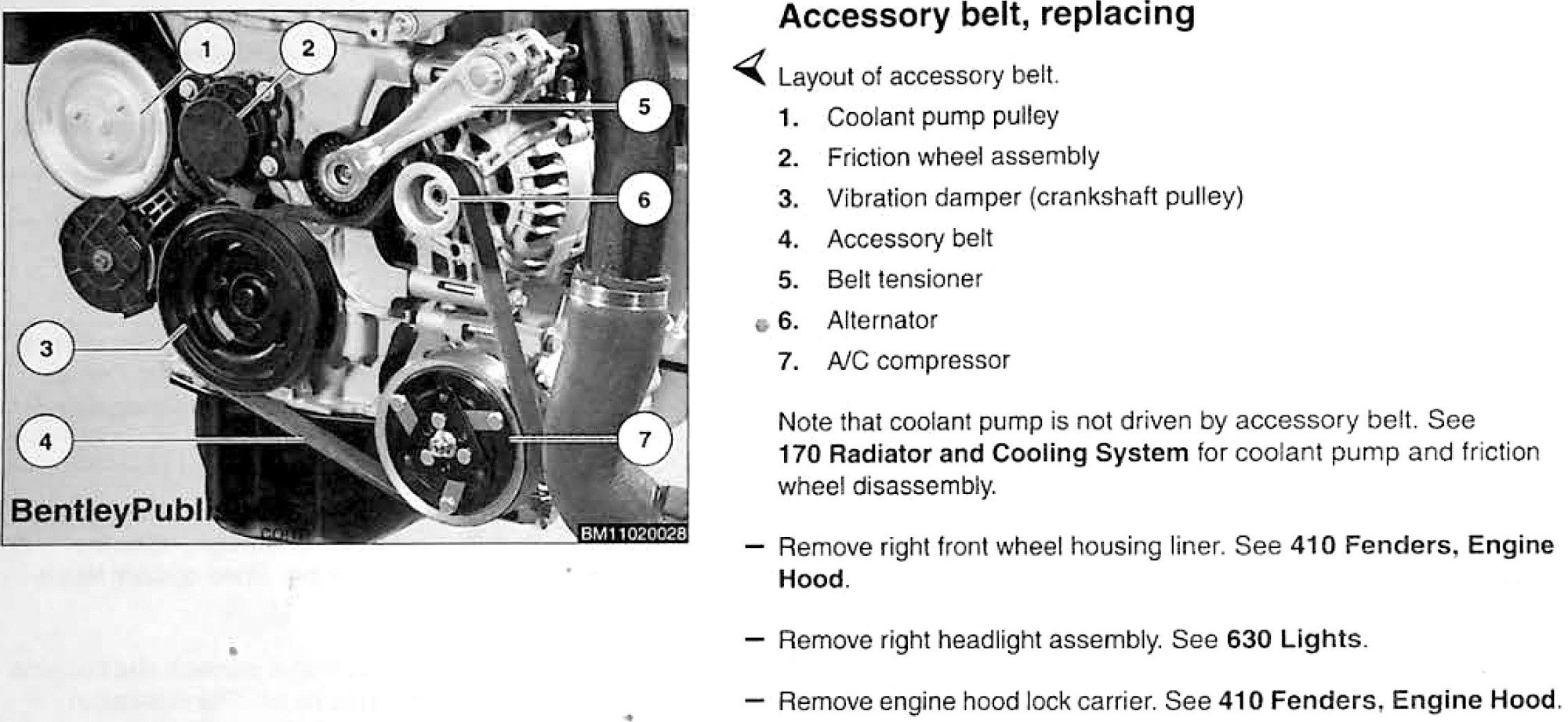

The leak is possibly from the water pump. Check whether the friction wheel turns the water pump pulley when the engine is idling.

I don't know where that is to look for it as I’m not aware of tech stuff. Any video that can help me perhaps?

Try to find videos of R56 water pump replacements, and that will get you pointed in the right direction. You will have to go in through the passenger wheel well.

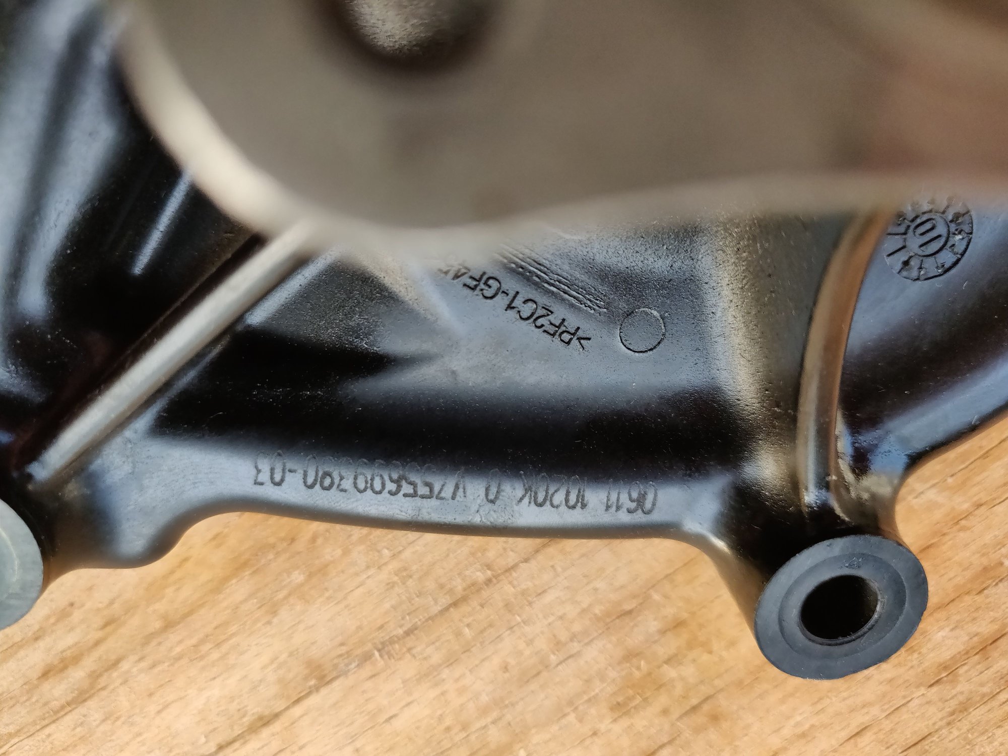

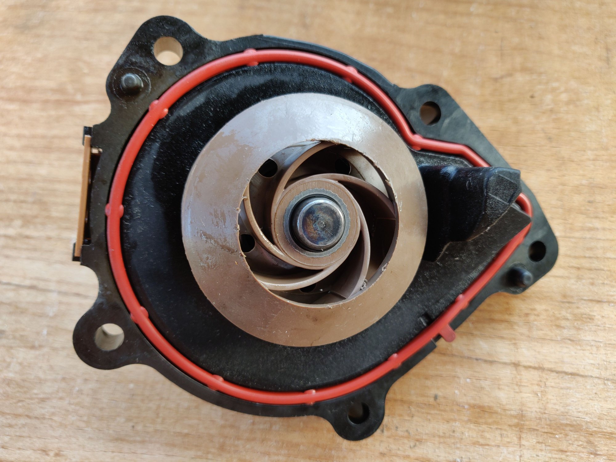

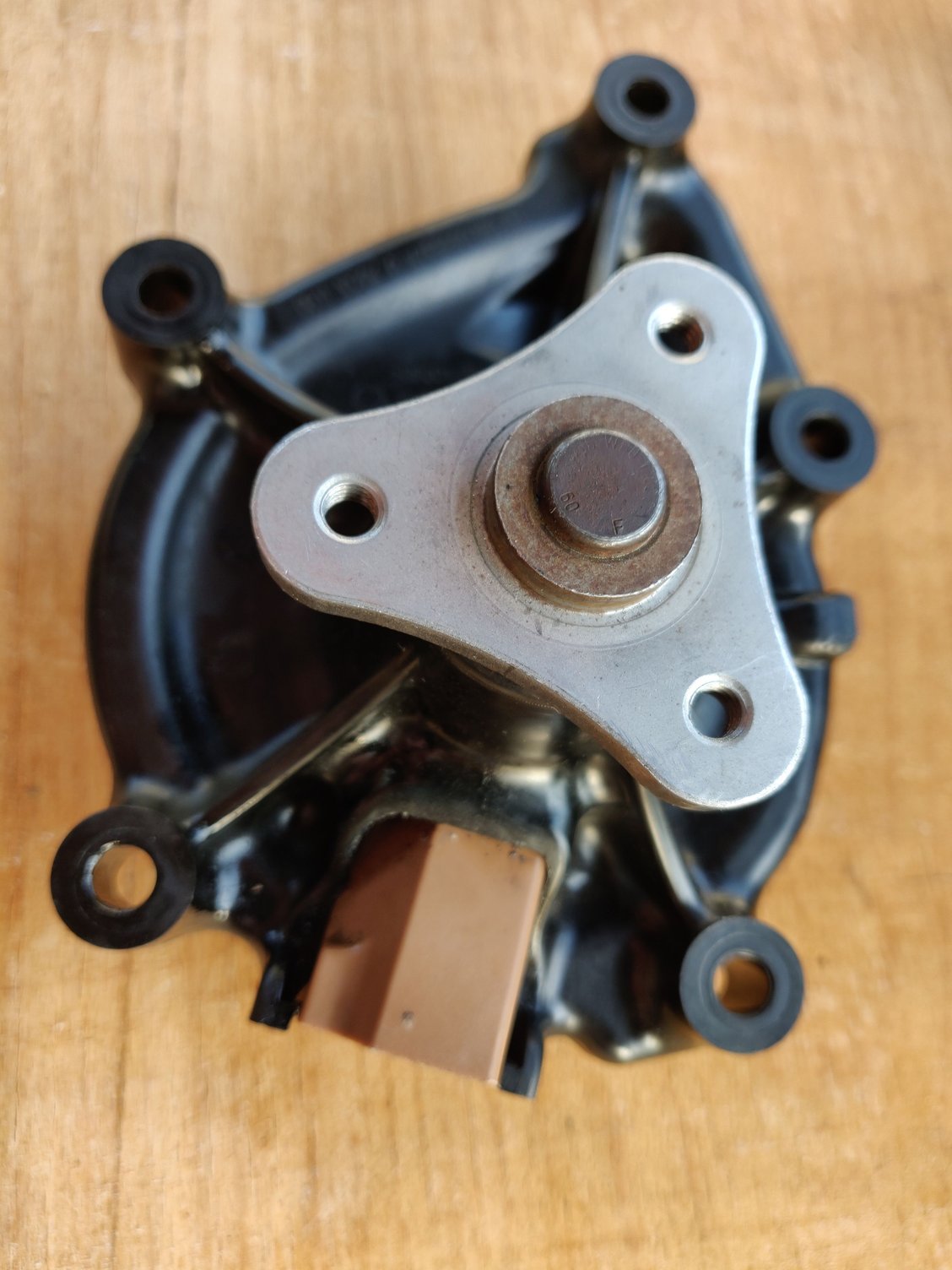

It was the water pump. They put on this and claimed it was OEM. Is GEBA oem?
Old May 29, 2026 | 07:26 AM
giorgos's Avatar
giorgos
Joined: Sep 2018
Posts: 528
Likes: 101
From: Germany
Here are some pictures of the factory water pump out of a 2010 N16. There was no manufacturer branding anywhere to be seen. Though the housing was plastic, it was glass fiber reinforced and of much better surface quality/precision than the replacement Dayco.
