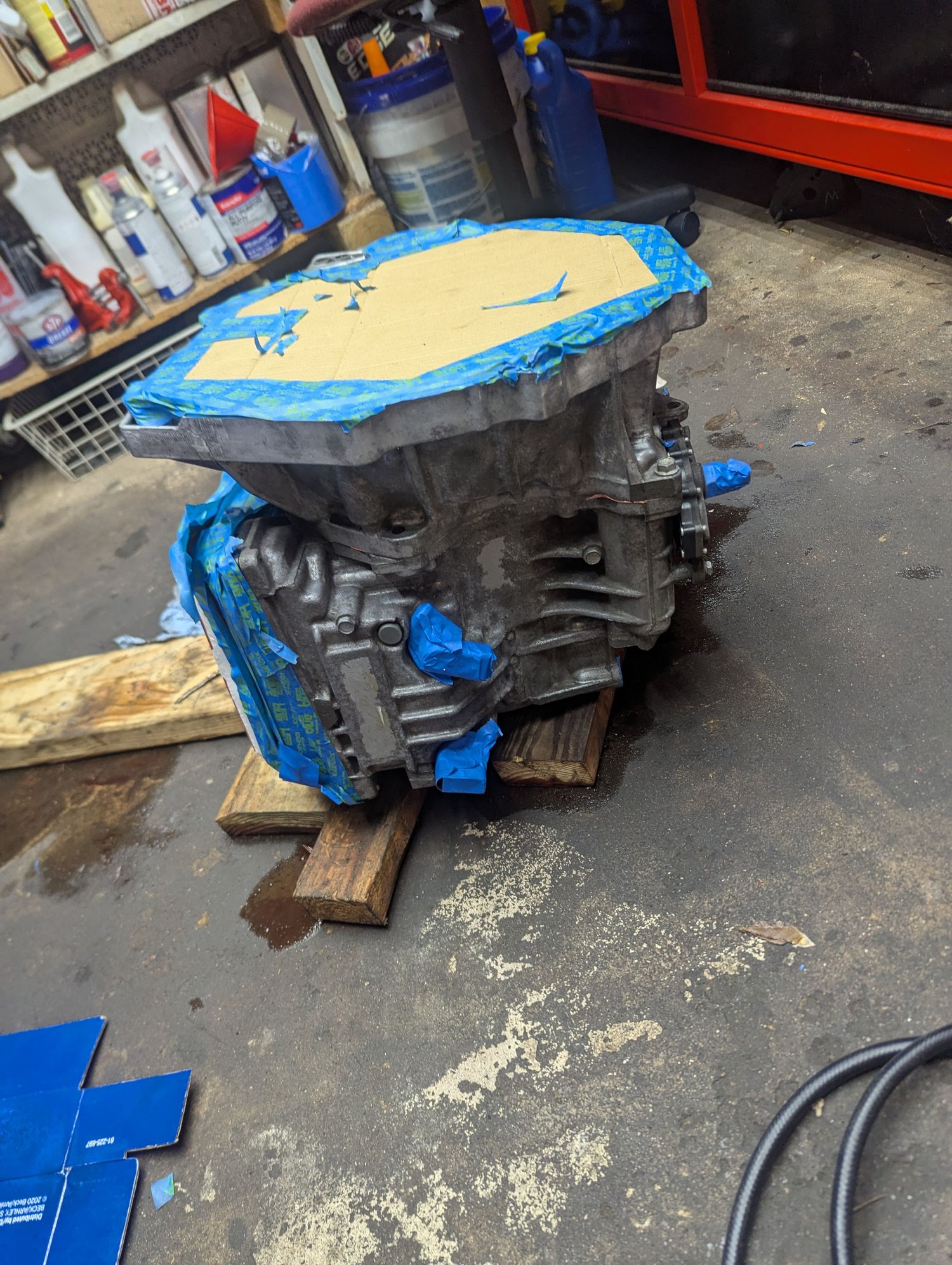

Update 3: Side quest- Painting Parts (R52S rebuild)

Primer
Primer
Parts cleaned!
Parts cleaned!
New N95 mask, and go pro.
prep
prep
masking it off
masking it off
some parts before
some parts before
before shot
before shot
transmission looking pretty, painted the cooler red so it pops.
While the engine block was at the local machine shop I decided to paint the transmission, the engine mounts, oil filter housing, supercharger and the intake manifolds. The plan is to clean the parts, put down primer then a few top coats of paint. Most of the parts are aluminum, so I used self-etching primer. And I decided on a 2K Paint from Eastwood for the top coat. The engine is getting 2k primer as well. It took me longer than I expected to realize just how clean I needed to get everything. But I did have time to kill. I used a combination of degreaser,, green scotchbrite pads, and a brass wire brush. Cleaned off with acetone and put down 2x of primer on everything. I couldn't believe how great it came out! I never did so much prep for painting before, but it makes ALL the difference I used Alumiblast for my top coat, it made everything look brand, spanking new. I got a good N95 mask too cause those fumes at toxic. The intake manifold and supercharger horns got a top coat of the VHT Wrinkle black, which may not show it in the pics but looks nice. I'm going for an OEM plus look. Engine came back, so I hit it and the engine mounts with the Eastwood 2K black engine paint. I still don't know if it'll run, but it's gonna look good either way.😊

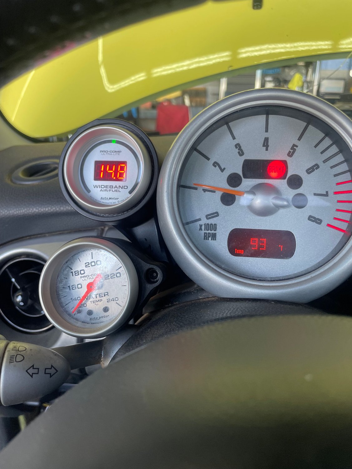

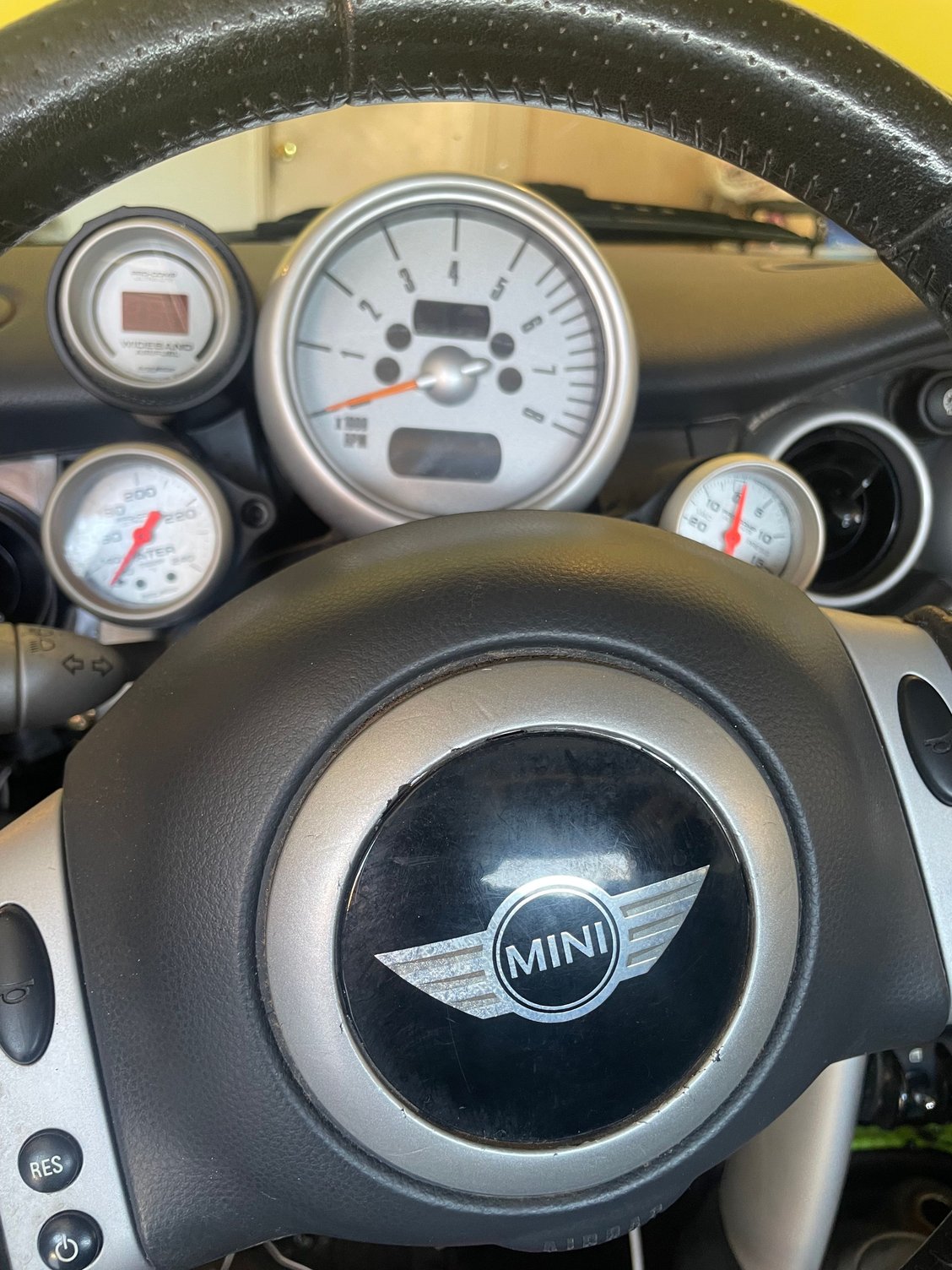

I'm so envious! I wish I had planned oil pressure gauge when I had my engine out.
I have a question to your question: what is the benefit of hooking wideband output to the narrow band ECU input? Is it capable of understanding and reacting to that input? Between your wideband AFR options, I lean toward AEM over Innovate but I have no good reason why.
As I also like the look of the AutoMeter Ultra Lite gauges, I have their boost, water temperature and wideband AFR gauges in my car. My AFR gauge (AutoMeter 4379) is output capable, but I only use the wideband sensor for the gauge.
Here they are installed:
and operating
