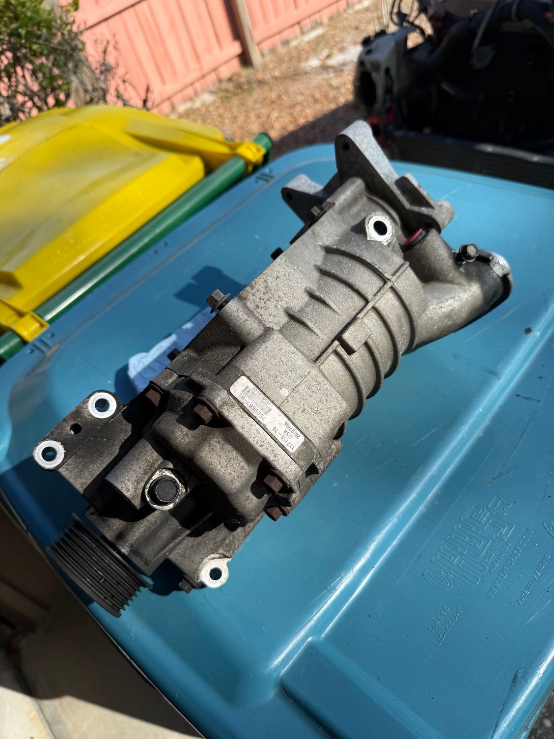

I’m doing some major preventative work on my 06. Considering a SC pulley upgrade…I’ve looked at Cravenspeed and Alta 15% pulley’s, but I’m open to get some opinions from others here. In the process of cleaning things up a bit, and working on some other upgrades as needed. Thx!

All SC reduction pulley's mentioned are good choices.
I have a 15% WayMotorWorks pulley currently on my daily R53 and a 17% CravenSpeed on my refurbished spare.
You will need to get an SC pulley puller to remove the factory pulley off your current SC. You should be able to find a new one for about $65.
I documented refurbishing and replacing the factory pulley on my back-up unit; "Viable SC or SCrap...?" - if you scroll down to post#12 ; There maybe some useful tips on how I made the pulley swap on a bench.
You'll also have to get/run a smaller diameter belt to match the % of the pulley you decide on. You'll also need to change out your plugs with colder sparkplug's (e.g: NGK BKR7EIX) was recommended when running a smaller SC pulley. New(NGK) plug wires would be a good thing to add as well....
All of this info was gleened from those smarter than me

Good to know! The smaller belt and the plugs I did read about, Cravenspeed has a complete kit (including puller), but new plug wires I wasn’t aware of. The car came with a different coil pack too; it’s red. I think MSD? Should I leave that or is there something better to complement the new upgrades? Thx!
