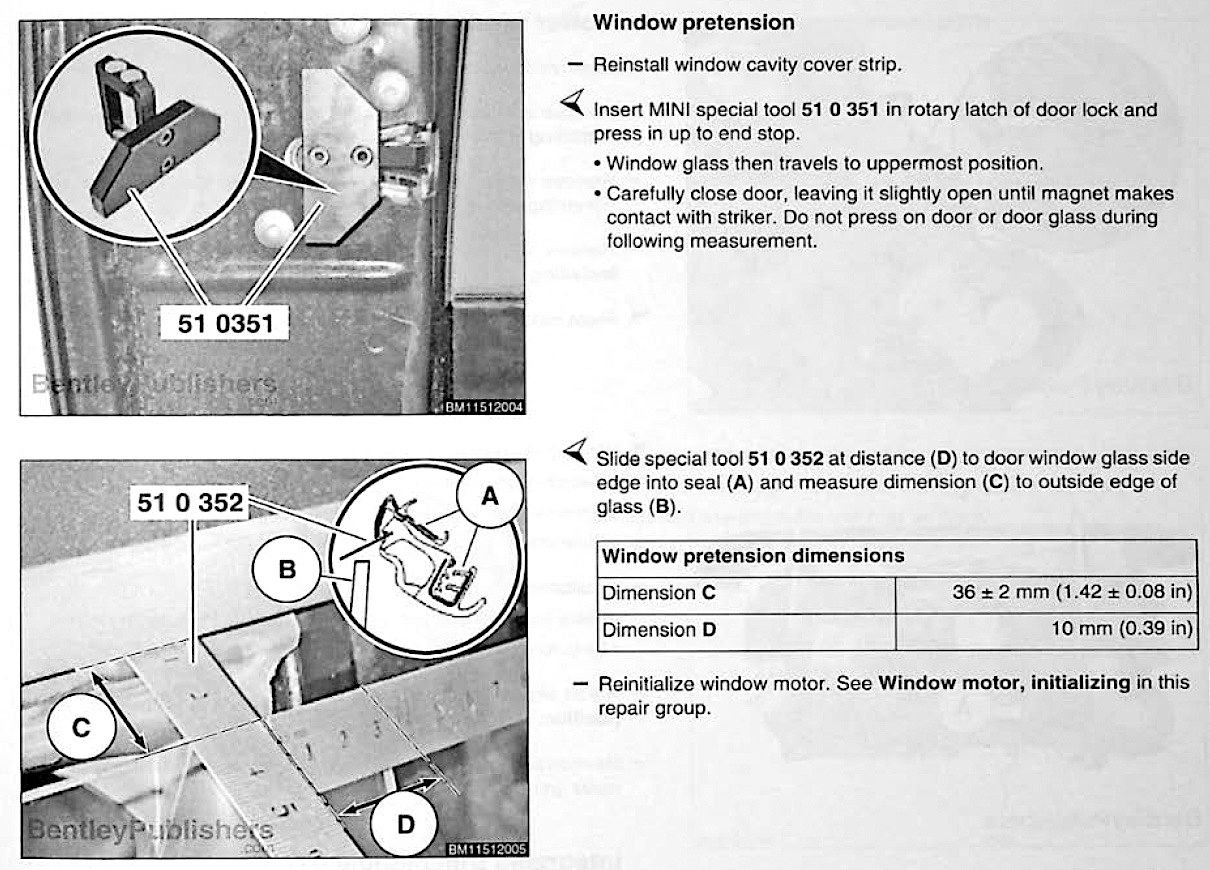

If possible, remove as much of the old grease as possible (the silicone spray may help do this) and then completely replace with silicone lubricant.
If you want to DIY repair your Mini, I recommend that you buy a Bentley manual, which is not perfect but is superior to the alternative of flying blindly. For example, the images below show the section on adjusting the glass position.
Very cool - thanks for sharing! I'll definitely pick one of these up. I've had a lot of luck finding YouTube videos for the larger jobs, like the clutch replacement, but less on smaller jobs - looks like this would be very useful.
