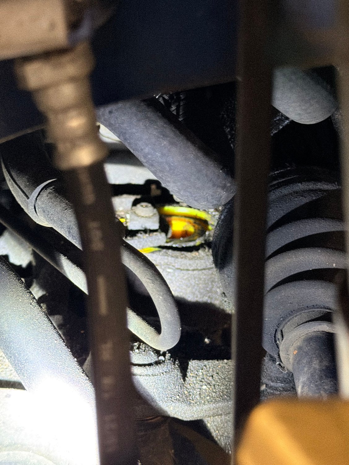

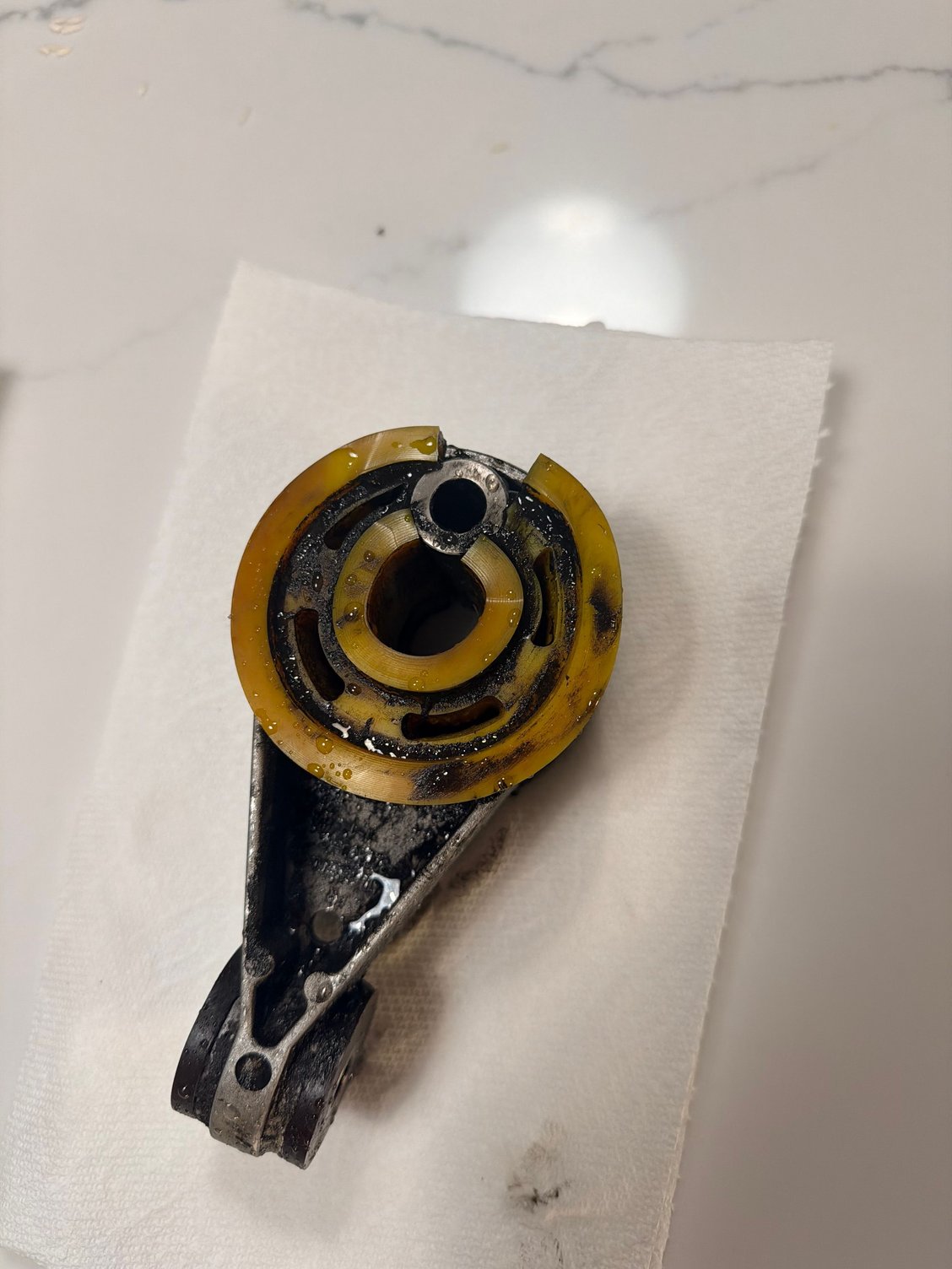

I installed the power flex bushing kit about 7yrs/30k miles ago on my ‘05 r53… when I was accelerating from a stoplight earlier this week, I heard a loud/weird sound. Almost like a tire was rubbing the fender - to be fair, the ac and music were blasting, ha. I immediately pulled over and cut the car off. When I restarted the engine, no noise but when the fan kicked on for the ac it happened again. I was about 1/2mile from the house so I limped home. Looking over everything, I saw the clean yellow bushing through the passenger wheel well. Hind sight being 20/20, it turns out the entire engine had shifted forward just enough for something to hit the fan. I attached a couple pictures below.
Yes, I know everything is covered in oil. I’ve had a valve cover leak, oil filter housing and cooler leak for a while. I replaced those gaskets and used 3 or 4 bottles of break clean and degreaser while I waited for a new lower mount to get shipped. Everything is back together and good as new!

Wow - That's odd.
Urethane is generally impervious to solvents (with the exception of toluene if not mixed/cured properly)...
I've NEVER seen urethane swell or "break down" like that before.

YOWZA!
that is a catastrophic failure!
i remember when i ran that version i thought it was overly vibratory, but i did not remove the black insert which would've made it more compliant because i had concerns about the empty voids making it structurally unsound & by the looks of yours it appears as a collapse because those voids perhaps?
were you running it without the insert?
that 95A insert durometer black formula is super stiff,
the yellow is 70A which is considered soft cruiser style with skateboards
i changed over to the fancy badboy they make, 80A purple/70A yellow

Wow so i wasnt the only one!
Funny story.... Mine failed within 300km, only being 3 months old. Purchase was still fresh so I contacted Powerflex, I asked them if I can pay the difference and get the full mount. I ended up talking to poweflex UK, who referred me to US. Somewhere during that transition somebody missed something and the full mount showed up at my door.
can confirm i was running the black insert when it failed. It did vibrate like mad, more then the full mount.

interesting that it appears to be the same failure pattern, like a shear, in the very same stress spot.
wonder if they had a bad batch? Or is this an inherent design flaw due to material/construction choice?

It does make me wonder why the failure/ split in the same location?
Does Powerflex still sell that style of inserts?
I opted for the Yellow Powerflex inserts. Leaving the large end of the bone with the OE black rubber, sandwiched between Powerflex yellow inserts. The small end of the bone was gutted and replaced with Powerflex purple insert.
It's been more than10k so far and all seems well.

@Here2Go I have a feeling yours will last. Them voids have to be the cause of failure on our design.
They do still in fact sell the failing one, PFF5-120.
I purchased the Gen 1 handling pack PF5K-1004 which that bushing is part of also.
@JRoze Powerflex has a lifetime warranty providing you are the original purchaser with proof. They were great when i dealt with them, ask them if you can pay the difference for the full mount. Worked well in my favor!

Dug deeper myself and found all the failure pics, not only did mine fail at one of the openings, but also the up and down offset portion to boot.... almost self explanatory
