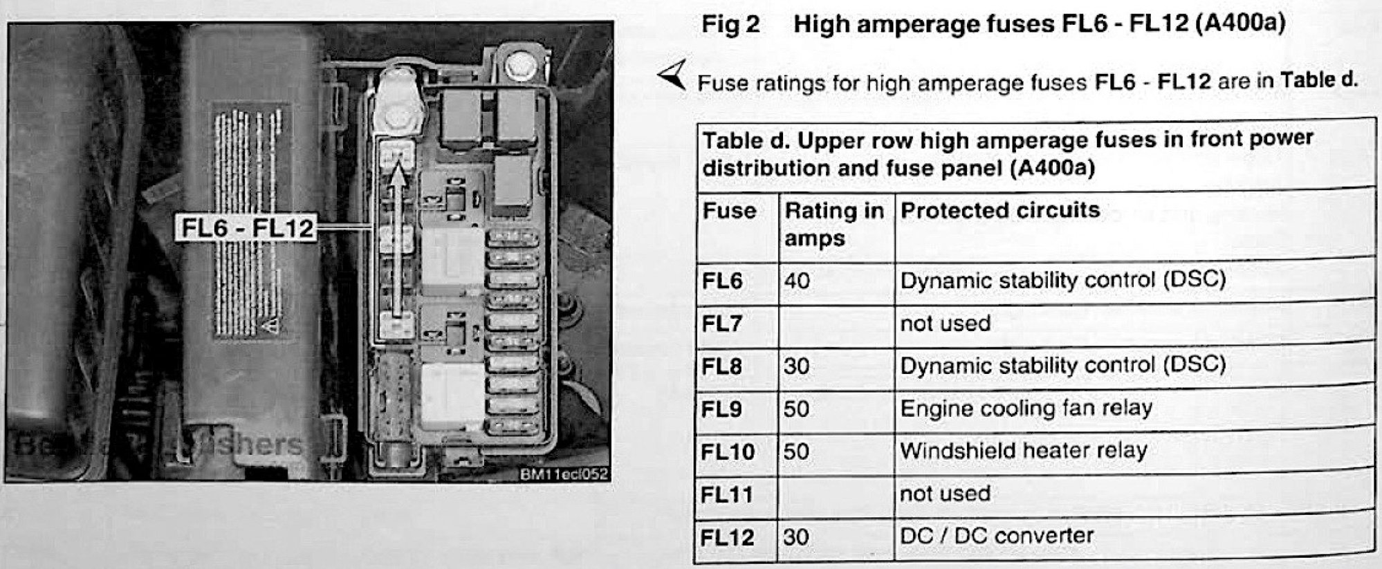

Ok , sooo is it missing a fuse here for the dme ??? Next to the 40am I'm pointing at ???
because I swear there should be one there

Old May 29, 2026 | 02:46 PM
Maybe, maybe not's Avatar
Maybe, maybe not
Community Builder
Community Influencer
Joined: Jul 2023
Posts: 1,577
Likes: 215
FL7 is an empty slot
