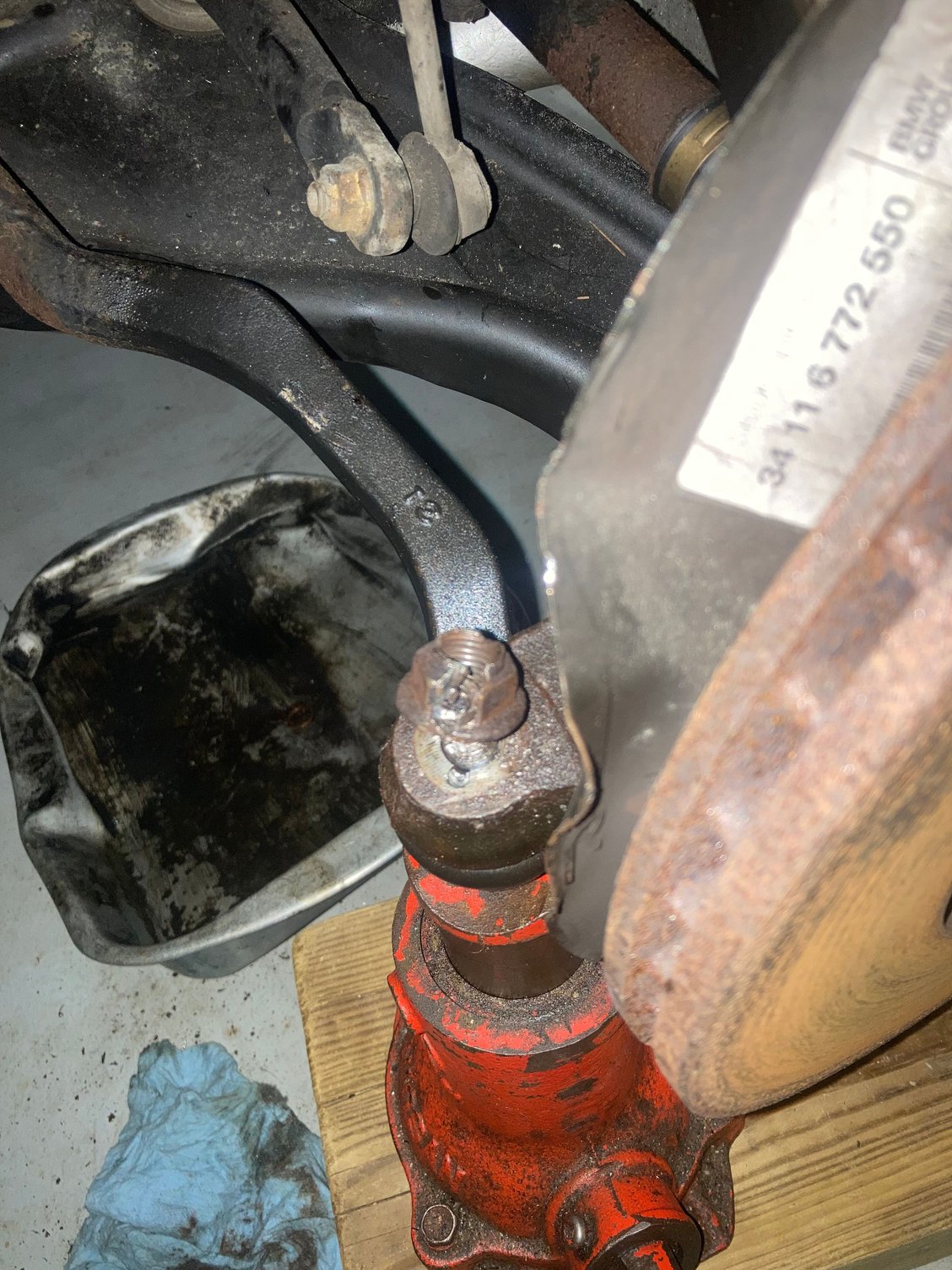

Okay so after I got rid of some of the material of the nut the Jack underneath worked, using a drill cutting holes in nut.
And the arm nut was loosened with some more heat, Question is to change the boot on this arm is there access to reach the inside attachment of boot? It is becoming more obvious as I get things apart to get everything back in alignment will be a challenge!

Steering joint arms are some stubborn I heated several many times even set up blocks under the joint in question in picture above to wack it with a ten pound! I think the issue is getting enough leverage on the two arms.
at this point I am just soaking with blaster once a day for couple of weeks see what happens.
the drivers side shock at one point fell out of the knuckle but waiting to get everything movable so I do not damage new parts.

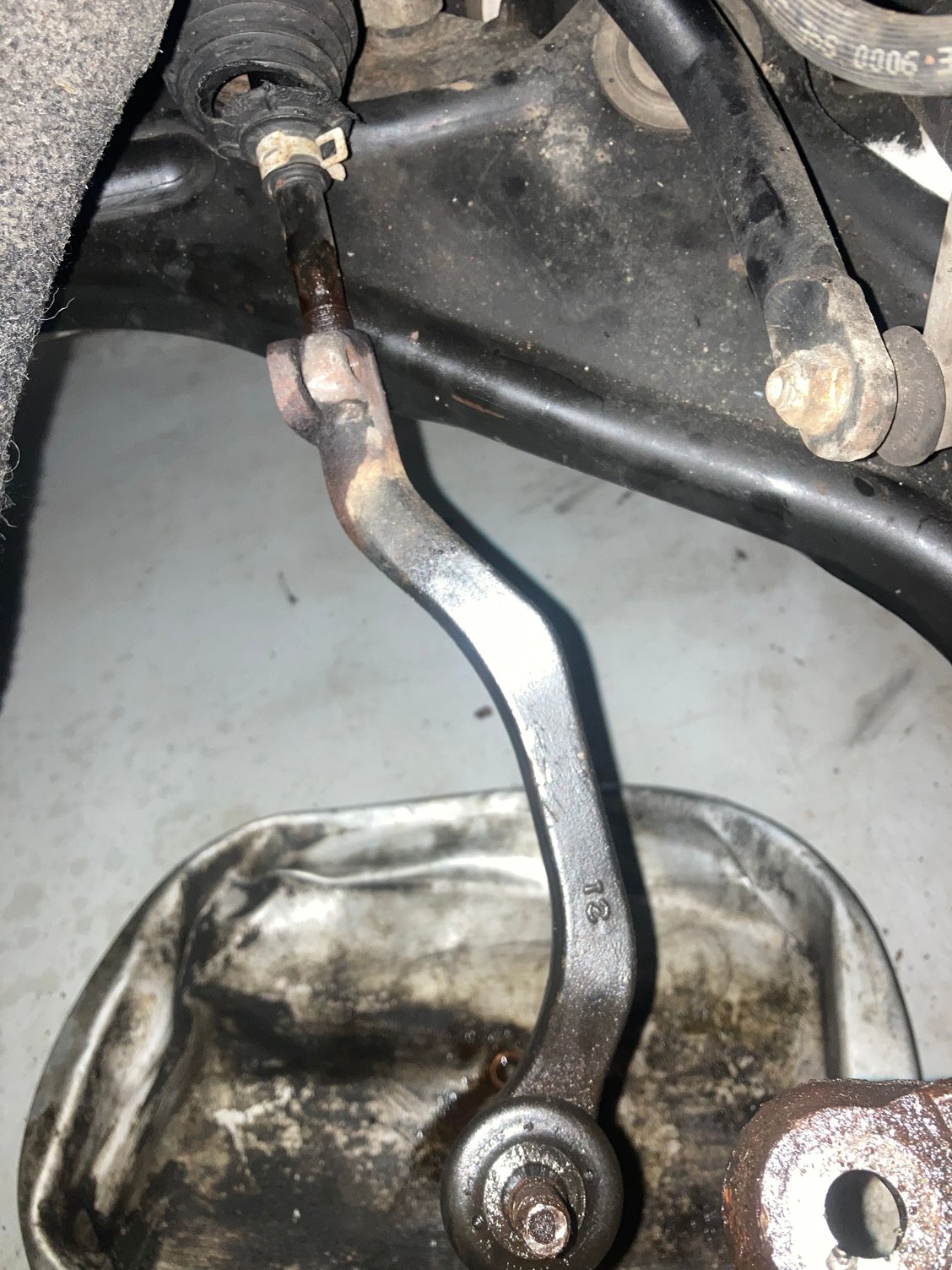

Appears I will need to lock the inside section of steering arm, this has flat sides just inside of the threaded joint that is rusted.
with a wrench on this it will just rotate out of wrench.
is there any option besides a vise grip of which will likely destroy those flat sides of steering arms?

If the steering rod is frozen inside the tie rod, and heat won’t get them to budge, time to replace both.

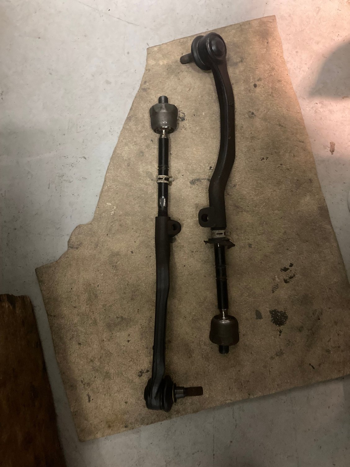

Okay now I see what you are saying as yes the outer two rods are frozen together.
I got it on will when time avails see how it fit over inside attachment get the bleeping arm off.

The inner steering bar attaches to the steering rack inside end of tie rod.
do you leave the inner connector attached to the rack & replace the tie rod & ball joint?
looks like you cut off the rubber boot to get the adaptor onto inner connector to remove tie rods.
the end of tie rod attachment to steering rack I assume you can leave & attach new arm.
