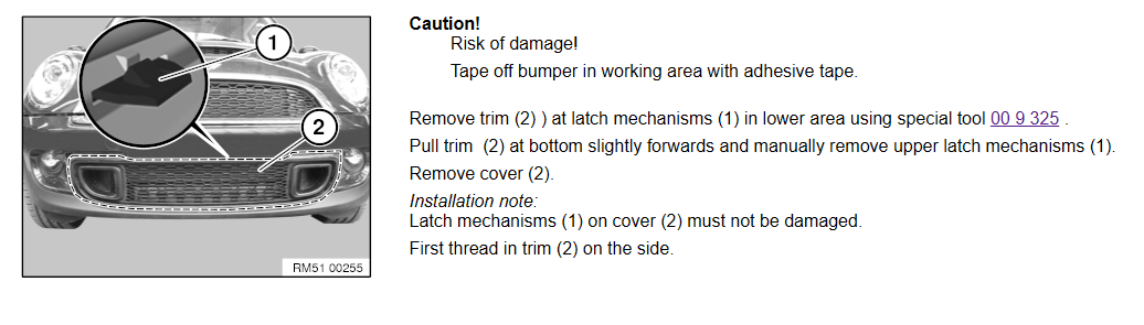

Any idea how to get the LCI bumper off? There seems to be 2 or 3 screws holding it on to the lower bumper bar that only LCIs have, but the bumper lip obstructs access to them so Im at a bit of an impasse and it's driving me insane.

The issue is the 3 screws under the secondary bumper bar wont let the bumper move and the bottom lip/trim on the bumper is too far forward to access the screws. Ive tried pushing the lip back to access them to no luck and the lip goes too far back to try and push it forward to access them.

Did you pop the grill out?

Yes, the grill, the 4 torx t25 screws (2 behind fender arches 2 behind grill), the headlights, and the plastic clips are all removed. The only things left are the screws into the LCIs lower bumper bar of which I cannot get proper access to.

OK, I just went and checked the newTIS information, and they want you to remove the lower grill and trim first:
Maybe that's what is getting you hung up. I have to admit, though, all the times I had my front bumper off, I never removed that part first. Maybe when putting it back together, you skip those screws for next time?

Hmm, I'll look into that, but I dont see how removing that will get me to the downward facing screws.

Do you have a picture of what you're looking at? I am having a hard time picturing these screw locations...

Not my photo. Though my lip is further forward than this picture making that screw inaccessible.

Interesting... I honestly don't remember there being screws that deep in there. I only remember screws and clips visible in that location - nothing hidden under the lip like that. If I were in your position, and they were preventing me from removing the bumper, I'd be tempted to cut them out, and forget them when putting everything back together.

Yeah, there's next to nothing out there that discusses their existence out there, even on lci specific posts/videos. It's just so frustrating because this should be the easiest step of the process and Ive been hung up on it for so long.

I'm guessing someone had the bumper off before and botched the reinstall
Do yourself a favor, and get the bumper hardware kit:
P/N 51112411406
The kit includes and assortment of the clips and screws for bumper installation.
