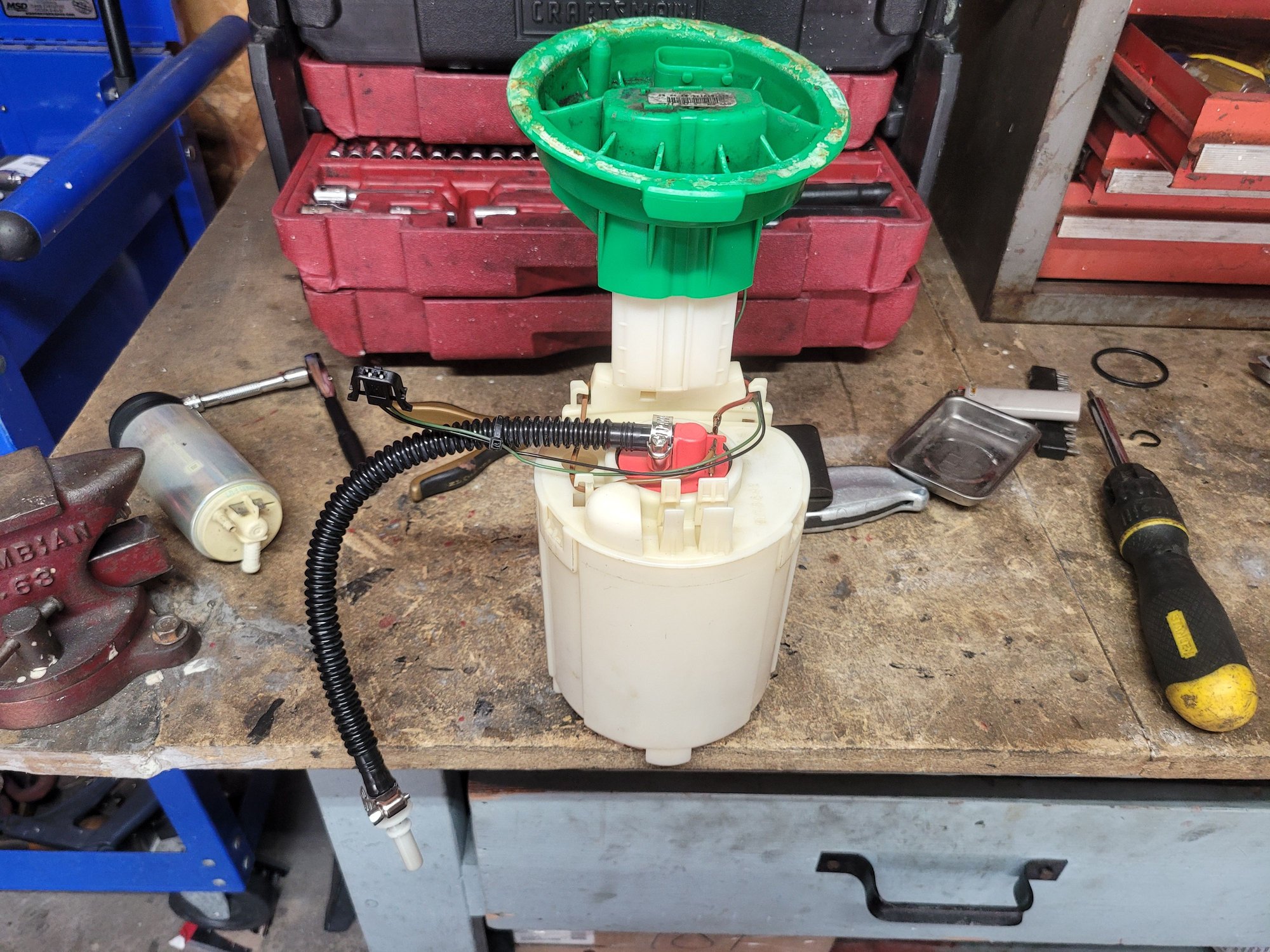

Soooooo it's building 18.5psi now on stock ic. Idk , it seems the same as with the grs. No quicker but not slower.. the iats are abit warmer by 15-20degrees all around..
the 340lph fuelpump and new fuel filter kit has arrived so I gotta run down the gas tomorrow and then Monday I will probably swap in the larger fuelpump.
the aftermarket intake should be here aby day now and the guy who sold me the hood said it should he getting picked up and enroute the 9th..
idk if it will be getting the ns1 cam now because the cam id ordered i thought was 1x step under the 469 BUT its 1x step ABOVE . It's one of the most aggressive Cams. I was told tuning it on stock ecu can be very difficult and it drops alot of vacuum at idle so idk if I'm going to use it or try and trade it fir a less aggressive one..but I'm gonna talk with Adrian and see what we can do. Maybe I just say F it and do it , then IF I can't get it to hold idle it aftermarket ecu time...
here's the fuelpump I got , lol it's 35$ for a reliable 340lph oem fit pump. Its hard to find this exact model that comes with the new screen but there's another model # that's identical just without the screen. Aaaaaand I got the attachments for the davies craig water pump so now I cam run an electric waterpump and delete the shadt driven pump and free up some parasitic drain off the sc

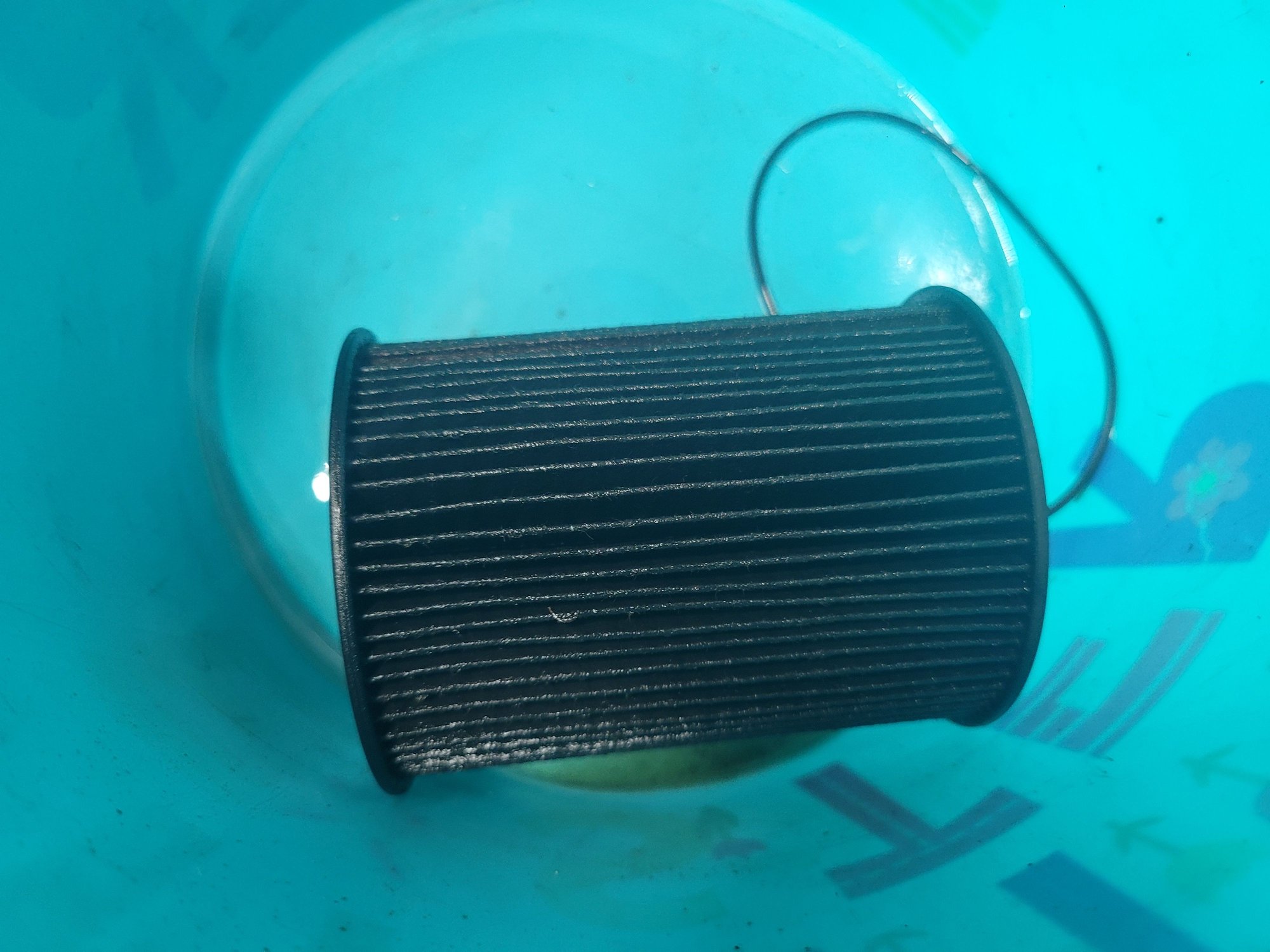

Well , that went smooth.. other than when I removed the fuelline on the pump side and taking a facial full of gas but other than that , it went smoothly.
I cleaned up the retainers and antirust coated them and they went on alot easier so itle be easier to service if i ever have to fir any reason.
I cleaned under and the sides of the seat cushion very well too befor i put it back.
I then took it around the block and everything seemed OK. I got into partial boost too with 0 issues. I will take it for a full shakedown later because I gotta run some errands so itle be the perfect time..
if you guys are on the market to upgrade your fuel system or even just refresh it , I HIGHLY recommend this pump. Its no different other than color and brand name than my 200$ 340lph pump in the other mini. So new filter and performance pump for under 60$ , you can't go wrong ! The pump ALSO is quieter than stock too so that's another plus. Either its quieter or the new filter and cleaning is making it run smoother than the oem one..
Theres 1x pump left available if anybody is considering this mod too.

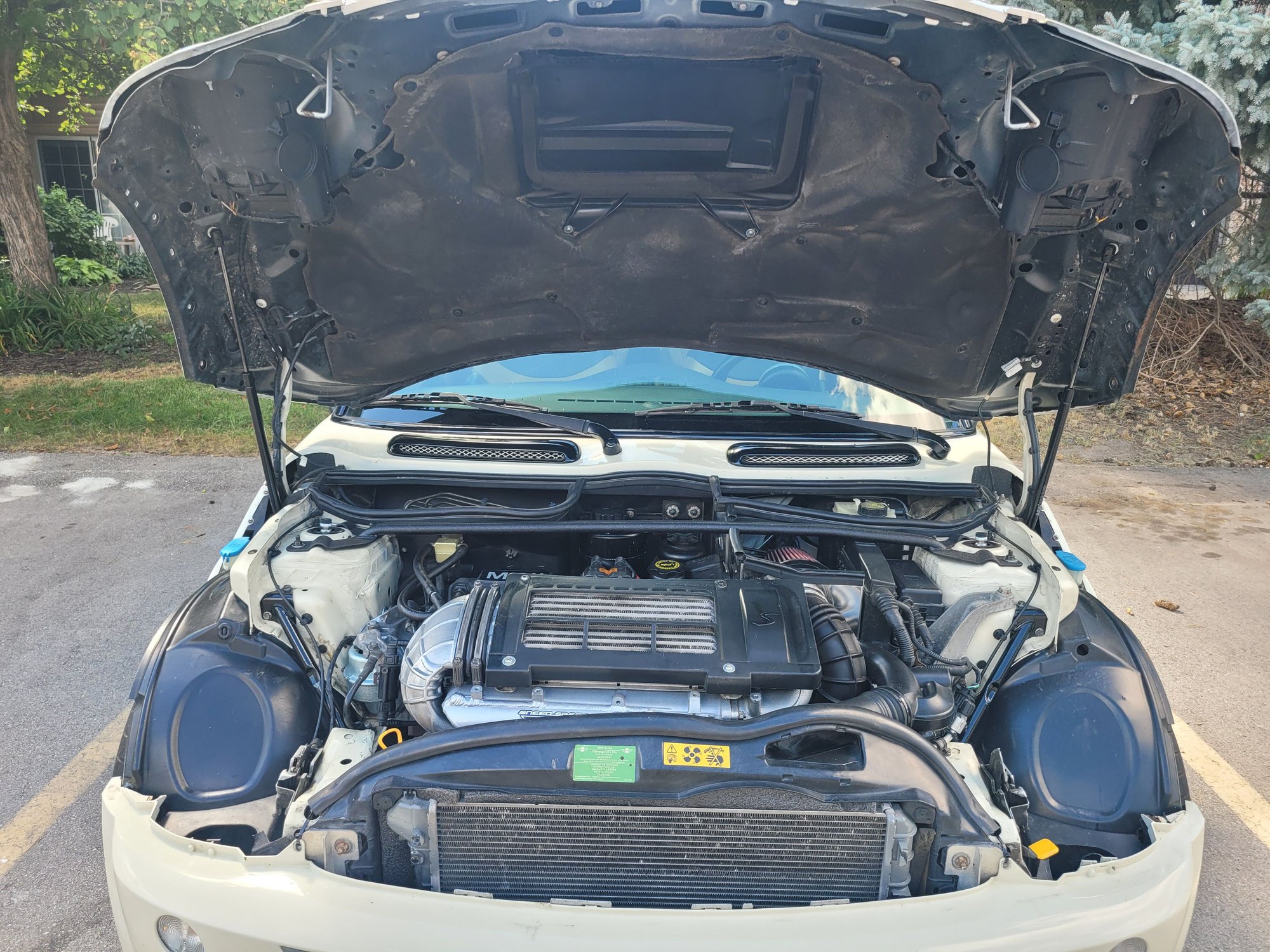

I need an extra hand to safely remove and install the replacement hood , then it will get a good wash and paint correction. I might need to order new fender flare clips BUT I got both side off without breaking 1x tab on the backsides and had one side not been 2x taped on ,I'd probably have had enough clips to put it them back on. Though I bought a side flares kit a few years back and I know I have stuff left in it but I don't think I have the correct ones left that mount the flares to the hood.
I will check tomorrow morning, it's getting late abd it's gotten HOT. So hopefully I get a helper tomorrow and get the hood on. O yea , I will need another grill too now..
here's pics , now you guys will see why I kept the bra on this whole time.
I very much THANK fellow member Arori for getting the hood packaged up well and actually willing to ship such a large item. THANK YOU VERY MUCH Arori !
