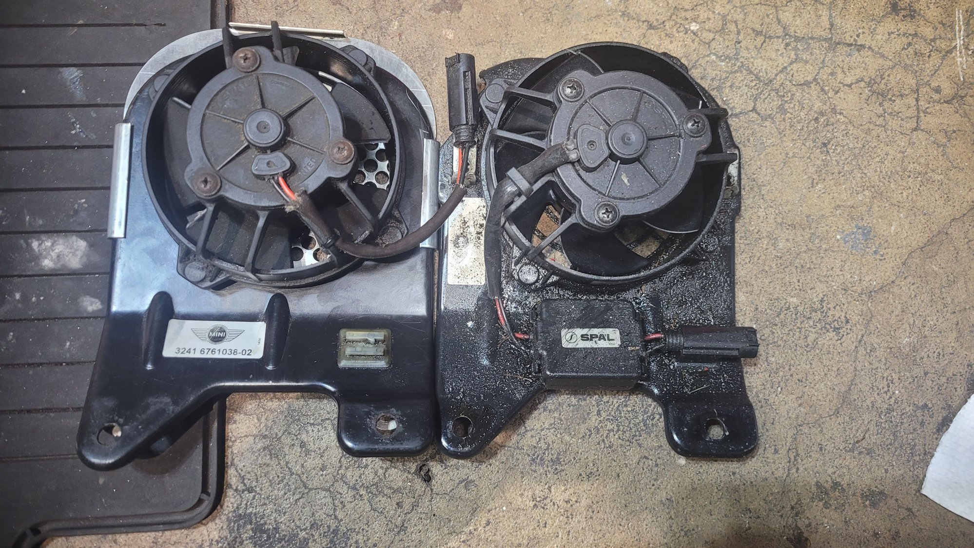

Put in a new , shielded powrsteering fan.
nothing wrong with the other one , I just liked the looks of the protective casing on it..
Any idea why one fan ( my old one ) had a box thingy inline with the cable ?

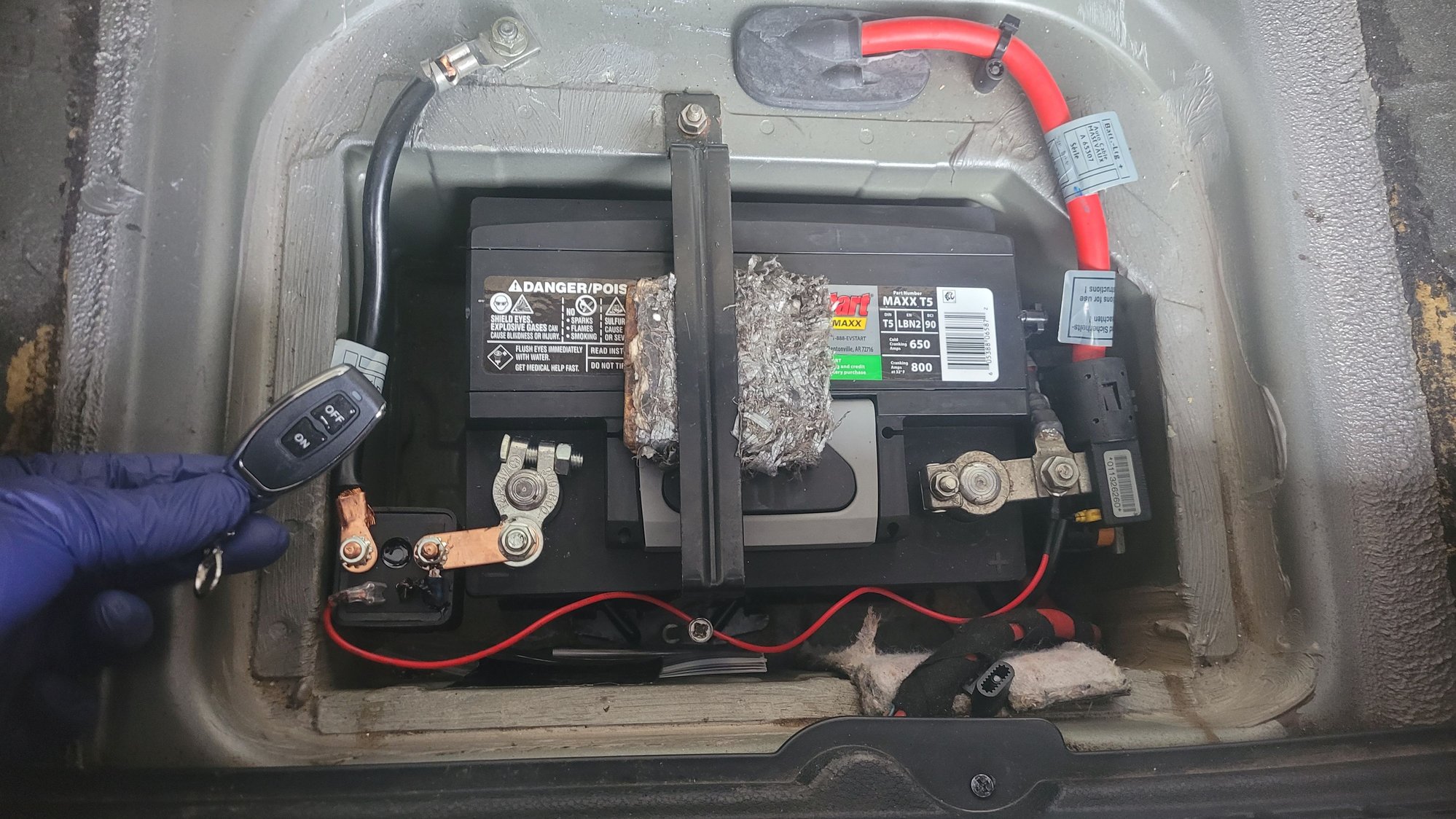

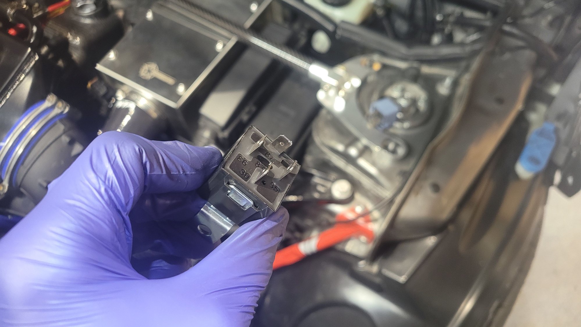

Good thing though. I stopped the battery drain , it was either having a 5x prong relay in a 4x prong slot OR my leds were draining through where I had em wired in.
the battery also came back as bad too so it got ANOTHER new battery.
I also ran the waterpump to a switch so it no longer needs to run fir 5min every time I key on , unless I want it to...

Found the cause of the parasitic drain , I had the wrong style relay in my waterpump harness. It was constantly grounding that circuit and I actually went out after the car say a few days to remove the old fuse and it was actually warm for continually grounding. So I know what destroyed my last battery now.
I hooked up a remote battery disconnect too but it's not really needed now though it is still very useful because i have a rear seat delete panel ect in my rear so climbing through the hatch to power on the battery after the trunk accidentally latches isnt fun. My underseat pull wire has never worked either ofcourse so now when I park the car for extended periods, now I just click the button to disconnect the battery, that simple !
