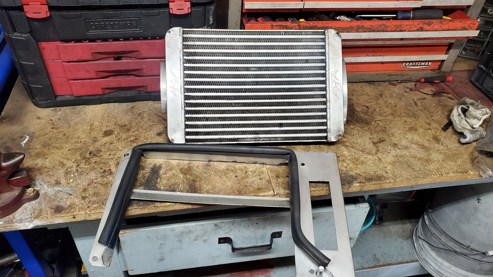

Ok.. wtf guys !!!
WHY IS THIS IC NOT TALKED ABOUT MORE !!!!!
This is the only , ONLY ic I've yet to try that has experienced ABSOLUTELY NO BOOST DROP , NONE !!!! It also cools better too. Ive had intercoolers that did flow better but they're cores were too small and they'd get wayy too hot.
this alta intercooler is absolutely amazing ! I can't believe I lost NO BOOST at all. I actually think the cars is making max boost sooner now.
This Is one of 3x ic's ONLY that ive found that use this type core , i believe its bar and plate and stock is tube and fin.
you can just look at it and see how much more efficient this type core is instead of cheap folded over fins. The other it's that I've tried that have this core are grs motorsport ( was the best until I tried this ) , an ebay hobo ( not the standard 60mm core , it was an odd brand ) and now this alta one.
recovery times are also excellent too. It doesn't spike temps. I just dont see why this ic didnt gain more traction. Was it too expensive when it 1st came out ?? Were they just really low production??
if you can find ANY info on this ic plz lmk because I'd like to read about it too. But im telling you this. IF YOU SEE ONE OF THESE come up forsale. BUT IT ASAP !
I just can't believe it actually outperforms my grs motorsport intercooler..

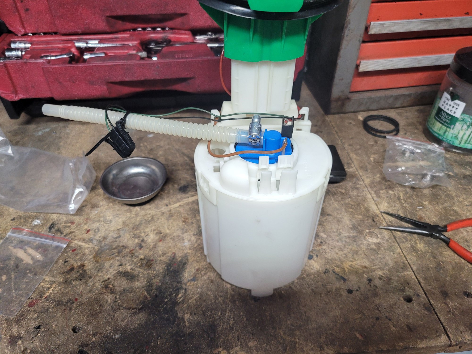

I FINALLY got in the 340lph fuelpump. Test started it and it fired rite up. Pump sounds great..I will be test driving it soon ( in MexicoCreek ) and uploading a drive along video and figuring out how to use my new phone. Hopefully video quality will be better with this phone..
here's pics of old and new.

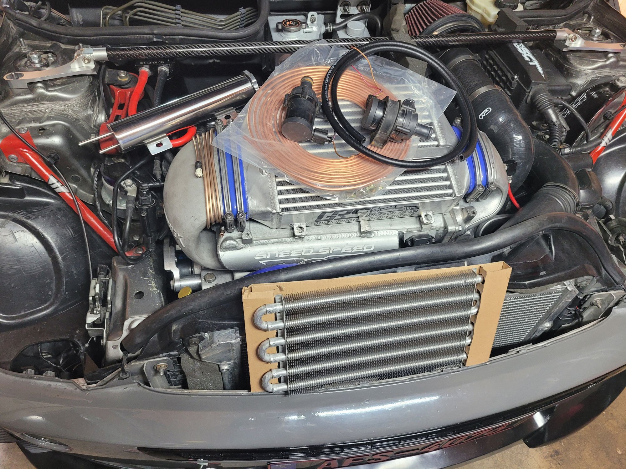

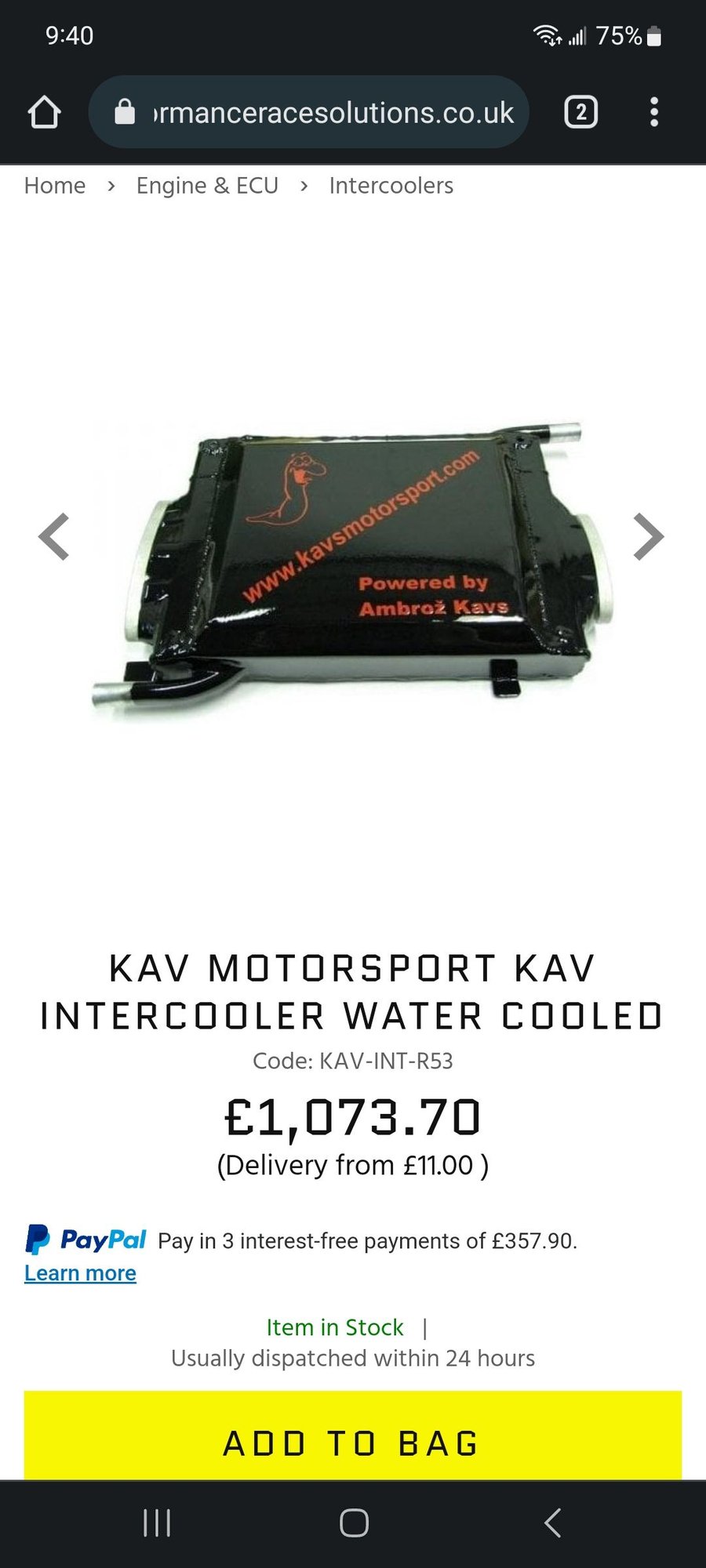

Kavs liquid cooled intercooler has been ordered..I'm ALSO working on making a heatsink cooling thing for the hotside of the sprintex..I begun test wrapping it and it looks like it'll come out exactly as I hoped but I wonder if it'll actually help..I am using copper and it's pressed all around the hotside horn.. It also will have a reservoir under the leftside scoop by the brake master and also a radiator I will mount infront of my coolant rad since it has the perfect provision to do so.it will be fed by 2x bosche intercooler pumps , one on each side of the radiator to ensure awesome flow..
I got to finish wiring in the wideband in the other mini and then i will finish this coing project.

What are you trying to achieve? Cooling that horn or the case? If the horn use the smallest possible meth jet you can. If the case itself keep in mind the rotor pack wouldn't be affected but if the case was cool enough it could cause expansions issues as in rotor pack expands with heat and case not as same rate could cause collision. Just food for thought. Google cooling blower case and you will find lots of info from non mini sources going back 50 years and their trials and tribulations. Just food for thought. I spray into mine and it keeps the whole thing cooler but not everyone wants to do that etc. Remember no matter how cool you make the air afterwards it doesn't add 02 denisty back to the charge that it had before it went in. Which in theory is why you want the air ingested in the first place as cold as possible to compensate for whats lost. Mis conception that if you cool the air back down even to say -20f it regains o2 density which sadly it doesnt.
Here was a good read on the case cooling if thats what your trying to do. ITs for a roots but just be careful that if the case itself was cooled enough and the inside rotors where the same when expansion happened it could be really bad day.
Are you spinning it at its max rpm ratio? Might be better to spin it slower and increase VE as a whole to keep it cooler and keep same power levels. Could also just look as a whole non mini specific what sprintex users do to keep everything cooler. Mini specific stuff is likely going to be limited and remedial compared to assimilating what all the other platforms do jeep toyota etc.
https://www.eng-tips.com/viewthread.cfm?qid=359156
Again link talks about roots blower but the same principles apply to anything designed to expand contract together and if one of those factors doesnt ie) made cooler.
Also keep in mine about the in tank fuel pressure regulator and if its fed to much pressure it will open bypassing fuel back inside the tank harming over all flow. Lots of folks might not know that exists and how it works to keep line pressure only at 4.5 bar -1 bar atmospheric for the venturi to pump back over the sadle. which is why some folks grab a r56 s in tank regulator. So bigger might actrually reduce your over all flow causing IDC to get jacked.
This is how ours works too fwiw.
https://www.northamericanmotoring.co...s-it-work.html

What made you decide to go with this style of charge cooler? Kavs as well? Nice thing is these styles use the factory intercooler as their base and then modified.

Ille look into that stuff you sent later tonight...i dont plan on it decreasing intake Temps I'm just hoping once the liquid cooled ic is on to have that in conjunction with my contact cooling mjiggy kit to help keep the hotside horn and as far down as possible ( hoping it would help the case and oiltemps abit ) to help protect and prolong it. If I can get it to not be dang near burning hot once you press you habd on it , I will be happy with that. And your rite , it might not to a darn thing but for the cost of the reservoir ( 23$) , why not try it since I have all the stuff on hand to do it..
The better iat's i hope to achieve would come from the kavs intercooler. I'm gonna have an auxiliary tank in the trunk, probably like a 3-4 gallon and have it be iced. I know it will only be great until the ice melts BUT I guarantee the watercooled ic will outperform the stock and my grs BOTH combined.. that Marion ic I had ran AT ambient Temps once the ice melted. The Marion just had a terrible core design and caused too much boost loss to justify such cool iat's.. the colder gains from the lower iats couldn't even be felt because it lost so much power with the boost loss. It robbed about 5psi..
my grs only robs 1-2psi but cools outstanding and it DOES outperform the stock ..I have backroad tested them back to back numerous times and they are close but the grs does do better for backroad spirited driving.
soooo if I can get the amount if cooling IF NOT better than the grs with the kavs BUT sacrifice NO boost , that's a win win in my book..
I'd like to just sat F it and spray the meth into the boost toob rite beneath the throttlthrottlebody but I really really don't wanna disassemble the car for the bagillionth time AND I have not heard back from Adrian in along time after emailing and pm'ing him numerous times so I've given up on that and have been looking into other tuning options..time miiiiiiiiiiiiiight come to go aftermarket ecu this off season..we will see..
