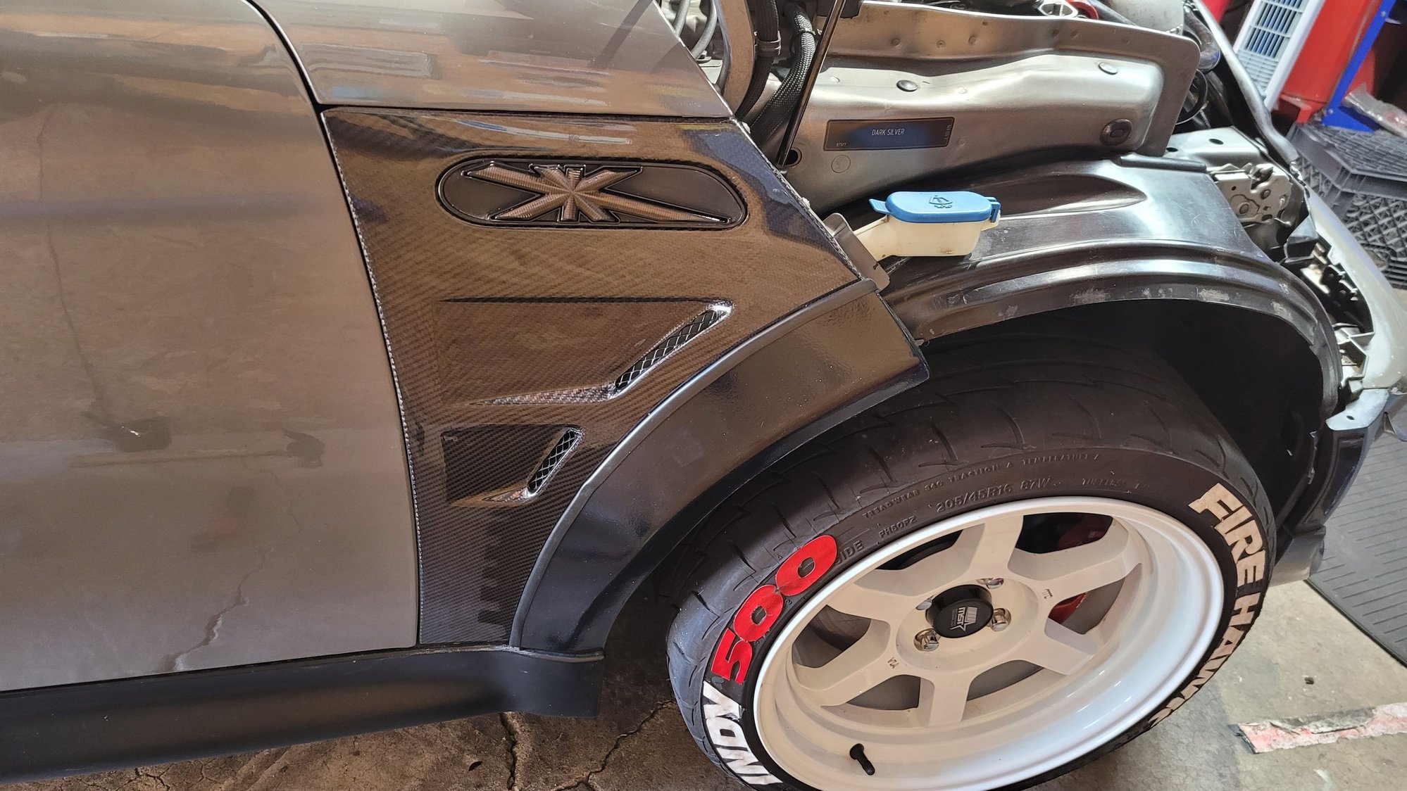

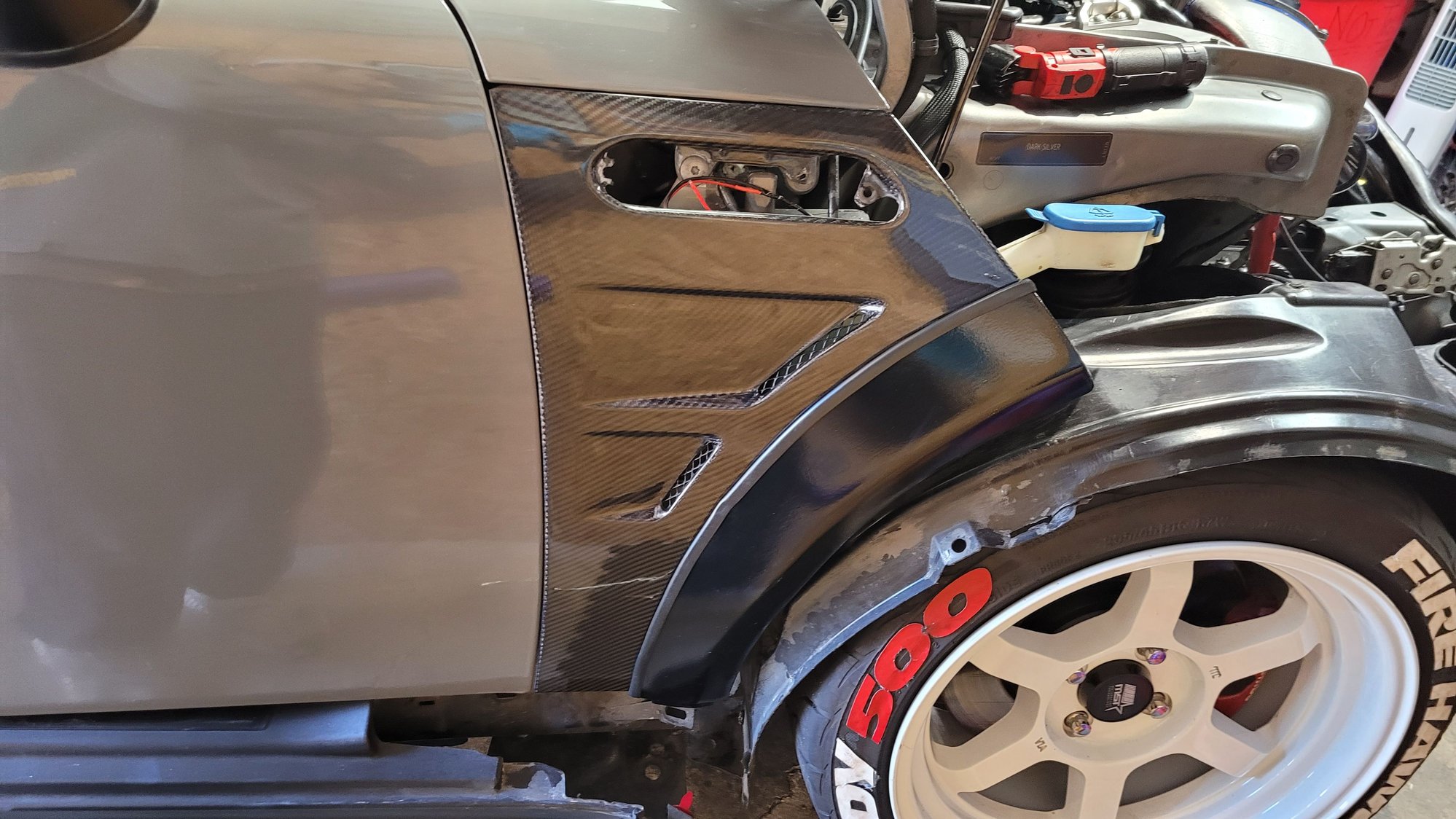

I will FINALLY be putting the fenders on tomorrow. I had to repaint the flares 2x and I've been up north working on mine n my pops properties..
I used a bead of window weld and then i use 1in black expanding foam to further enclose and hold them on better.
Then i got bored while I was waiting for the flares to cure onto the fenders so i started making an intake box / heatshield. The lid will be removable with push clips and it will screw to the firewall facia and bottom of the oem intake box in the oem screw spots. It's not done yet but it gives you a good idea how it's gonna look and function.
I'm also VERY MUCH considering having the 464catcam installed too.. I'm just kinda nervous to do so because I have gotten NO 1st hand feedback on the cam to know how it will operate as opposed to my ns1 cam that's in there now..maybe I will throw up a post asking if anybody has...

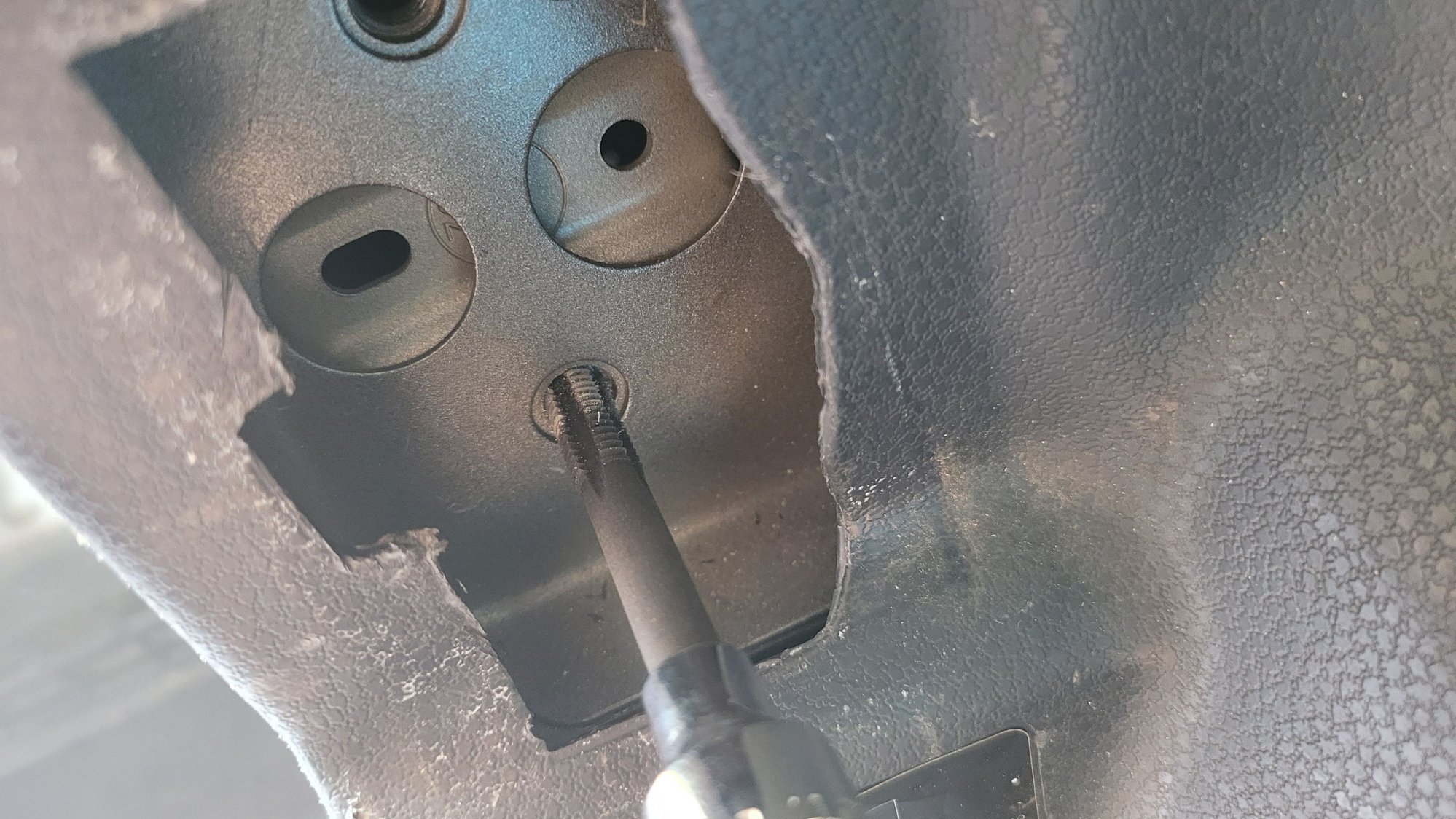

i had abot of a scare when i went to reinstall the rear strut bar , one of the bolt was wanting to cross thread. The musta got damaged because id over tightened it awhile back when I eliminated rattles. THANK GOD it easily retapped and the oem bolt went rite back in smoothly.
anyways , here's some update pics.

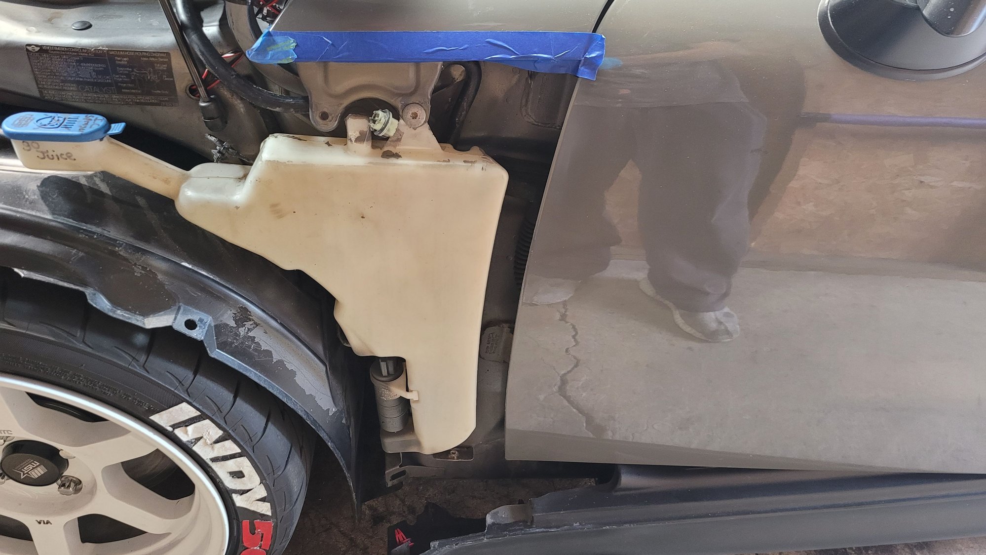

They've come out very nice. Not perfect but very very nice considering that they're a custom made to order part.. I'm VERY happy with them..
I did a little test drive until I realized, DUUUUUH I never secured the reservoir tank.. derderder. BUUUUT my garage temps were high 80s though it was low 70s outside so the cooler. But in a 10min drive iat went from 80'F down to 75'F lol.. and I did 1x good ,hard pull and OMFG this ic breaths baby ! Aaaaaaand on the pull the iat ONLY got to 85'F.. I can't believe how efficient this ic wlis going to be.. even with the BEST ic I've tested so far , on a hard pull at full boost 19-20psi it would get upto 150-160 for a few seconds and them immediately start to fall back down to where it was befor , usually around 110'F but the watercooled ic , it ONLY spiked to 85'F..fricken SWEEEEEEET.
I will get more pics n stuff soon and a drive along too finally to show you guys how it pulls.

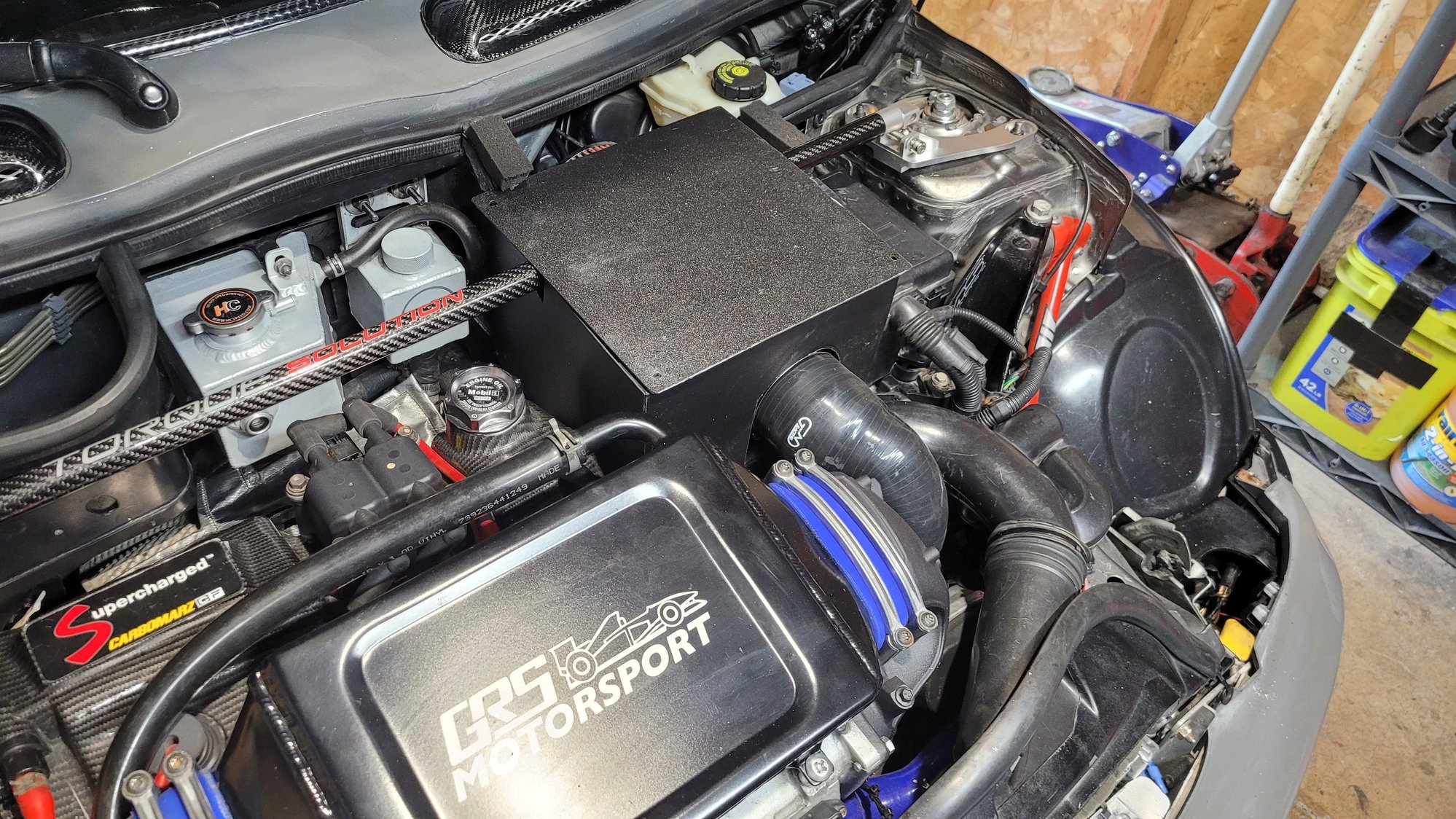

Since I'm no longer running the v12 tbody I decided to get am intake to match the throttlebody size so I ended up getting an alta intake and scored a ddm intake box off a fellow member... I've actually always wanted this intake box. It seals perfectly to the rear facia and hood so it does an amazing job keeping out hotair. And the rear scoops are going to be more efficient now too then.
the car doesn't seem to have lost any power either switching to a smaller intake without a velocity stack.
Also Imo it really makes it look alot cleaner and more potent when the hood is popped..

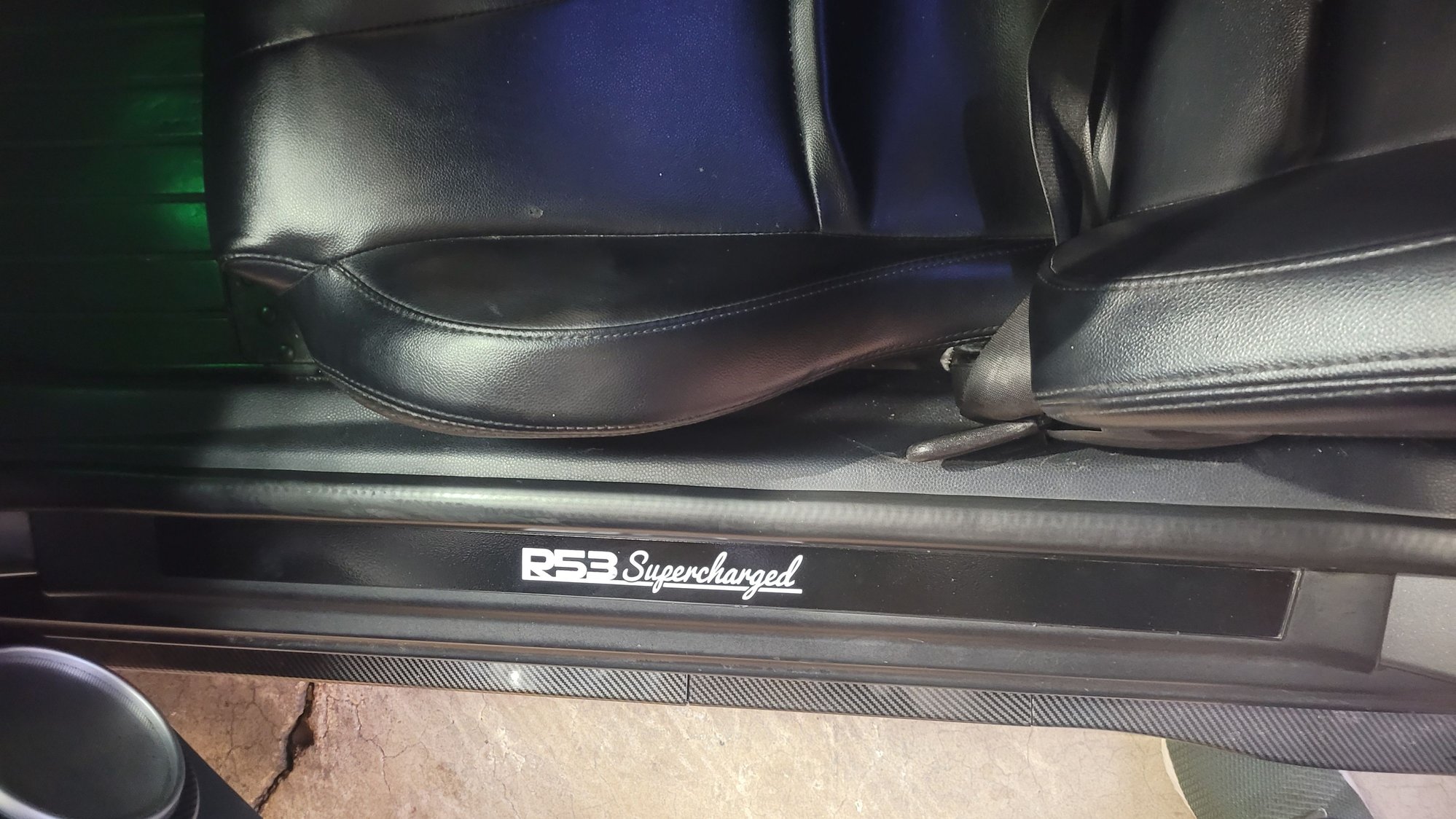

I also made a set of entry sill plates since I was sent 2x different ones. I just painted them , put on the decals ( they match decal on my dash )and then I clear coated over them.
