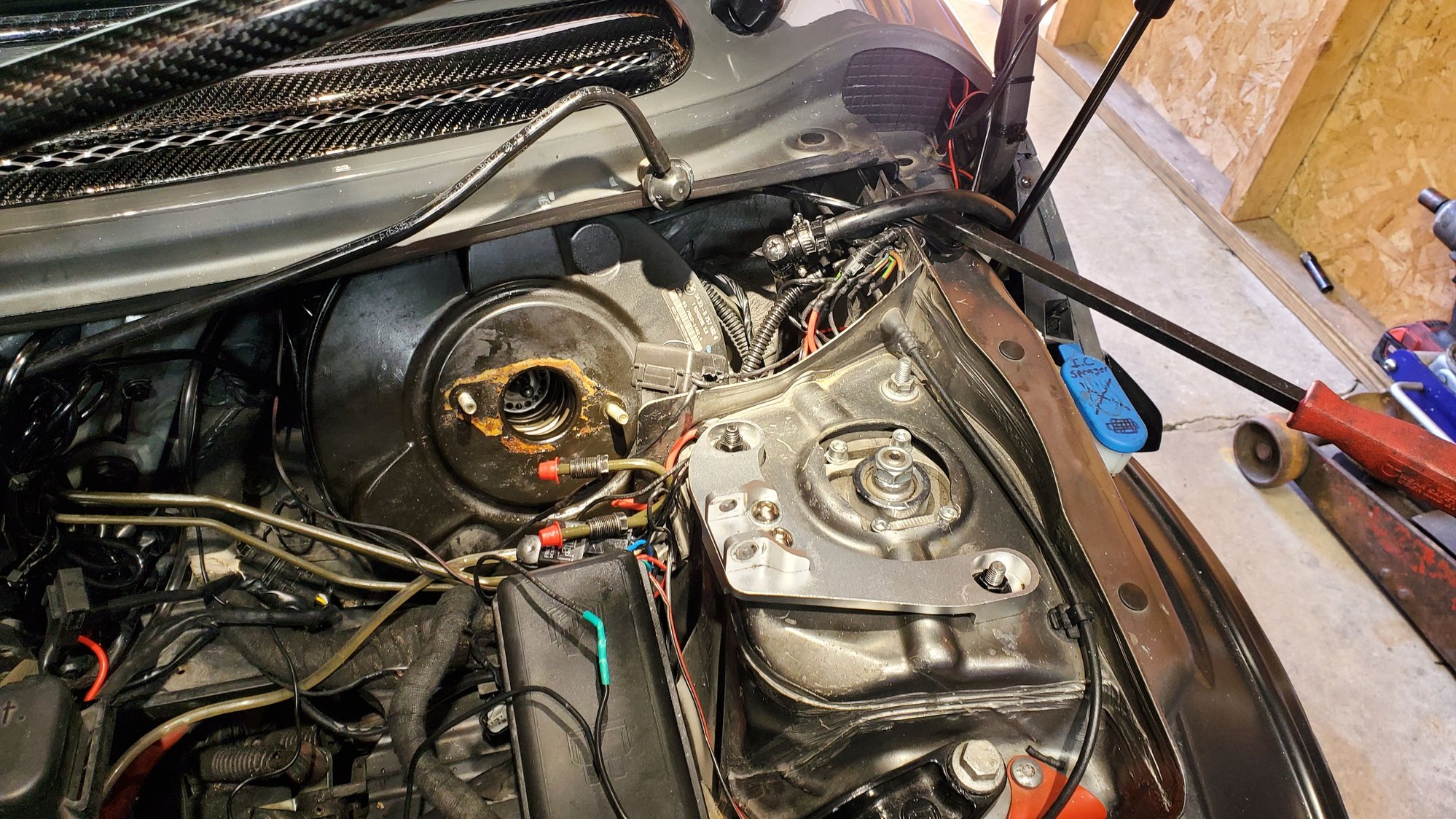

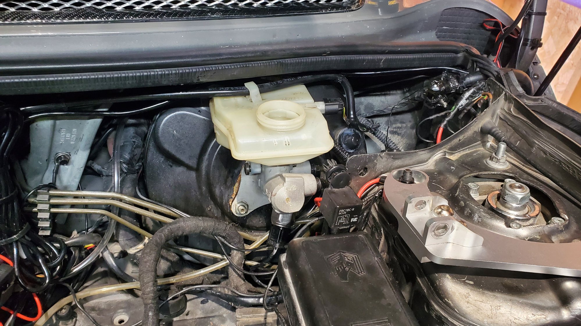

we were bleeding the brakes AGAIN and as we got the the last corner even after foxwell being used on the abs MY RESERVOIR split open and pissed fluid EVERYWHERE . So we ran to the salvage yard and I grabbed a whole replacement brake master cylinder and swapped it on. Redid the bleeding procedure and wouldn't ya know it , the pedal felt AMAZING and didn't sink. So I said F it let's powerbleed my clutch slave too since I replaced it only like a year ago AND A BOLT SNAPPED OFF IN THE LOWER MOUNT. Thank GOD it still tightens on with just the 1x so it's gonna be asis UNTIL I get around to ordering and doing the clutch. Then once I drop the trans I will drill n tap it out. But I don't wanna try with it where it sits with the lack of room. I don't wanna F' that trans ear mount.. i plan on using an ebay stage 2x fx clutch and lightweight flywheel, Im using the same setup in my aero mini AND I LOOOOVE IT.
so me n my buddy will finish bleeding the clutch tomorrow and hopefully my brake pedal is back to normal and my clutch engagement will be crisp still.. but ugh. That bolt I know I didn't over tighten and it never even sees rain noneless barely got driven so for that bolt to snap like it did is such b.s..
o yea , I got a new intake thingy that plastic housing that sits behind the intake box. I got another one and cut it up to fit and used that to seal the filter in instead of the strut bar.

Problem not fixed...
I found a vacuum line collapsed from vacuum when the car was running and it was the vacuum line thar connected to the brake booster off the sc. So i removed the supercharger and bent a hard line to fit and reinstalled it and put everything back together aaaaaaand it didnt fix the sinking brake pedal..lolol.ugh.
so I finally thought to smoke test the brake booster and after wresting out the vacuum fitting from it I pumped s one into it AND it DIDNT hold pressure AND it leaked smoke into the cabin by the brake pedal by the plunger from the booster. Sooo I think maybe it's internal diaphragm is shot soooo I took the dang thing off and what a pita that was.. I can't imagine how much of a nightmare it's gonna be installing the new one.. gowd ! I just PRAY the problem is fixed because the stage 2x performance clutch and all corresponding replacement /maintenance parts have been ordered..lol I spend 600$ buying stuff to do my clutch and the brakes arnt even working properly...derderder.. but in all fairness I thought the brake master swap was gonna help things..
haha o well..idk yet if im gonna have a local member do the clutch job for me and pay him or if I wanna do ANOTHER clutch job , since I just got done doing it and though it wasn't hard it's an inconvenience because I can't do it in my own garage as it's too small so it's a huge inconvenience for me actually...

New booster , New brake master, over 20x bleeding cycles and using the scwaben tool to activate the abs module and absolutely NO ****ing change in the pedal.. I'm soooooo close to saying ****ing it and strip it down, transfer everything I wanna use onto the aero and sell the rest.. I'm soooooooo close.
Idk wtf it could be but this is such ********.

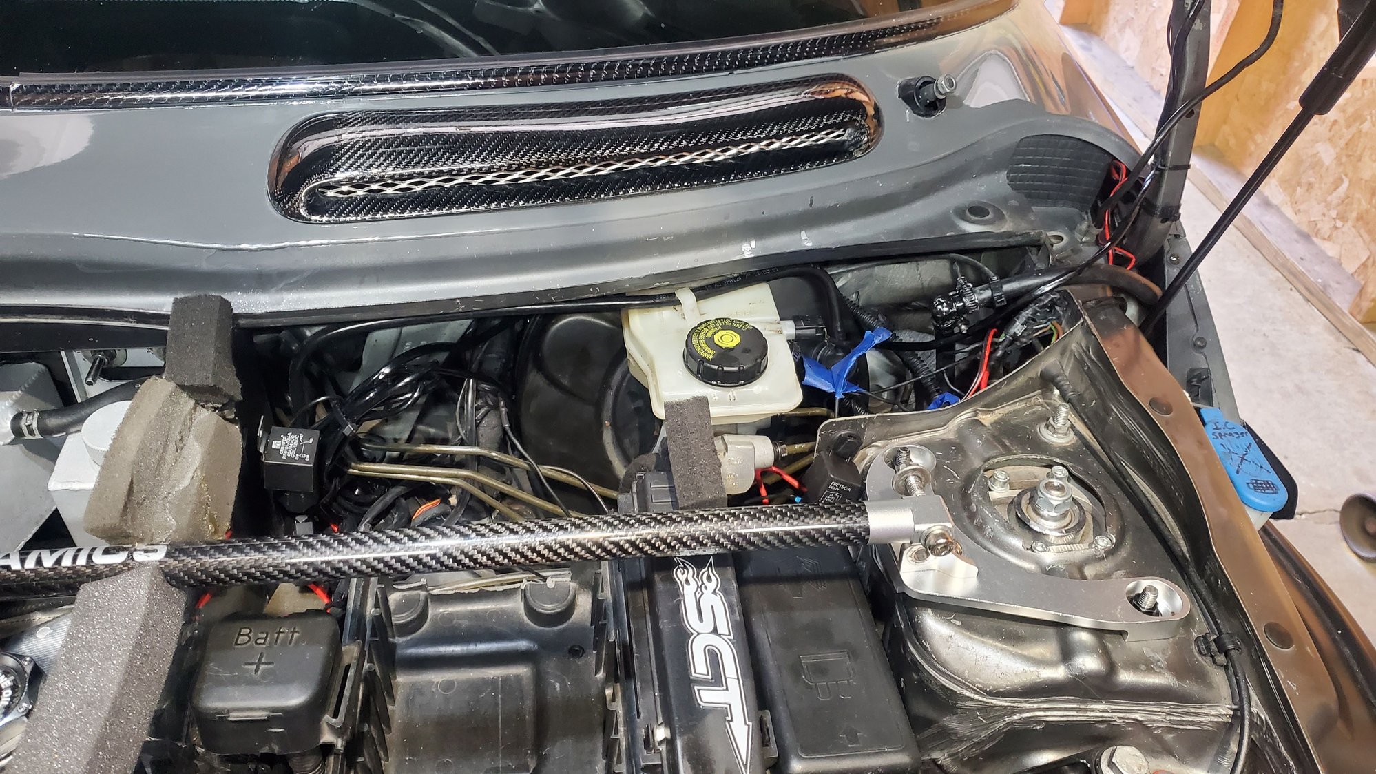

So I left my brake pedal depressed over night , then I bled it 2x more times.. the pedal still sunk to the floor... so I said F it and went to pull my car out so I could paint in my garage and for some reason the brake pedal held. Though it was verrrrry close to the floor , it held.. so I took it around the block romping on the brakes and it seemed to get better gradually.
so after a few blocks I took it back home and bled another 2x times and went for another test drive , I ended up driving like 20miles or so and the brake pedal now feels 100x better.
it still feels like it travels abit too far befor it bites good but it's atleast fully drivable and my calipers no longer hangup either..
what a pita.
I think I HAD to drive my car inorder to push the air down far enough to be bled out..I have a feeling its was just bleeding rite by the air somehow..

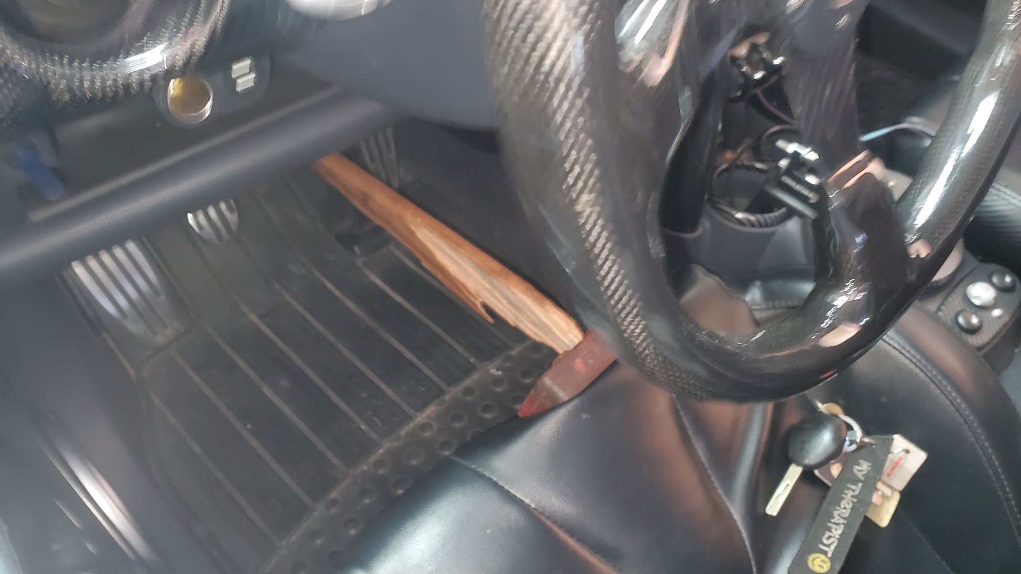

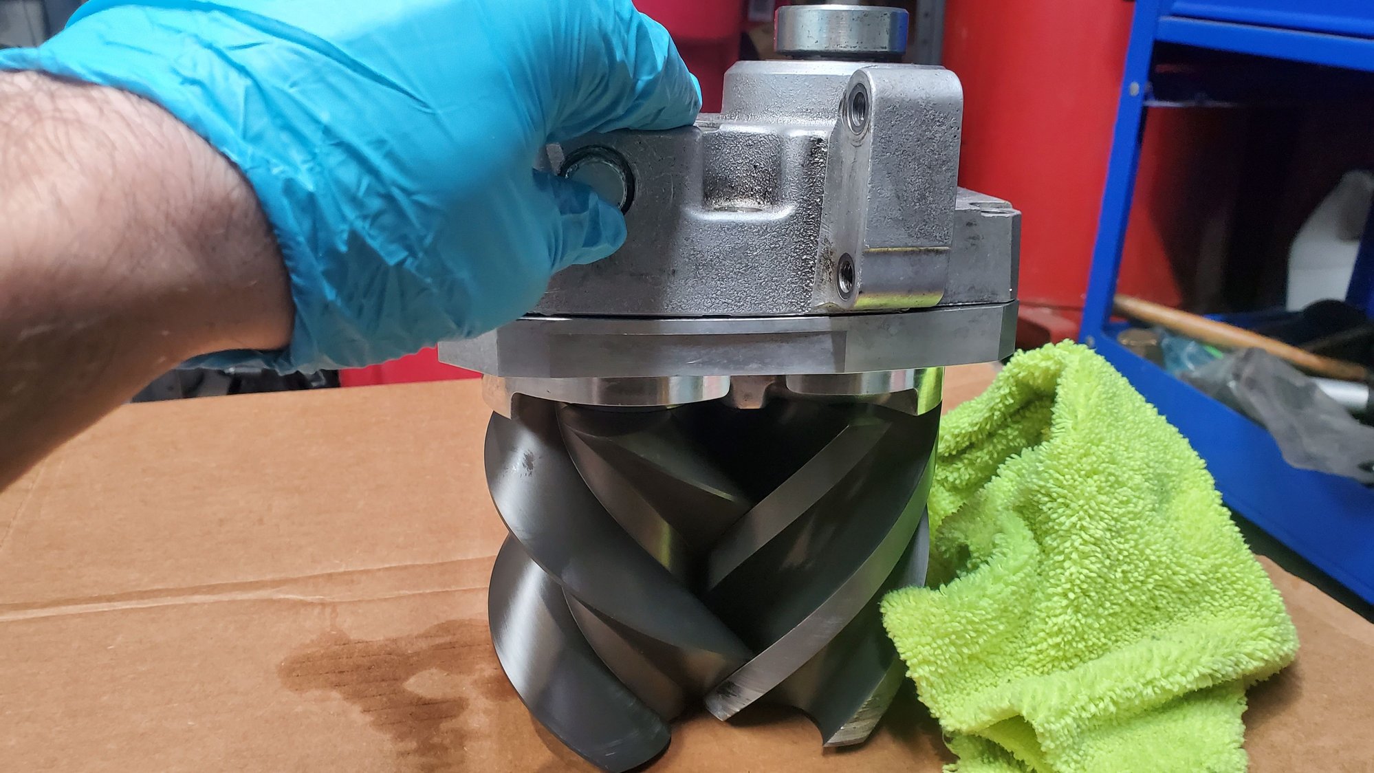

the car just shut down at a stop light abd I could restart it. So I had my mom pull me via my towhook back home and began digging.. I found my belt wouldn't turn , SOMETHINGS LOCKED UP ,the car wont start and turn over either now.
so I removed the belt and tested the accessories and found MY SPRINTEX WAS LOCKED UP !!!!! OMG !!!!!!!!
so I get it off and find something wedged on the rotor against the casing , I THINK ITS FUUUUUUUCKED !
SO I go to disassemble it because I was going to send it in for a rebuild and new rotor pack but I worked it loose and it began to spin again. So I FULLY took apart the sprintex to inspectinspect damage was very superficial. I couldnt even feel the scratches it made BUT on the rotor blade it didnt chunk it abit BUT i just used my sander and 2000grit and sanded it smooth again and then I sanded the casing inside very lightly and put it all back together and WOW I got lucky. It WORKS AND IT WORKS GREAT STILL ! thaaaaaaaank gooooooood ! What happened was during figuring out the brake issue I put a hardline on from the booster to my sc because I found the line I used was collapsing so I had to shorten it and I cut it while everything was on and installed, I thought I was careful but obviously not enough because the rotor tolerance in this sc is soooooo tight even a piece of dust interferes so anyways a chunk of the hard hose I cut fell into the tube and locked up the rotors and stalled out my engine then..
the sc has lost NO boost and isn't making any odd noises ect.. actually my iats are running much cooler now lolol so I think the sc benefitbenefited from a good cleaning and the craigslist style rebuild I did on it..
the brakes now are fully worked out after i finally replaced the slide pins because old ones were a little iffy.
