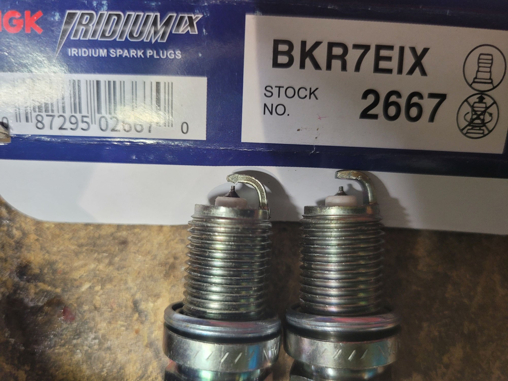

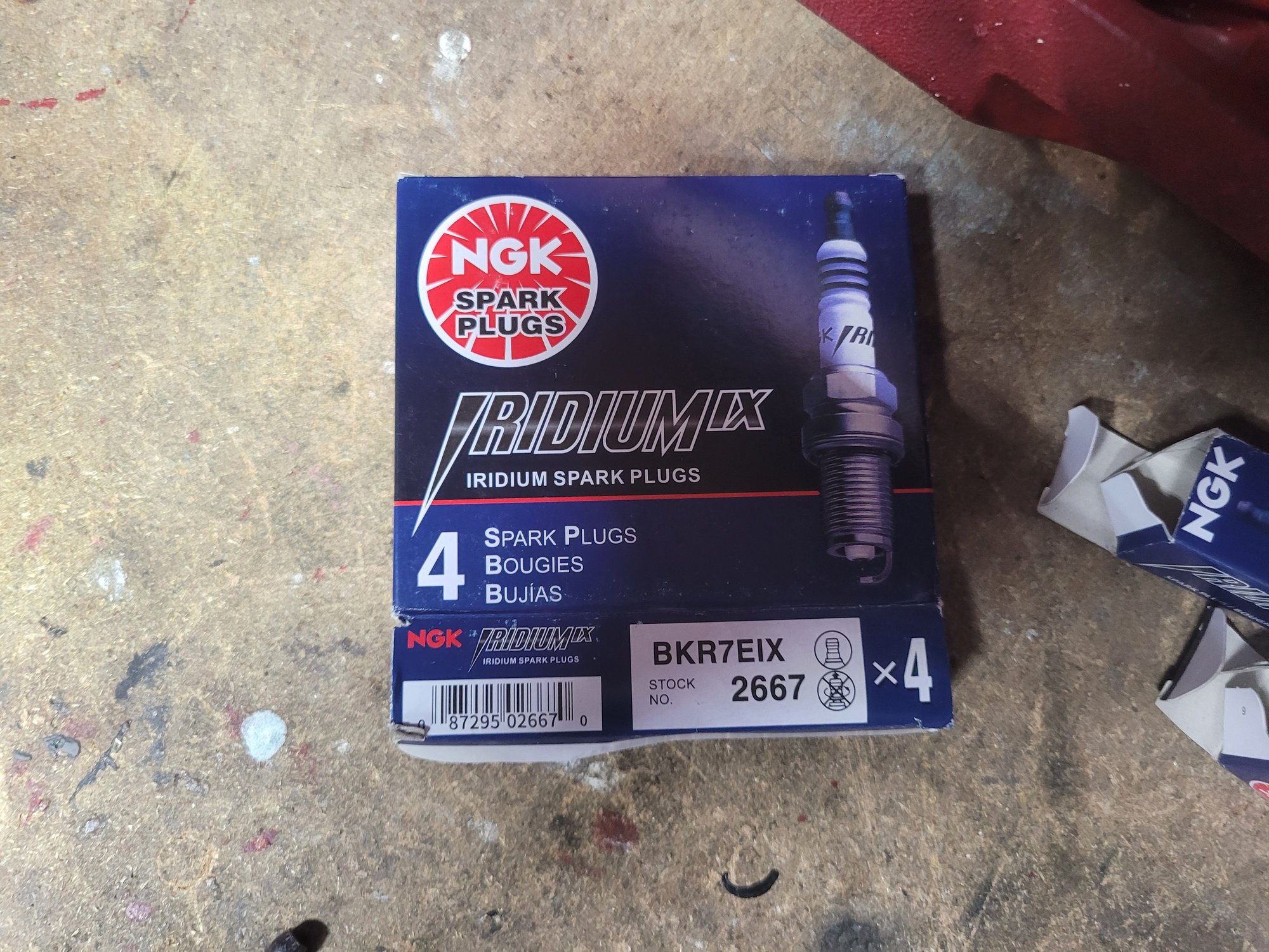

I orderednew step colder plugs too because ones I'm running can't be gapped and with the screaming demon coilpack your actually sapose to open up the gapping on the plugs to .65 to allow the coilpack to better utilize its hotter stronger sparking. So these DO make more power over stock when run correctly. I forgot all about doing that , I did it last time and noticed an improvement all around with the demon pack and big gap plugs..so let's see hoe the car responds to it now that I'm much much more in depth with its engine mods. When checking my current plugs , they looked perfect. And that's thanks to Adriancl 's awesome tuning . I sure wish I had the slightest clue how to tune. I've actually been contemplating looking for a a little tuning coarse if there is one here at the tech collage matc. That would be the best thing I could do is learn. Lol then all the tinkering I do dealing stuff in,looking for every bit of power I can. I'd be able to tune in and adjust for EVERYTHING I do then. Gowd that'd be sweet to learn.

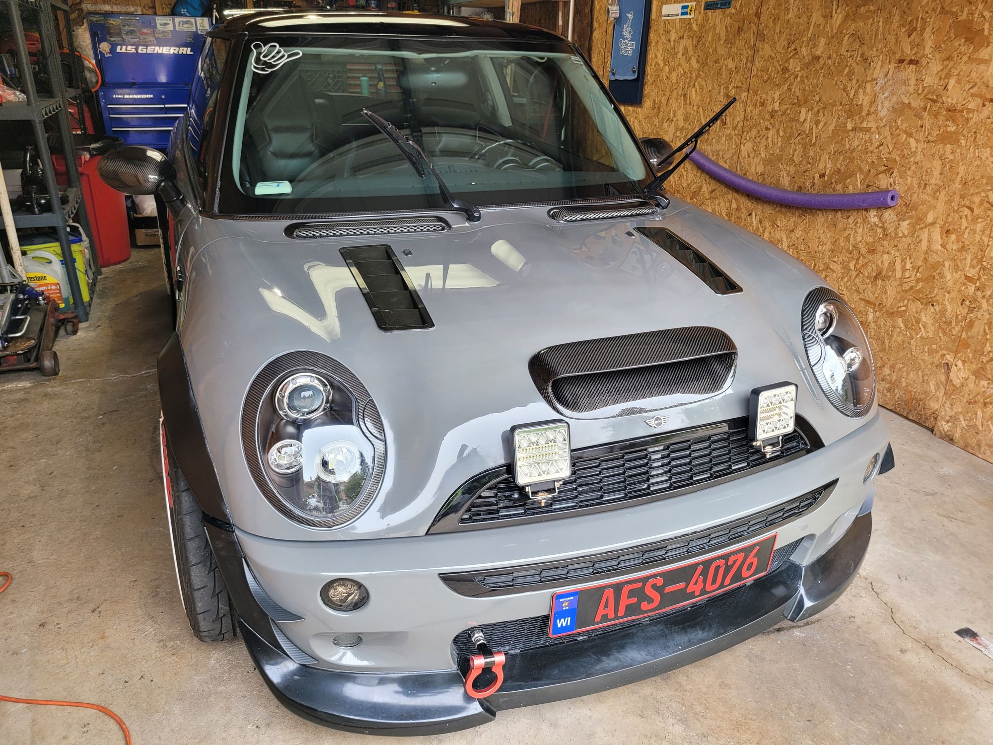

well here's pics of my ricerocket all cleaned up..

Still think your car is one of the best looking minis on here. If you lived closer I'd want your hood when you go cf. Mine is damaged and I love the vents you installed.

it isn't hard by any means putting in vents and they make a set actually contoured for our hood , only problem is there NO room for error. Mine aren't perfect but imo good enough to get by until I got the cf vented hood.
plugs should be tinged brown. The extra residual stuff you see is from the e85 blend and methanol... the car runs perfectly and trust me. Well, a little on the rich side as afr ar 10-11 at full boost but better safe than sorry.

it shooooooould run abit less rich once I get these new plugs in with their large gap. We will see though.

Dang , my old plugs weren't bad by any means but I wasn't able to test drive it because everything is flooded outside but just giving it some revs it seems to rev up abit quicker and less effort , started up with less cracks and I swear my exhaust seemed to be popping more , so maybe it DID lean out my afr abit.. I will post back soon as I test drive it and I'm going to try and make another drive along video too then..
I put the pkugs side by side with their stock gap and then i opened them up to .52.. i didnt go as much as it said because I am running more than 2x stock boost and other mods so I didn't wanna have spark blowout. But maybe I will take them to .65 and see...

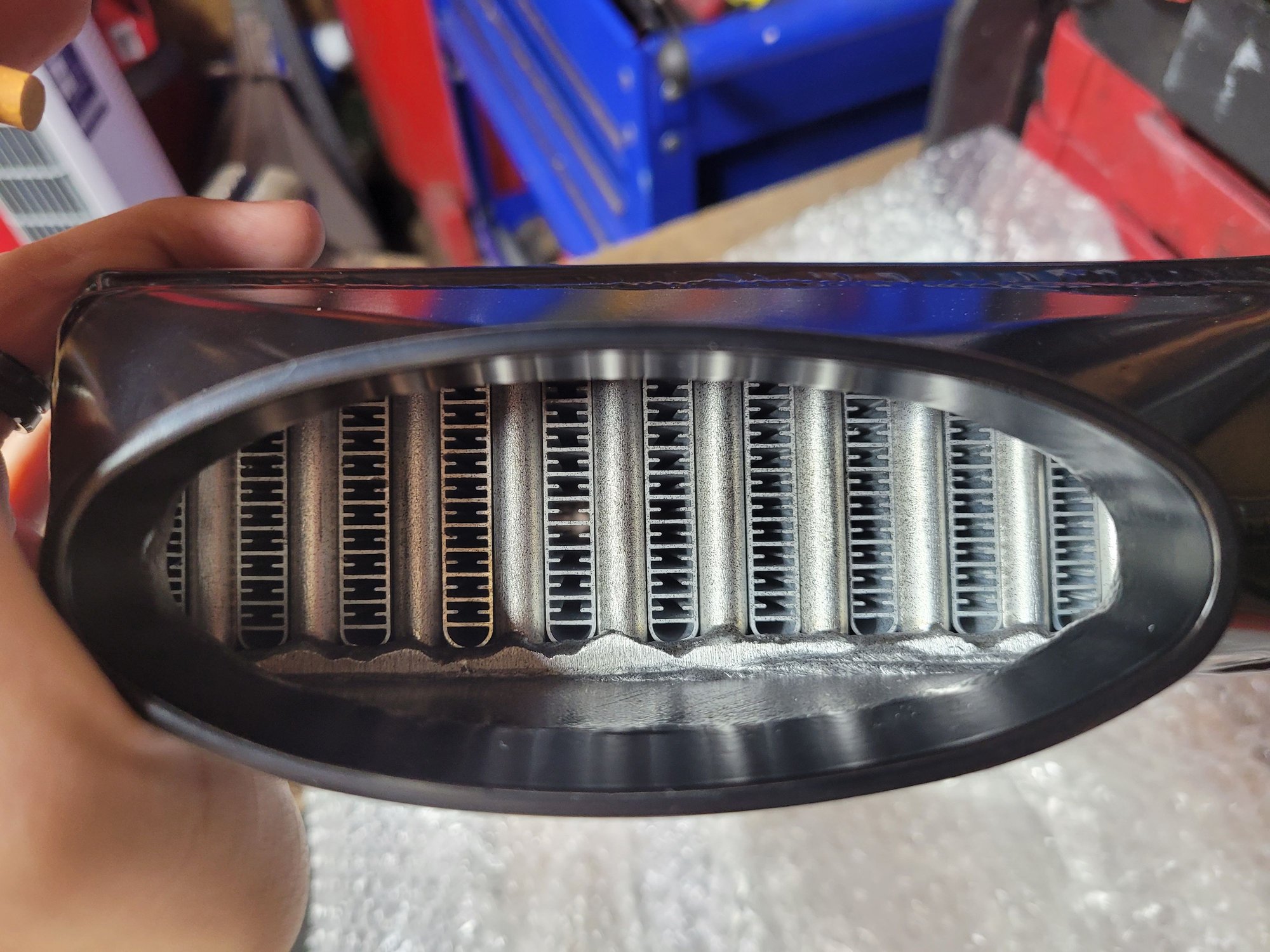

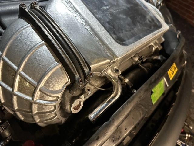

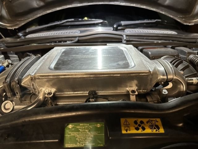

Ooooooo baby ! The ic has been finished being made and just needs to be powered coated and then it will be en route. Heres a few pics of it being test fitted 1st..it's been taking a bit but the wait will be worth it !
Oli over at orranje.uk has been awesome , once again in providing me a custom ordered custom made part..

I was wondering where the bleed was, then noticed the return water fitting is high up on Opposite side from feed so you don’t need a separate bleed. Or not much of one if you jack the rear up a bit when filling.

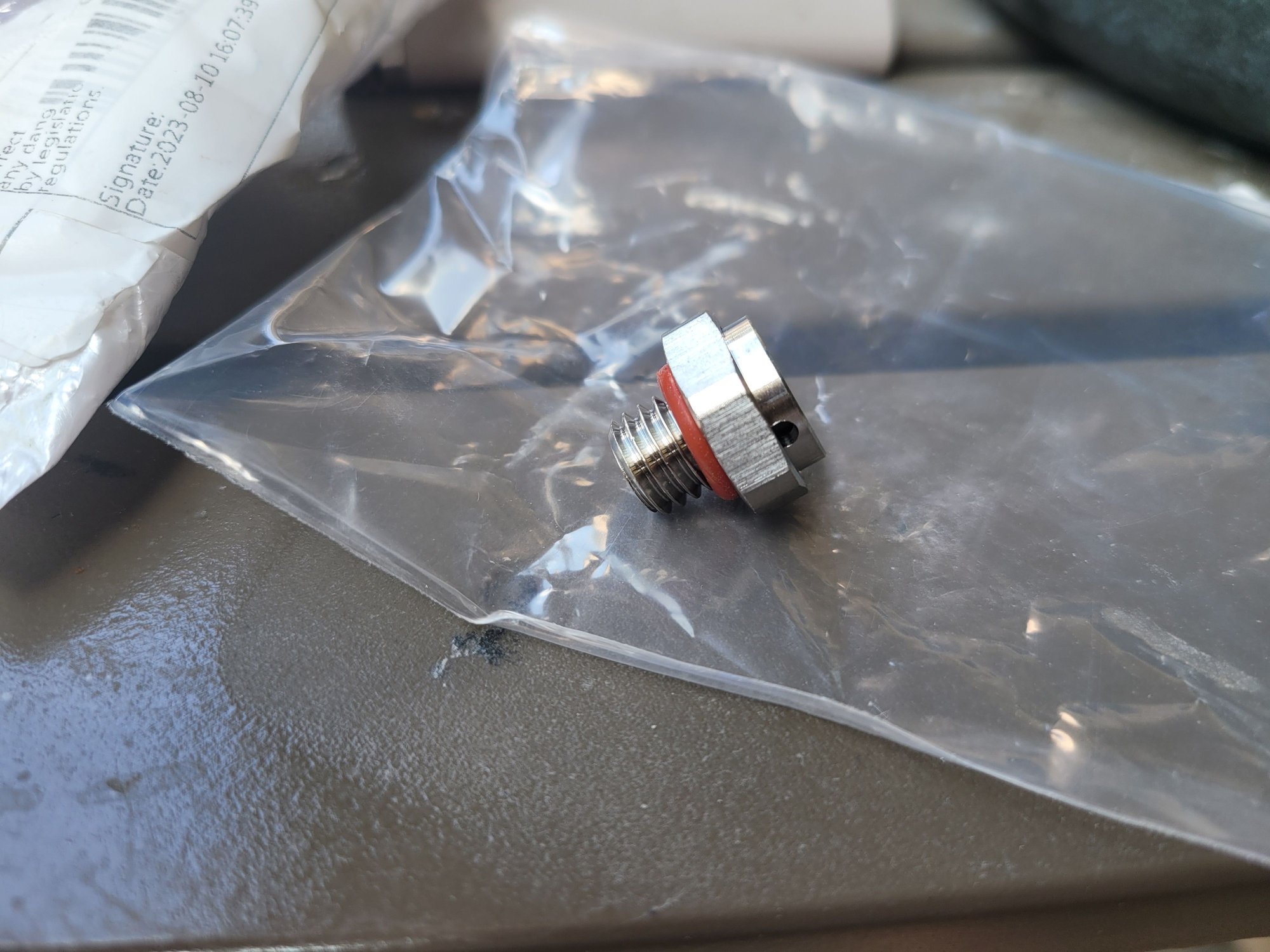

at the very top most hose I'm going to splice in a bleeder pipe like we have on our upper radiator hose. I might not need it though because it shooooooould bleed from the reservoir cap and I'm going to be running 2x pumps. One to feed and one to return. I think I've settled on a 7x gallon reservoir, so the whole system should hold about 8x gallons. That should be pleeeeeeenty fluid to not get heat soaked. Plus I got a pretty good size radiator for it too ( actually have 2x ).
it shooooooould be a very efficient setup. I'm hooooooooping I will be able to then just get rid of and sell the methanol kit then..
last piece to the puzzle will be a kavs or dinan throttlebody.. I just felt on this car , it was better like a good in-between of my ported stock tbody and the BMW v12 tbody.. I think it moved the PowerBand EXACTLY where my cam like to make power so it was the most effective for this setup.. I SHOULDA never sold the one I had but I had to get $$ together for the aero car I'd picked up.. awe well , tbody or my aero ? Lol I think it's a no brainer but I still am gonna hunt for a replacement atleast.. if i ain't trying I'm dying..

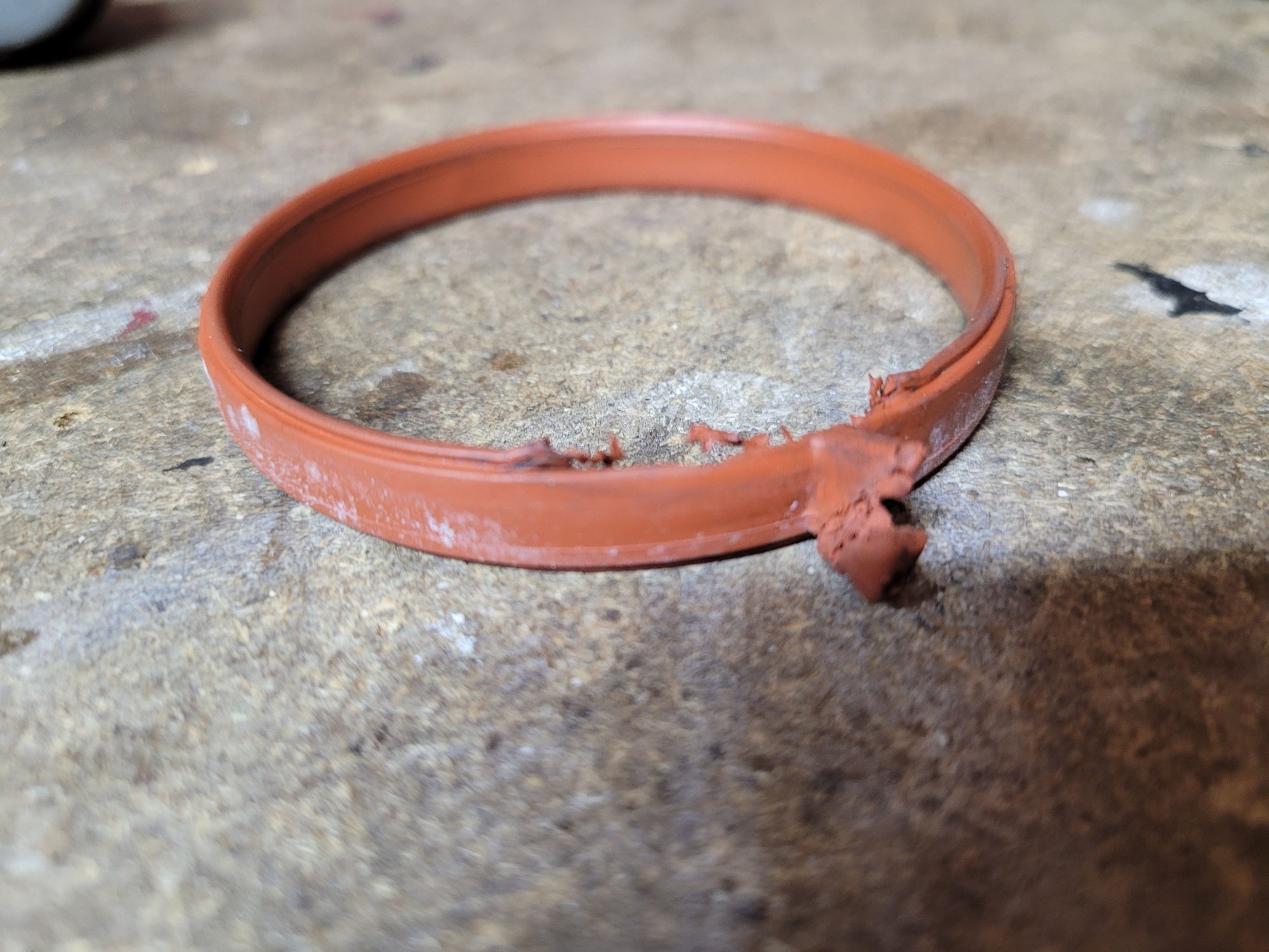

when I put on the trans mount i found my tbody gasket was chewed on by an engine knome , thankfully i had an extra. I can't believe it wasn't losing power from that. Lol or was it and the car legit is that quick I just didn't realize? Well , I'm gonna find out VERY soon here..

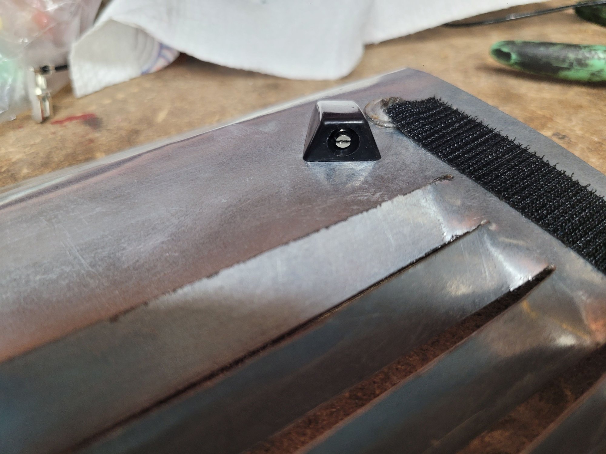

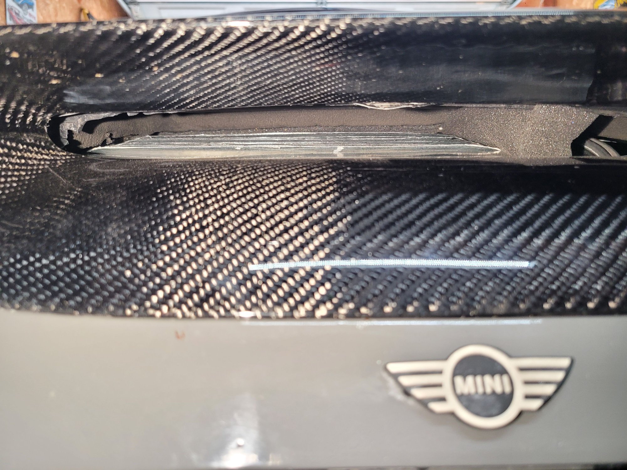

theeereen my fenders came so I had nothing left to do until the pumps get here over the weekend so I figured it wouldn't be too much to toss on the fenders.
lol BULLLLLLLLSHIIIIIIIIT. not one hole is predrilled though km glad because most didn't line up and I had to mark all the holes , drill them and epoxy on nuts so the bolts will actually hold them on and not risk craving the taps as easily and to better line up with bodylines.
it took 2hr to get the sidemarker to fit as well as it is sofar. It still needs more work though..lol if I wasn't so **** about everything I wouldn't be in so far over my head rite now.. lol I even am going to replace every clip on the side runners too , why ? Because, thats why !.
So probably 5hours I got into the fender and I haven't even put the widebody flare on it yet. Though i gotta plan that too. Idk if im going to again directly seal it and fill the gaps with panal bond and smooth it out OR install a type or rubber seal that'll pick up the little gaps and make it look even..idk , we will see..

My concern with those “vents” is
a: they impact the space occupied by the washer bottles, it seems.
b: there’s no flowing air back there that needs venting, because you have wheel liners and then washer bottles obstructing it.
it’s a lot of expense and time fitting and tweaking a cosmetic only part for what shouldn’t be much if any weight savings, and at least down here, they only last a couple years before they start yellowing and flaking, unless you scuff and paint them with automotive base/clear.
waiting to see what you find out when installing them.

So far so good. They clear everything and I got all bolt holes lined up and nutcerts ect added on to better strengthen them.. the actually LINE UP AMAZING. Usually cf parts gaps will be a bit off and even with fiberglass too but these gaps are tooooooootally acceptable as is and the only things I needed to shave or cut were the side marker holes . The 2nd fenders is going 10x faster because I know what I'm doing better now.
I also repainted the flaresso once they're fully dried I will attach them on. Those too line up very well on the fenders too thankfully..
I'm pretty happy with these sofar.
This reallllllllly makes me want the cf hood BAAAAAAAAD and RITE NOW ! LOL so buy my meth kit guys and fund my hood.. you know you wanna see this baby turn from troll to the carbon cooper.
