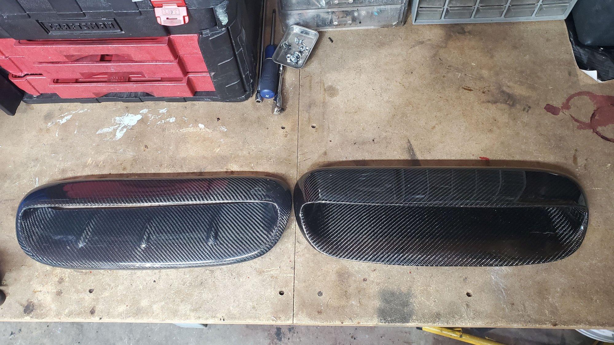

here's pics comparing the old hood scoop to the new one.

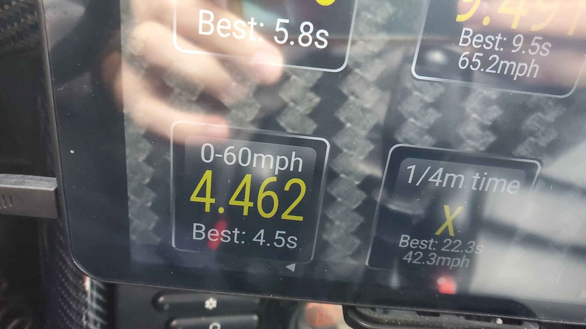

Soooo I don't know how accurate torque plus is but I set up my cars profile accurately... I ACTUALLY got a best 0-60 today of 4.1 but thought it would save it and it didn't buuuut I was still able to pull a 4.5.. its pretty muggy abd chilly today as its been raining past few days ( actually had a Tornado locally other day ) and I had to kinda soft launch it because I'm now having to relearn to launch the car on its new tune. So imo I think that's a pretty respectable time..
Also I did research my cars mods and around what hp it my car shooooooould be and with my mods I've been telling people conservatively its 280hp , maybe 300hp tops and according to my torque plus it says 295hp.. lol those numbers are VERY close to what I've estimated my car to be and what it feels like...I legit though I could pull a sub 5sec 0-60 no problem, especially if I do a hard launch but that requires warm temps , decent road surface and ille warm my tires first.
Im going to contact Adrian again and let him know we can tune the meth in when ever because the tune without it is running fricken CRISP ! LOL I don't even have ANY back fires or pops now if I give it gas and let off.. I LOOOOOVE it , i liked the natural pops and crackles it had but once kids started tuning for it and making their stock cars pop n crack like crazy I no longer liked it. So my tune must be running fricken CRISP. I mean according to my afr gauge and everything it is..
o yea !!!! We raised rev limiter to 8k from 7300 AND I BET thats helping it abit. I shift now at like 7600-7800 and it goes into the next gear SO MUCH better at those higher rpms. It really holds the powerband fricken excellent..
I wonder if once the meth is tuned in if it will pick up any more power or if it will just prevent heatsoak and keep iats down.. I'm HOPING to pick up power because I don't have an iat or coolant temp issues what do ever.. today , hardest longest pull i didnt see over 120'F and just cruising it was in the mid 70s low 80s.. and it's like 55' and cloudy out today.
anyways here's pics for proof.

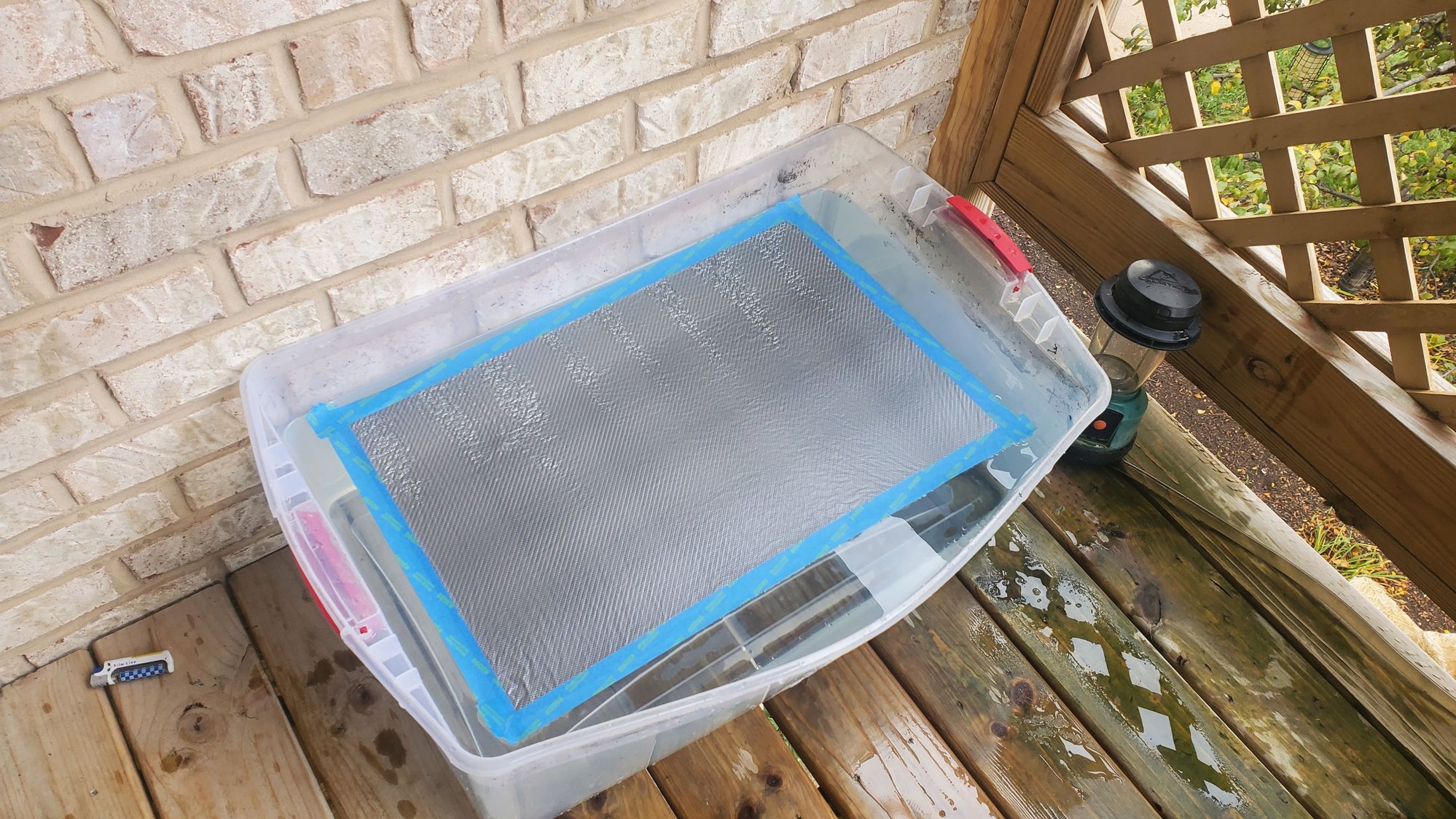

you should get a 20$ kit with the activator and a pattern you like .
You gotta use the rite kind of color and paint for the bottom coat in order for the pattern you choose to show up well.
Buy a bin like I use from like Menards or somewhere to dip in and just do a few random shaped items to get a feel for it.. it's gonna be trial and error.. after I cut the sheet to size I put tape around the edges so it doesn't float around or spread on the water. I find using 95-100'F water , then letting the film soak ontop for 60sec. Then after the 60sec I spray a thin even layer of the activator on it from 2ft away and wait another 10seconds or so , you'll see the film pretty much liquefy and almost just look like ink on the water. Then you dip it in at and angle , kinda slow and steady and swish it under the water and move over the excess film ontop of the water and pull it out. Then you need to rinse it off in 95'F water until it no longer feels slimy /smooth on the surface. Once rinsed fully it need to dry for 2x days and then you can clearcoat it..
I hotglue popsicle sticks to the backs of things I'm dipping so that I can dip it fully and not have my fingers be in the way.lol I think that is the biggest hack I've learned while doing it.
It's not hard . It's more time consuming than anything imo. Having to fill and drain the tub , rinse and then wait and then clearcoat..buuuuut it is worth it when it works out in the end.

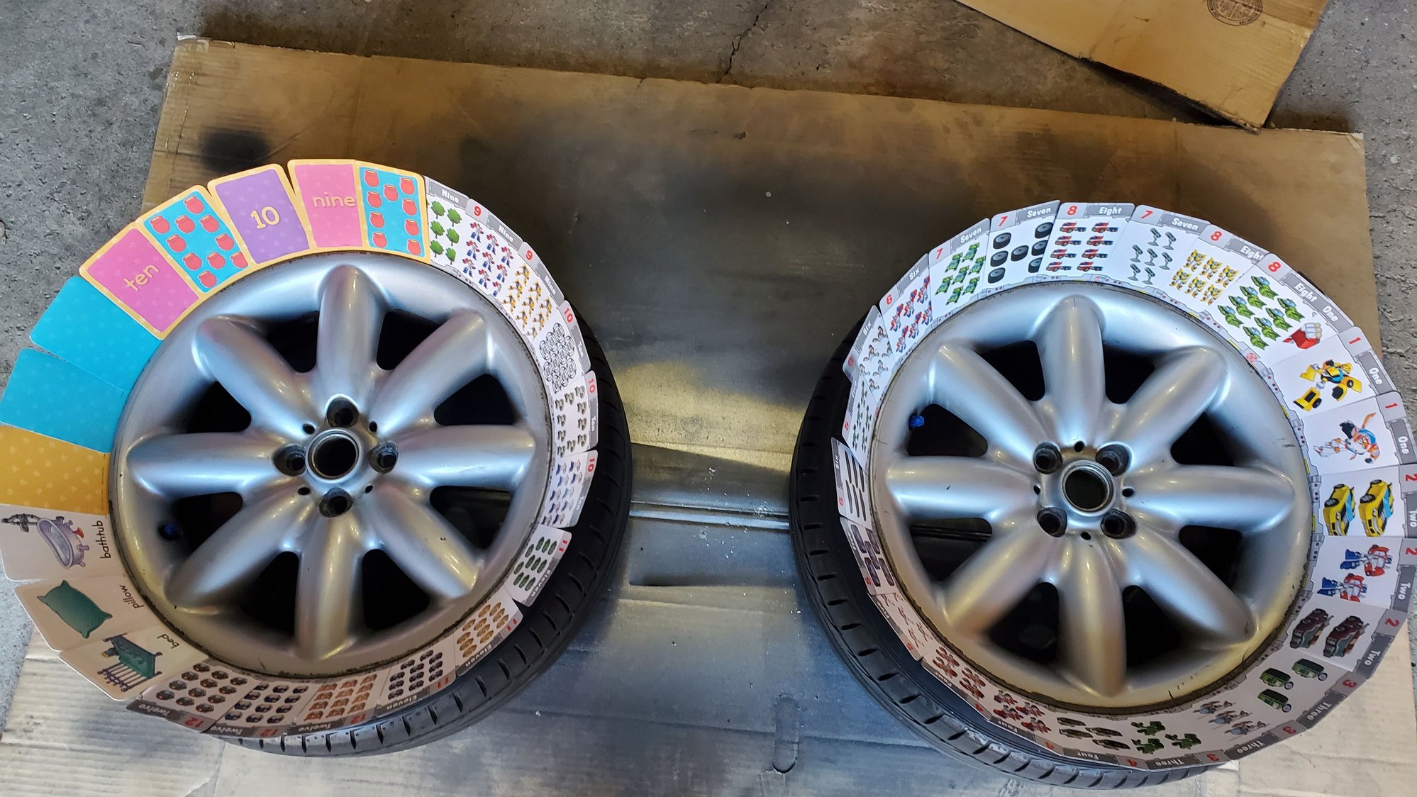

also I grabbed some winter rims n tires from a local member. i then had extra time due to plans being canceled so I cleaned them with just dawn n the hose , did a lazy light sanding with 1500grit and then grabbed 2x cans of krylon paint I'd had sitting around for a year now since buying it on clearance for like 1$ a can. And the color and paint ends up coming out FRICKEN SWEEEEEEET ! lol sometimes I impress my self with my quality of workmanship on such a simplified project. I can't imagine how nice they woulda looked had I actually taken the time to sand them better , use primer and clear..lol this is literally JUST spray paint and they look this crisp.

My big sheet of hydropdip I'd ordered that got lost finally showed up and were having a warm streak , of course rite after I put on the winter rim set..so I've been dipping everything easily removable from the interior and making it look carbonfiber. I've done the custom coolerworx shift boot delete and the cup holder bezel infront of it and I also removed all the trim rings from the dash , hazard switch casings and the 2x little side vents on either side of the dash. Sofar I just got the shifter n cupholder trims fully done but all other parts have been painted and I will be dipping them tomorrow.

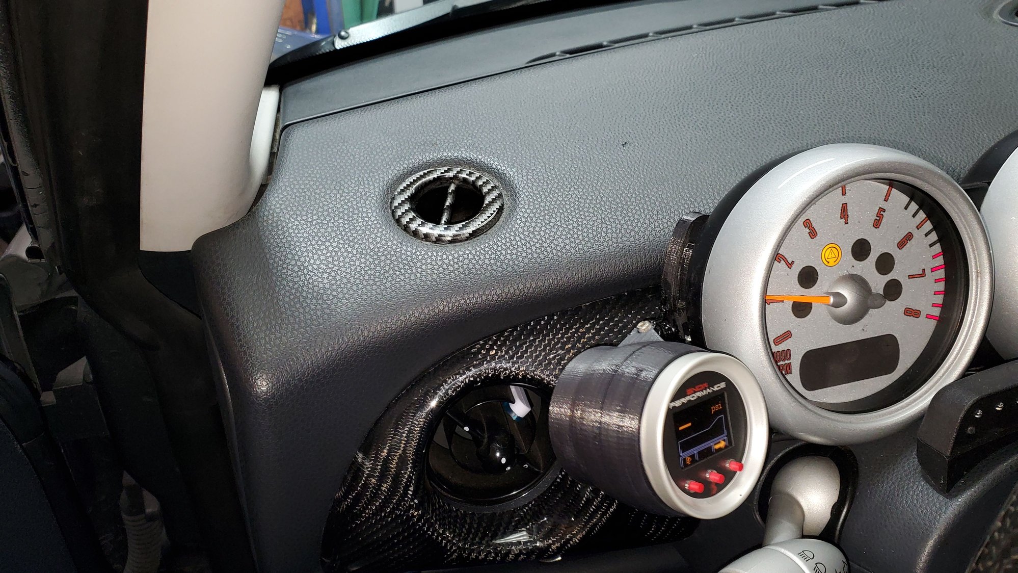

Here's all the carbonfiber dipped interior parts , they came out amazing ! I got on the cpillar add-ons too..soon as the r56 brakes get here , the 1st decent day I will swap them on and get my old ones up for sale fir cheap.. anyways , here's pics guys !
