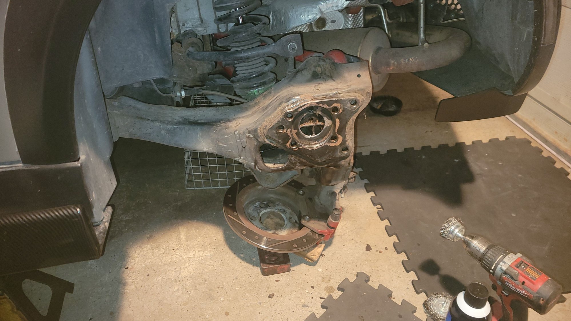

but I will hook it up n check all I can after I got the new rear hubs in. The rear passenger side was so bad it was kinda hard to turn even and wow does it grind , i cant believe i didnt hear or notice that sooner..

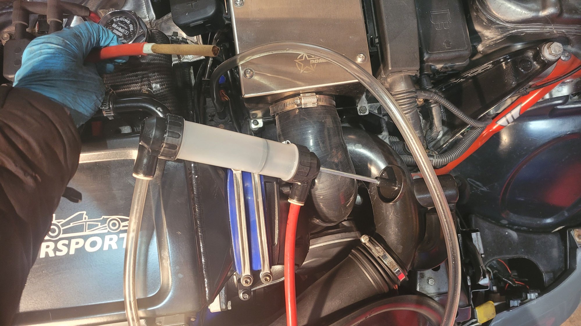

I also put in 2x replacement tmap sensors and them smoke tested the intake system ( found 0 leaks ). I also 2x checked wiring , plugs ect..only some what concerning thing i found was the #4 injector adapter felt like it wasnt seating as well as the others but i doubt thats been my issue and its probably not even an issue i just get **** about things and need it everything to be as good as i can get it.
I got the old hubs off no issues and the new ones were suppose to be here today but they got delayed a day so hopefully they'll be here tomorrow and I can get the car back together and see if I have fixed either the trifecta lights and or the p0108 code coming up..
I also wirewheel EVERY bolt that comes off before I put it back on too to help prevent them from seizing in for the next time AND it just makes it looked nicer when you look at it and even the bolts have little to no corrosion on them..

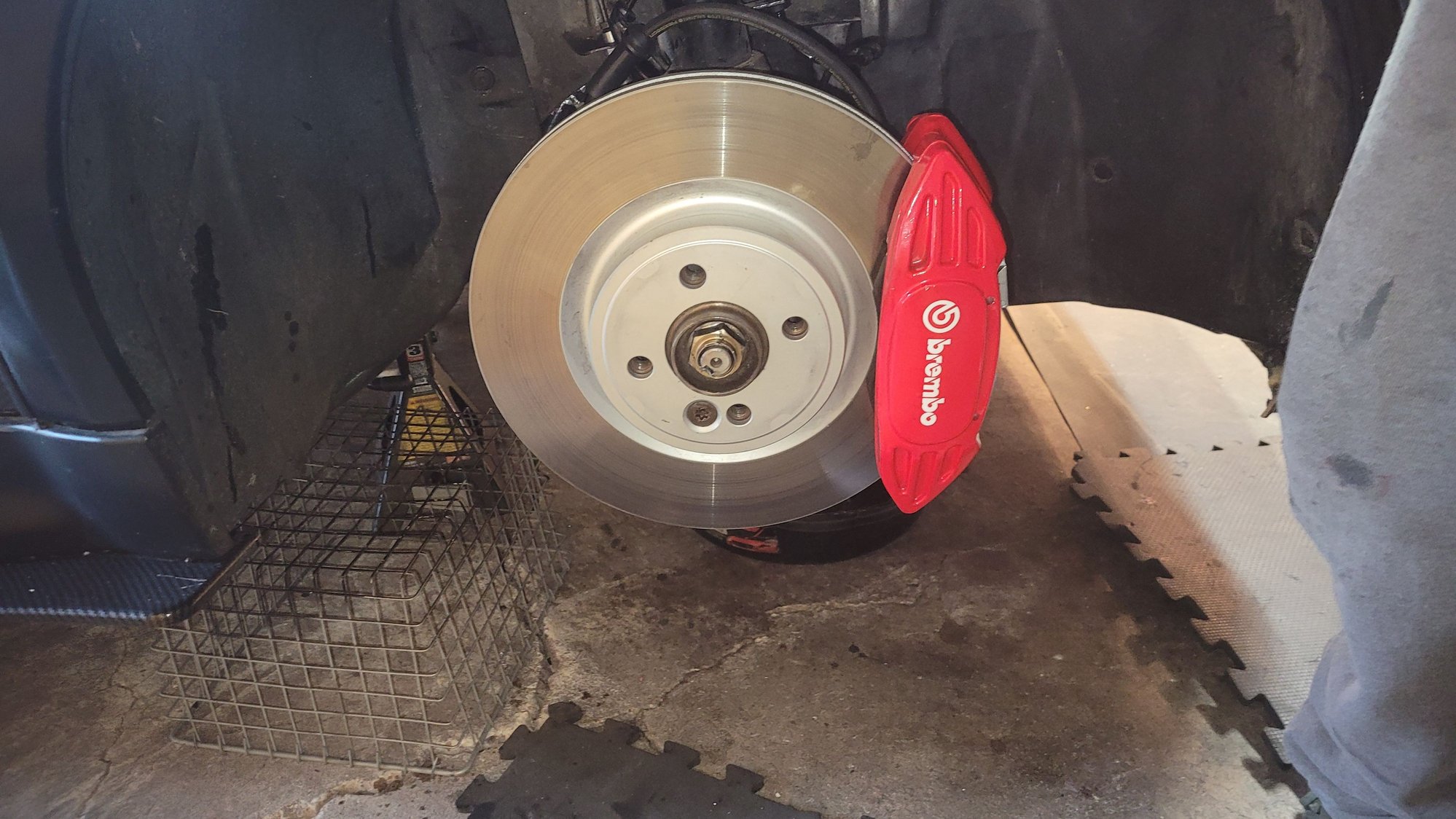

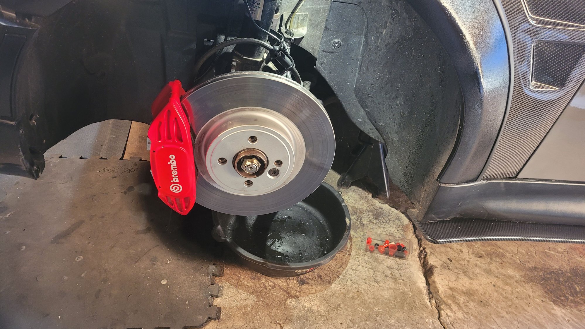

Aquired half , well , hoping the next mod but I'm afraid I won't fit my 16s iver these BUT I'm gonna try and if it's close and I can grind abit of material off the calipers, I will. But if not I do have my rims and tires currently up for sale or preferably trade for some 17s or possibly 18s.
​​​​​the calipers are loaded with pads amd ready to be installed too.
but I'm gonna put back on the stock ported throttlebody and do a few test drives and see which feels better now that the car is running rite. Then once i get a few things done on the aero cooper then i will get to these brakes because thrn if i need 17s it can just sit on jacks until i Aquire a set.
im hoping i can swap over my ss off of my r56 calipers onto these brembo since they are the r56 ones..
with the calipers I'm going to remove the jcw logos and put on brembo decals because that better suites this build.. had these gone on the other car I absolutely would have left them as is..

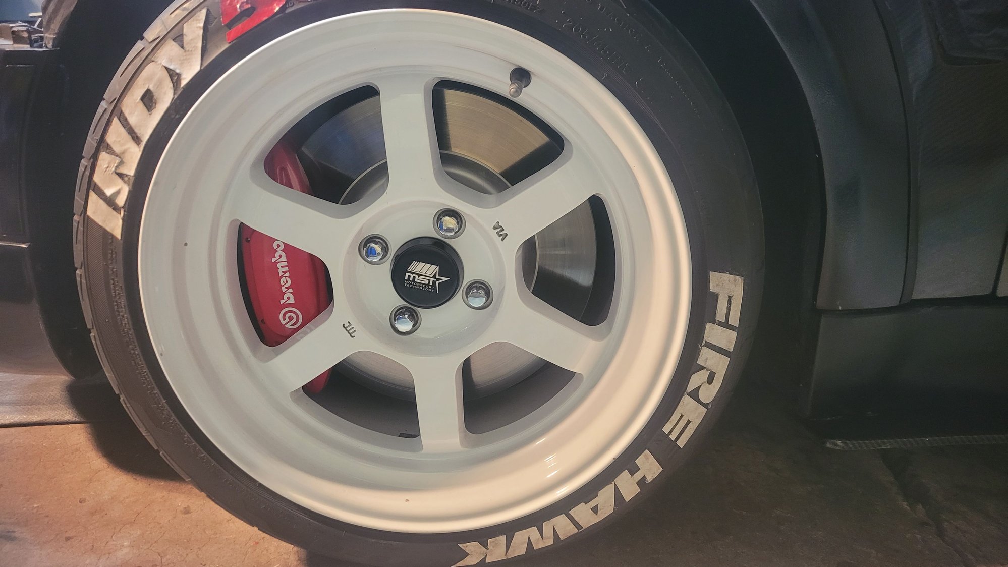

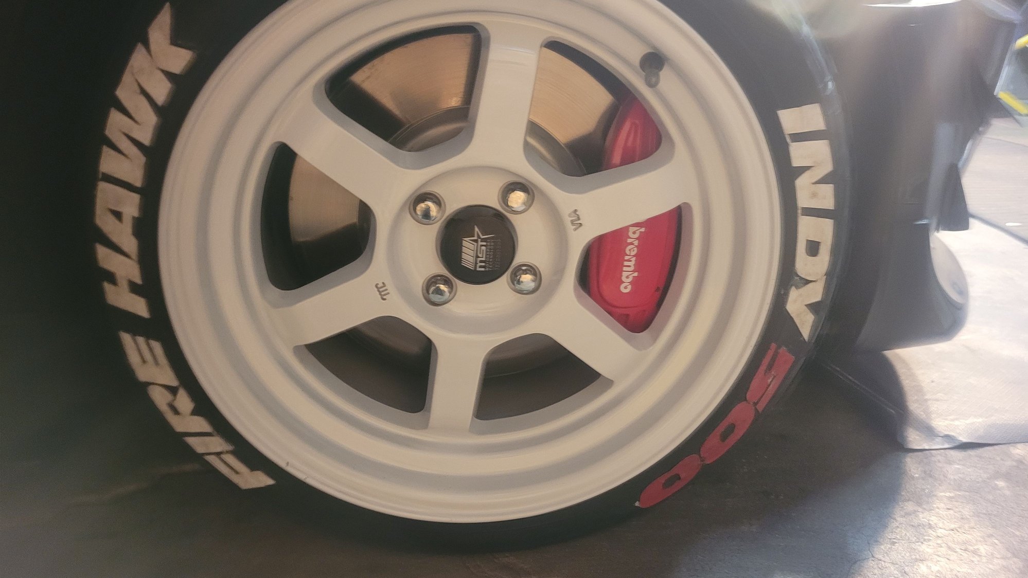

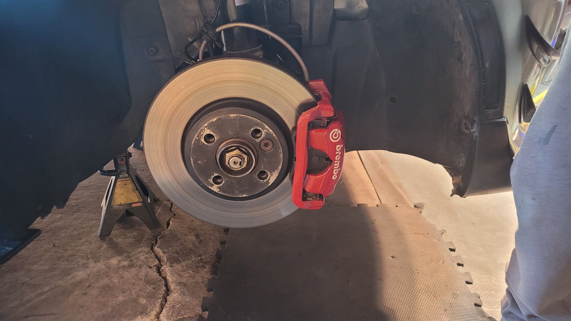

Sweeeeeet THEY CLEAR MY RIMS ! they WOULDNT had I not had et20 offset With 10mm spacers so for 16in rims to clear these calipers you'd need an offset of et10-0 but THEY do clear the wheel weights also..
I bled them and hot the brake pedal a few times and they felt good so I will go for a little test drive tomorrow then rebleed them one more time and then go test out the brembos and tvs... how sweet to be able to finally get these.. gowd im excited to try them out..
as you see I removed the jcw decals and put on brembo decals too..
Check em out !

LOL, those JUST squeeze in there! Those are 16's too... Nice. You're at an effective +10mm offset? Get any side shots yet to show how much the wheels stick out?
If you scroll up a few posts you can see... even with the 10mm spacers and offset my rims and tires STILL sit juuuuuuuust inside the fenders..
the widebody flares really are useful..
