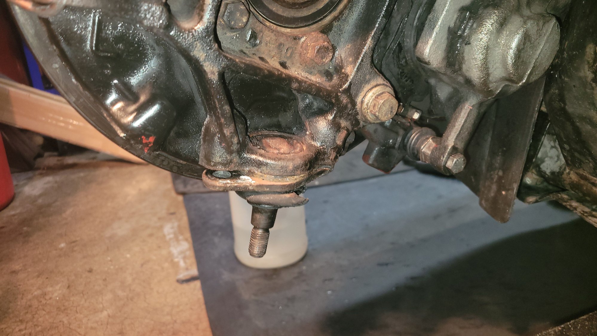

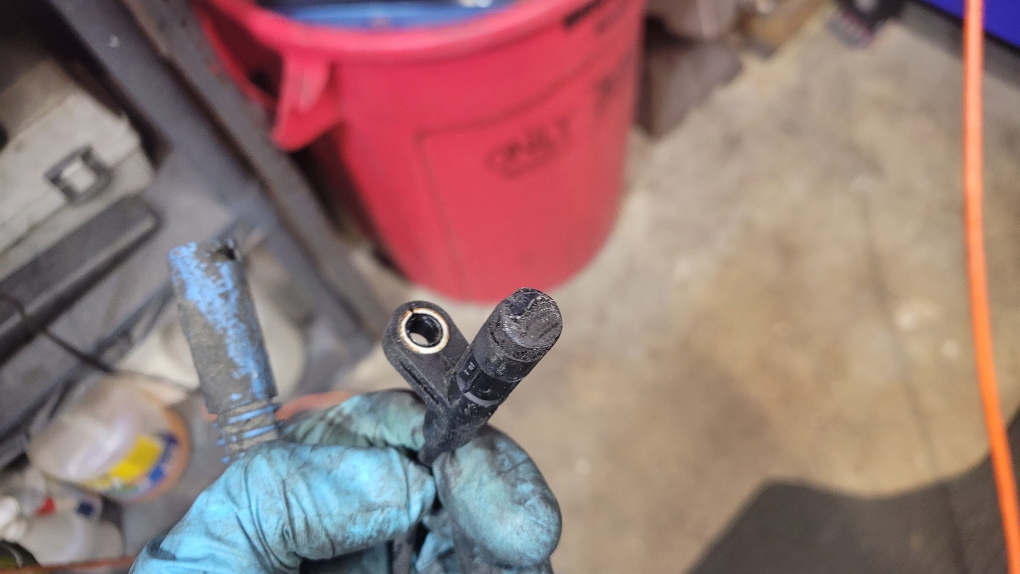

Went to clean passenger side sensor and of course.. had to remove the hub partially and knock drill and knock of the broken off sensor. But I cleaned the tone ring on this side now and have it all ready to put the new sensor in and on drivers side then too since I just removed it it should come out easily.
I sprayed cleaner up at the rears the best I could , I even shot it through the lug holes hoping to clean the sensor and rear tone rings because they're not as easily accessible.
I removed all 4x spacers too so once I get in new sensors hooooooooooooooopefully the lights are off and then i can try the spacers again.
atleast the balljoint was like new yet on the passenger side I swear I replaced both of them but I guess not. I must have only did passenger side..
