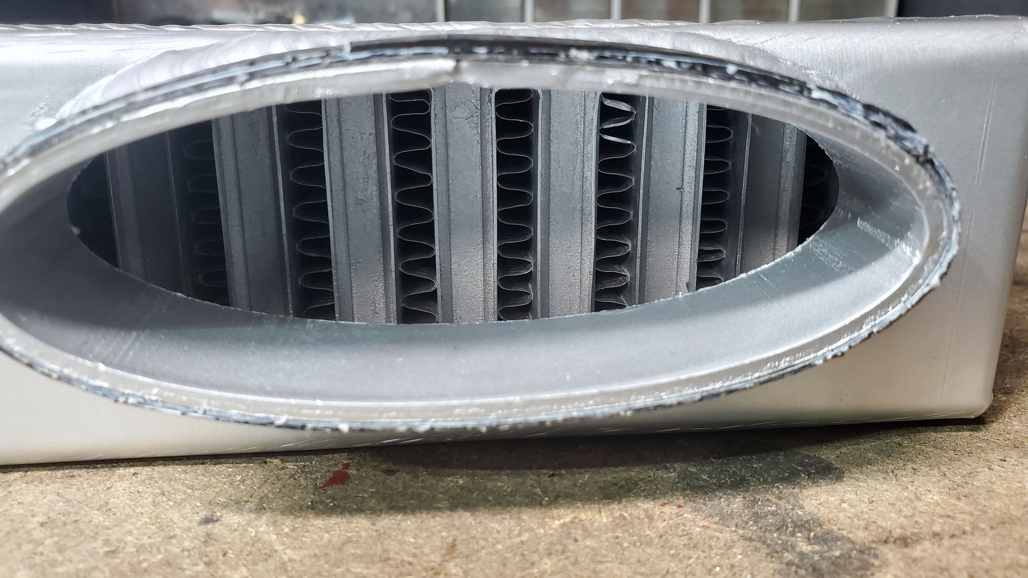

Long story short I was offered this oc for dirt cheap from a seller on ebay who'd said he had 4x laying around for past few years. So I bought it to try it... here's my results...
now, I fixed my fpr hose that was kinked and gained back throttle response and 2lb of boost but i still tested my other ic befor that way and I was peaking 16lb only and would see max iat of double digits ( was 95' day ) ran like 97-99 usually abd hard pulls never got over 130'.when running liquid cooled then just air cooled like 120's and spiked at like 150'. And car felt a abit sluggish as compared to normal.
now. This hobo intercooler. Jdm sport or what ever it's called...it was 75' tonight and normal driving it stayed under 100' in the high 90's.. on HARD LONG PULLS from stop to like 130ot peaked at 200'f BUT the second I let off it immediately went back to 150's within seconds and then in about 1-2min normal driving it was back down to like 110-130s and stayed around there as it gets heat soaked from hard pulls. I did like 7x more pulls all with the same result with temps.. but here's the kicker !!!!! Stock intercooler made max psi 20-21psi , water cooled ic maxed out at 16-17psi this hobo intercooler IT MAXES OUT AT 22-23PSI !!!!! then ontop of it , MY CARS NEVER HAD SUCH GOOD THROTTLE RESPONSE AND TOP END , OMFG !!!!! by time my car was usually doing 70mph ITS NOW DOING 120MPH AND IM NOT BULLCRAPPING !!! THIS THING FLOWS LIKE NO OTHER !!!!
I'm verrrrrrry hesitant to buy the grs motorsport now because I know itle cool better but how much boost am I gonna loose and throttle response vs this hobo ??? Now here's where it gets better !
I seen those temps and could tell that my intake velocity was way up so I turned on my meth and set it to spray the 1st stage at 17psi and no 2nd stage .. IT PULLED EVEN HARDER !!!!!!!! IT CAN FINALLY UTILIZE MY METH !!!!!! then on the longest , hardest pulls it NEVER got above 110' F....
hahaha BUT I don't suggest buying this. It took ALOT to get it to fit and not leak. 1st I had to put high heat tape around the ends to enlarge them about 5mm. I then had to port both ends as they would have been again about 5mm too short and caused interference. Stock boots also absolutely will not work with it either as they're too short and too wide. But after all the B.S , it was worth it in the end..
now I'm gonna be having Adrian tune in my meth and new parts and let's see if I can utilize my 2nd stage and lower iats more and pick up even more power..honestly ny cars NEVER , NEVVVVVVVER felt this powerful. This is what's its sapose to be. A I wonder how long my fpr line was kinked and my old janky boost line I replaced. I bet that caused the initial power loss I was chasing for past 3x months..
leads me to a BIG question , do I even bother buying the grs motorsport intercooler now or do I just stick it out with this hobo since it performs like I've been looking for an ic to do ??
here's pics guys...

So I removed the ic just to 2x check everything and I removed the tape around the edges since I had aftermarket boots and it actually doesn't leak.. I still cannot belive this ic makes only 1lb less boost than my stock ic and even then it only saw that extra 1psi for a few 100rpm.. they both spiked upto 200 on long hard pulls but this hobo recovers far far quicker and actually ACTUALLY provides better throttle response. I did alot of learning about how supercharged cars are effected by stuff like intercoolers and intake Manifolds ect.theres SO MUCH WRONG info on the net about it, supercharged cars respond completely different than turbo cars when it comes to upgrading the air intake system. I learned you gotta find the rite middle ground to amount of cooling needing and boost drop you'll get. And having larger intake all around the ic , I didn't need a huge ic. Supercharged cars will suffer throttle lag and boost drop the larger the intercooler. my water to air ic probably would have better suited my engine had I not had my ported sneed4speed Manifold, larger throttlebody and intake and catless 421 headers.. with the large intercooler on and even the 62mm core intercoolers it was just too large and caused the throttle response to drop as well as boost and power. Though the car can cool far far better , that's not what I need. For it being a street car / 1/4mile runner I don't need such massive cooling. Exp Since I have meth now.. Devil was 100% rite , you pretty much don't even need an ic if your running meth..lol I wonder how much throttle response and boost it would make with a intercooler delete , like make a tapered tube where the ic sits and have it be finned so as the scoops throws air across it it still has some cooling effect and then have the meth activate the 1st stage at 3pai and then 2nd stage at like 11psi for when I'm wot..
I still can't believe how much faster ny car is now.. I know that fpr line was kinked but I haaaaaad to have had some other bad vacuum lines. I did replace almost all of the under the ic and intake Manifold so maybe I fixed what was going on for the past few months causing my power loss.
I also installed ic sprayers onto the front of the ic which do an amazing job at cooling it when I don't wanna use meth or I want it cooler as I'm about to do a hard pull. I also made an air tight air diverter for the ic to force the air down through it as well as not allow any of the water from the ic sprayers to reach back by my wires n coil. I also boxed in the intake filter. Idk if that helps or not but it's not as enclosed as I can get it . I put a shield next to it , sealed it to top of hood , installed rear vent scoops AND installed an m7 aerogel heatshield so Idk what else I could do to make it any better. Though I doooooooo want the dinan airbox I been eyeballing. I still don't know if I should even bother with the grs motorsport intercooler or not..I mean , could it actually make as much boost as my current intercooler??? I know for a fact it would cool better but it would really suck to spend that much money on it only to have my hobo out perform it..
what are your guys thoughts????
