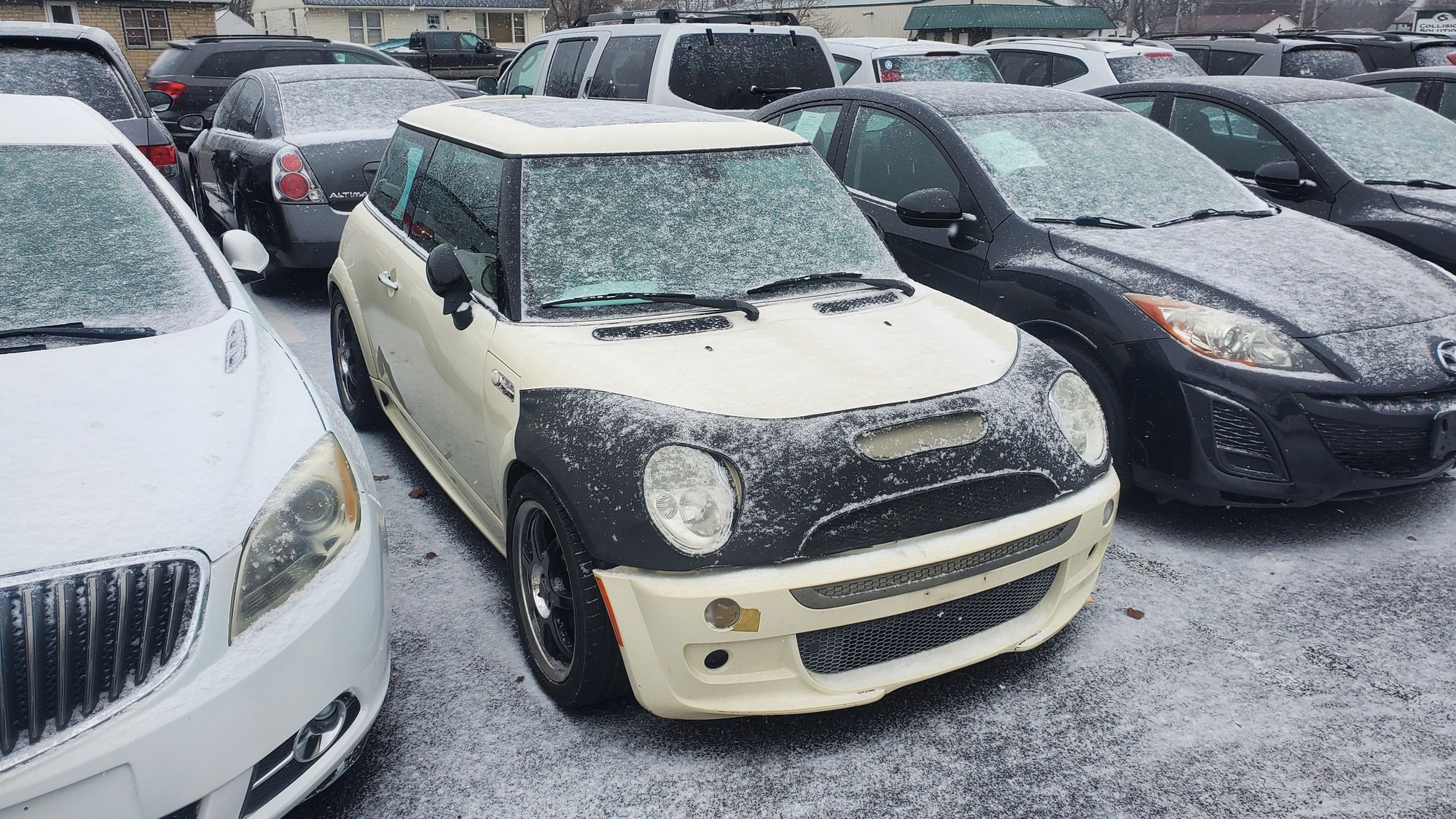

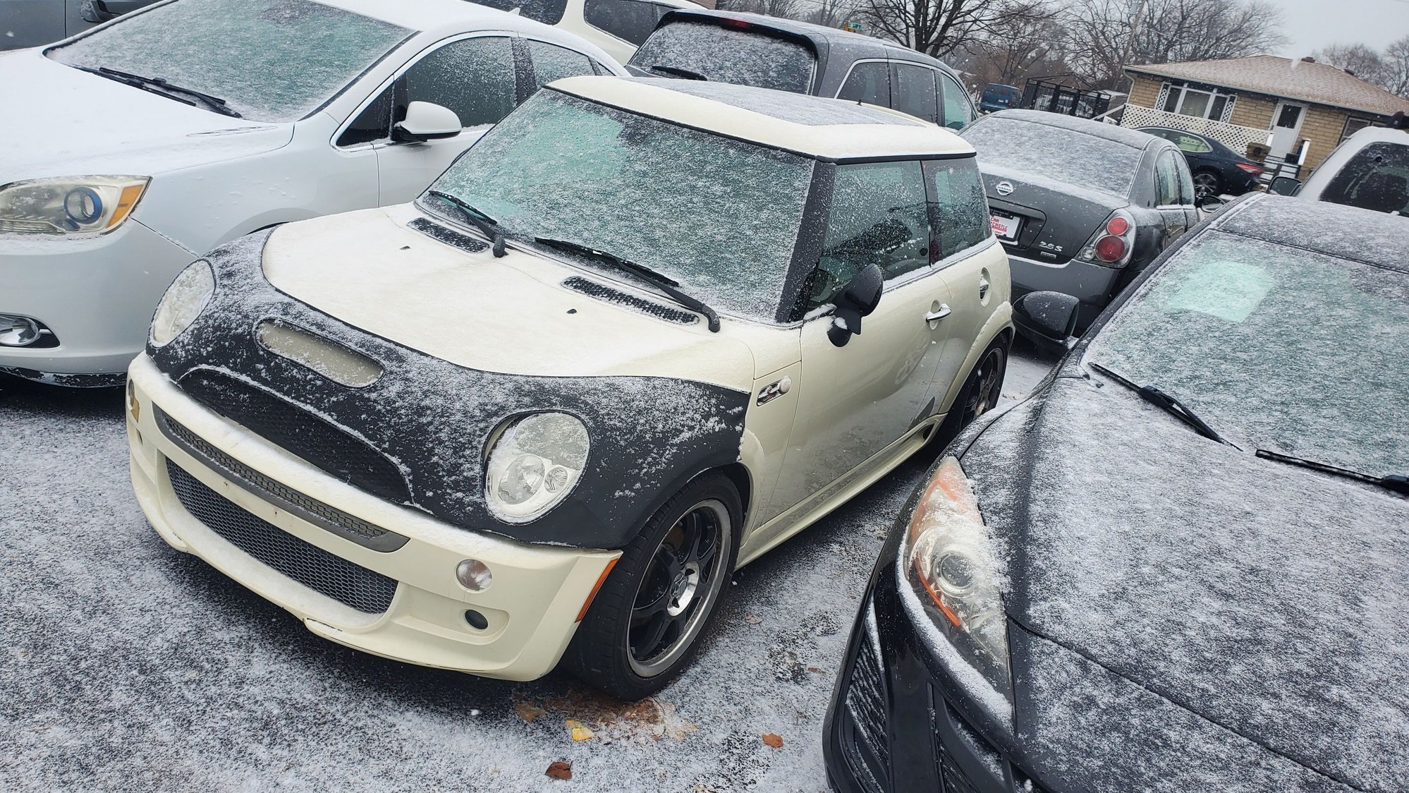

Over Xmas it was bitter cold with negative temps AND steady wind of 30mph with gusts upto 50mph.. then today it was almost 50F , lol gotta love Wisconsin weather..
so I took advantage of the warmth and threw on the ac delete pulley along with new upper engine mount and polly bushing..
idk WHY every ac compressor removal article or video said i had to use a rachet strap or something to pull the engine forward to get the compressor out. Not only did i NOT have to do that i was able to even leave all ky coolant hoses attached and just peeled back the core support enough to get down there and then i dropped the compressor out through the bottom.. I thiiiiiiiiink this pulley is a few mm smaller than the ac one , either that or my best stretched some after sitting fir a few weeks , though it was a new belt I just put on. I felt like it was much easier and I had a tad more slack when putting back on the belt..
the engine mount was straight forward install , didnt have any issues. Though i did wirewheel every bolt I'd taken off and put back on just to clean up their treads and knock off any corrosion starting. Why ? Because I'm nuts like that , that's why ! Lol I like my stuff as nice as I can get it..lol you guys reakky have no clue how much time ive put into the small tiny details on this car that youll probably neber even see or knowtice but in the end it all comes together to make my car that much nicer..
soon as weather and roads permit I'd like to test drive it abd make sure I have no belt slip still.
btw , if you haven't seen yet because we don't text , I aquired another 04 aero finally ! I bring it home the 2nd and will begin a massive cleaning and inspection from top to bottom from the 5th to the 12th because i will be at my brother's watching his dogs for them days so ille take that time to just get a good start on the new mini..
as always , here's pics guys !
Hope your holidays went well.. have a safe , happy new year AND MOTOR ON MINIACS !!!!
