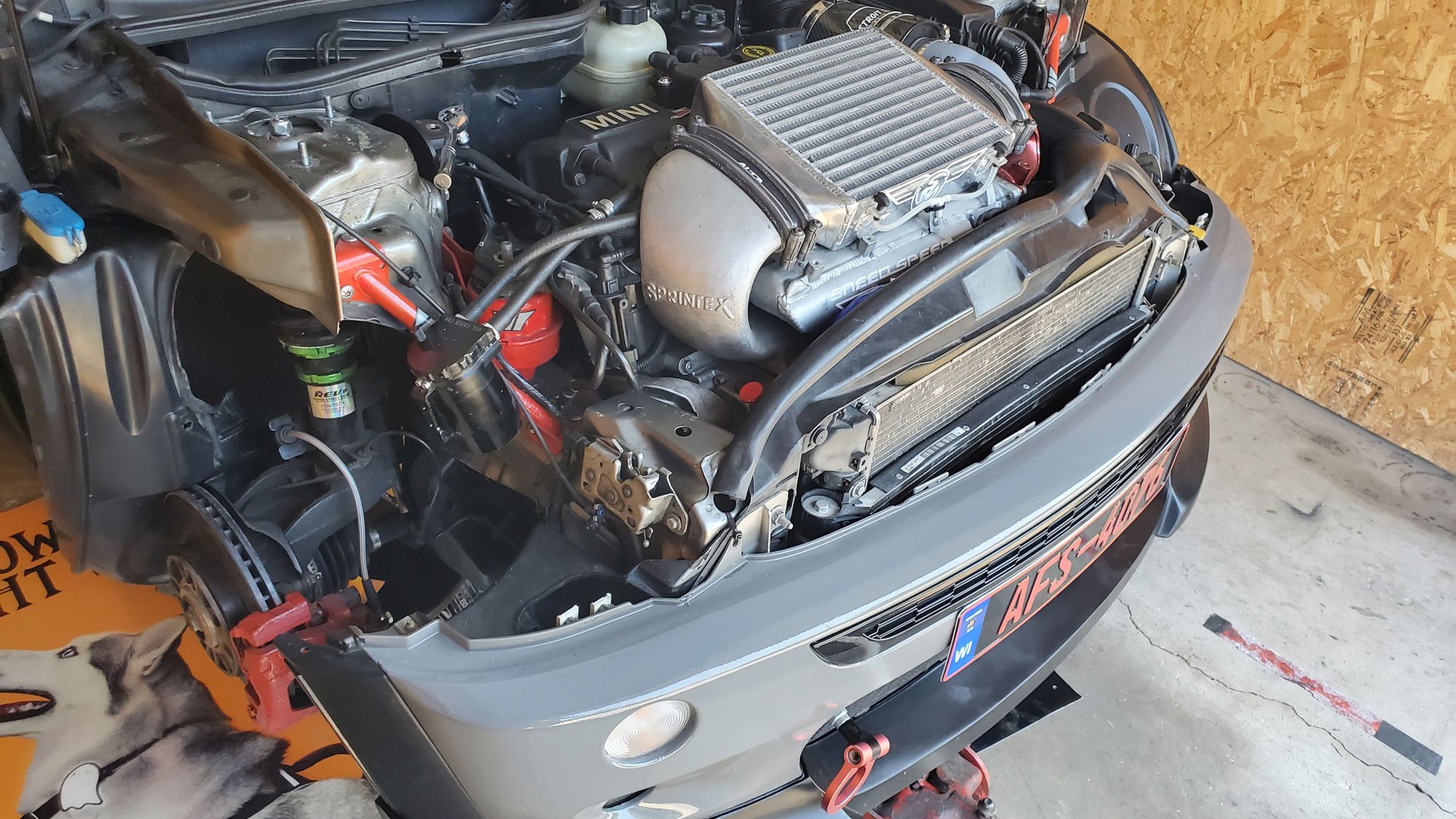

And I'm pretty sure I have the same oil cooler on my wife's mustang. Except we're using it for a transmission fluid cooler on her car. Either way it works VERY well.
yea looks just like mine , though 1/3 the size of the one I got. I wish I had gotten one half the size of the one I have because I wanted to hang it out infront of the bumper fully exposed. Buuuuuut it was too large so it went in behind.

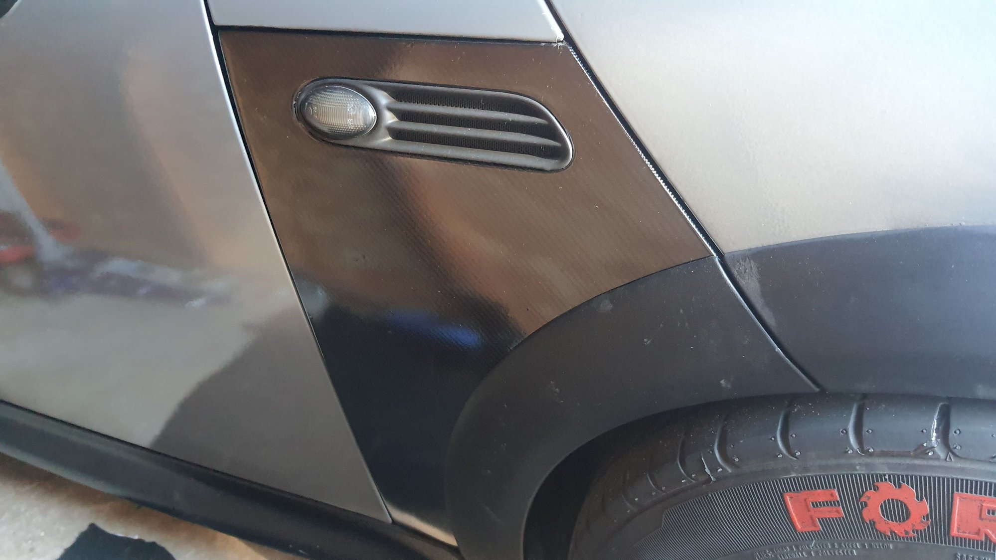

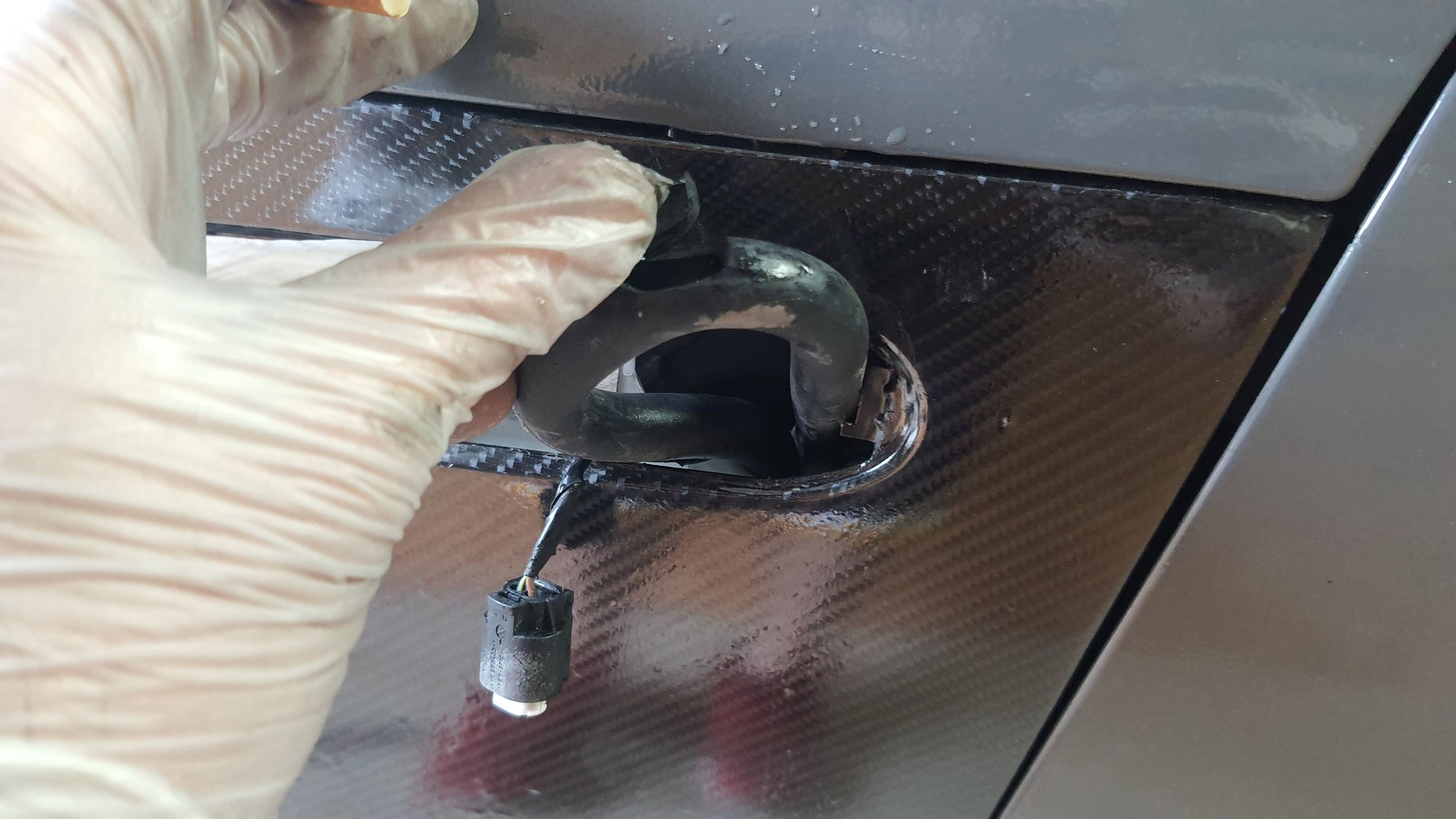

I finally got my 2x new fenders so I wrapped them in carbon fiber wrap too of course..it looks much nicer now that the new trim sits perfectly flush on the new fenders.

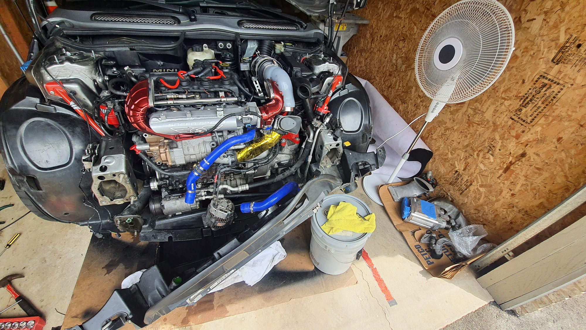

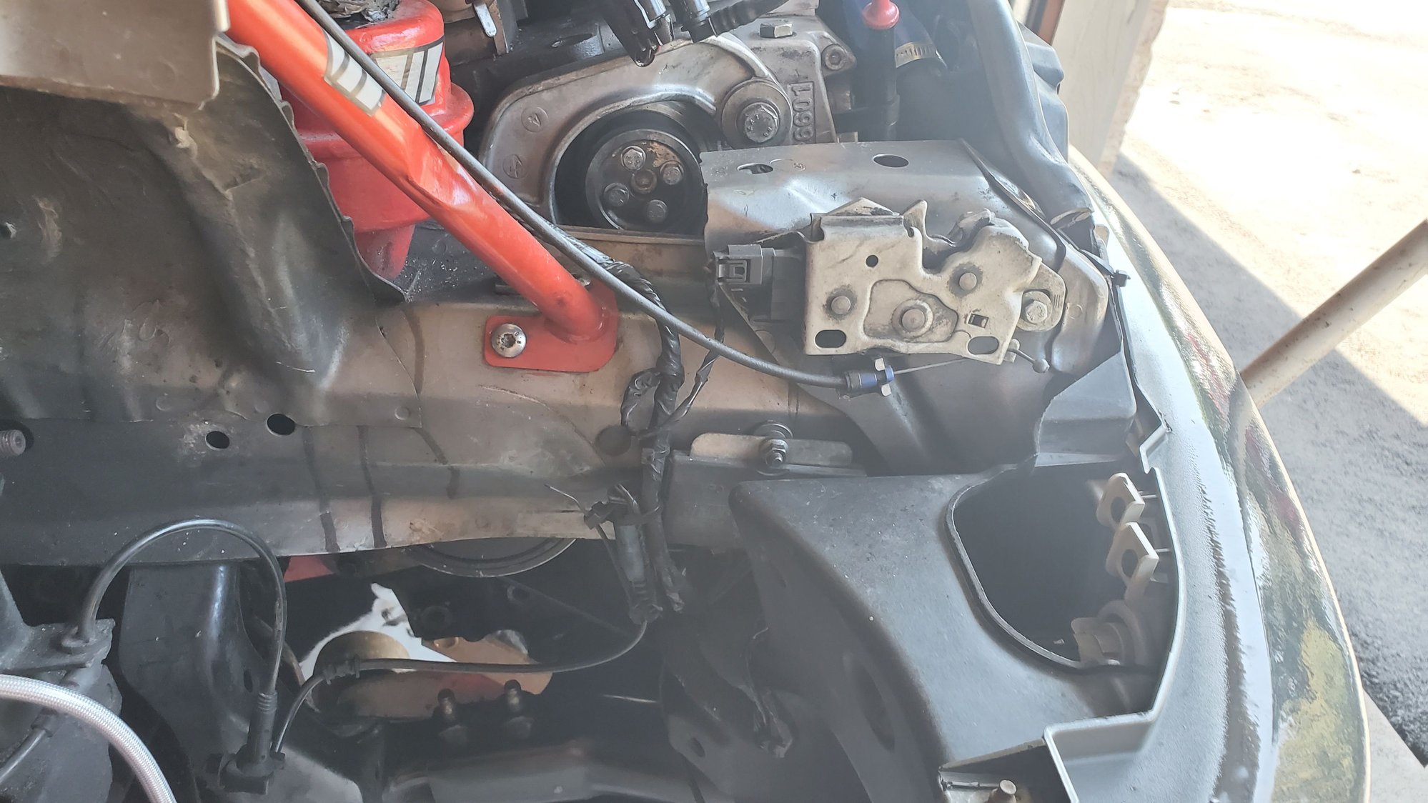

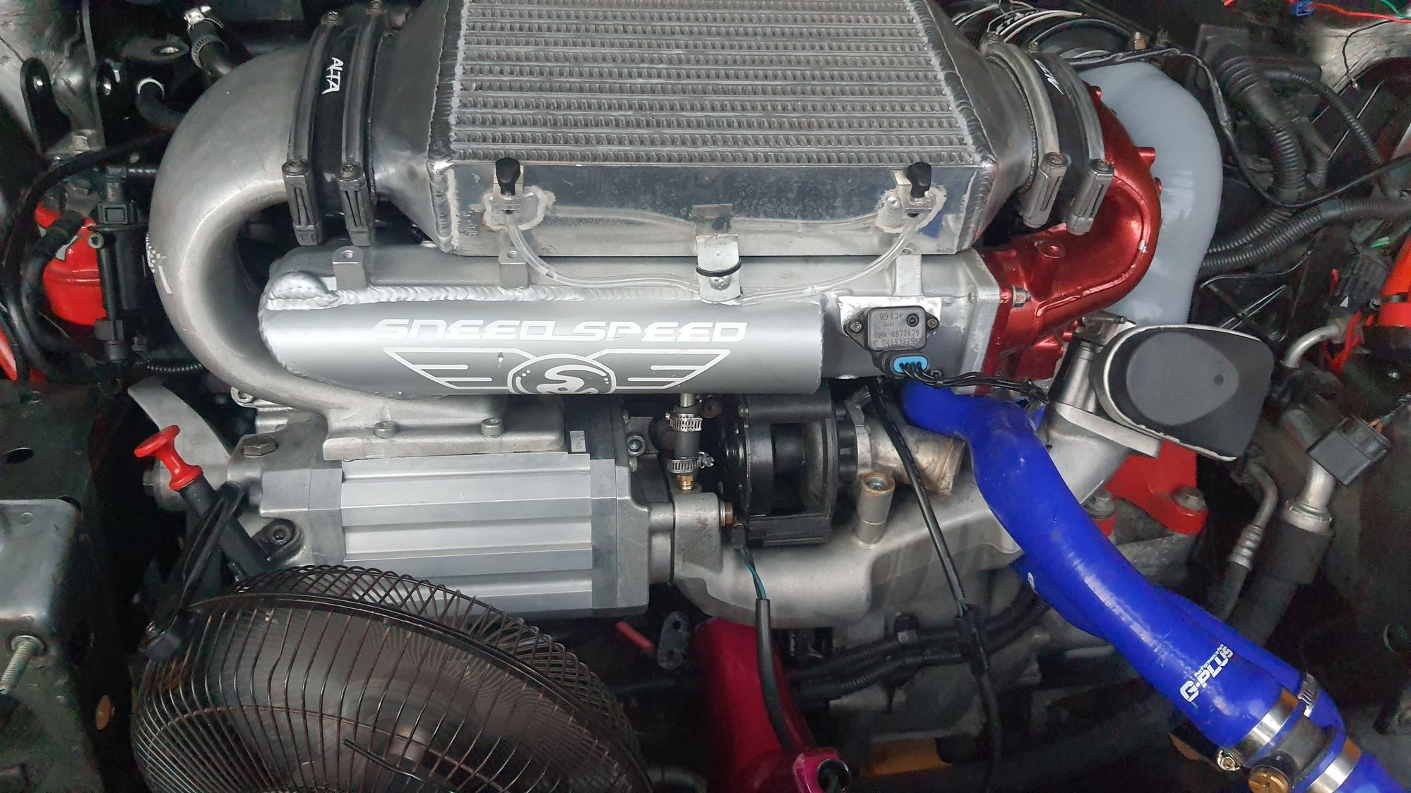

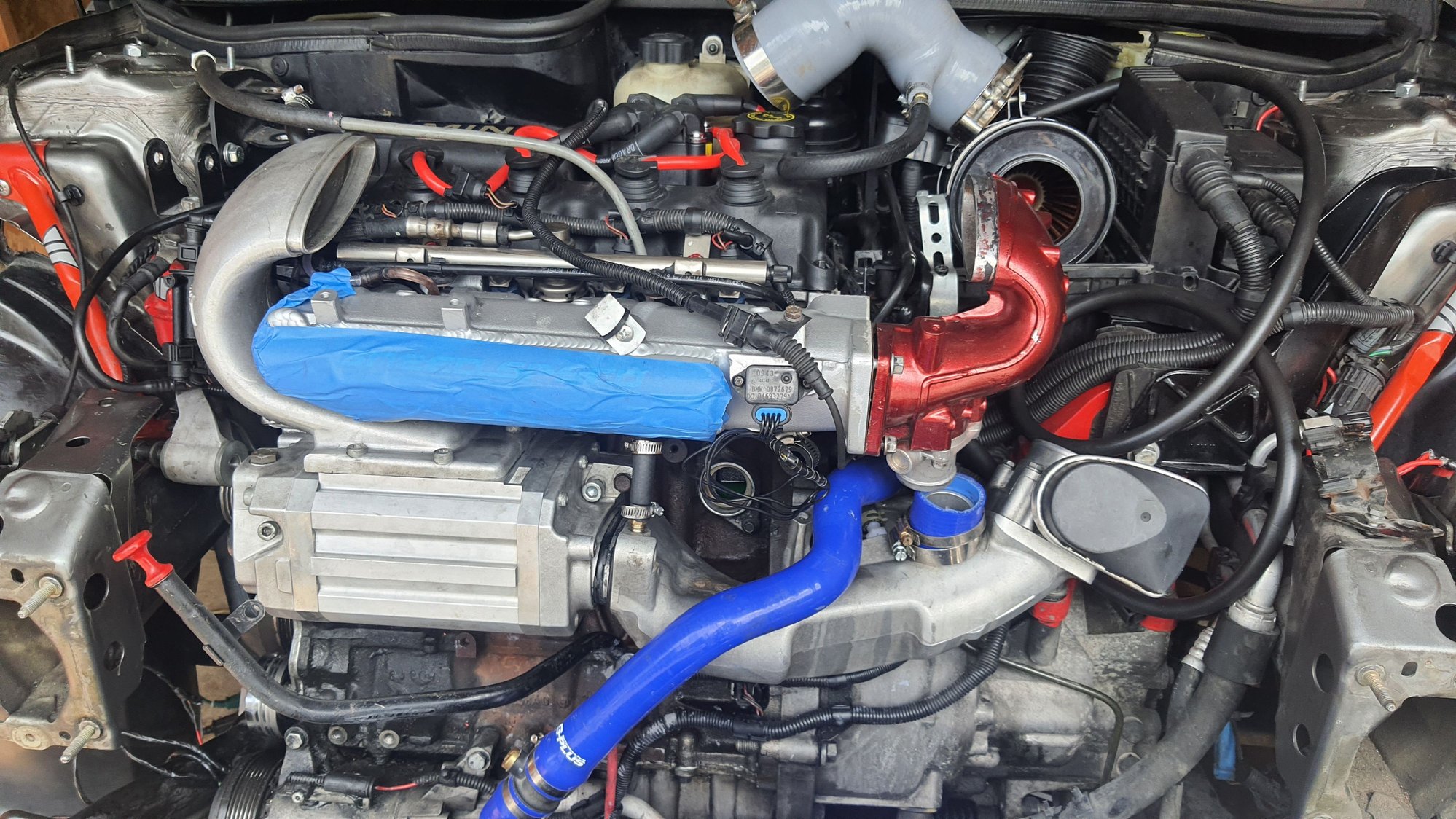

Got it on and absolutely LOOOOOOOVE IT, also got my long tube 4to2to1 headers installed and they sound so much better than the short 4to1 headers.
This sprintex is awesome. Install was strait forward with just a rew things needing to be relocated but was simple . The power is AWESOME, ille attach a video below show it and a drive along. I also finished installing my intercooler sprayer kit I put together and it works fricken 10x better than I expected and was 10x easier to do than I expected . With the exception of having to replace the stock feed line as it had a slice in it and leaked every where. I can't wait for a nice hot day to test it. And don't worry there's epoxy underneath the gorilla tape , tge tape just held it exactly where I needed while it dried so I just left the tape behind then.
Befor the ic sprayer with the sprintex kit and a 95 degree day my it's were averaging 130s which I'm not happy with considering my stock sc made 2lb more boost and ran avg of 10 degrees above ambient temperature. Granted this sprintex kit is more powerful . I feel it doesn't make more peak power buuuuuuut you hit max boost and power so much sooner in the rpm band and its such linear power I looooooove it. It's also cool that it runs the electricwater pump for 2min once you shut down the car to help fight heat soak n cool it down faster..heres pics and videos.

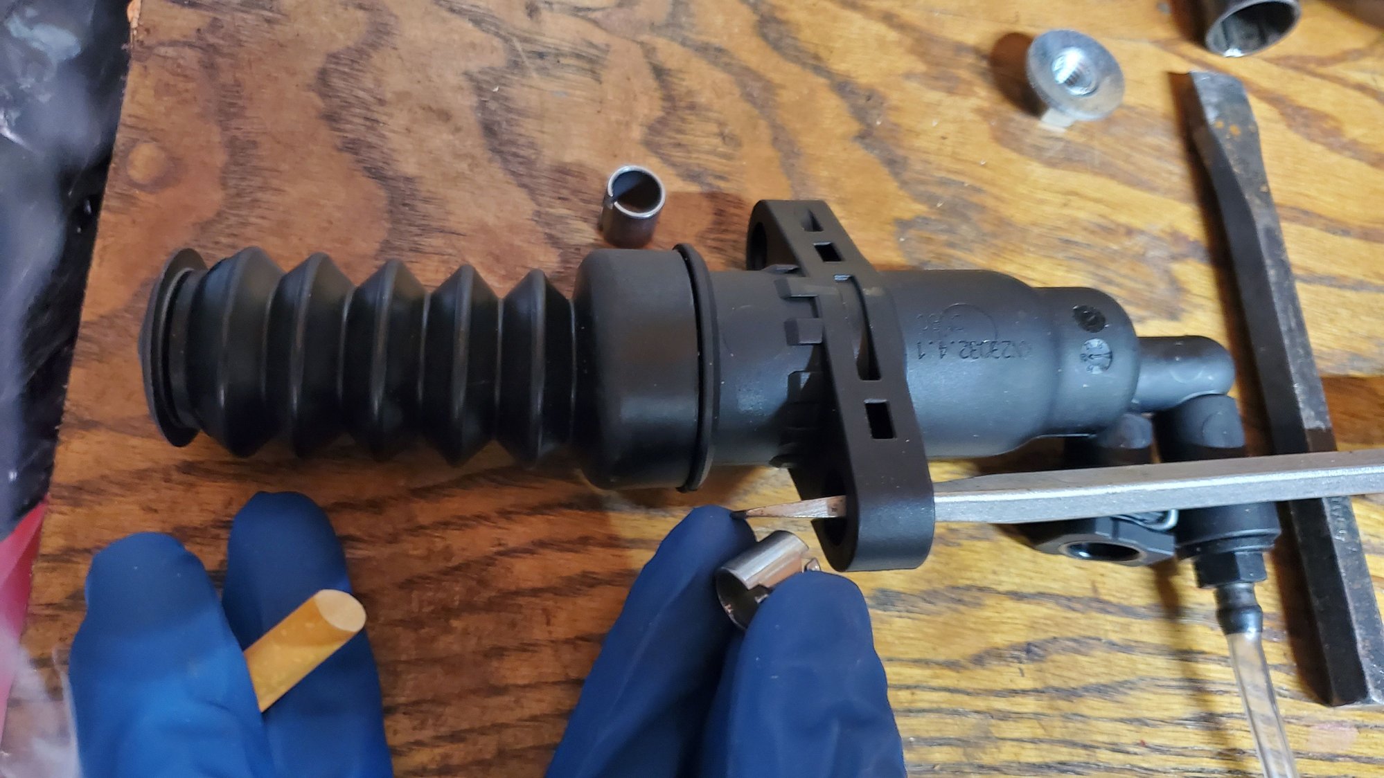

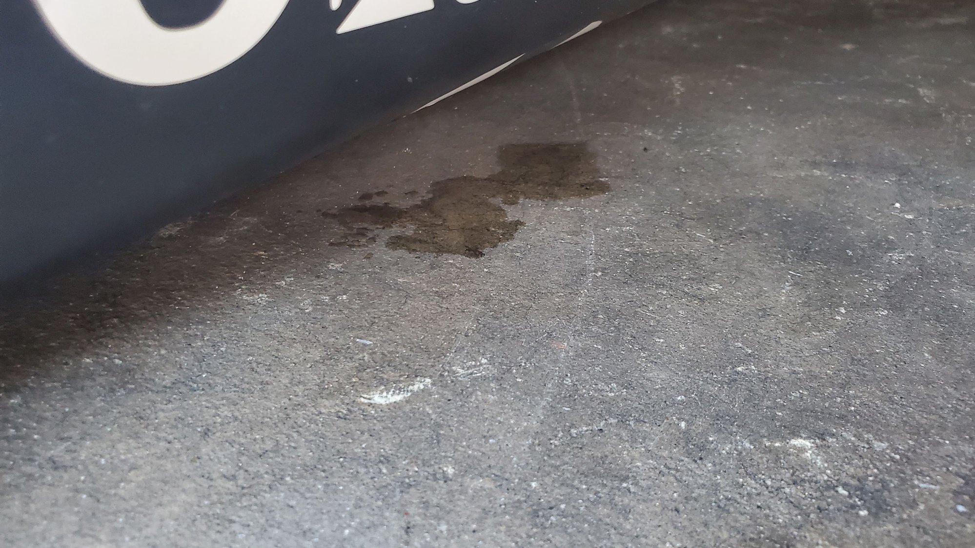

anyways , I went out and seen I had a leaky slave so I replaced that.. WHAT A DISASTER. The 1st one I got I tried for 4 hours strait to bleed and left it over night compressed and still no clutch pressure then found the seal around the plunger was bad from the get go so I went and got a different brand that was exactly like oem and repeated the process but with luck the 2nd time.. I Finally got my 62mm pulley for my sprintex and got the car all set to install it and removed old one ONLY TO FIND OUT MY OLD ONE IS A 60mm ...ggggggrrrrrrrr .. so waste of money of that pulley as I'm not going backwards..sooooooo I will be ordering a light weight 2% crank but unfortunately I won't have enough to buy the ATI super dampner I will probably settle with an Alta light weight 2%....then that's as much boost as ille possibly be able to make on my setup.
