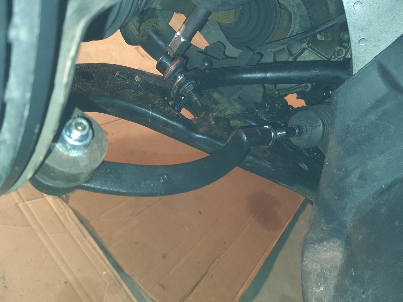

Got the new tierods in, easy peazy.. I used some wood n lines to get ny alignment set as good as I could , once the roads clear I will test drive it and if it's ok than that's awesome but if not I will HAVE TO have it professionally aligned becuase I've did it to the best of my ability.
everything came off easy , I love how they manufactured this car with maintenance in mind. Unfortunately one tierod was seized so I had to cut it in half to get the boot off.
I then went and 2x checked every single bolt under the car I've touched and THANK GOD I did as some were able to be snugged abot more after driving last test drive now that I found the settings BUT my fricken front right caliper bracket bolts , one was backing out and tge other was finger tight..GEEEEEEZ. I guess those needed thread locker on them so I took them out and put it on all my caliper bracket bolts as I wasn't happy with all the others torques either then.

I may be wrong, but is that tie rod installed incorrectly? Isn't it supposed to curve the opposite way? (in towards the axel?)

It also has the letter R on the top. That might mean right. The other has an L.

LOL, I didn't even see that! Definitely wrong side installation.

Lol... yeaaaaaaaa. I flipped them becuase due to the drop and position of the endlinks changing I needed the clearance. It shouldn't effect it I wouldn't think.i read that it's actuallypopularthing to do in the bimmercommunity. alignment looks perfect though only a test drive and alignment shop will tell more..though today just while I was warming it up n circulating fluids I took it just in and 9ut the garage and my steering feels So Much better on that little test atleast. I used to have like 1/4in of play in my steering wheel befor it would fully engage and I always figured it was my steering bushing so that was actually next on my list but the new tierods completely eliminated that slop now. It was obvious my old ones were bad just by touch once off.

What?! You’re giving clearance to your end links in exchange for clearance to the tires. The tie rods curve like that so they don’t rub the tires when you turn.

I checked my clearances and this way provided muuuuch more clearance EXP since I'm running et20 rims and 5mm spacers...

there's a 1st for everything ! There also may in 12 years have never been a mini with my exact setup I'm running either to justify having to do that . Technically I diiiiiiiiiidnt neeeeeed to buuuuut it just provided much more room so why not.
the tie rods are the EXACT same other than the clearance spot, that's it.

I don’t understand why there’s an interference issue with the tie rods. The car doesn’t look that low. What am I missing?

Missing nothing. He's being different because he can. There is no functional impact from mounting the tie rods on the wrong wide of the car. They are made with the curve for a reason, and he's flipped sides for a perceived interference issue with his sway bar links. (which I am not convinced is an issue, but its not my car)

There wasnt an issue just to clarify.its more of a preventative thing. I just did not like how close the sway bar end links sat to them when they were installed correctly.. if the sway bar were to somehow bump back half an inch it would hit the tierod then. So why risk it if I'm going to be pushing the car hard this summer ? It probably wouldn't have hit but I'm just doing it to be extra safe.. i 3x checked and as it is , full crank left or right I have good clearances on all my suspension n braking components with the exception of my caliper to rim since the new rotors and pads but I grinded the calipers so as they wear down they will only clearance more but they are close but fine.
