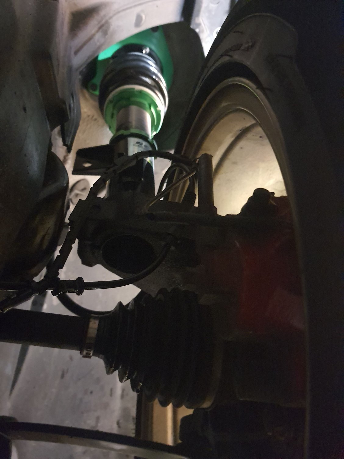

For your brake lines, you will need to remove the nut circled in red. This connects the hard line to the flexible hose portion. BE CAREFUL NOT TO LET THE HARD LINE TWIST!!!! I usually use PB Blaster (or your favorite penetrating oil) on those brake lines before I try to take them apart. With the hard line removed the soft line can be removed from that bracket (yellow circle). It will probably either have a nut on each side or a "U" shaped retention clip that just pops out. If you plan to keep your old brake hoses than just work quickly when you actually break the lines open so your brake fluid reservoir doesn't empty. Some vehicles require the abs module to be activated to bleed the system if air gets in there. That usually requires a vehicle specific scan tool at a dealership. Its easier and cheaper to just make sure fluid stays in the reservoir. A trick to keep the brake fluid from draining out is to use vice grips on the flexible hose and remove the caliper. NEVER DO THIS TO BRAKE LINES YOU PLAN TO REUSE! Let me say that again for anyone who may read this, NEVER CLAMP BRAKE LINES YOU PLAN TO REUSE!!! Doing so can damage the inner wall of the brake hose and cause a blockage in the line. If that happens, when you push your brakes, they wont work. If you plan to throw out your old lines putting a clamp on there will allow you to remove your caliper and attach your SS lines to it ahead of time.
Something else I'll mention for holding a rotor on if you don't have the factory screw is put a wheel bolt in with a big nut or stack of washers. Or if you have a stud conversion just use a lug nut. C-clamp works too never seen that before.
My rear brakes finally came yesterday and I plan to put them in this weekend. IDK how soon your trying to get to the SS lines but I can get some better pictures of how those lines come apart when I do mine if you'd like.
So that hard line nut is a reverse style thread ?

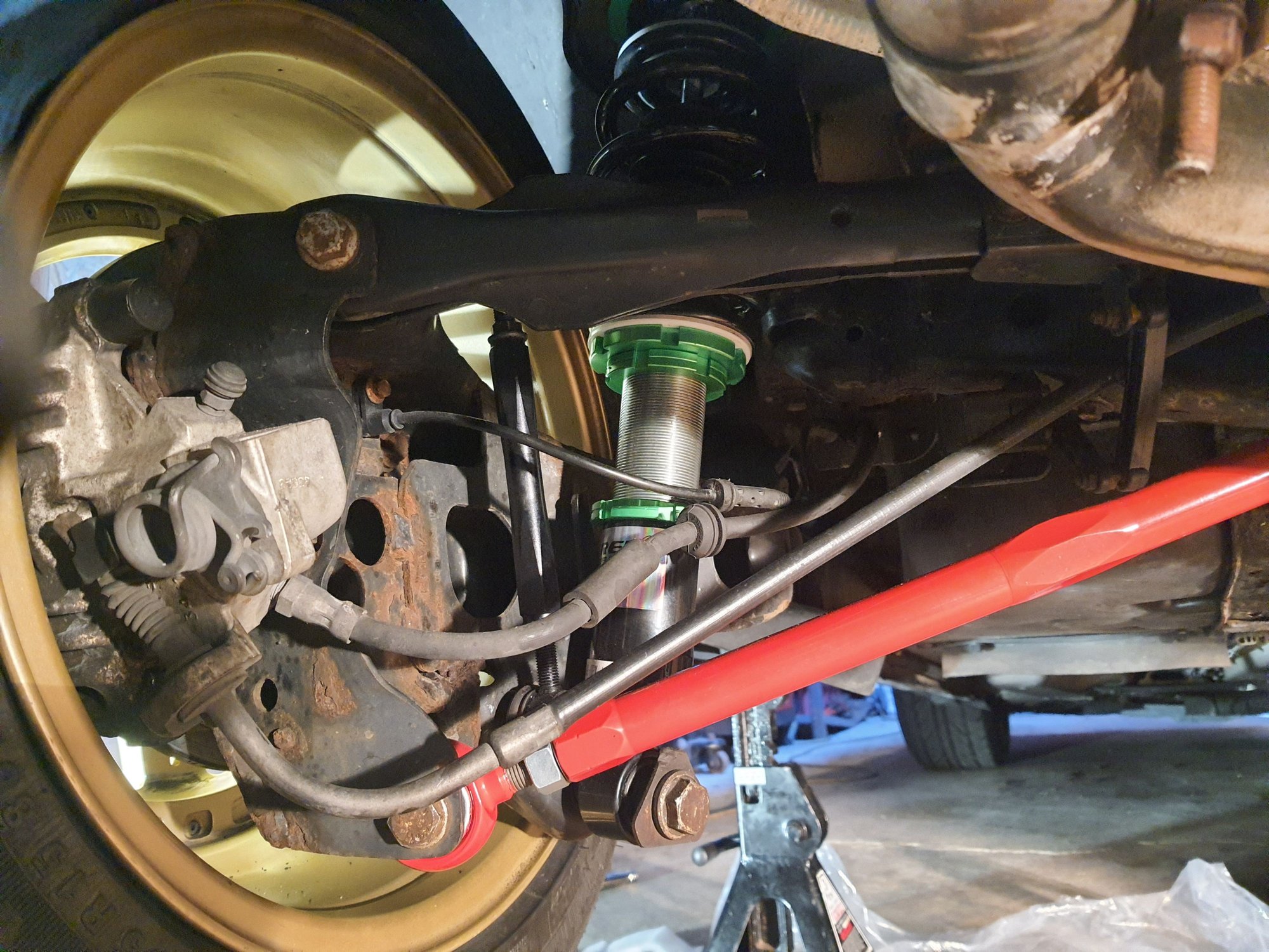

Got the coilovers in , rear adjustable control arms and rear adjustable sway bar end links.. I need to get adjustable end links for the front now too so those will be ordered soon with the camber plates..all went in with no problems at all BUT imo it is a 2 person job.. I just set it at the highest height and 4 clicks from the firmest setting ( has 16 ) . It ACTUALLY sits a tad higher than my stocks did BUT my stocks are old and may have sagged BUT they ARE the sportplus so maybe they just sat lower like that to begin with and these set to stock height of the non sport shocks..
either way I'm happy to get working on the car again and thankfully my cus came over to lend me a hand.. I still have to do my ss brake lines and put in the performance fluid but I will do that when I put on the front end links then send it in for a custom alignment. Thanks for all the help so far guys ,I wouldn't have been able to do half this stuff without your guys guidance.

Looking good man!!! I like the amount of clearance you have between the coil overs and the wheels. I know you run a lot of offset but that is a common problem with coils from what I've read.
