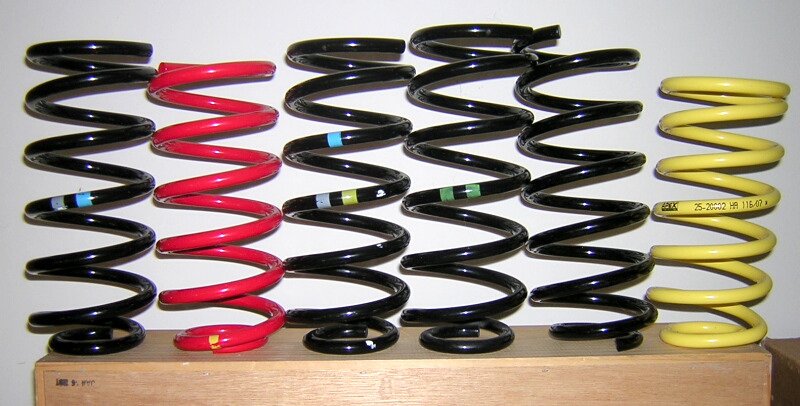

The factory SS+ springs will be black with two stripes. Two grey stripes on the front is very common on 2003-2004 R53's. See the second spring from the left in the first attachment.You can also check the wire diameter with a pair of calipers. The SS+ with two grey stripes should measure at 14mm
If the rears are black with one grey & one blue stripe or one blue, one grey plus a third yellow stripe, you have factory SS+ for the R53. Those should Mic out at 11mm wire diameter.

Whoops! should've posted that info.
Fronts:
(L to R) JCW (R53 with A/C & sunroof), SS+ (2003 R53 w Sunroof A/C), TSW (V.3), SS (5spd R50)
Rears:
(L to R) SS+ (2003 R53 w. A/C & sunroof), JCW (R53 w A/C & sunroof).SS+ (R53 2004 build w A/C & sunroof)**, SS (R50 w 5spd), TSW, Apex (Dutch aftermarket springs).
** the 2004 R53 w A/C & Sunroof I examined also used the Grey/grey front springs identical to the '03 R53 ( same wire diam. coil diam & free length)
There are other SS & SS+springs out there that aren't shown here. They will have different color paint stripes.
