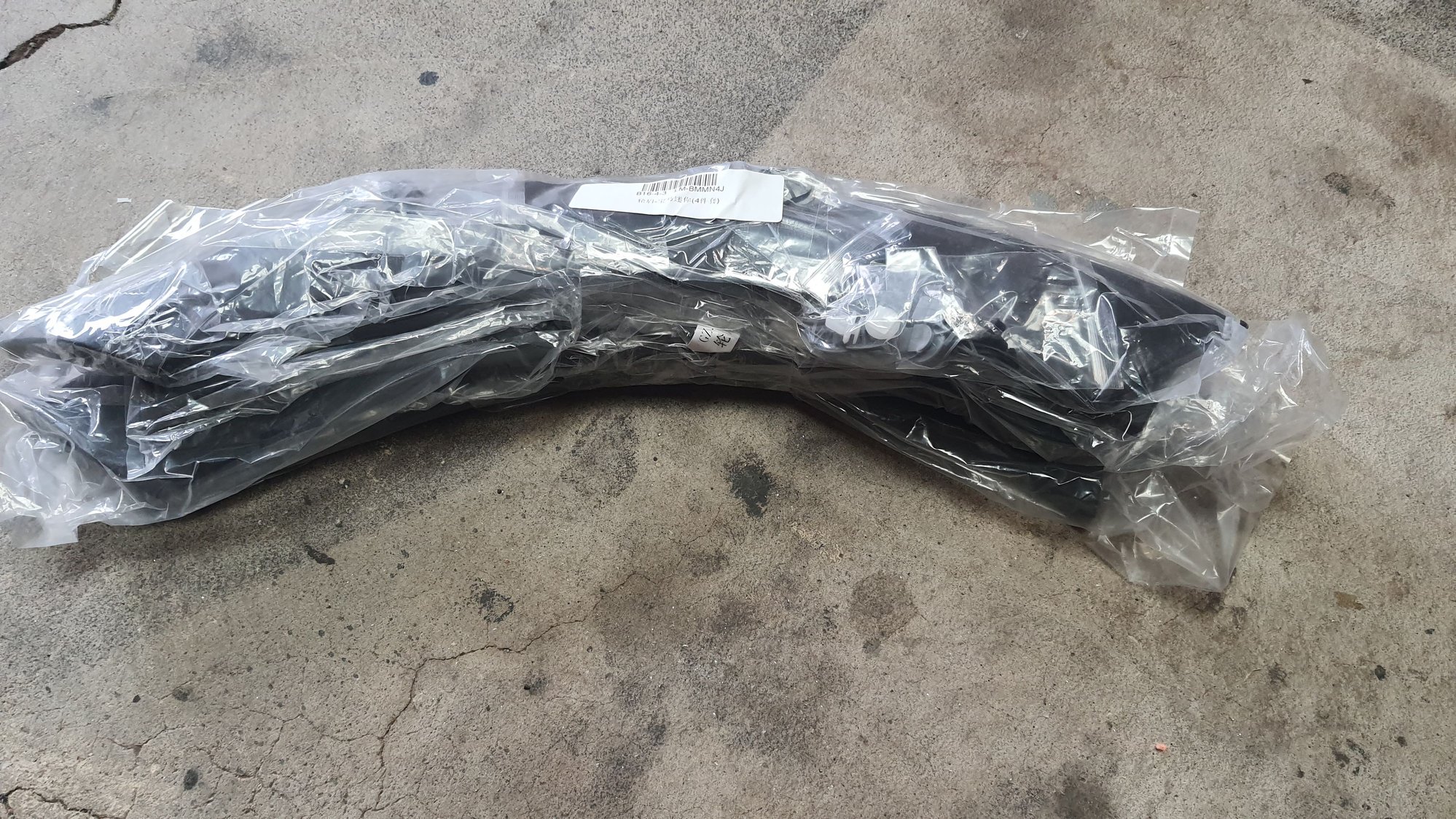

Few more goodies came which were the last of my stuff until I get the GEN 2 SPRINTEX KIT in a few weeks.. I also ported the heck out my sneed4speed manifold too. Got a cool mood lighting kit to see how it works out n looks. A shifter **** and extender to try n make it easier to reach when I shift , ss lines n new fluid , and fun buttons to activate my ic sprayers I will be making and some new fender flares as my old ones bit the dust trying to remove them and I didn't feel like trying to fix the broken clips.

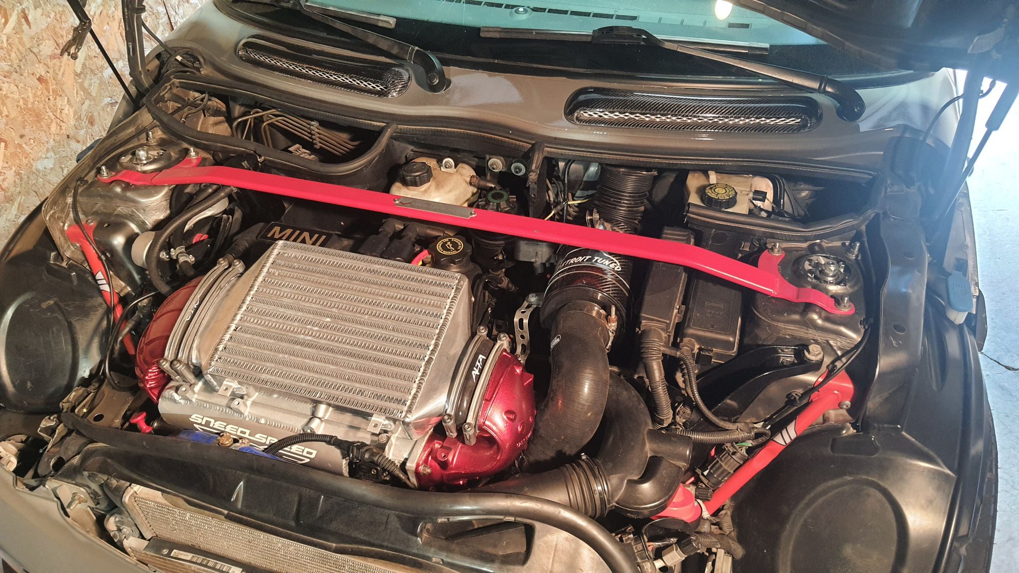

While the cars clear n paint finishes curing ( went very thick ) I been starting to caaaaaarefully put on my new parts. The car will still need a cut , buff n polish..
I started cleaning up under my engine bay. I got in the new brisk sparkplugs, screaming demon coilpack, and the dragonfire wires. I also put in the new map sensor and tmap sensor as well as a new 02 sensor ( all oem ). I also put on the larger throttlebody and I had to hollow out the intake by cutting out 2x plys just like I had to do to make it fit my enclosed filter. The filter and throttlebody are both bout 70mm and the intake was made to fit the puny stock throttlebody. I then rerouted the vacuum lines by using a simple T and a foots worth of extra tubing. Then to correct the intake issue I contacted a company on ebay that sells a bunch of silicone intakes and coolant hoses for multiple different vehicles, I actually got my coolant hoses through them anyways I messaged them and asked if they could make me a full 3inch intake which they gladly said " yes " to. So when I get that ille swap out my hacked up one I have in since it's actually a smaller diameter completely. I also wired in a new map sensor plug . This should all compliment the SneedSpeed intake manifold which then it will ALL compliment the gen2 sprintex even more..
Old May 22, 2021 | 10:13 AM
  #292
nd-photo.nl's Avatar
nd-photo.nl
Joined: Jun 2020
Posts: 1,146
Likes: 313
From: The Netherlands
Nice work man, your Mini will benefit from that full 3" intake!

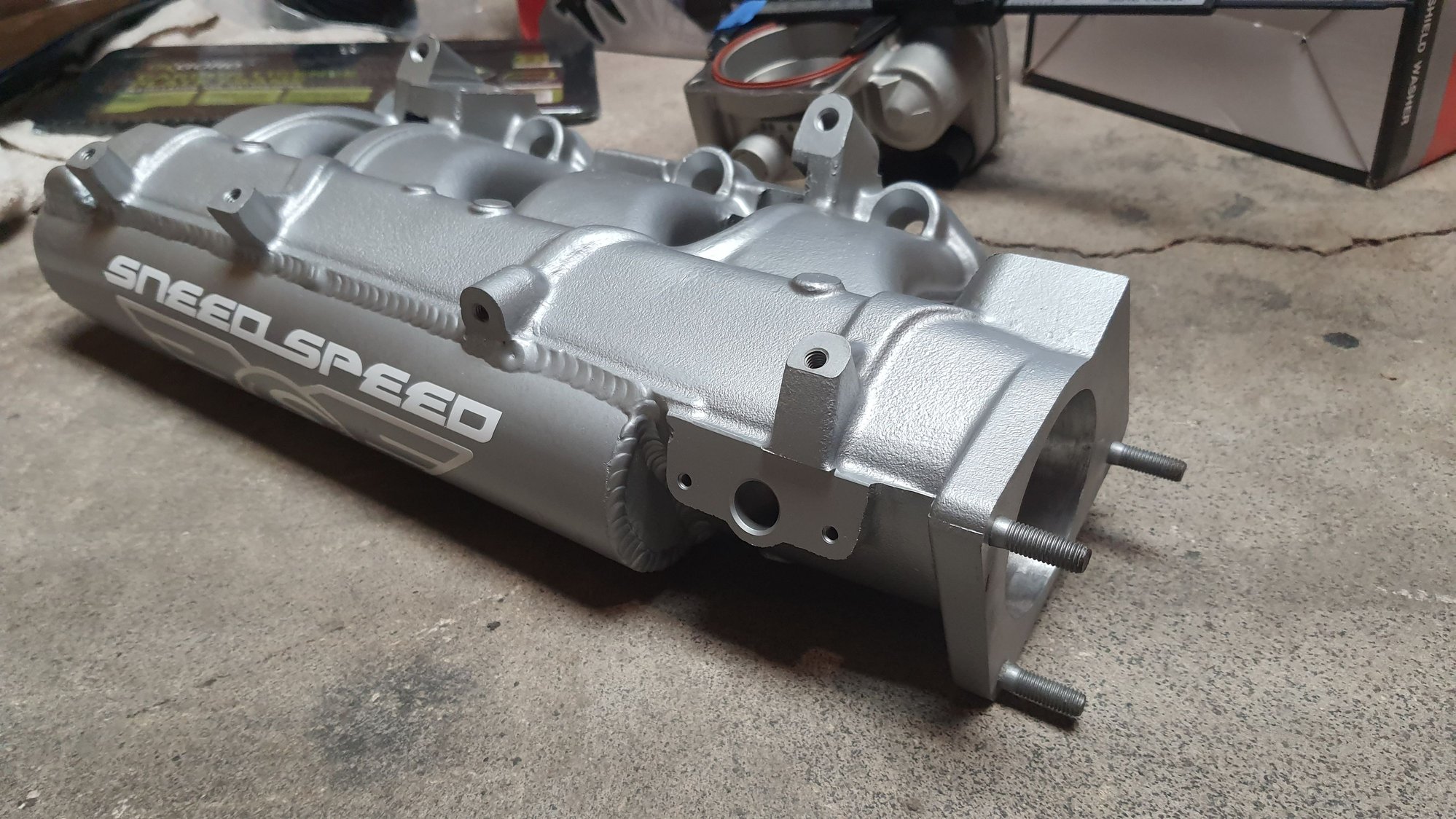

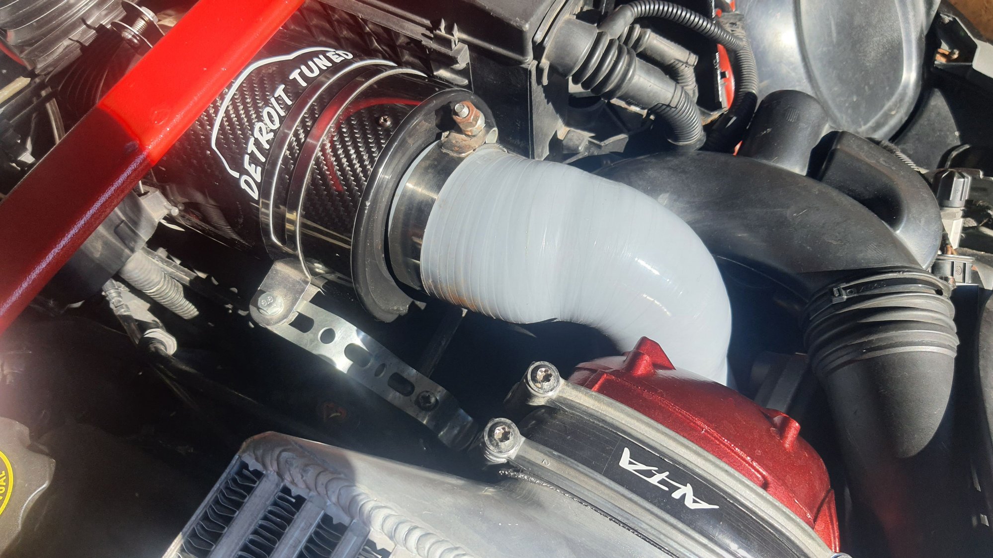

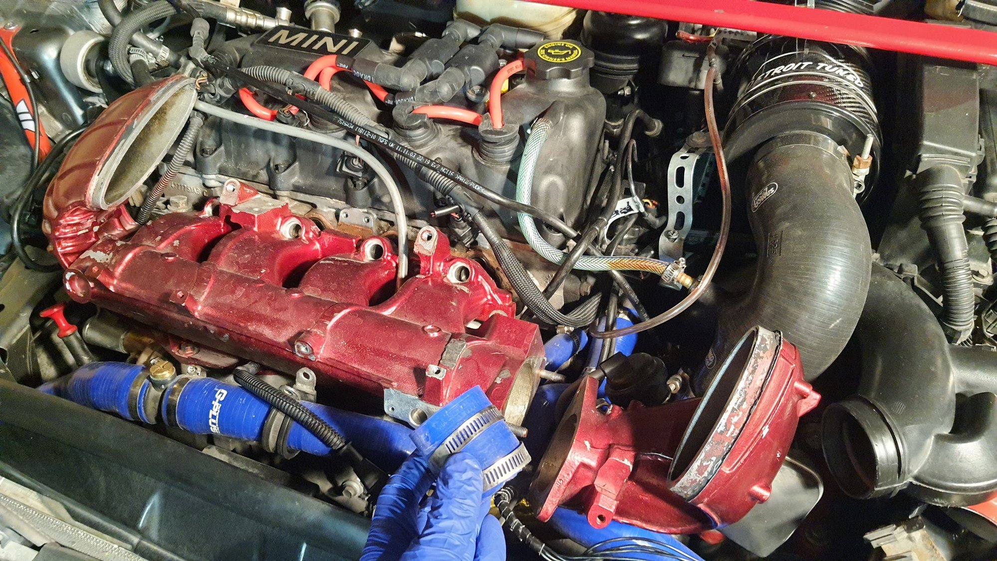

Wellllllll 3in tbody FAIL !!!!!!!! atleast on my setup it lost so much tq down low the bit it gained up top was not worth it. I could barely squak the tires going into 2nd , o well. So I put the stock tbody back on . I then put on my sneedspeed manifold and fixed the vacuum line routing mess I had and cleaned out my fuel injectors.. I didn't even remove the sc lol I just backed all the bolts out a bit so I could move it forward about 1/4in so that the left tab on the stock manifold would clear the intercooler horn base and slide off. I then grinded off the tab then on the sneedspeed manifold so encase I need to service it or something I can easily remove it.

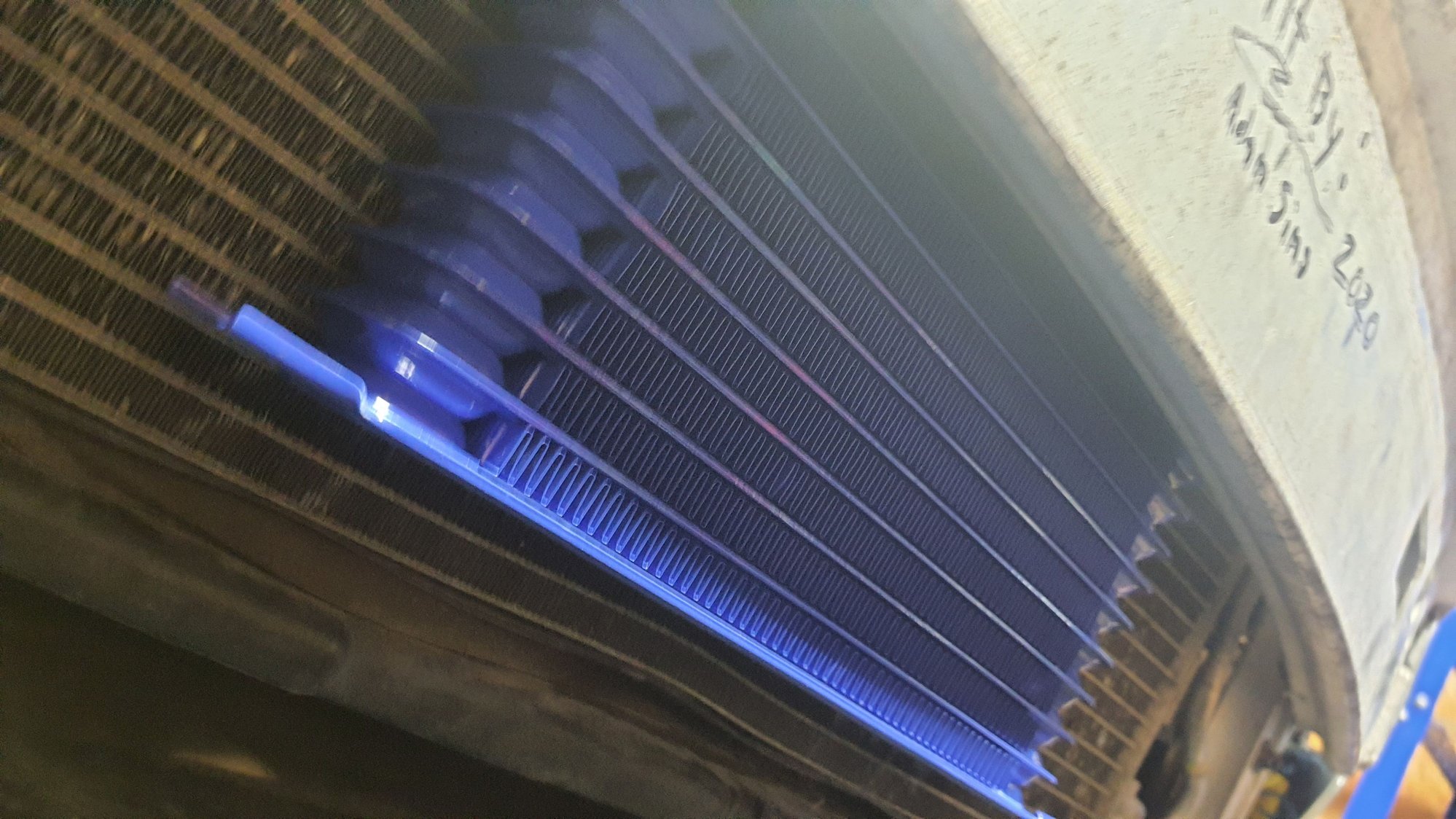

also check out my intercooler, knowtice I had them purposely make me one with the tabs backwards? Now I can easily mount the intercooler sprayers riiiiiiite onto those for perfect aim of spray then. I also had a company make me a full 3in intake which I will still use as my filter is 3in and maybe one I get on my better headers n sprintex then maybe a 3in tbody miiiiiiight be beneficial.
anyways I took it for a little rest drive and I am ABSOLUTELY IMPRESSED with this manifold. Instant in the pants feel gain. There's absolutely no oooooo drop off on power all the way to fricken 7500 rpm..lol this little suckeres sucking well now . It's all around smoother too and omg it actually made the engine sound beefier too. I also put on my new wheel and rear view mirror rain guards.
put on my battery tray under cover too. Pita !!!!! not made for aftermarket exhaust I'm sure but I willed it on.

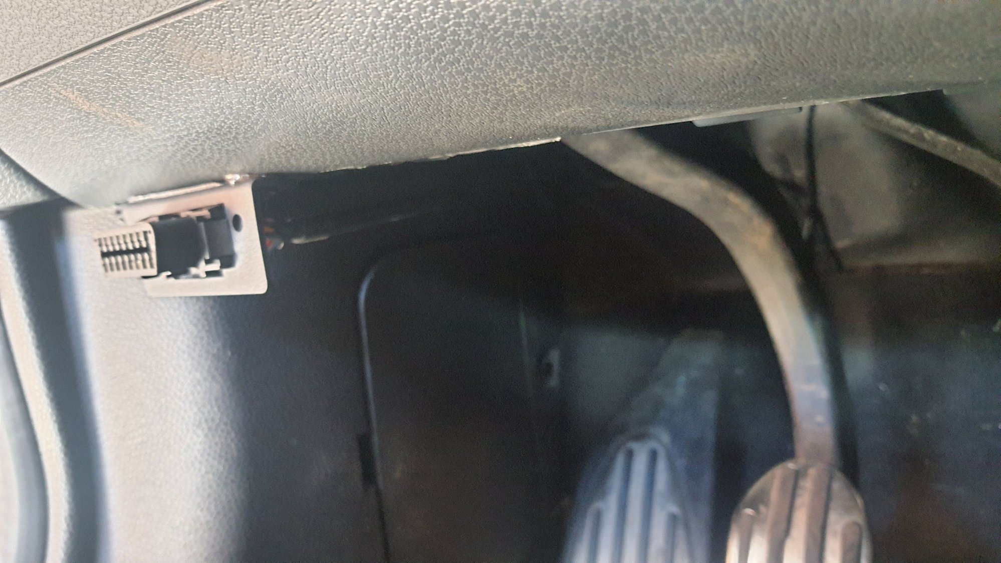

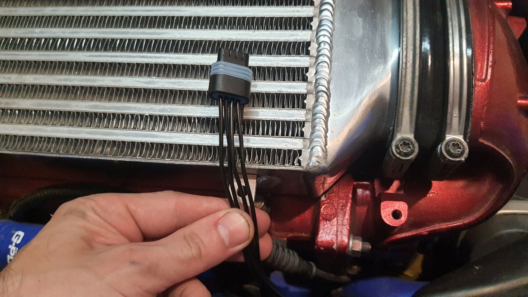

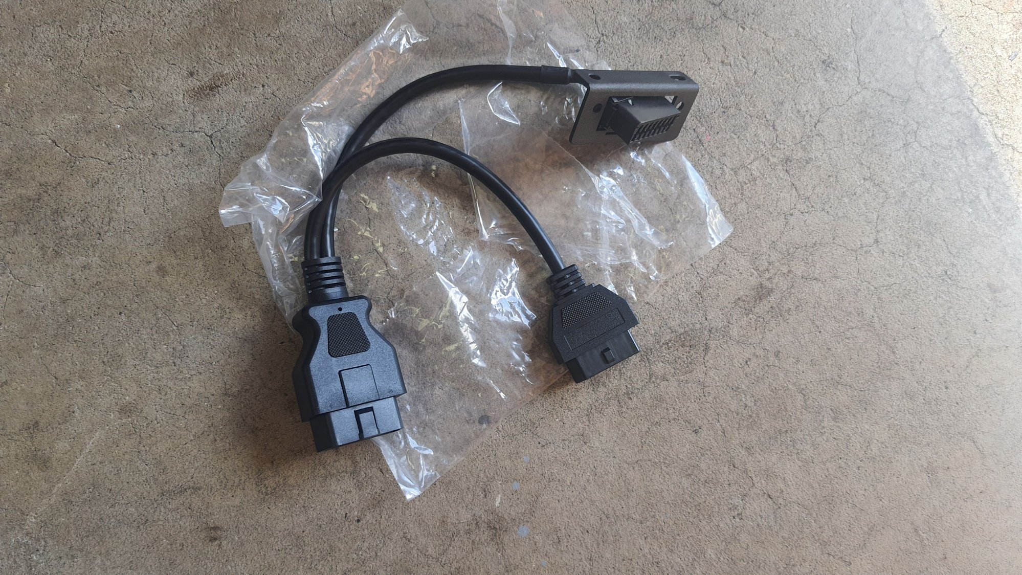

Wired in and relocated my obd2 y splitter and put on a different style shift ****. I also mounted the ic cooler nozzles and plumbed the line half way to the trunk then ran out of line , lol so I need more to finish it. I also am installing the trigger under my gas pedal so anything over 3/4 throttle it will spray away. The cooler has been an easy strait forward install thankfully. So day or two ille mount the switch , finish running the lines and mount the reservoir.

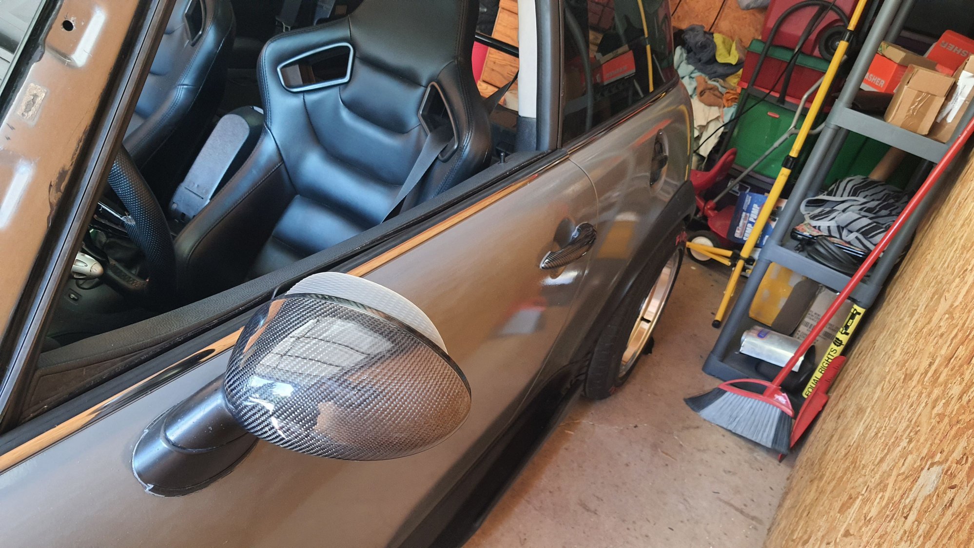

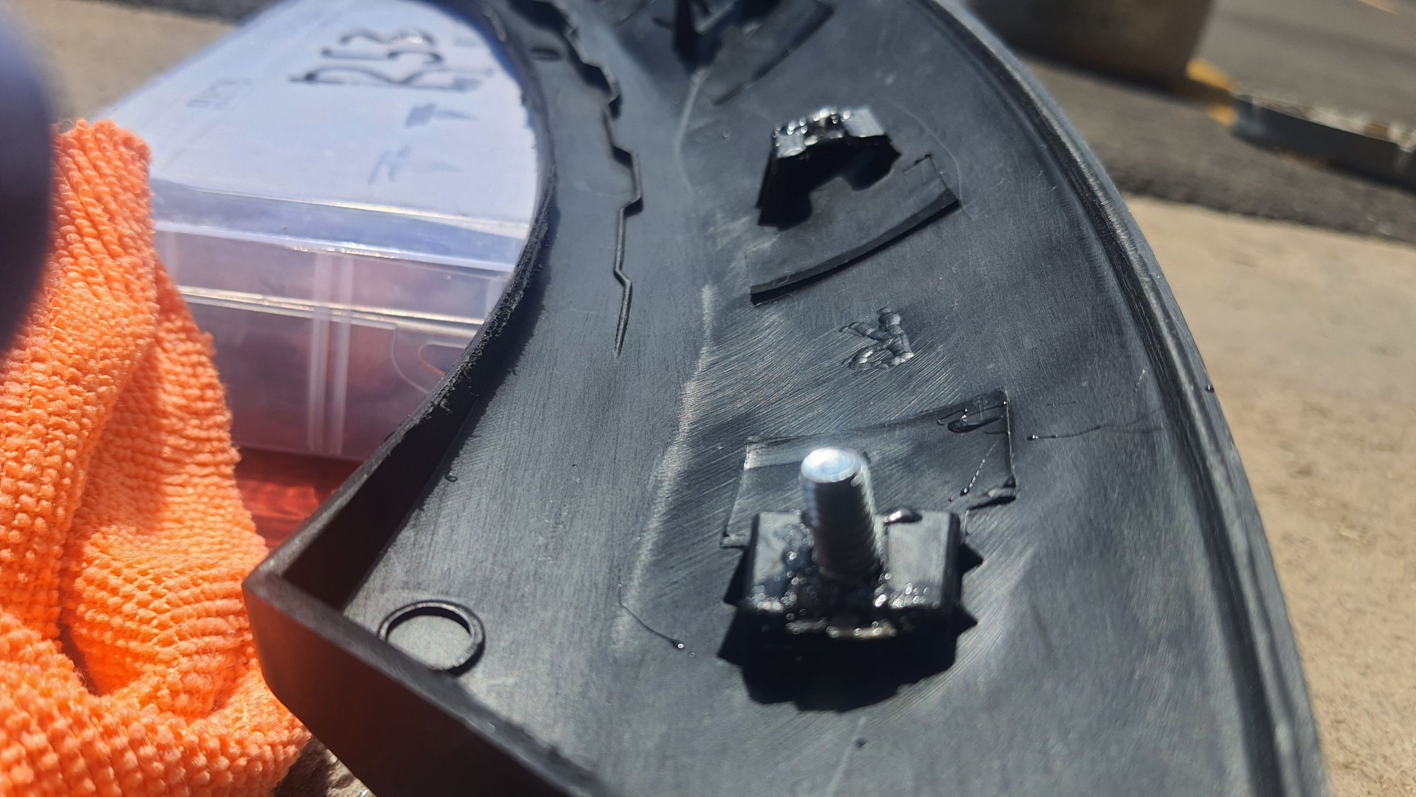

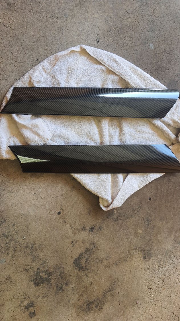

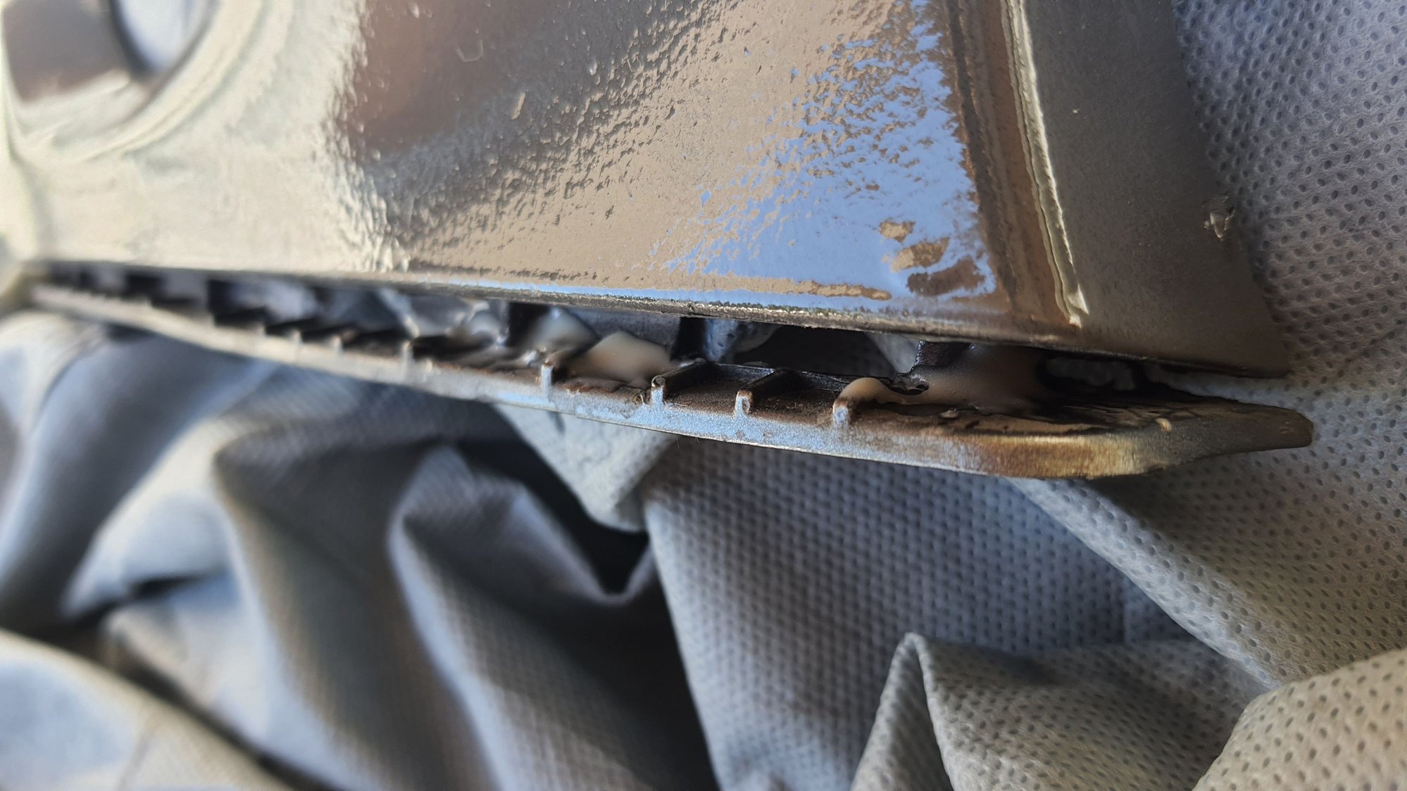

Been busy AF .. I relined the trim instead of a flat black blackout tape I used a carbon fiber looking tape which looks much nicer, got in my new windshield and had to rig in the lower trim but thankfully it went in flush all the way around and sealed..I was going to cut the bumper support to fit the oilcooler behind it but LOLOLOL my ac condenser has always been slightly bent so I was able to actually perfectly fit the oilcooler infront of it so it gets direct air through the lower grill since I can't fit it anywhere else that's beneficial and use the cooling fan then...
I been cleaning up over spray and putting on the trim perfect and fixing little cracks and broken tabs behind the bumper and stuff..

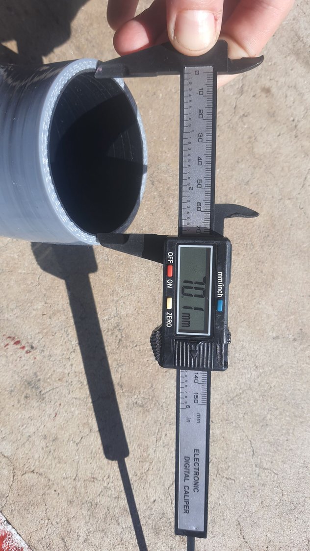

I also got my custom 3in intake and it matches my car almost perfect. Its way larger than even the aftermarket tube I widened already.. I order the sprintex in 3days !!!

Man I like that beltline tape! I've been contemplating blacking out all the chrome on mine, I even bought a couple cans of Rust-Oleum Peel Coat in gloss black to see how it'll look.
