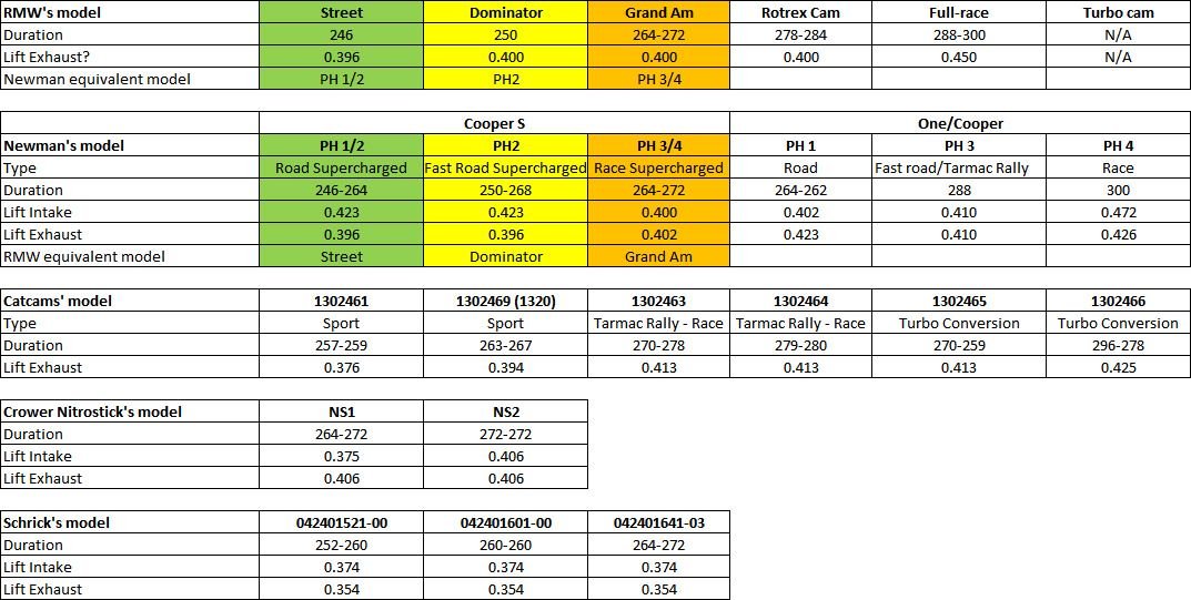

The cam you have is also paired well to the size valves in the head that you have from thumper. That being said the 469 will not loose you anything. No response no bog nothing of the sort. But it also is better suited for larger valves then the version of thumper head you have. As far as the idle thing it was just that the v1 r53 simmens ecu doesnt like it. The v2 VDO ecu has more tuning variables then the v1. So the v1 might not handle its idle characteristics. The v2 has more tweaks at idle so it can handle it. BlwnAway documents this in his thread.
Again I can only speak to the set of parts I have as most of it was designed together to do what it does. Start moving stuff around this part or that part I cant say. To many variables which is why I just stuck to what was designed and known to produce the result I wanted.
The stock head is complete *****. But all the bull ***** here about heads is just that. I trust Alex the engine designer not Jan or Mike/Thumper. I go by what he says. After all he designed the damn thing presented a Master/Phd level paper on the engine at trade shows which can be downloaded. Any one else is just bench barfinf random crap. He tells me X product is actually scientifically better I take it to the bank. Same thing with the Simmens ecu engineers I am friends with.
But I digress only saying the head flow on the engine is the biggest limiting factor and thats why the fiat tritec made now is so different. Lots of people getting those heads chopping off the cam phaser and using them. Luckily you dont have a bone stock head so thats good. Lots of stuff is always reading between the lines and knowing who to actually listen to and not some rando forum guy that had to beg his wife for a cam or pulley let alone GASP 3k on a BVH.
Here is a good cam chart fwiw. The cam you have now is already close to values of 469 pending on where each company measured the values as their is no standard.

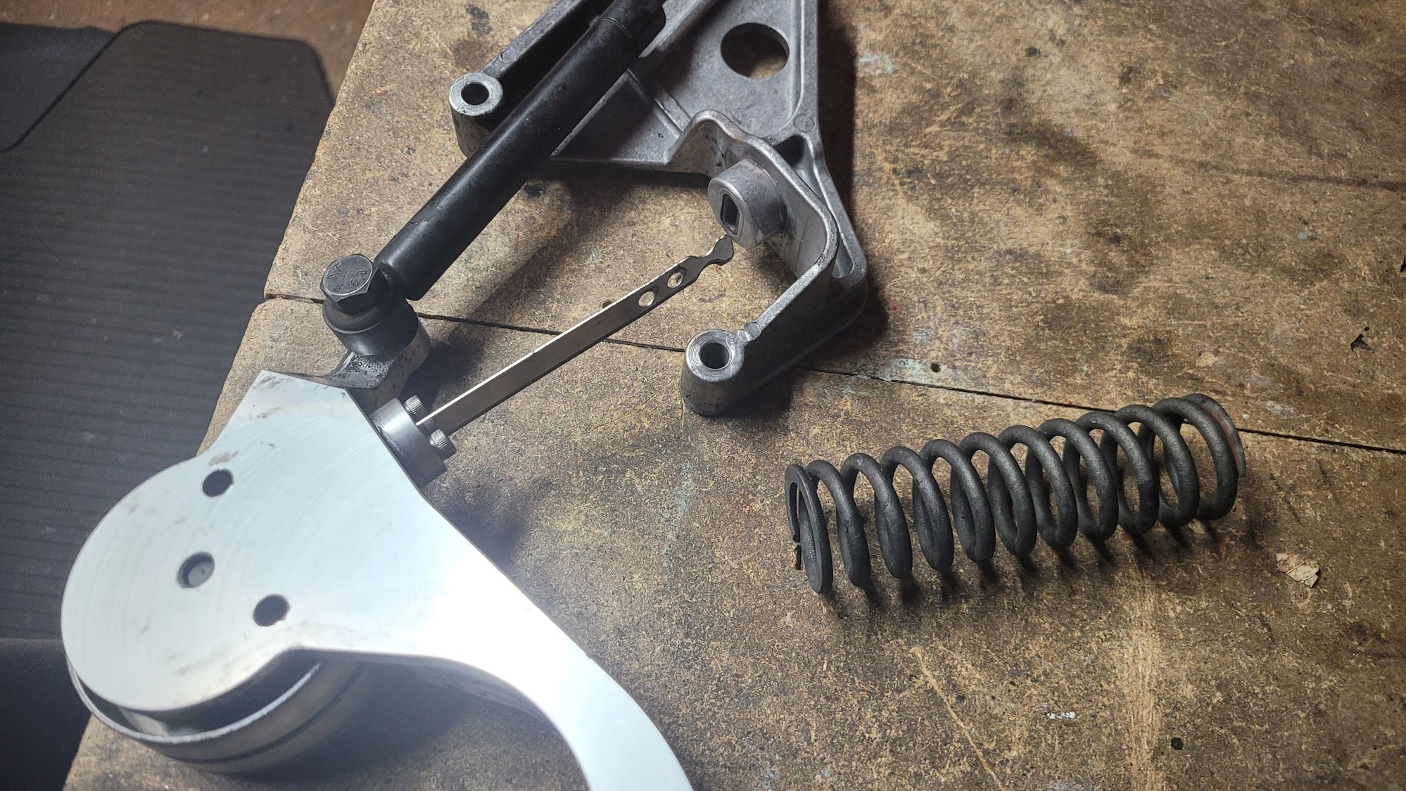

I can't imagine this is the correct belt , it's 10mm longer than the one I was given that I know worked and the only difference between other other car and mine is I have a 2% crank..
am I correct in thinking I was sent an incorrect length belt ???
I did get the tensioner back together though...
anybody know if this IS the rite belt for the tvs with 55mm pulley and a 2% crank ???
I started cleaning gaskets surfaces too on the tvs but again , was pulled away from my own car to help someone out... which is the last time too.
​​​​im.ive told this kid numerous times and he doesnt listen , then gets upset he has to pay to have jobs done 2x but i told him stop letting dope fiends work on your car and then what parts to use or not use and of course. Never listens, now he's blowing me off when I'd taken parts off my car and my personal fres time to help him and he's again , taking my kindness fir weakness... gowd people have just become so useless now a days.

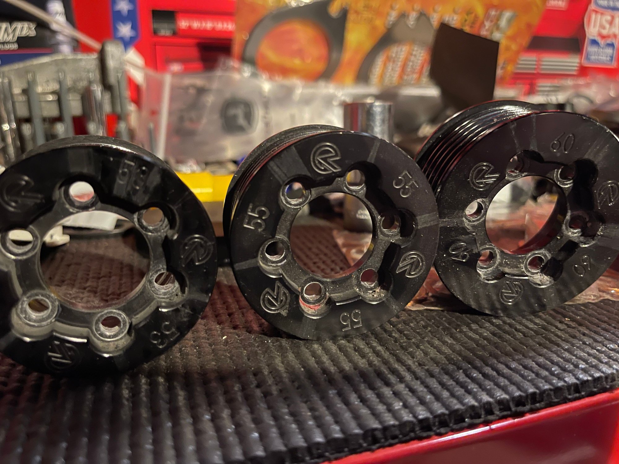

Here is 450usd worth of pulleys in this pic.
Old Nov 14, 2023 | 05:57 PM
  #715
The Devil Z's Avatar
The Devil Z
Joined: Nov 2021
Posts: 538
Likes: 126
Ooops looks like they came down in price so now 115 a pop. The Grip tech variants which are one offs where 150 though.

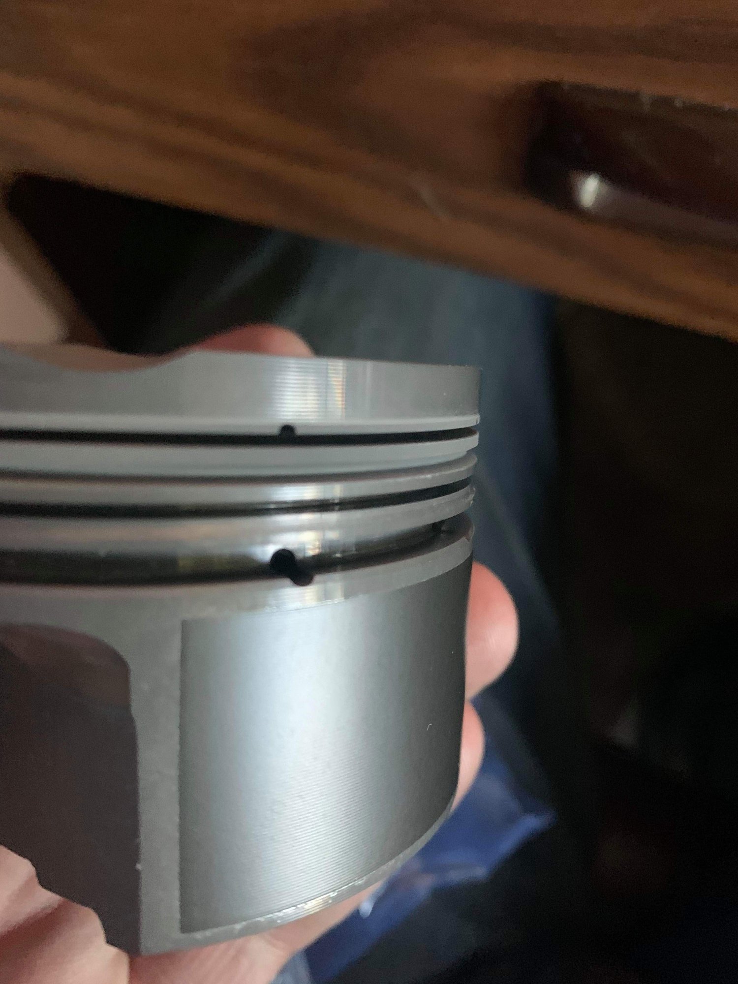

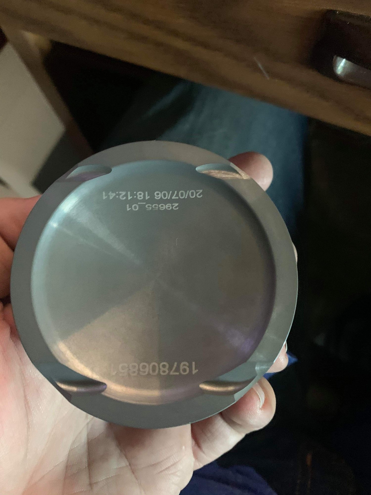

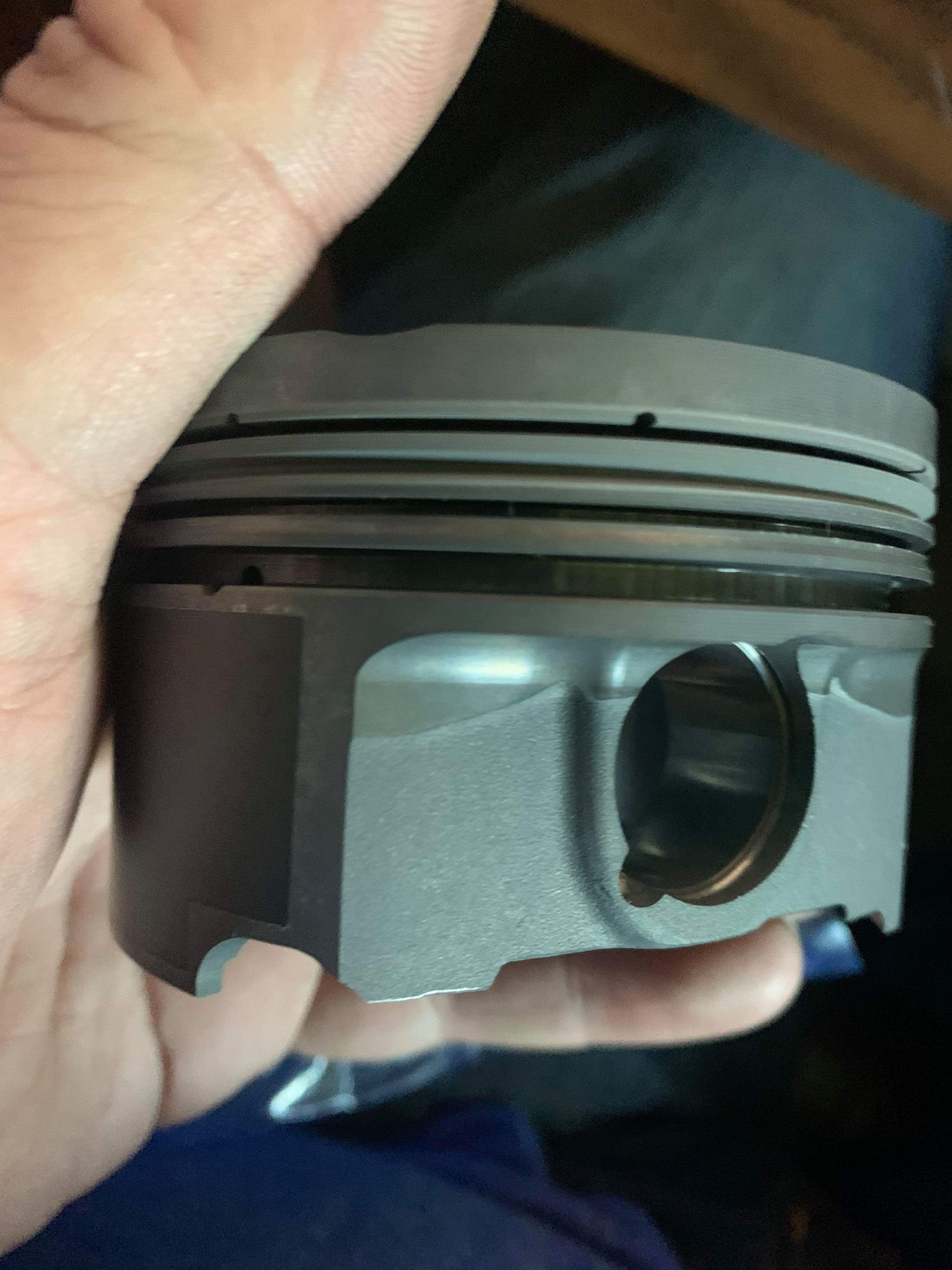

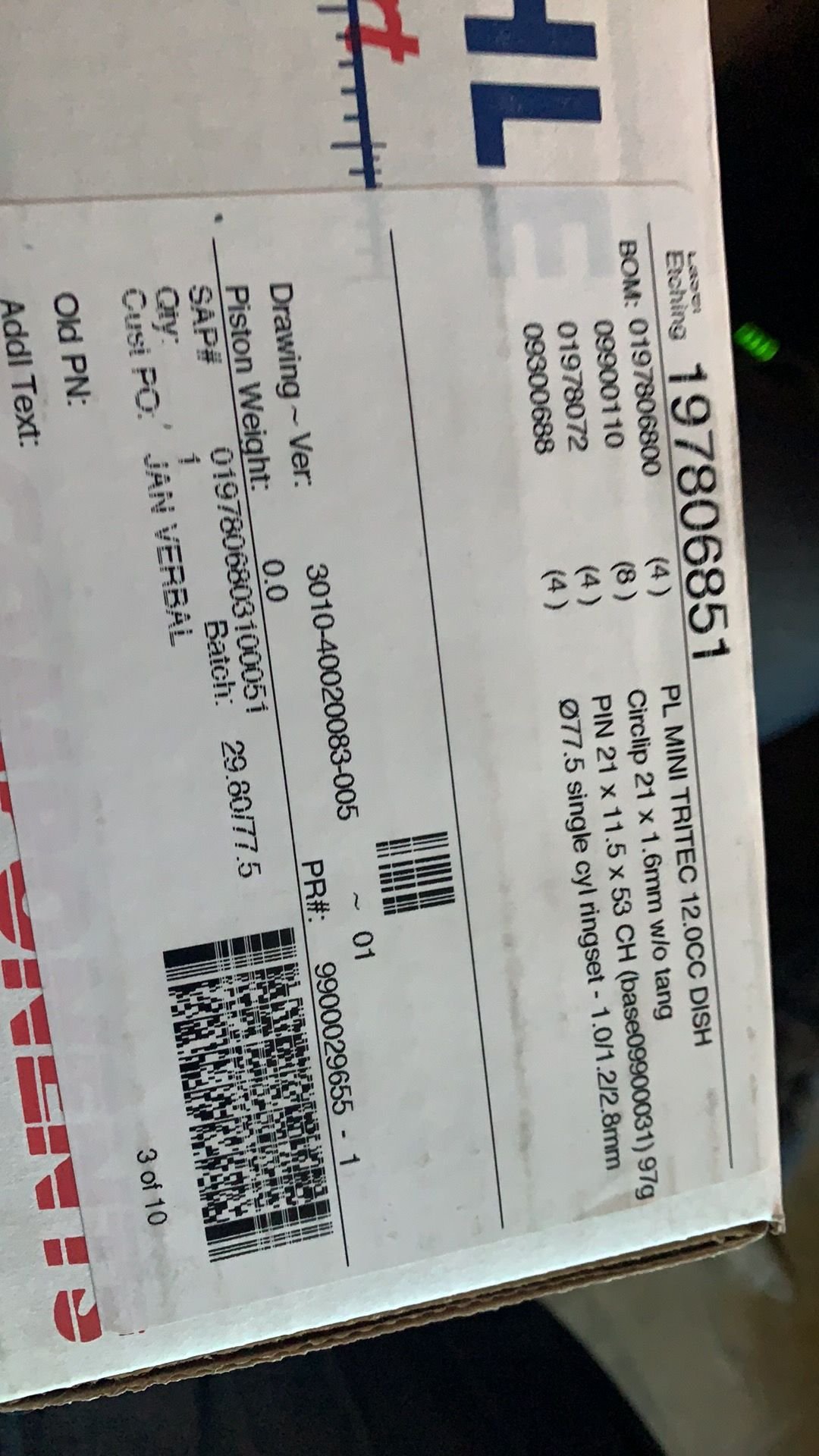

He doesn’t update his store much either so he might have them in stock. I’m sure he has to order them in batches as well and demand might not be there anymore. When I did my custom pistons mahle wanted me to order a total of 2 sets so 8 pistons and it was really reasonable pricing for one off design.
Here is some pics of the ones you want. You could run the part number past the mahle into department and see when the last time they shipped to Jan. These truly are the best piston for this car.
The ringland thickness, location the anodized goodness and top it all off gas porting make these these the bees knees. Leave the wiseco in the dirt bike lol. That being said these are the only pistons with thought and engineering the others are just branded versions of the stock piston. So not like these where somone sat down with re engineering for the better in mine. The custom dish cc and reliefs they are just amazing in hand.
