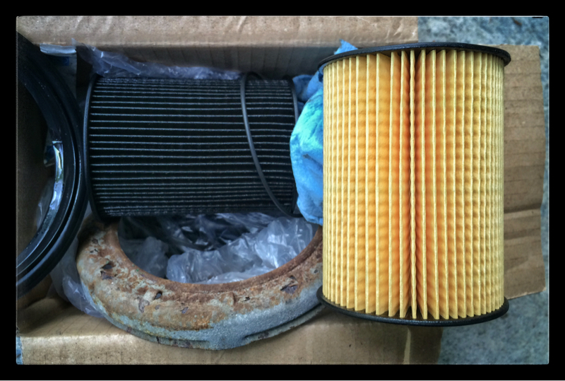

Did a fuel filter change on my '04 R53 MCS (114,000 miles). Consulted the various online tutorials before commencing, putting down plastic in case of spillage. After disconnecting the battery, I decided to remove the passenger seat to facilitate the task. Waiting 'til first thing in the morning (for pressure to fade from fuel line) was a good move as there was little to no pressure in the fuel line when removed from the canister, so there was no seepage or spray of fuel. Indexed the retaining ring with a marker before removal. After prying the canister out of its recess, I gripped the lower part of the canister with a pair of oil filter pliers before carefully (to avoid spillage) twisting off and lifting the lid, which didn't want to come off easily. From there on, it was routine, as I removed the dirty filter (certainly dirty, but not as bad as some I've seen online), used a turkey baster to remove the dirty fuel, wiped out the inside of the canister, replaced o-rings (lubed with Vaseline) & gasket, dropped in the new filter, then put it all back together. After the filter change, I figured I'd remove the driver's seat as well and give the whole carpet a good vacuum, and wipe down and clean the seat mechanisms. Reinstalled the front seats, reconnecting the plugs underneath, then reconnected the battery, turned the key a few times to reprime fuel system, which if you listen, can hear when the fuel filter canister is full. Turned the key, and she started right up. Can't say definitively, but the idle seems smoother. Replaced filter access cover and rear seat after checking connection for leaks, reset the ECU, and checked the fuel filter task off my R53 to-do list.
All in all it took about an hour and a half.
Attached Thumbnails What did you do to your mini today?-image-3563942211.jpg

Congrats, great DIY here, did you use that ?
https://www.northamericanmotoring.co...hange-mcs.html

Yes, the NAM DIY was followed pretty much to the "T" but where I modified it was to use the oil filter pliers to grip the lower canister, which made it so the entire filter assembly only had to be lifted enough (2" +/-) to get the jaws around it, instead of the 3-4" in order to put my hand around it, and secondly, it kept the assembly stationary and level, so at the moment the stubborn lid "popped free," there was zero spillage from jarring the lower canister, full of fuel.
Painless and easy, and with the seat removal step, it was also great to be able to properly clean the carpet under the seats in areas you could not get into with a vacuum.
This place is a great resource.
