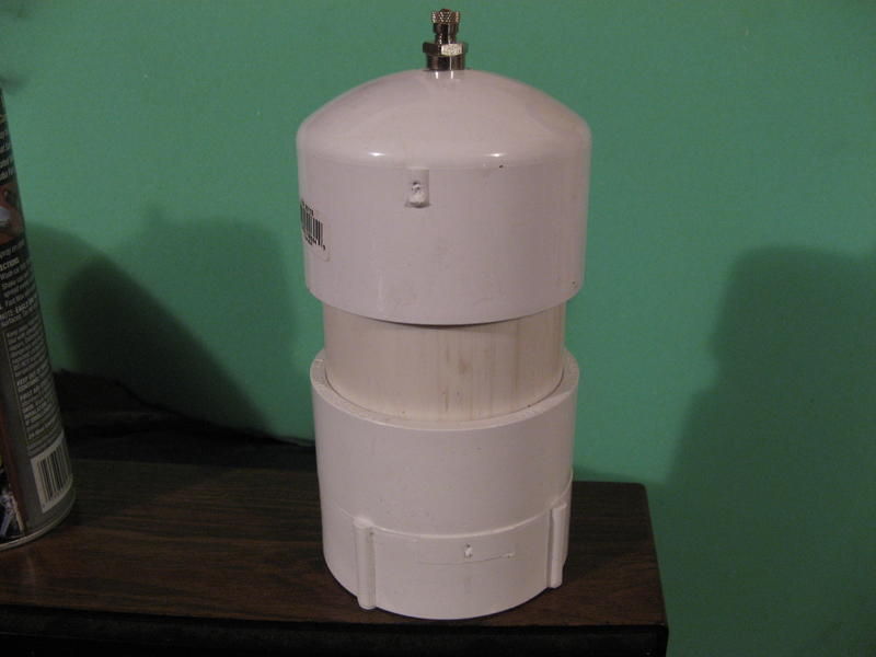

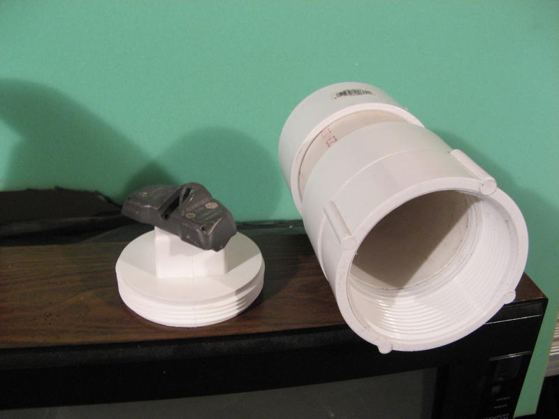

No More TPMS error Light
I installed a set of old 8 spoke wheels I got used and Pirelli Winter 210s in 205/50/17. Needless to say the old wheels don't use the TPMS sensors my car came with so I've been staring at the yellow tire preasue light for over a week. I got a piece of 3 inch PVC and some fittings from the True Value Hardware store and mafde a preasure chamber so I can put the sensores in and pump it up to 35 psi. I went with the 50 series tires for 2 reasons, a little more sidewall and it has got my speedometer error down to almost nothing. Maybe 2 mph at 80.
