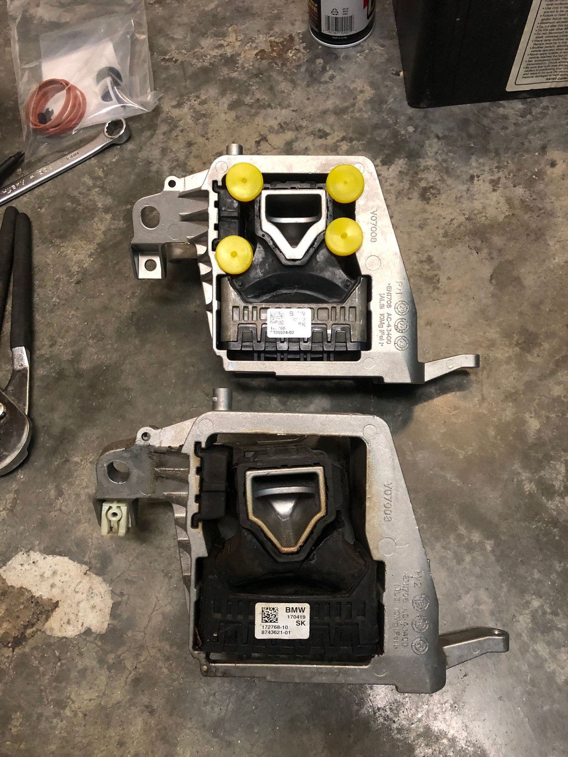

The fact that the car body-attaching piece and the engine-attaching piece are literally connected only by rubber blows my mind. It’s almost artful — while simultaneously and categorically subject to all the issues discussed in this thread.
And the bottom of that filled chamber — vacuum hoses have sturdier walls. What the heck, BMW. Just what the heck. Engine heat alone will weaken the living daylights out of that to the point of failure over time.
The Powerflex inserts will definitely reduce movement of the center/car-body-attached section — and with that, reduce pressure on that gel/fluid-filled bottom chamber. But I fully expect to either do a similar fill to your urethane or end up replacing the new mount at some point due to similar failure. The design problem is obvious from a materials standpoint (sadly).

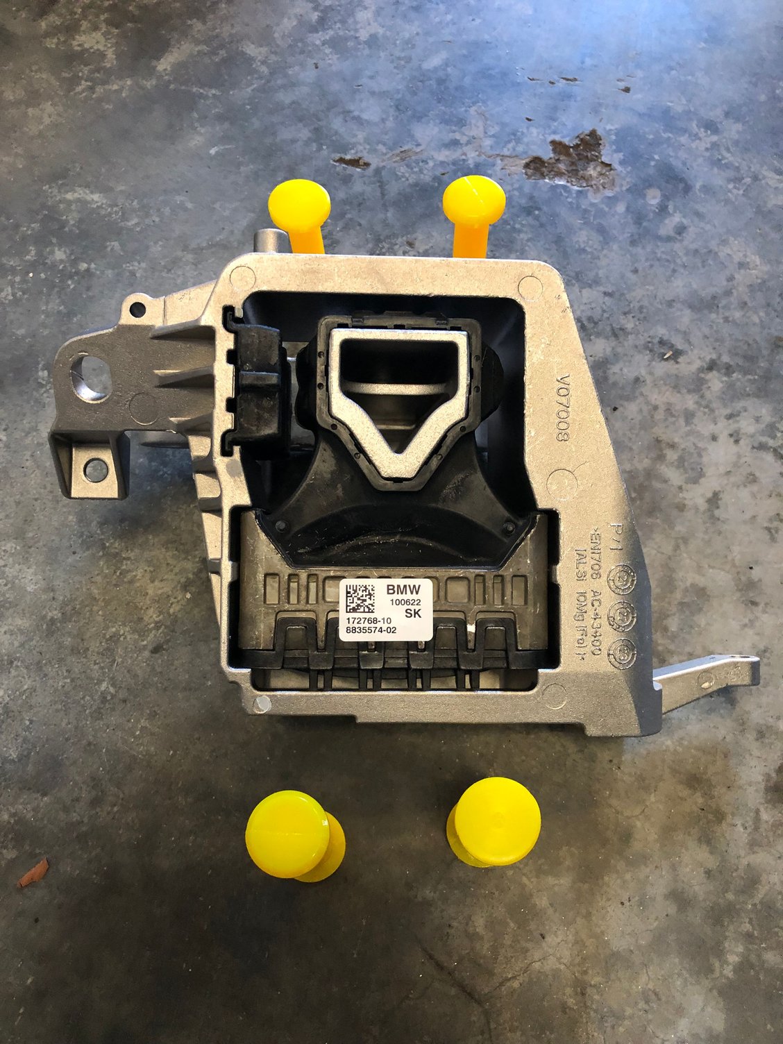

New mount, before bushing install.
New mount with bushings installed. Dishwashing liquid is your best friend for pressing these in and through.
Comparison of both mounts, outside the car.

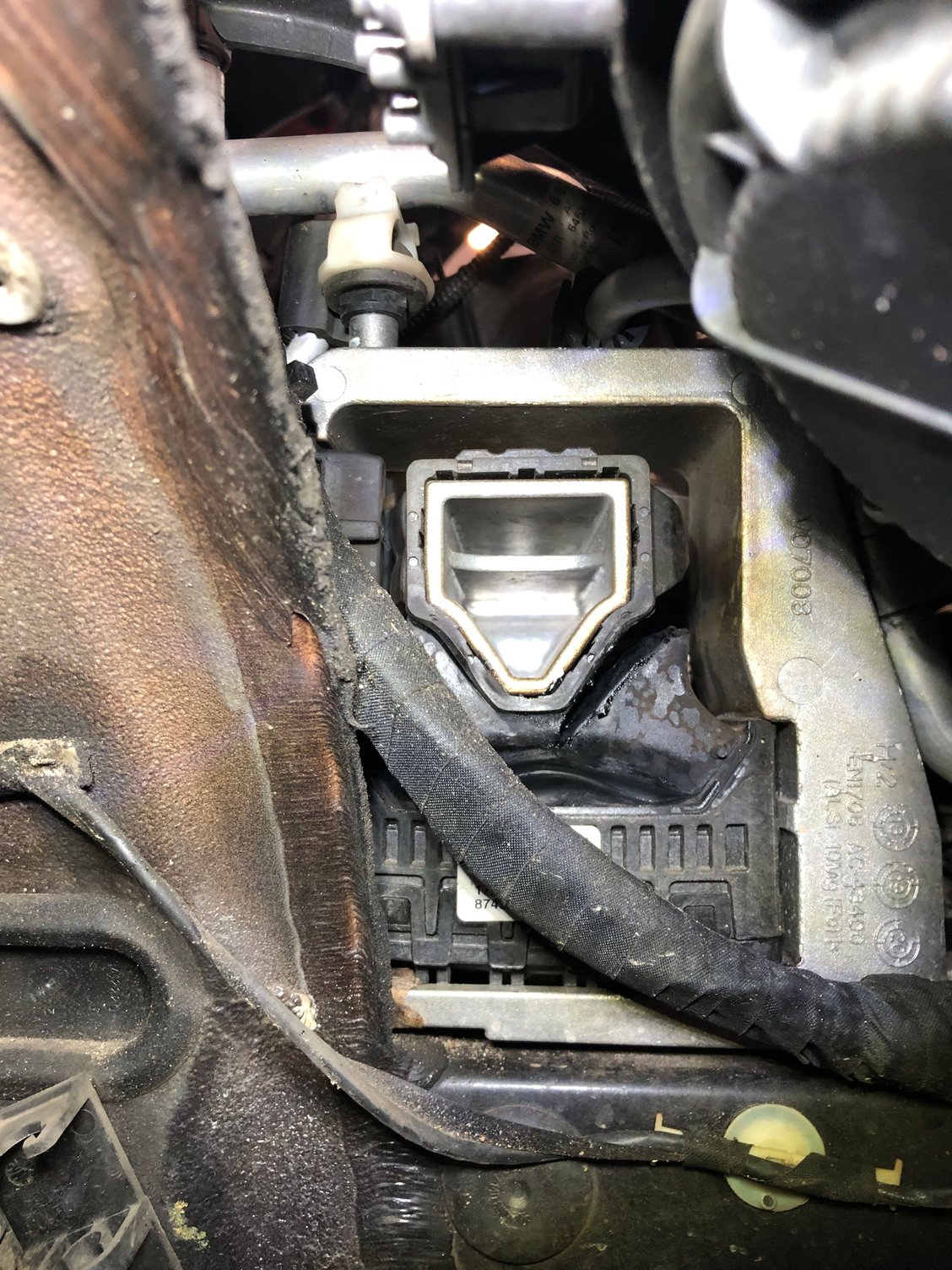

New mount installed, bearing the full load of the engine (floor jack support under engine removed).
New mount installed, closer look.

Originally Posted by boki
@cjv2 That was an awesome write up and DYI, thanks so much for this. I wish I could pay you to install mine in - the amount of detail and patience on your side is awesome to see. 👍👍
And by the way, do we know if the upgraded engine mount part #22118835574 still has the bottom rubber part filled with oil or is it solid hard rubber (circled in red)?
Thanks @boki , if you have any questions feel free to hit me up anytime. That area you have circled in the pic -- it didn't feel or look any different old vs new (well, obviously other than the new one not being sheared). I think it's solid rubber, or at least mostly-solid. It sure doesn't feel hollow, but given that the whole weight of the engine is on it there is probably more rubber (quantitywise) that has to keep it semisolid anyway.
Very different from the rubber you see a hint of on the underside. The underside that you see -- that's a ridiculously thin rubber which is clearly a diaphragm, and mine had ruptured. I'm not sure how that fluid-filled area is connected to the other more solid rubber sections. Too bad I tossed my old one, I probably could have dissected it to try to understand that part better.
