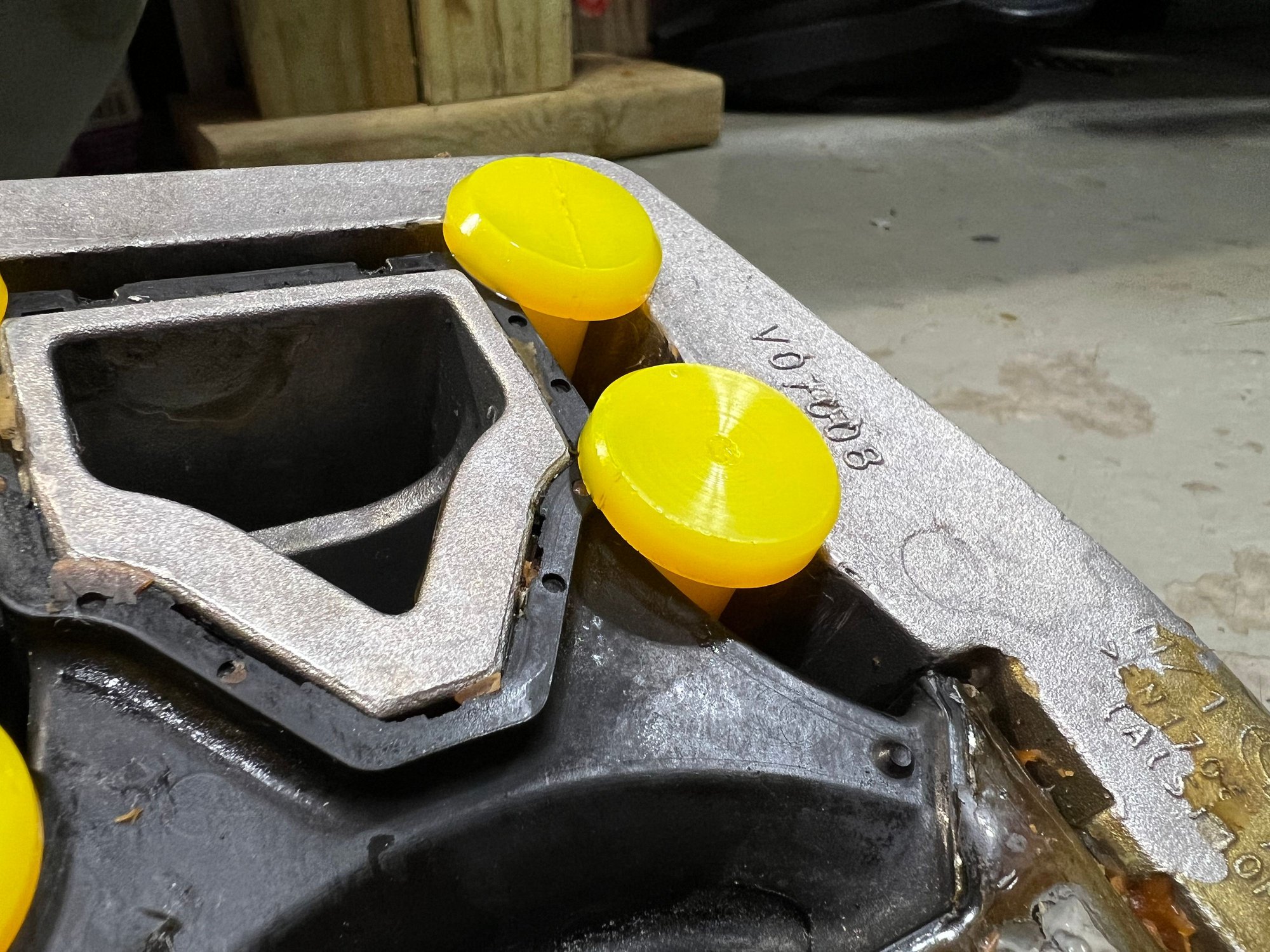

Install them before putting the mounts in the vehicle and you can handle most of the physics. Other than that...
For the upper engine mount, dish soap works very well as a lubricant. And the center component moves, so you're not trying to get them into fixed-clearance locations. There is more room to work in the upper pair than in the lower, so I would put the lower ones in first. You'll get the idea. Silicone spray or grease might also work as a lubricant. I used Dawn dishwashing liquid, which was fine, but over time the blue color discolored the bushings, go figure. Just use something that doesn't degrade polyurethane.
I don't have any hands-on with the lower mount or transmission mount, but I would imagine that similar tactical would apply.

@Andy from Hull thanks for the thanks -- glad it helped! And very cool that your 2017 F56S is just a month older than mine -- we've effectively got the same car!
My current take: definitely go with the GP3 mount (22118835574) and definitely go with the Powerflex bushings. Do *both*. The only change I would make is to a minor bit of my installation process (I'll get to that).
Since installing the GP3 mount and the Powerflex bushings about 2 years ago, I have watched discussion after discussion about the upper engine mount situation on multiple F-series MINI forums. There appears to be a solid consensus (amongst those paying attention, at least) that the Powerflex bushings benefit the longevity of the mount, and that this matters in turn because the GP3 mount -- whatever its benefits from being "upgraded" - is far from bulletproof. So an investment in the GP3 upgrade from standard when the cost differential is low remains sensible, and an investment in preserving that upgraded mount also remains sensible.
On my car, I do check the mount from time to time and I have yet to find obvious signs of degradation (not that there would be any until it had hit solid failure, I imagine, but still). The mount is in a tough to scrutinize location so the visual may not mean much outside of inspection using a borescope or similar (which I haven't done, but maybe I will). I remain happy with the install work I did and the parts I chose. I remain aware -- but only when I'm paying attention -- that the bushings do sometimes transfer engine vibration into the body at dead idle (like at a stoplight) but it is generally not noticeable enough. More like -- once in a while I catch it and go "oh yeah, I remember that, I know what that's coming from." It's the sort of thing that someone really attuned to their car will note, and probably nobody else will.
The one change I would make is to my install process, and it's minor. When I did the install, to aid in getting the Powerflex bushings into the mount (which you should absolutely do before putting the mount in the car, btw), I greased them up with Dawn dishwashing liquid. Slippery stuff and definitely kept the silicone of the Powerflex from getting caught up in the tackiness of the rubber used in the mount. However, that Dawn dishwashing liquid's blue color ultimately got cooked into a brown/black that discolored the Powerflex bushings. No functional concern -- it's 100% aesthetic, and more of a "hey I didn't mean to do that" than anything else. Were I to do the install today, I would use silicone spray instead, and if that wasn't good enough to do the trick, I would use a clear liquid soap of whatever kind.
Hope this is useful! And thanks again!
