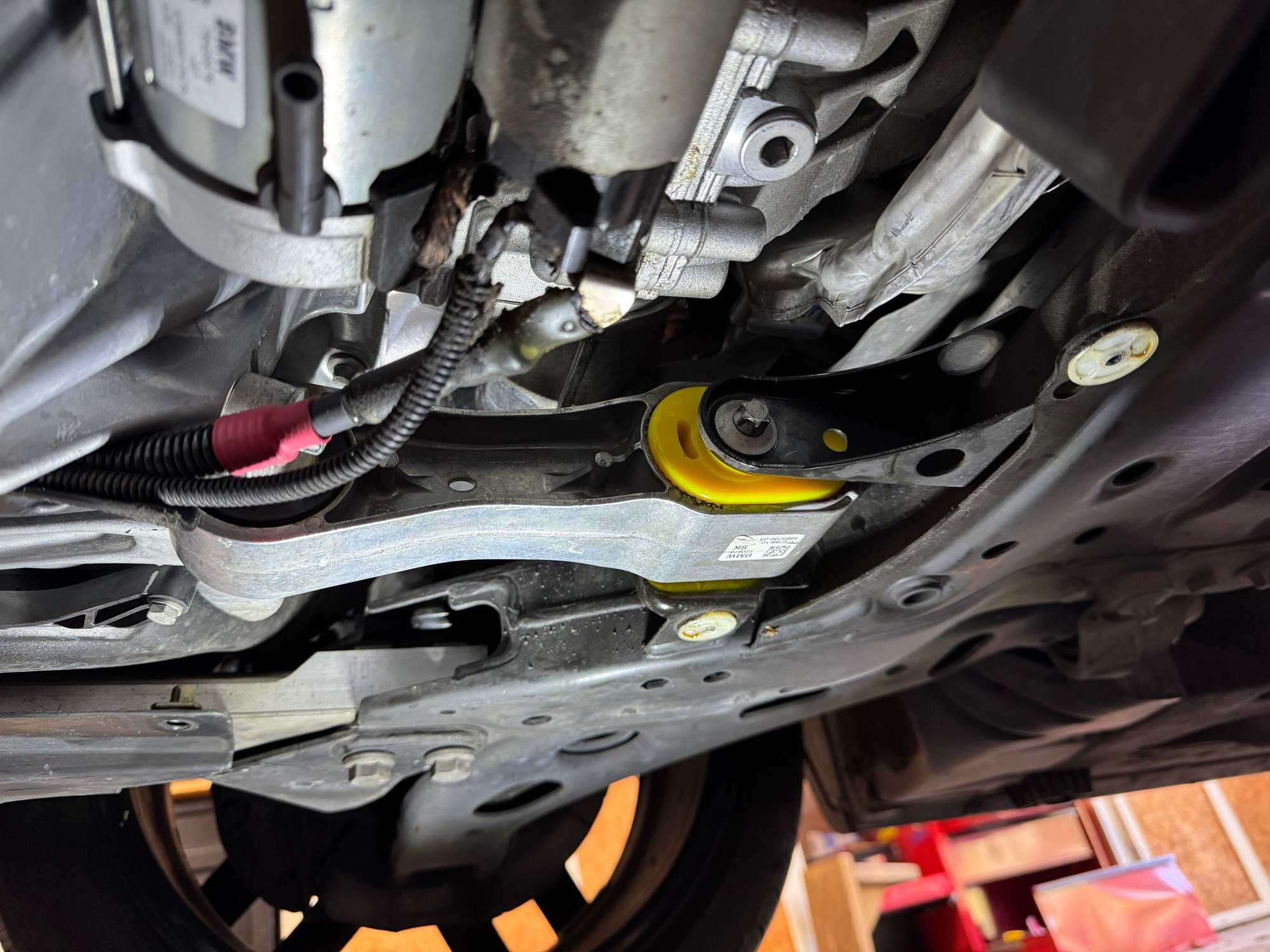

It is interesting that the guy notes the same thing you did. The twist-move-stand-on-your-head etc to get the engine mount out worked on a prior job, but not on the MINI featured in the video. So, he does give an idea of loosening the headlight but not removing it that worked.
On a side note - I am a huge fan of the PowerFlex bushing for the lower engine mount. It has been in a while now and can find no downside to it. The improvement to drive ability is well worth and there may well be a benefit of improving the life of the upper engine mount.
Glad you posted this. Good video. And it illustrates *exactly* what I ran into (no pun intended) with the headlight being in the way. That one contact point is what I couldn't sort, so I yanked the headlight.
His workaround to get some wiggle room by removing 2 of the headlight mount anchor points is pretty smart -- that hadn't occurred to me.
Also glad you posted because you reminded me to get on "Powerflexing" my lower engine mount bushing. Can't explain it exactly but something about a changing feel of the car is telling me I need to get on that -- and I don't want my upper mount, having itself been replaced and with Powerflex inserts installed at the time, to weather any more stress than it has to.

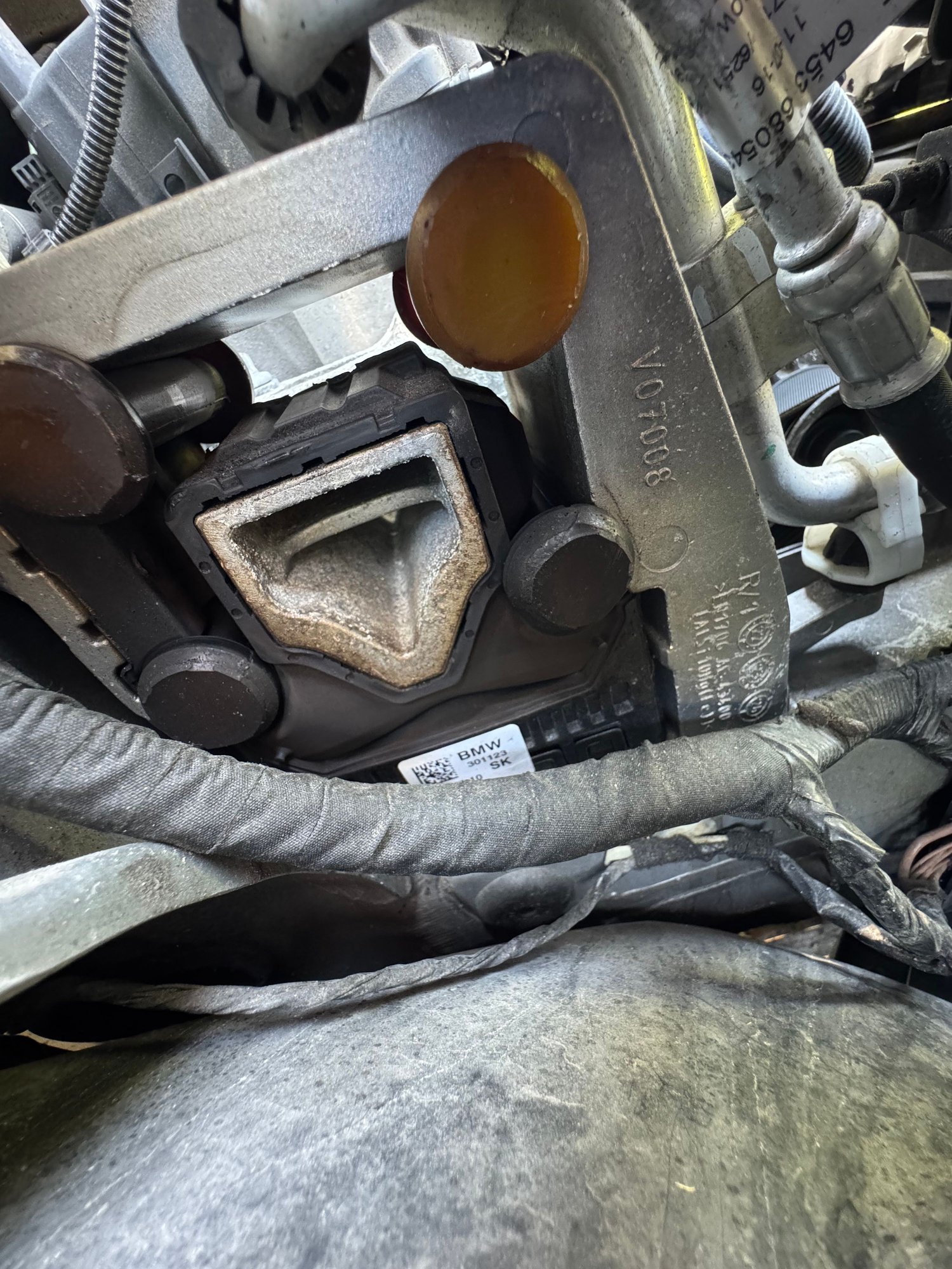

Well mine just failed after 2 years and 14k miles: 22-11-8-835-572. Looks like the new one for an F54 is 22-11-8-835-574?

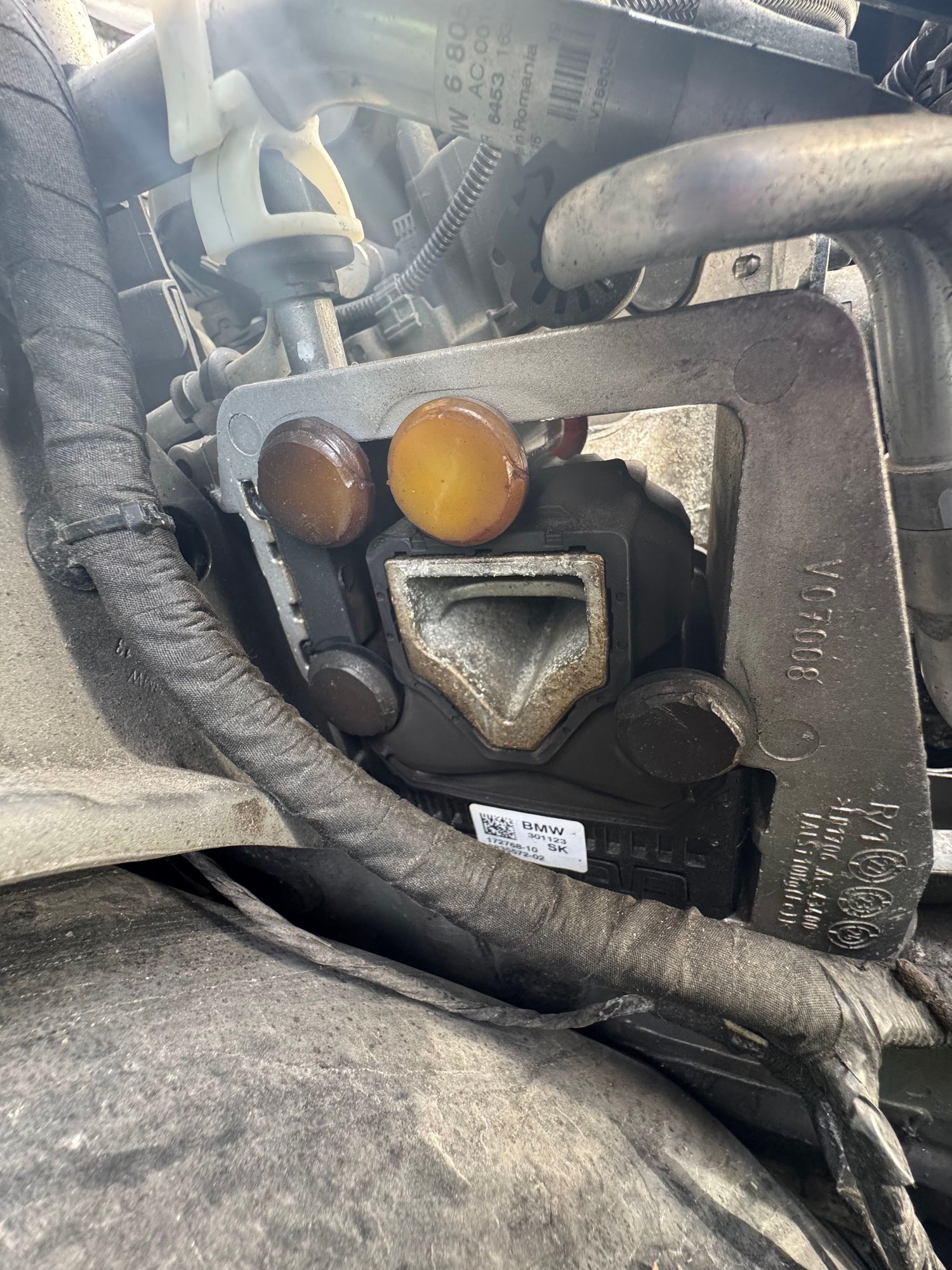

Here are pics, is this failed or just under load. Doesn't look like the upper PowerFlex bushings are doing anything at all.
https://www.northamericanmotoring.co...ars-later.html

Thanks for the updated, i have shared this with our engineers, we hope to have a fix soon that is a one and done.
Just check, were you replying to my photos/post? If so I'll hang tight and not order another mount.
Mine is borked, right? It shouldn't be that low?

Towards the beginning of this thread (and elsewhere) you’ll see pictures of broken vs not. Yours looks to be broken….
I would highly suggest that when this is being replaced that you also modify the lower engine mount with the PowerFlex bushing to cut down on the rotation of the engine when it is under load. Here is my post (link) about doing that. All is still fine and as I note in following posts to this linked one, there is no downside to this mod.

Thanks, yeah I'm thinking it's borked and I'll have to do the job again. Super annoying. I hoped that the PowerFlex on the upper mount would have helped...but I guess not. Lower dog bone engine mount bushing has been ordered from ECS, so I hope to do that this weekend. Then depending on what @ECSTuning comes back with I'll order the latest GP3 version of the engine mount. Maybe do the poly eurothane thing to fill all the gaps.

If you are going to do the lower engine mount and you don’t have a 2 jaw gear puller (or a hydraulic press), get one. That will greatly improve your ability to get the OEM bushing out. I posted previously (a page before this one, maybe) about finding a post about doing it with a 2 jaw gear puller.
Hopefully your new upper engine mount with the PowerFlex bushings in the lower mount will will survive.
