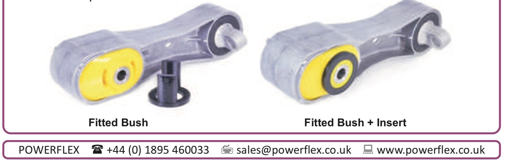

@cjv2 thanks so much for the fast and very detailed response.
I am about to order but undecided on the Powerflex bushings.
Anything that introduces vibration of any sort will definitely be noticed and upsetting to me
I may settle on the GP3 mount ONLY which I believe is a slightly harder durometer.
Horrible to say but I will be selling the car within the next couple of years. I'd rather not sacrifice driving pleasure for a lifespan increase!
Where did you buy your parts from, if you don't mind sharing?
Also, I have loosened all headlight bolts after soaking with some WD-40. I will buy replacement bolts only.
Would you agree I only need to remove headlight, no RF wheel off, no raising of vehicle other than to support engine/sump?
Thank you.

A thought -- if you are using the auto stop/start, you aren't going to notice much in the way of vibration, because at many stops the engine is, well, stopped. That said, totally your call. In my case to be clear the vibration has not been "why is the car shaking?" so much as "something feels different -- oh yeah I changed the thing" and by the time the thought is complete the light has gone from red to green and off I go.
I have NOT noticed any additional vibration when in motion -- if there is any (physics says there must be), it's imperceptible when moving.
The GP3 mount purchase: I got smart and bought it locally, at a BMW dealership. Got it for just over $150 (and it is apparently still selling for about the same price). No shipping fees because I drove over there and picked it up.
The Powerflex mount original purchase: I bought the kit (PFF5-1321) at ECS Tuning.
General purchase thoughts:
  • As I look around today, minipartsdirect.com is selling it for about $145, but will certainly add shipping/handling. Similar at Seattle MINI, selling for about $147 but shipping/handling will be added.
  • If I were you I would buy both the mount and (if you choose to install them) the Powerflex bushings at an online shop that offers lifetime replacement warranty on both -- meaning if it goes kaput, you can order a new one, return the old, and they will issue store credit at original purchase price for the old. If you are not installing the Powerflex bushings this approach makes even more sense. Both ECS Tuning and FCP Euro do this, and both sell the mount. FCP Euro does not sell the Powerflex bushing kit. Pricing on the mount is a smidge lower at ECS Tuning.
  • At the time I made my purchases, ECS did not have the lifetime replacement warranty program; if they had had it, I probably would have bought the mount from them on the same order as the Powerflex kit.
Installation thoughts and info:
  • I believe there is a post in the forum about doing the upper engine mount replacement without removing the RF wheel. Though I appreciate it I would not take that approach. Clearances are very tight in that area and when I do things to my car -- any car -- I want as full access as I can get, as well as full visibility. At absolute minimum, not removing the RF wheel and fender liner leaves you with a visual blind spot in the one place where you otherwise have the BEST view. Just my take. I have popped the RF wheel and fender liner off and on so many times at this point I think of it like tire rotation (which I also do myself) -- a little annoying but has very specific benefits that make it worth doing.
  • The factory headlight bolts are installed with Red Loctite. I believe I read that the WD-40 approach will cut through it enough; if I am recalling that properly, you're on a good track. I did not use WD-40 or anything else but I had vise-grips on those square nuts so I didn't wreck them, Regardless, I had purchased replacement bolts and replacement headlamp alignment units as part of the plan, and I used them. Replacing fasteners on a BMW is a best practice "thing" due to limits on the longevity of the originals (whether the result of re-use or not). I have no regrets about taking the approach I did. Speaking of which, if you haven't made plans to replace the bolts that hold the engine mount itself in place, plan to replace them. They are torque-to-yield bolts, aka "stretch bolts" -- meaning you don't just torque them to a spec, you then turn them an additional amount further (specified by BMW), stretching and distorting the metal of the bolts to obtain a specific kind/level of friction. The bolts are not cheap. Do it anyway; they hold your entire engine to the car.
  • There are always shortcuts and better ways. I have learned the hard way with MINIs that shortcuts are generally not great. But if you land a shortcut that is, in fact, a *better* way (vs simply being *faster* or *easier*), all good stuff. Just bear in mind that BMWs have a way of letting you know -- later -- that you should have "done it the other way" and when that happens it is REALLY annoying

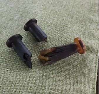

As a follow up to all of the above, here are some of my thoughts:
- FR wheel and liner MUST come off, I couldn’t get the rear of the liner disconnected so flexed front and pulled it out of the way. Buy 4x replacement clips for where this reattaches to lower plastic deflector, nightmare to get old ones back in and yet to figure out how they’re supposed to function.
- Even after soaking in WD40 and loosening headlight screws, they were difficult as they lock up when the Loctite engages. Bottom one was a nightmare to get out, 2-1/2 hours. Had to undo washer bottle and force it out of way and struggle getting small vise grips on back side of square nut housing. Fortunately I have metric taps and dies. Instead of using the new screws when replacing light, I ran die nut down the old ones, tapped the old clips, and used my own red Loctite. This will allow the next person to remove them as it is not the same Permanent Thread Lock that was used by Mini.
- The headlight clips are a work of art, including a center bushing with left hand thread, which allows for headlight alignment. As I don’t have a PhD I never figured out how these were intended to work. I modified mine so as they are all now bottomed out (not Mini’s intention) but alignment appears good.
- DO remove underside engine cover as you need jacking access. I placed my jack directly under the sump (with wooden packer) but this was too far forward. Engine tilted backwards when I removed the mount so I then needed an additional jack further back.
- DO tap all required holes in new mount, but only 3 full threads or so. I used the GP3 mount. All standard metric threads are what is required, M6 as I recall.
- Engine mount is one heck of a struggle to get out, goes out from the side.
- DO buy the 2x clips with the plastic retainers, I guarantee you’ll not be able to re use the old ones, they disintegrate.
- Re-assembly was surprisingly easy (except 4x lower plastic trim rivets/clips). As previously stated, only the 3x bolts that go in the engine mount directly from the top need the extra 90 degree torque.
- DO NOT attempt this job if you do not have a very good selection of 3/8 drive tools, including a selection of extensions, and good technical knowledge. It is at an absolute minimum 5+ hours. The girl who does it on YouTube in 2 hours is an absolute megastar, my hat is off to her! Maybe it’s a full on track car with no lights, no A/C, no underskirts etc. If so 2 hours is possible.
- Good luck.
This is because the 4x lower plastic trim rivets/clips are not supposed to come out. The "lower plastic deflector" and the wheel liner are a single part as sold by BMW. Google up part number 51717319760 for visuals. To remove the entire part you have to remove ALL of the 8mm hex bolts anchoring the "feet" (aka "lower plastic deflectors" or whatever term one might choose). And even then, getting the whole thing out is a bit of art thrown in with the science. It's not intuitive.
I pulled those 4x plastic rivets the first time I removed the RF liner. Thankfully I did it in a way that let me put things back together -- after realizing that they weren't supposed to come out in the first place. FYI for folks who have run up against this and wondered. It isn't your imagination or lack of understanding that makes it seem like the rivets aren't supposed to come out in any sensible way. You can get them to, but that isn't the design intent.
Old Jan 24, 2025 | 03:59 AM
  #237
Andy from Hull's Avatar
Andy from Hull
Joined: May 2023
Posts: 11
From: Tustin, CA, USA
That’s very informative, thanks for posting. I did remove the clips without destroying them and enlisted the help of my wife to get them back in. I obviously needed access to the back side in order to pull them through both parts, with a small pair of needle nose pliers. Makes a lot of sense what you are saying.

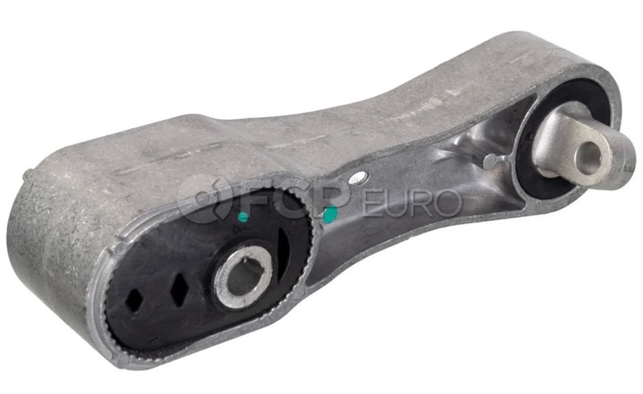

I installed the powerflex inserts to my upper engine mount. About 15k miles later I was looking at something in the area of the engine mount and noticed only one of the inserts was still in place. I had just been driving so the engine was hot, and when I touched the only insert it was soft and gummy. I looked closer and found out the mount was torn. I found pieces of the other inserts had fallen lower in the engine bay.
When I replaced the mount I filled the voids with polyurethane. I found a website called suspension.com that sells kits specifically for that. The kits have enough to the upper mount with a little left over, and they have different durometers to choose from. I used a medium durometer and it added quite a bit of vibration, so I would recommend the softer kit. I took a bunch of pictures when I was filling mine, so I could post a how-to if anyone thinks it would be useful.

I have a theory as to what is contributing to this upper engine mount failing. It is related to this part (thank you FPC Euro for the picture):
The “dog bone”  - the engine stabilizer link
This part controls the rotation of the engine under hard acceleration. Any rotation engine allowed by this part is going to go into twisting the rubber of the upper engine mount and this cannot be good. That mount already has to deal with multiple directions of movement (up/down, left/right, back/forth, etc). However, those movements are likely much smaller than the twisting motion of the engine under hard acceleration.
I was able to take under the hood video of the engine movement while driving, accelerating and stopping. You will notice that there is a noticeable amount of rotation of the engine when accelerating. A bit of a warning… I did no editing on this so it is a bit long and parts, like the beginning, look like nothing is going on. But in doing so it shows everything that happens when the car is being driven. This drive includes corners, stop signs, stop lights, hard 3rd gear accelerations, hard braking. You will notice that the engine hardly moves except for the hard acceleration.
Clearly the biggest movement of the engine under normal driving conditions that has to be accommodated by the upper engine mount is rotation. From this it seems that the failure of this mount has less to do with being a poor design than it has to do with the allowed amount of engine rotation and this is controlled by that dog bone.
A disclaimer: I have not yet checked whether that link on my car has failed or not. However, even if it has not failed I am going to buy a replacement and install the stiffer PowerFlex bushing in it.
PowerFlex bushing installed in the dog bone
That is my theory. Think about it. Replacing the bushing in the dog bone can’t hurt. But if it helps ….

On a side note - I am a huge fan of the PowerFlex bushing for the lower engine mount. It has been in a while now and can find no downside to it. The improvement to drive ability is well worth and there may well be a benefit of improving the life of the upper engine mount.
