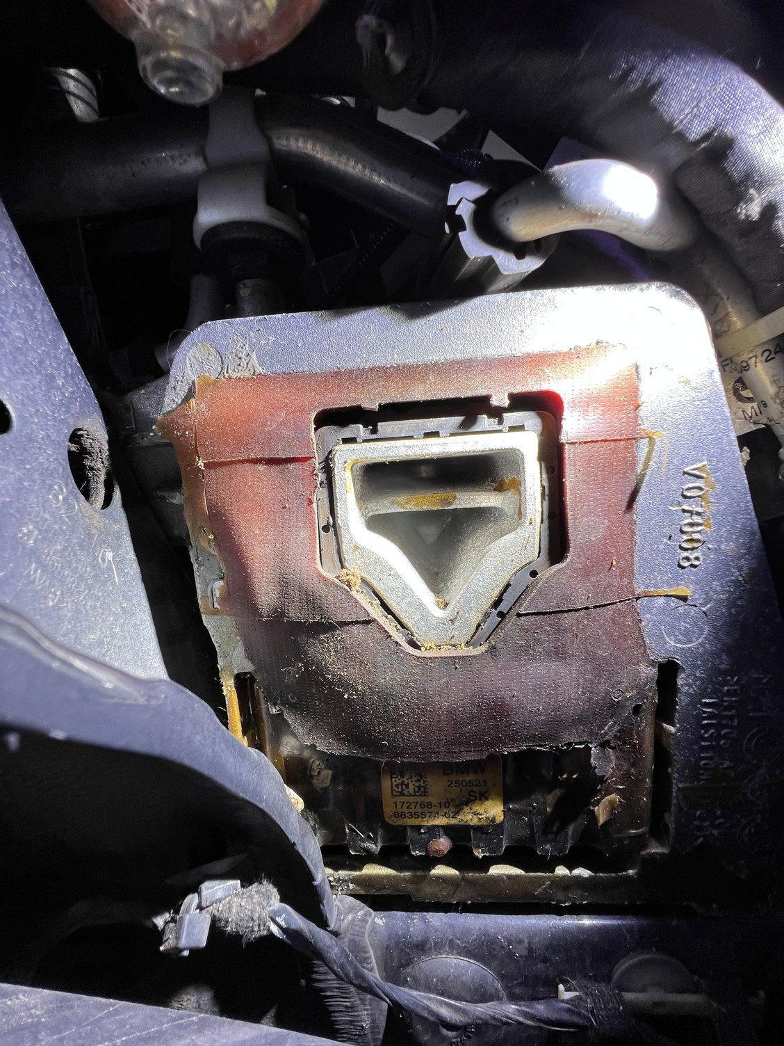

Both upper and lower motor mounts were leaking and needed replacement on my 15 F56S.. That was $$$ and not a DIY job.

I’m approaching 1 year with the lower chamber filled with 70-durometer 2-part urethane and the entire upper filled with Smooth-On ReoFlex 30.
I haven’t inspected it closely in a while, but I have no complaints. No vibrations.
I have to swap front control arms soon (ball joint going out). I’ll try to look closer then.
this was before I installed it.
One year of heavy use.

My '21 S has 19k miles on it, I took it to the dealer yesterday for some other things and they found the mount was leaking. Luckily it was replaced under warranty but wow this is crazy to hear how common these fail! At less than 20k I guess I should buy in bulk and learn how to replace these on my own for the future. Dang.

Interesting the top motor mount was redesigned (for the second time) in October 2020 time frame. Interesting it still fails. Anyone else have a 21/22/23 with a top motor mount issue?
