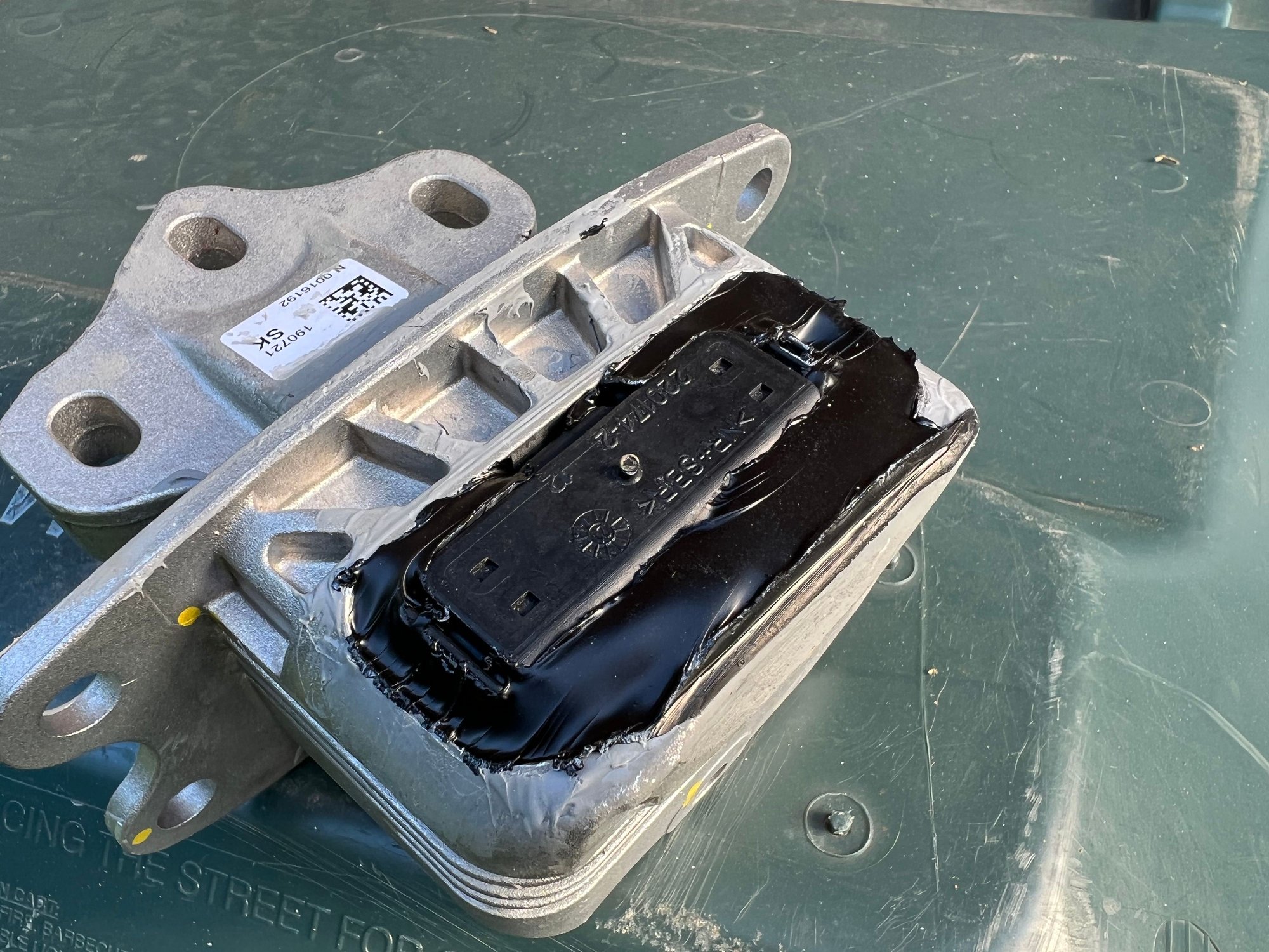

Update on my mount testing. I’m currently running a new Transmission mount, filled with 3M Windo-Weld (55a-60a durometer) and a new engine also mount filled with 3M Windo-Weld, plus a custom CNC aluminum bumper/spacer to replace the original rubber bumper in the engine mount.
The vibration is a bit too much for me (especially pulling away from a stop in 1st or 2nd gear w/manual transmission).
This setup did solve a major complaint about my 17’ Clubman S ALL4 though. On certain freeway expansion joints I drive over routinely the car always had a weird floppy / cowl shake / reverberation that’s drove me nuts for years. I even went aftermarket springs/dampers (Bilstein B8) thinking it would solve it. It never did. Nor did adding the 2020 Clubman JCW underbody or strut tower braces 😬😬
So apparently the floppy, reverberation feeling was the engine/trans bouncing around. Agh! Anyway, that’s totally gone now. Cars feels better over bumps than it ever has.
Next attempt will be to remove the factory bumper in an engine mount and fill the entire thing with softer 30a durometer 2-part urethane. Hoping the softer urethane will decrease vibration, but keep the engine/trans from bouncing around. Gonna leave the filled trans mount for now.

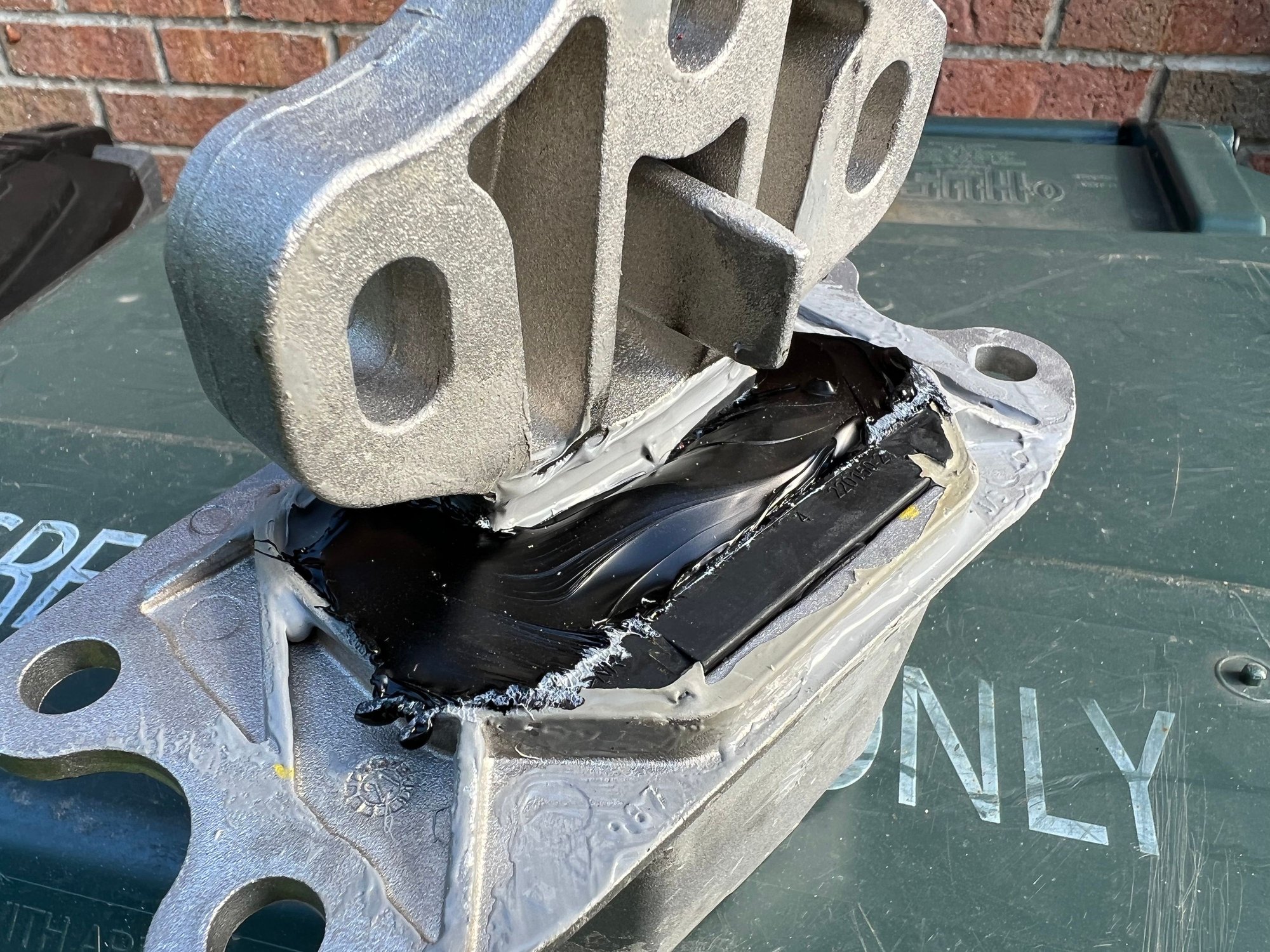

Here’s a new trans mount filled with 3M Windo-Weld. Doesn’t feel too horrible stiff by hand. You can still move/flex the inner portion by hand.
But was my engine/trans flop just due to the trans mount - I’m not sure… The original wasn’t really in bad shape. It’s a very basic rubber mount with no tears. I bought the car when it was 3 years old with 30,000 miles and it “engine-flopped” even then. 🤷🏼‍♂️

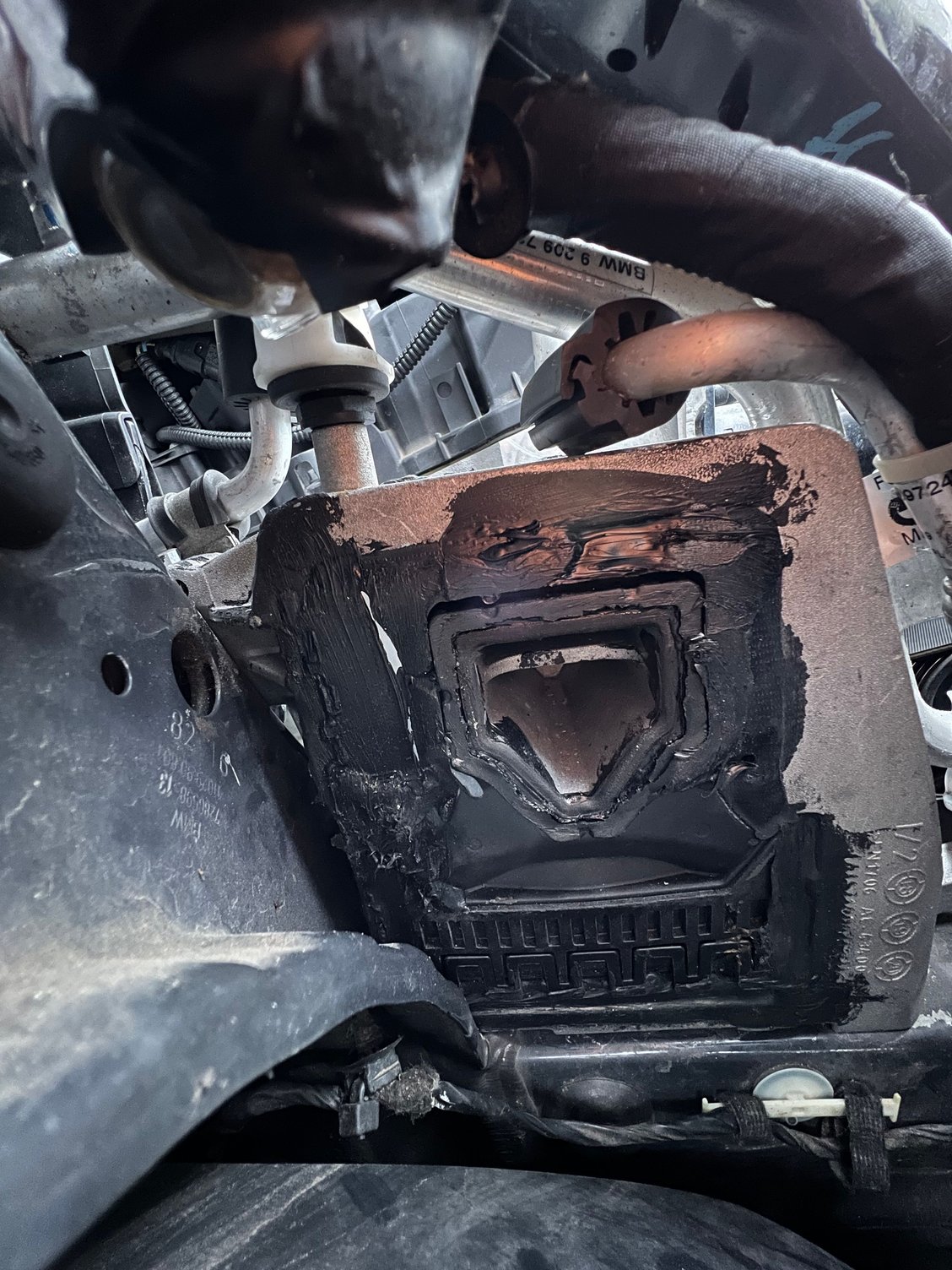

Not a great photo of my current engine mount.
