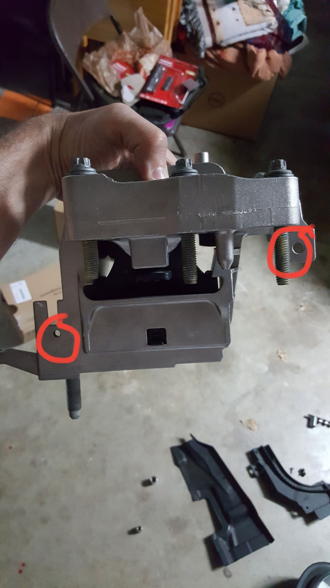

How did you get these screws out. I dont have enough room to get them out. I know they're both 8mm but the angle and amount of space is to tight.
Here's the location on the new part:
I use this tool:
https://www.northerntool.com/shop/to...2503_200612503
It was originally bought so to help me remove the water pump bolts on the R56 (2nd gen) MCS. Luckily it comes with both 8mm and 10 mm, and it comes in really handy in very tight spots. Kinda expensive though. Will you sell me your old mount? Even if it's torn, I want to buy it, too. I'm going to use it to do some research on how much reinforcement rubber to add and report the result back to the forum for everyone's benefit. Just need an old mount to work with.

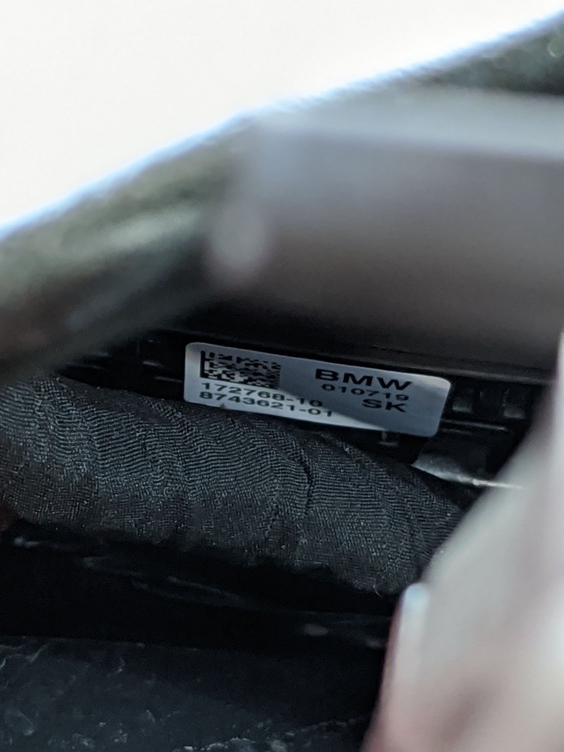

Hi,
I took a flashlight and checked passenger side engine mount and it looks to me as if it cracked Here the image.
On the right side edge of the rubber

Can you get a picture from the headlight side? It's much easier to see if it's bad from that angle
I think I had a hard time taking a picture as there is practically no room even for a flashlight. I can try taking a shot of that side.
The second image shows 2 cracks(?), have you seen it?

Here is the image I could somehow take from the other side of this engine mount:
I had those lines and they appeared to end up just being creases, not tears. Like where it would be flexing and keeping that area clean. I'd be interested to get your take on what they are.
Possible that 2 long lines are creases, but what about the one across? Seems like a scratch of some sort. I also provided other side images earlier. Have you seen it?

Imperial, I don't think your engine mount failed. Just an opinion. Here are pictures of my old one I took off.
Item's #1 Those are creases, and on mine they are about the thickness of a needle deep.
Item # 3 : I wasn't sure if this is what you were referring to as a scratch? But it's a seam in the original rubber mold (it kinda goes upward and to the right in the picture
Item 4: is your photo, but that seems kinda like # 1. Insignificant. I have another place on mine that looks similar, but it doesn't seem like an actual part failure. It's just a super tiny tear. I think once that tear gets to a certain size, it will stay because the meaty part of the mount is still in tact.
Good luck anyway.
