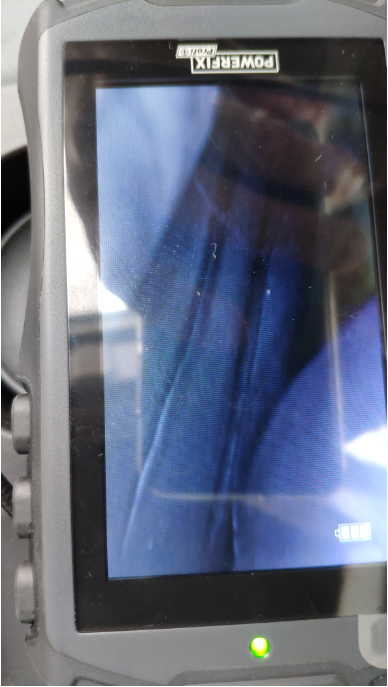

Hi and greetings from Germany,
first of all I want to say I am very thankful that this post exists as our "BMW dealer" who sold us the car (2015 Mini Cooper S with JCW Kit 1) was not able at all to resolve this issue. Very long, long story and I don't want to bore you to death with it.
After finally finding out what really was the problem for this irregular shaking/rattle/instable rpm in idle mode we also got a ridiculous quote for repairing it (even being still under extended warranty). They claimed it is a wear and tear and not a failure in the part itself. Anyhow,... I don't really want to comment on that (normal life expectancy of engine mounts is usually 12-15 years).
We ended up doing it by ourselves in a private workshop and I can say it is not as hard to do by yourself as it first seemed like. BUT an extensive set of ratchets/adapters is very handy to have as it is a bit quirky to get to the bolts without taking too many things apart. With a bit of fiddling you only have to remove the right headlight and nothing else.
Now to the point of this post. I wanted to let you know that by now there is even another revision of this part available. So it seems like BMW hasn't solved the wear and tear problem with previous revisions yet. Gladly giving you the new part number:
1x Engine Mount 22118835566 EUR 129,38 (previously 22118743621 and original was even different from that one, too)
2x ASA screw 22116858061 EUR 3,63 (still same)
3x Torx screw 07129908650 EUR 3,31 (still same)
We still went with the OEM part (expecting to repeat this job in approx. 5 years) and decided against reinforced aftermarket piece. In our believe the engine mount has been designed to give up under certain load (frontal/offset crash) to allow the engine dropping onto the road. This should prevent from further injuries to passengers as the engine squeezes under the chassis. Nobody plans to have such experience but we thought it's still worth considering. Maybe it's wrong after all and the aftermarket piece is perfectly alright but we were not able to find any crash test data. We also plan to exchange the lower engine mount with a reinforced part even though it doesn't show any indications of damage. But the engine/clutch has still this "wobble feeling" that you can also experience in other even new BMWs. Maybe we will even do the gear mount (driver side mount) but not decided on that as it looks rather okay.
For those interested here are some pictures of the old/new mount. As you can see the "old/worn" rubber part sits much lower inside the metal frame than the "new/fresh" one. We were seeing cracks and especially deformation under the weight of the engine. Once the part wasn't under weight anymore one could even assume it would be still okay but it wasn't.
deformation of lower rubber support causes the mount to sit "too low" in its casing
cracks visible under engine weight (using endoscope), unfortunately typical pictures for this part...
more cracks (picture taken with mobile phone)
new part on desk (engine side)
new part on desk (outside / chassis side)
comparison between old an new part (engine weight is already off by jack support which is why the mount is back up but still not as much as the new part)
new engine mount in place sits higher again/in proper position again compared to the worn one (engine weight is back on, support jack removed)
